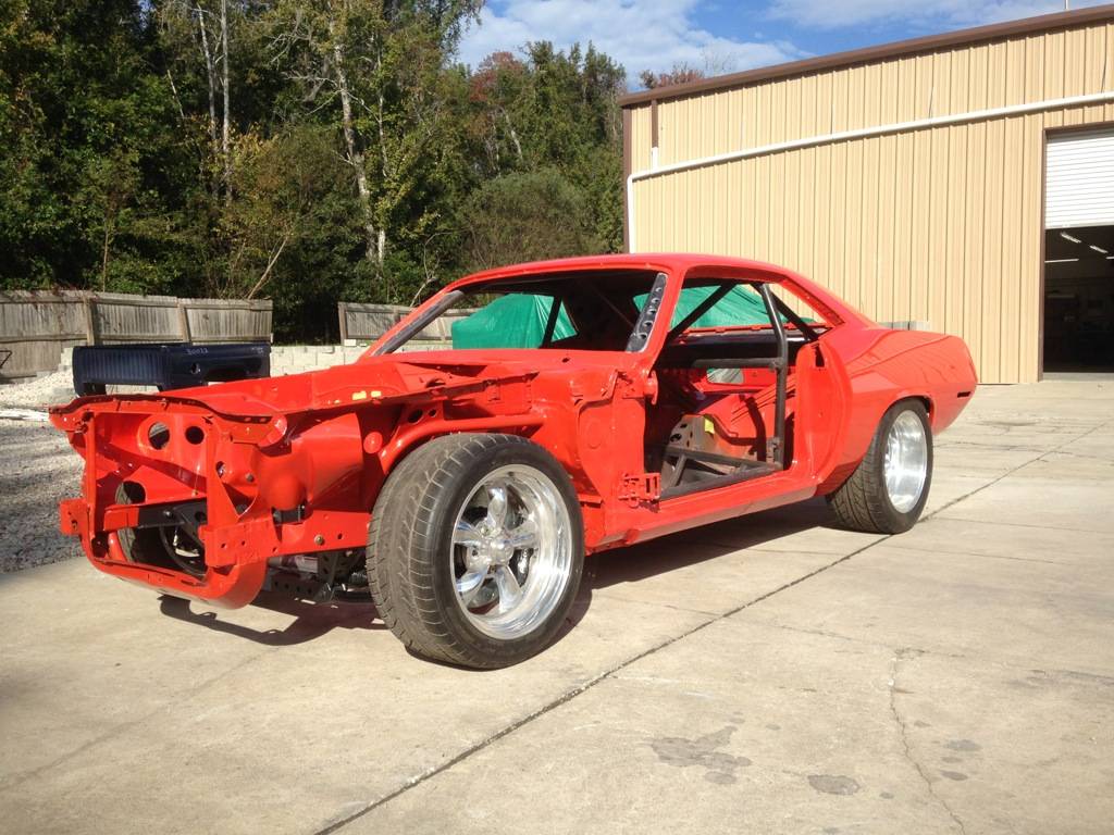

      Hey guys I am new to the board. I am working on my 1972 Cuda pro touring project and I need some information. I am trying to figure out the front suspension but I need to know how wide the front track width can be from outside of tire to outside of tire and still fit between the stock fenders. I do want the car lowered a little bit and the front tires up in the fenders at ride height. Can anybody help me with these measurements? I don't have my fenders yet.

      That seems really wide to me. The factory specs say it is 57.5" stock. How can you fit another 14.5" between the fenders? Maybe I am just not understanding how they measure track width from the factory. I'm not trying to argue I just want to be sure it will fit before I build the front suspension around that measurement.

      3 quick definitions to help your conversation ...
      1. Track width ... is center of tread to center of tread
      2. Tread width ... is outside edge of tread to outside edge of tread
      3. Tire width ... is outside of sidewall to outside of sidewall
      57.5" is referring to track width.

      71-72 is about right for tire width on these.

      What type of front suspension are you using? If you are running the stock stuff you will be limited to a 255 Max. width in the front. Any larger and you will rub the inside of the inner fender and the inside of the front fender. Now if you go to a custom offset wheel, you may be able to squeak a 275 under the front.
      I run a 255/45/17 in the front and 285/40/17 in the rear of my challenger and have no issues. The rear of the Cuda's can handle a 295 or 305 with careful measurement.

      I was doing research on my Cuda and I plan on running the DSE 535 http://www.detroitspeed.com/X-Gen-Pr...X-gen-535.html stub. with the right back space I can run an 18 x 10 and 295 tire.
