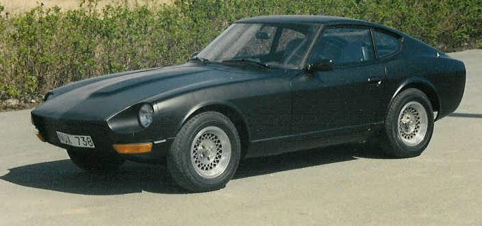

      After some work during the winter, this is what the car looked like in the summer of -89. Back then it was my everyday car. It ran OK, and I and a friend went on a road trip to Paris, France. I also made a lap on the Nürburgring Nordschleife!
