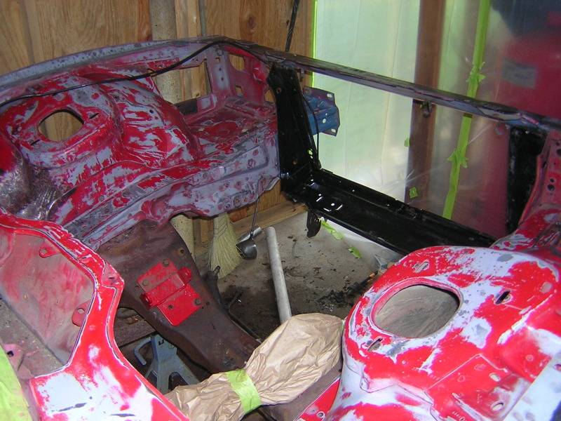

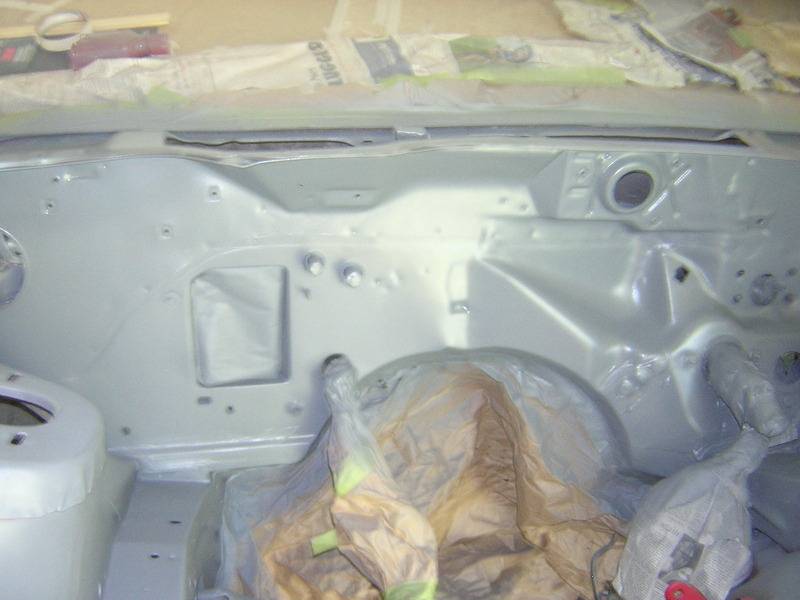

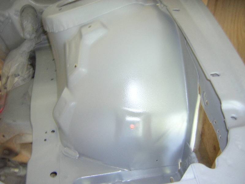

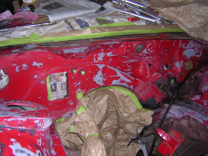

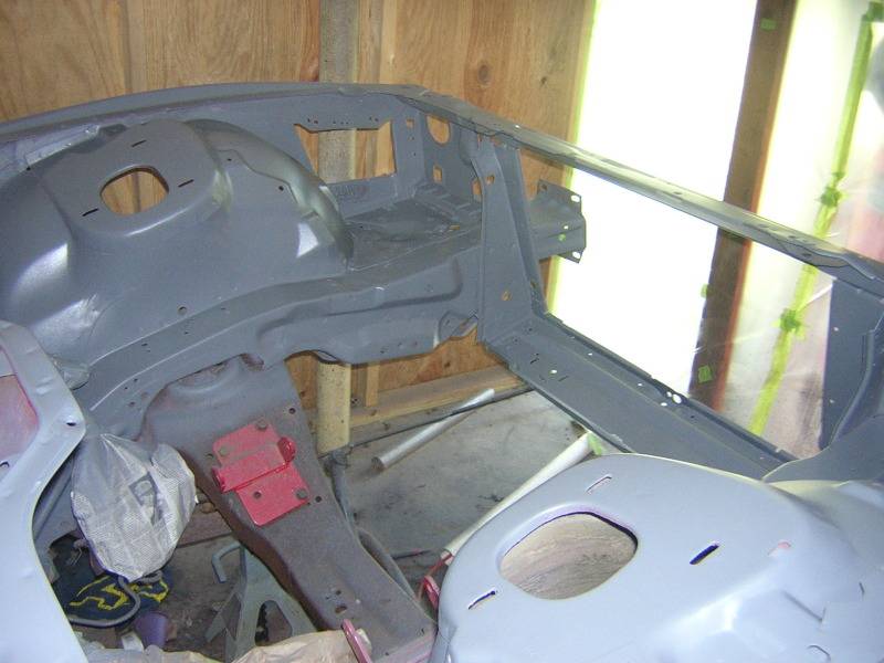

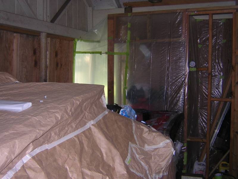

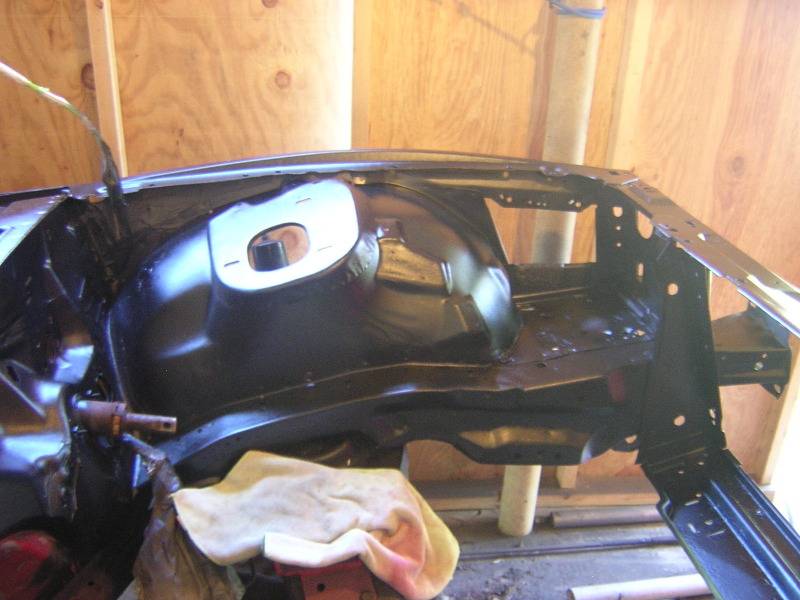

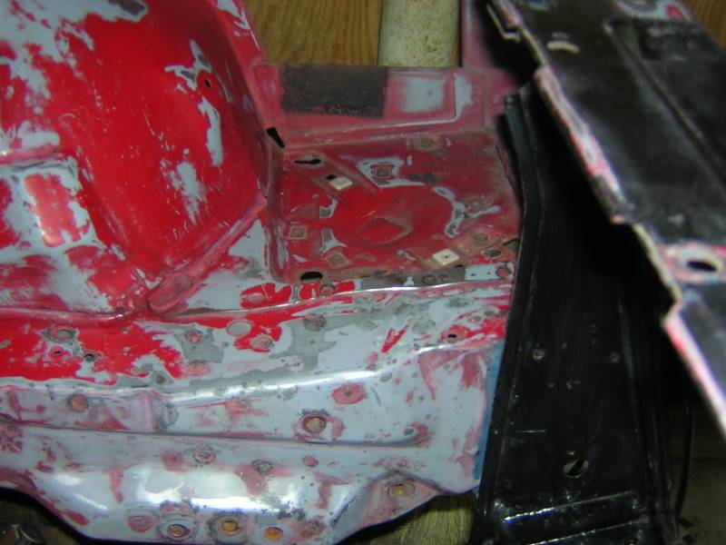

      Engine bay painting with the Eastwood ceramic paint. First time painting and yes.. I realize its not perfect. The K-member will end up replaced so it didnt get masked.:

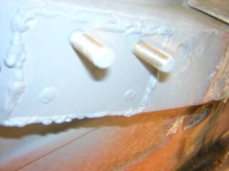

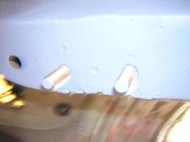

      I snapped off all the trans mount cross member bolts in the frame rail. To fix that... Chop, Cut, Rebuild..har har har..:

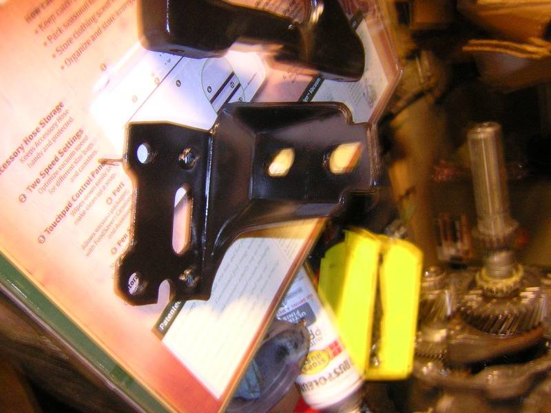

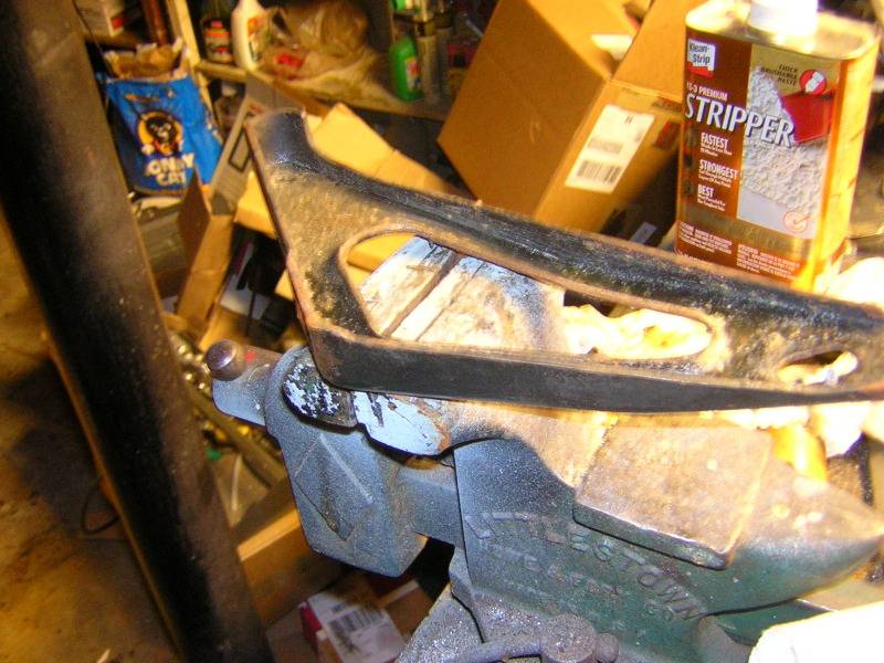

      Refinished a couple sway bar brackets and K-Member brackets. Wish I had a sandblaster for that one... oi. Oh, sorry about the iPotato quality on these:

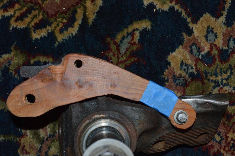

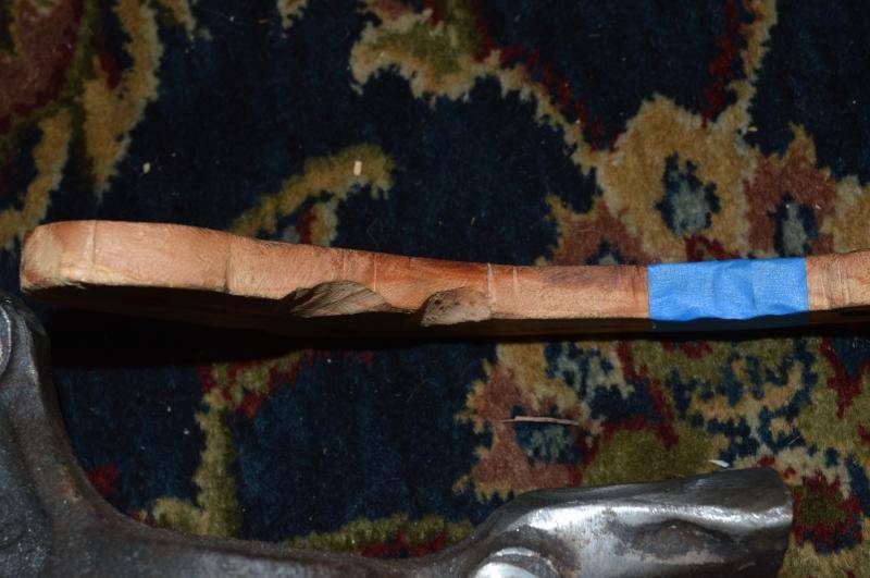

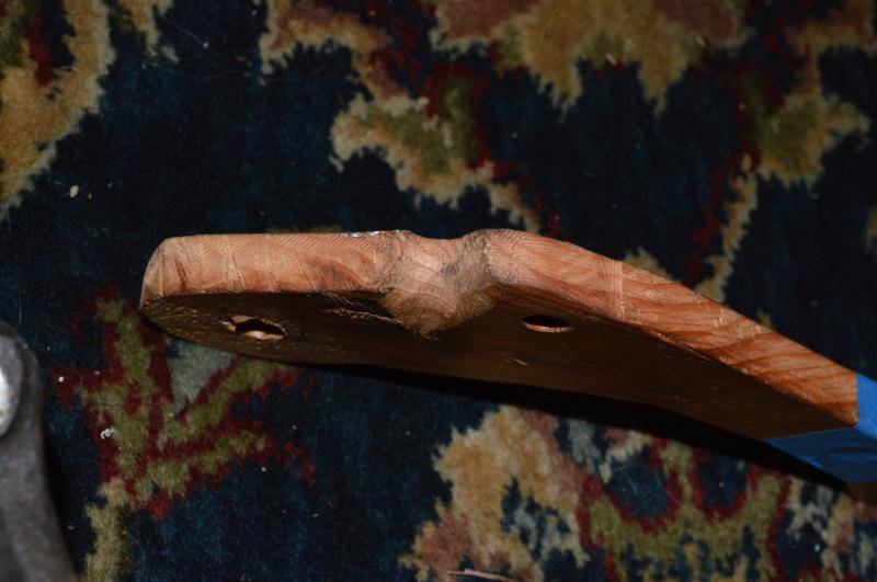

      Then I thought... brakes. Hmm.. lets try to make a bracket that would allow the use of CTSV Brembos with a 13" rotor. Ultimately, I gave this up as between larger wheels and tires or 2 piece rotors, custom brackets, etc... the price difference was 20 bucks...lol. The 'first draft' bracket was looking promising. I modified the stock spindle by cutting off the original mounting ears and doing some massaging/stress relieving with an angled die grinder. I think with a little more time and effort it; could work safely.

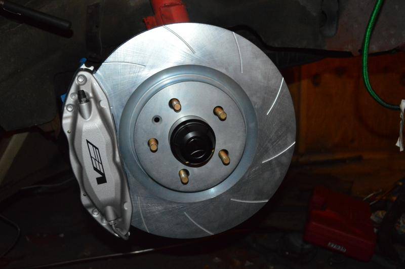

      Front brake on passenger side as it is now (CTS-V OEM, Kore3 Medium Duty Hub, Bigbrakeupgrade.com modified and powder coated spindles, BBU's custom stainless line, BBU OEM Brembo bracket, etc:

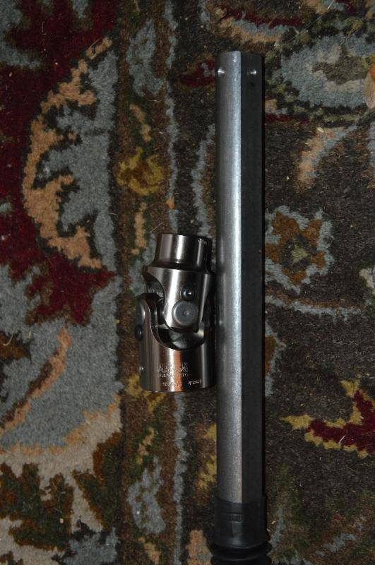

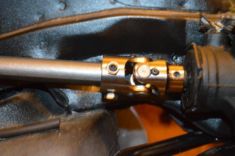

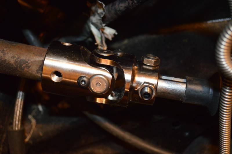

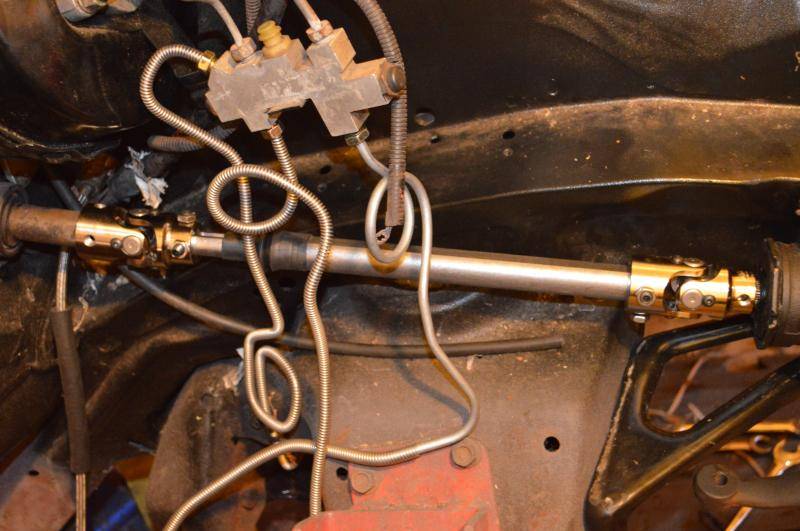

      Steering Shaft Replacement:
      The shaft came as a 21 inch collapsed/27 inch expanded piece with 3/4" DD/1"DD. Here is the Flaming River/Boregeson setup cut down, dimpled, and test fit.:
