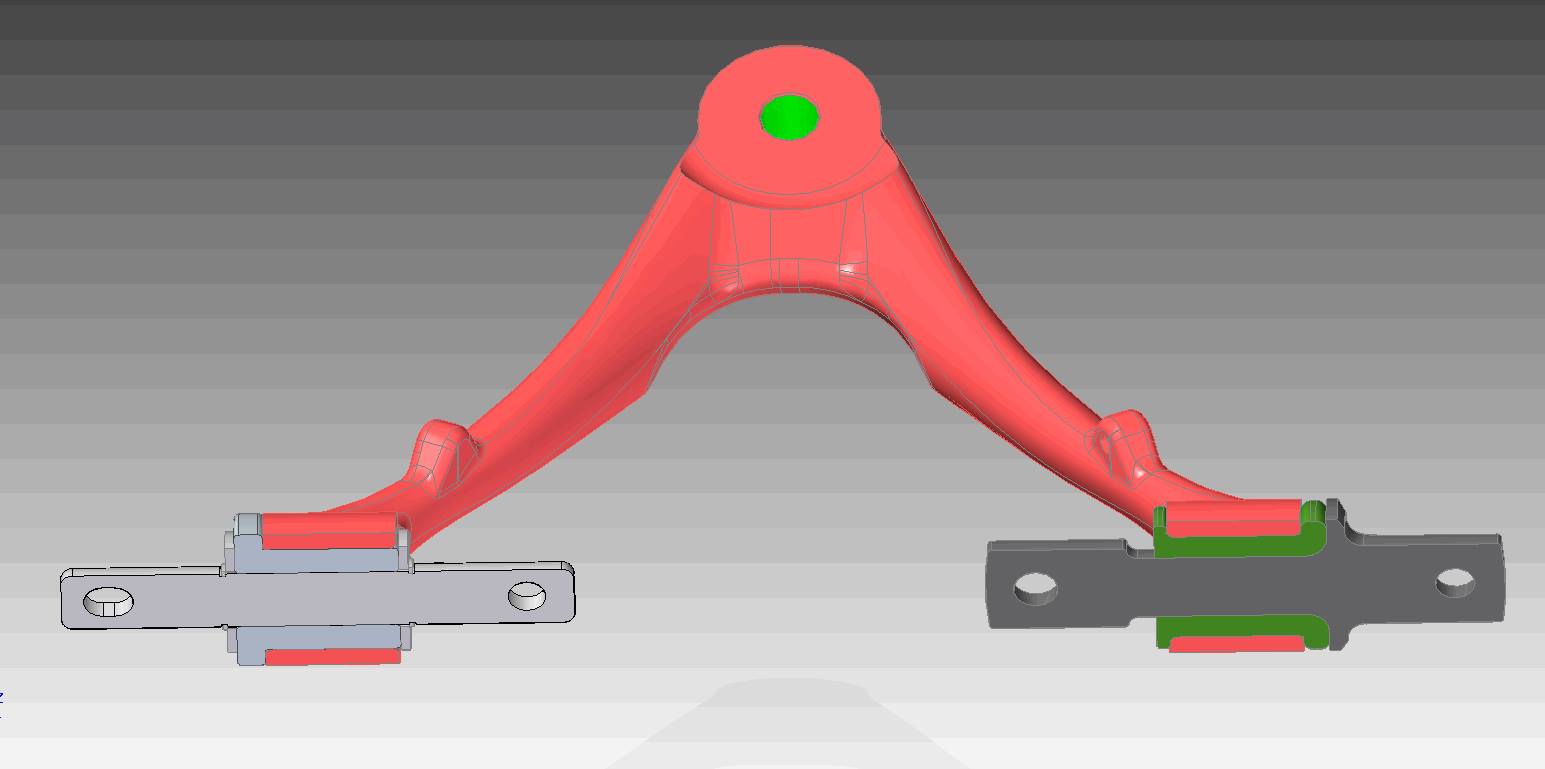

      Here's a quick screen shot of the front upper. . .uses one long Delrin bushing per mount and a fabricated trunnion:

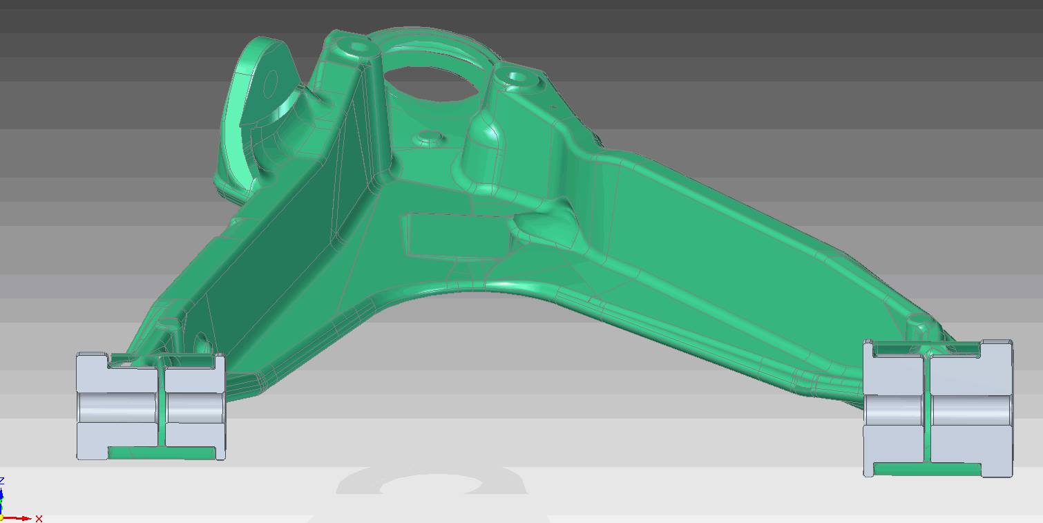

      Here's a screen shot of the front lower. . .uses two bushings per mount:

      If you guys go to market, you might consider making the UCA trunnion depth asymmetric. By that I mean that one side of the trunnion adds more camber than the other. By rotating the trunnion and bolting it on from the other side you can add or subtract camber. Offsetting the trunnion about 12mm (.5") should be possible. Also, slotting the holes to add caster would be most welcome. Oh: and a provision for adding grease.
      That's my wish list, anyway.
      jp

      No need for grease. We use delrin with Teflon.
