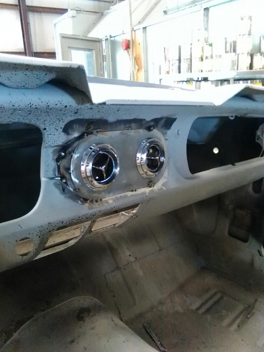

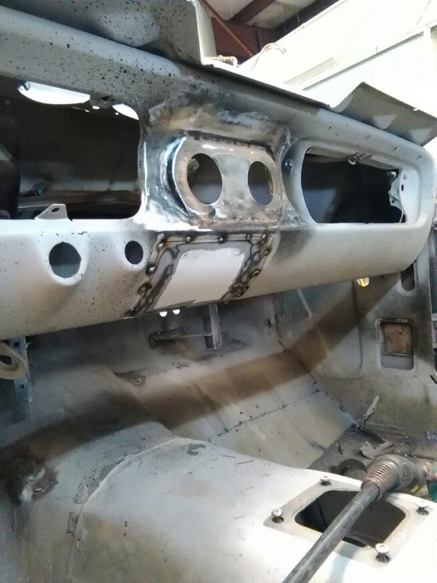

      I was planning on just smoothing the dash and installing these vents where the stereo was. Corey my builder sent me this picture today. Any opinions?

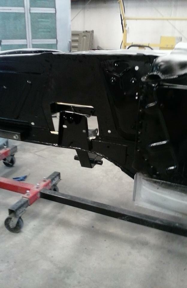

      LS1velle that I exactly what we did and moved them to inside the frame rails.

      For the center vents, I like the idea but I'd see about creating a raised bezel or lower the faceplate to replicate the chrome "rim" like the glove box and gauge bezel. IMO if it was left flat it would stand out more. There is a car Kiwi Customs built that used a cut up gauge cluster to add center gauges in the same location, looked killer.

      Dash is shaved and vents are finished.

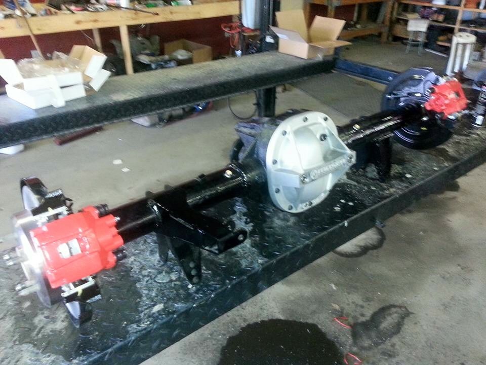

      Differential is all finished. Will install it all next week.

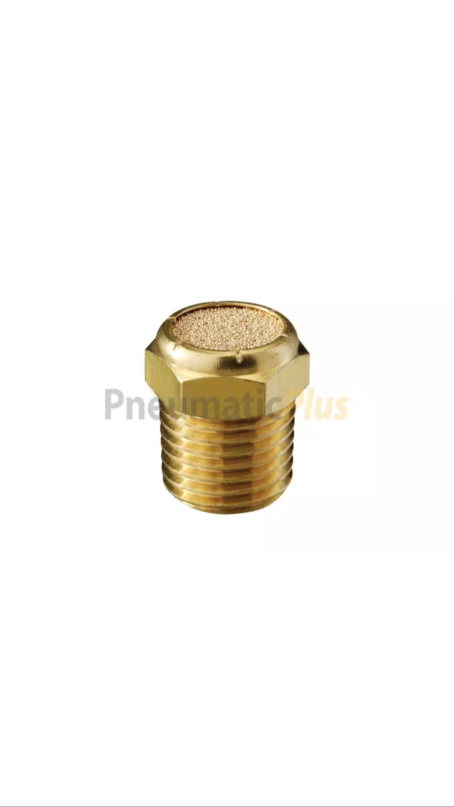

      A cool mod is the removal of the stock Ford axle vent tube and replaced with GM vents.

      It is a sintered breather vent. My Ford axles had a vent tube. I think this is a much nicer option.

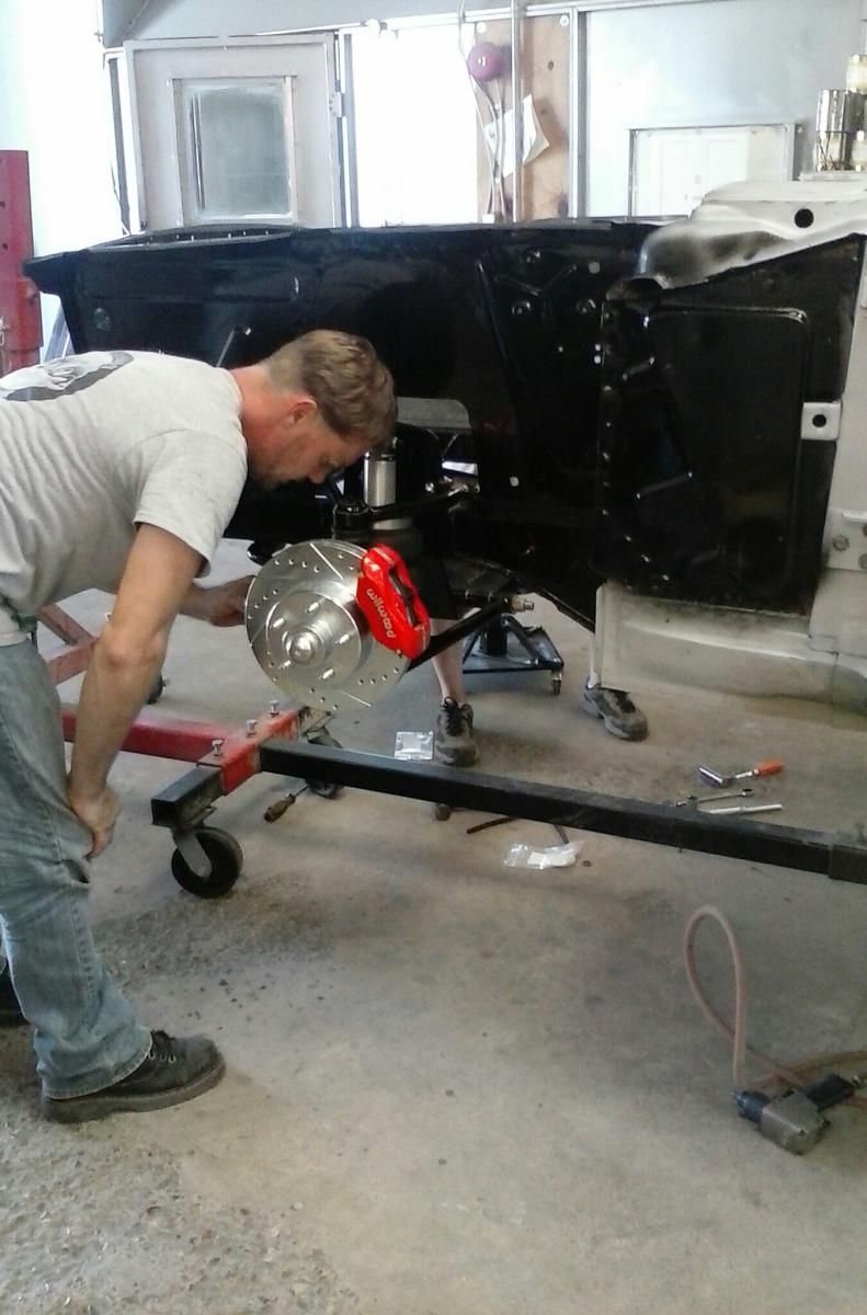

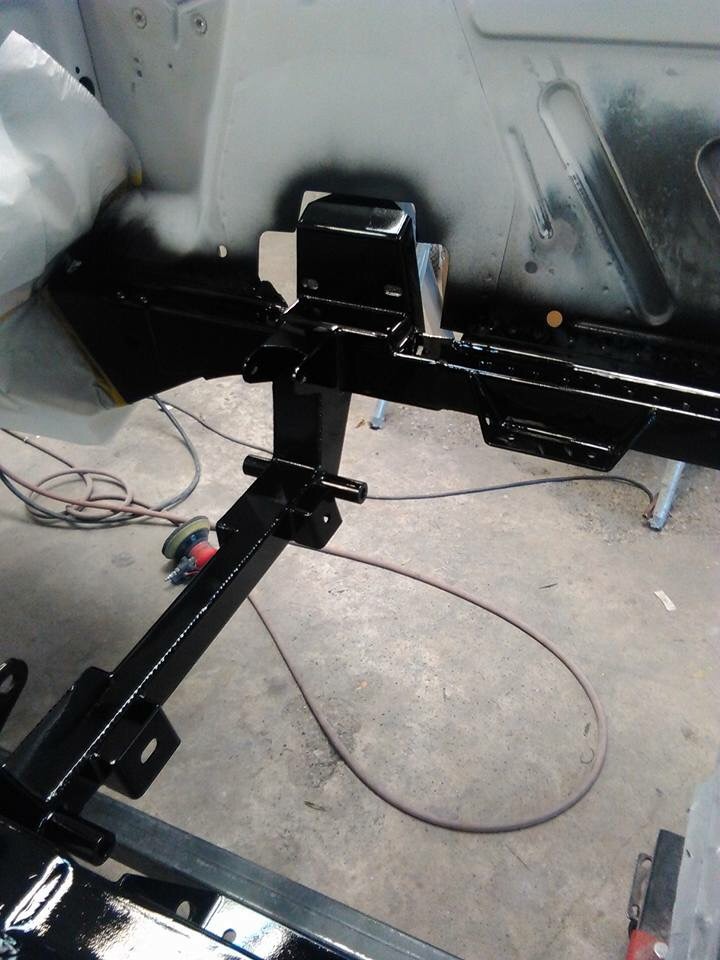

      Painted the front crossmember, frame rails and the front of the radiator support. The rest of the engine bay will be body color. Once this is finished we will begin installing the suspension and drive train.

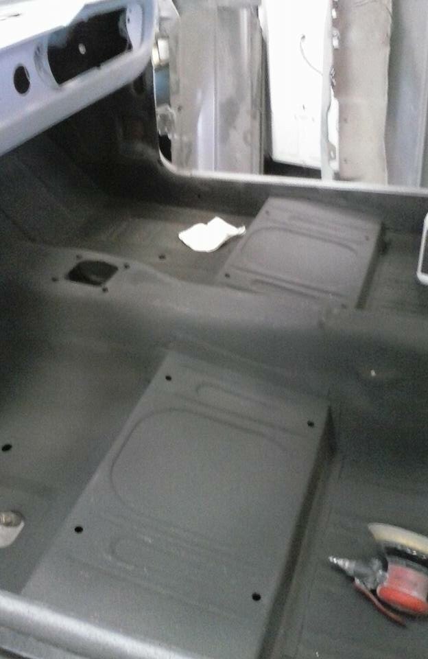

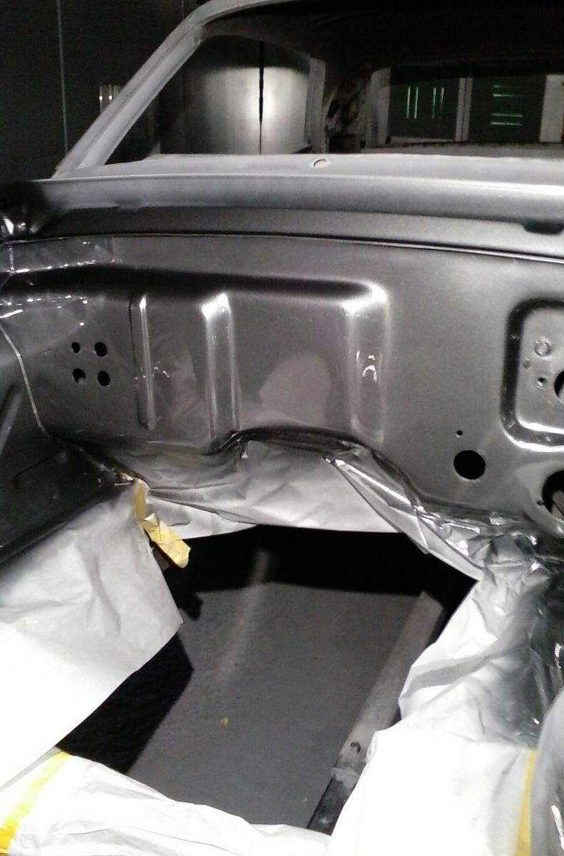

      Woo hoooo the Lizard Skin is FINISHED! I will still Dyna Mat the interior and install carpet pad under the Mustangs to Fear headliner. We did not spray Lizard Skin in the doors. I'm just going to use Dyna mat there. The front suspension is in and the engine bay is blocked. Should have color on the engine bay next week the rear differential installed and the car on the ground.

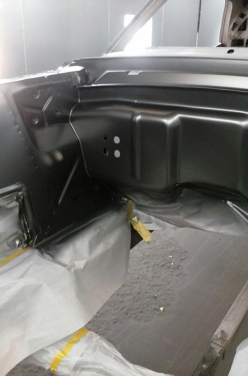

      The outside of the engine bay aprons are now painted and the engine bay is sealed.

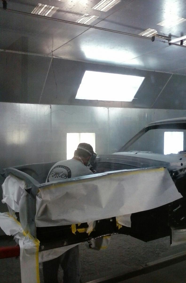

      Paint is mixed and goin on.

      Feb 2013
      Berwick, South Louisiana.
      203
      Final coat before clear and after.
