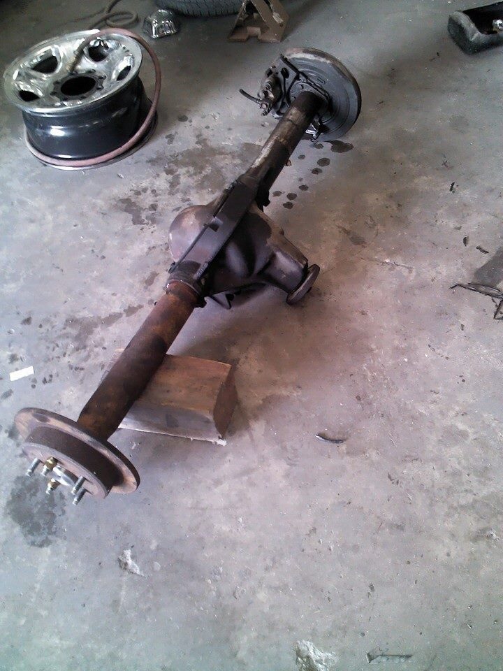

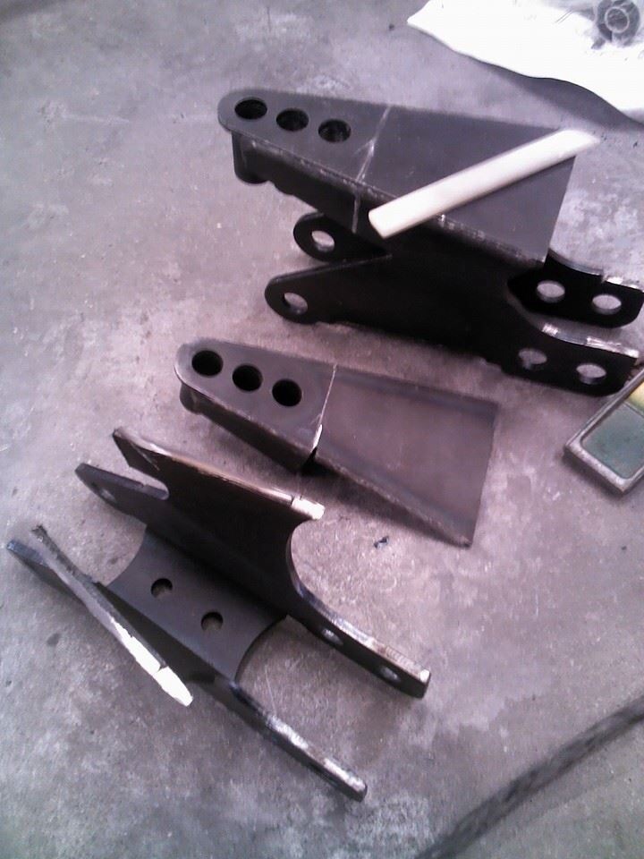

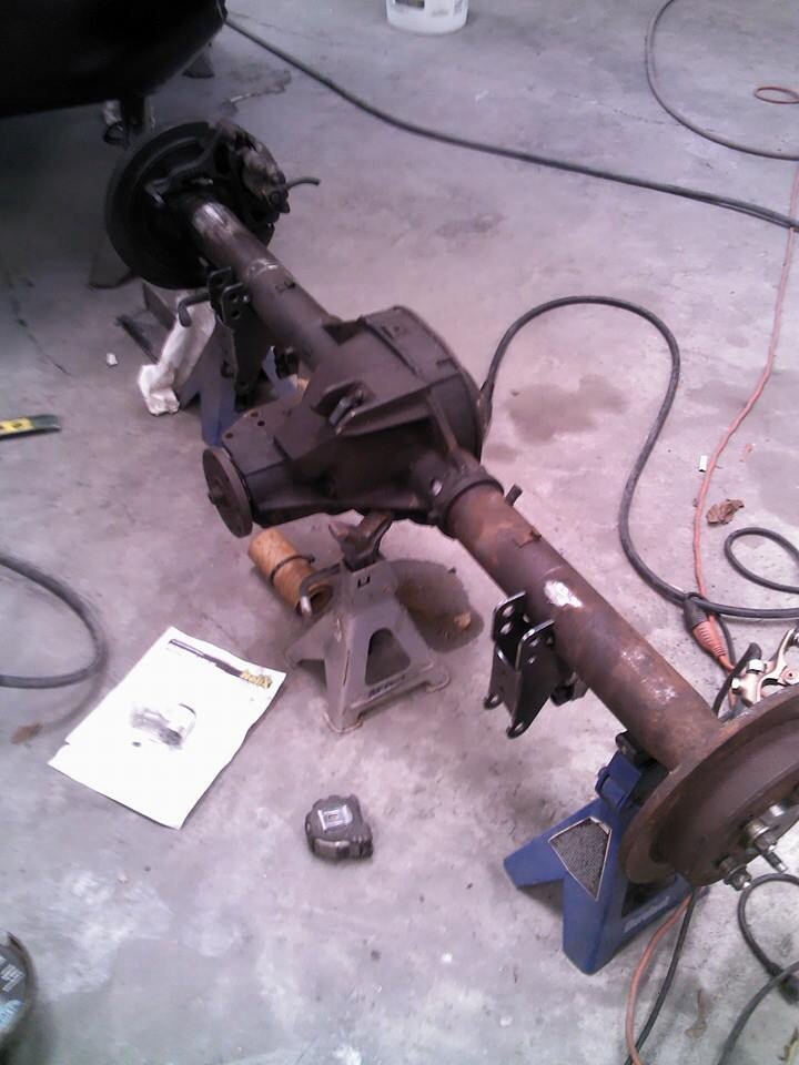

      Things have slowed a little and Corey's been able to get some work done on the car. Engine bay panels are on the way finally. Rear differential is finally back together and going under the car later today/tomorrow for 4 link brackets. We will also take the measurements for the rear Shockwaves. Once it's all fitted and welded up it goes off for powder coating. Ordered a billet AC/heater bulkhead plate, Lokar accelerator pedal and modern driveline clutch master cylinder. Hope to have the engine bay completely mocked and smoothed in the next few weeks. Then the front fenders will go on and we will get to see how the wheels fit with the 255's up front. Moving along again!

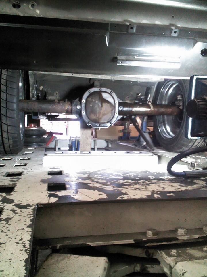

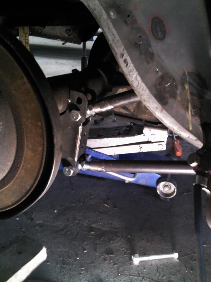

      Here is the 4 link brackets being installed on the rear end.

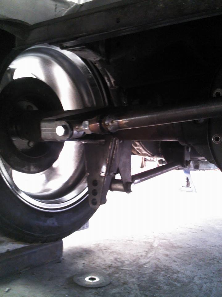

      Here it is back on the ground at ride height. I'm sure Corey will post up better pics. I'm out of the country until next week.

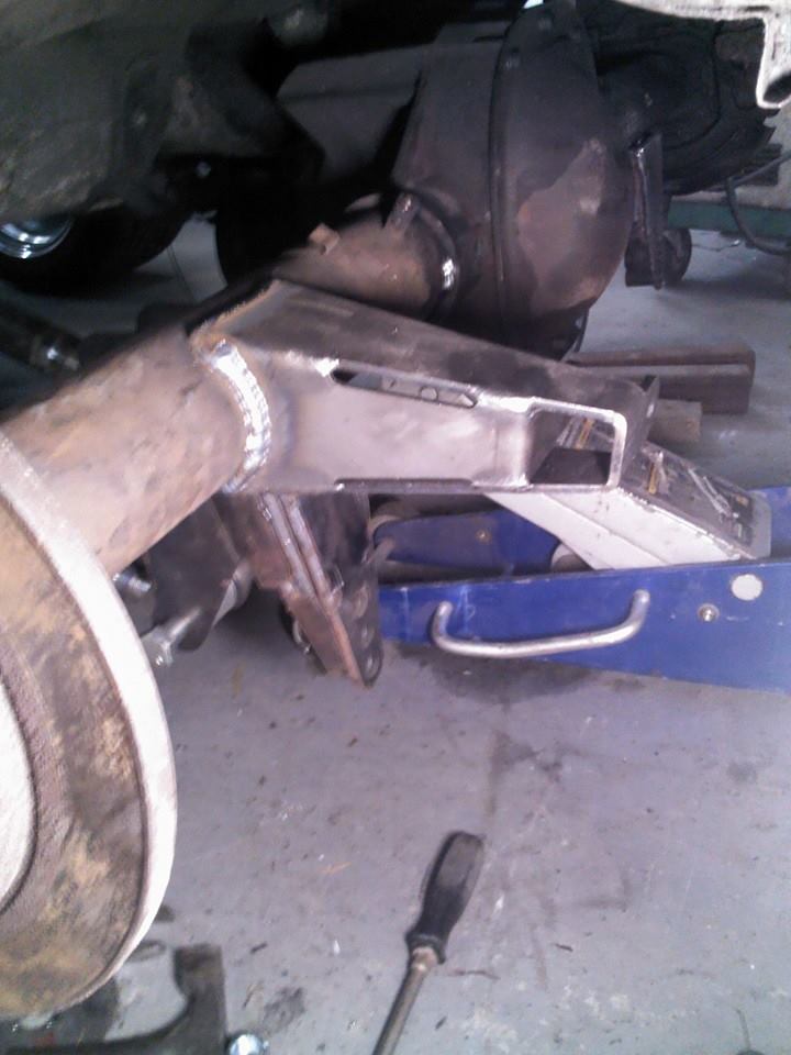

      The 4 link I ordered was not made for an 8.8 differential. The axle tubes have a larger diameter on mine. Corey had to modify them and lengthen them to fit the tubes. Work is still ongoing.

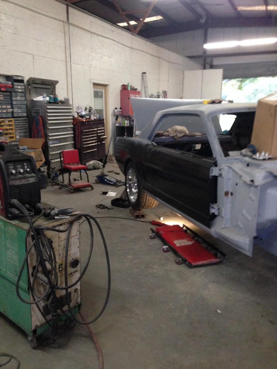

      Quick update on the Stang!

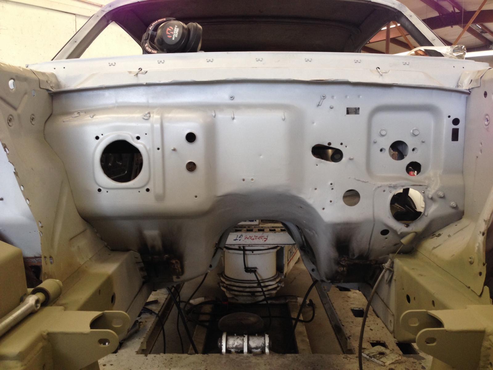

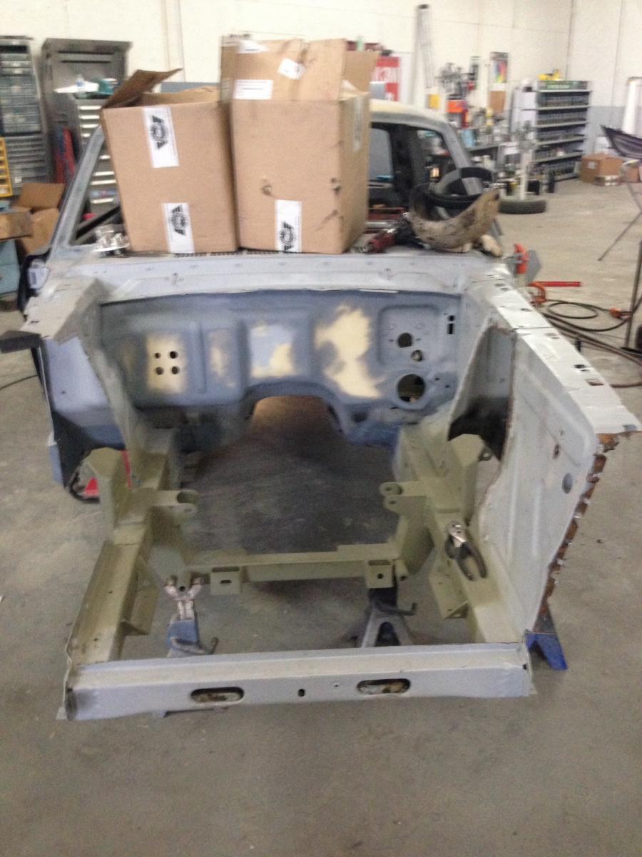

      Corey's doing an excellent job. The car is really coming along. I think the before and after of the firewall is pretty cool, it's not finished but well on its way. Josh at ridetech has been very helpful in sorting the rear suspension as far as geometry questions. In fact every time we've called him he's been helpful. Thank you Josh.

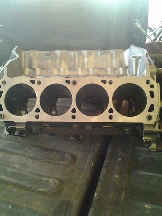

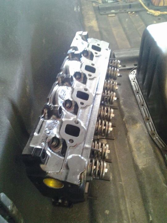

      The engine mounts, transmission crossmember, mount and all of the clutch parts are in as well as the fuel tank. Today Corey picked up the block and heads from the machine shop and dropped it off with the builder. Will post up more pictures as progress is made.

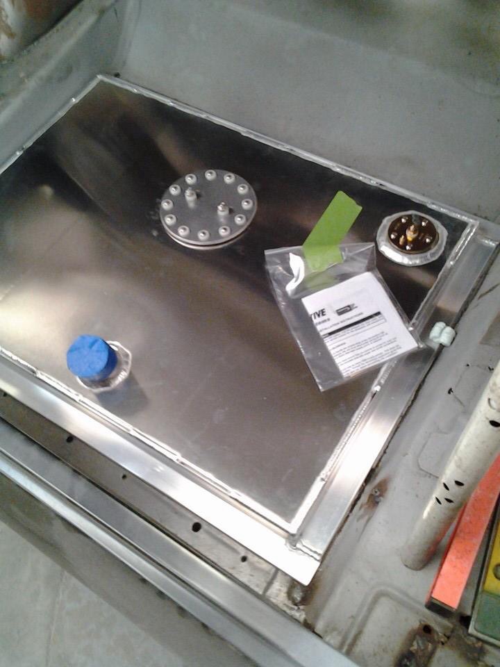

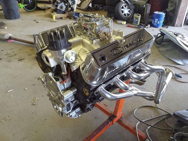

      I was going to paint the engine Ford blue. But seeing it mocked up have decided to go with black. I really think it makes the billet stand out. The tank fits like a glove. Corey is getting the transmission together and hopefully the engine and transmission will mocked up on the car by next week.
