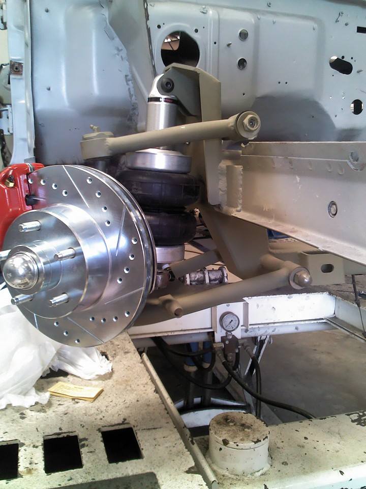

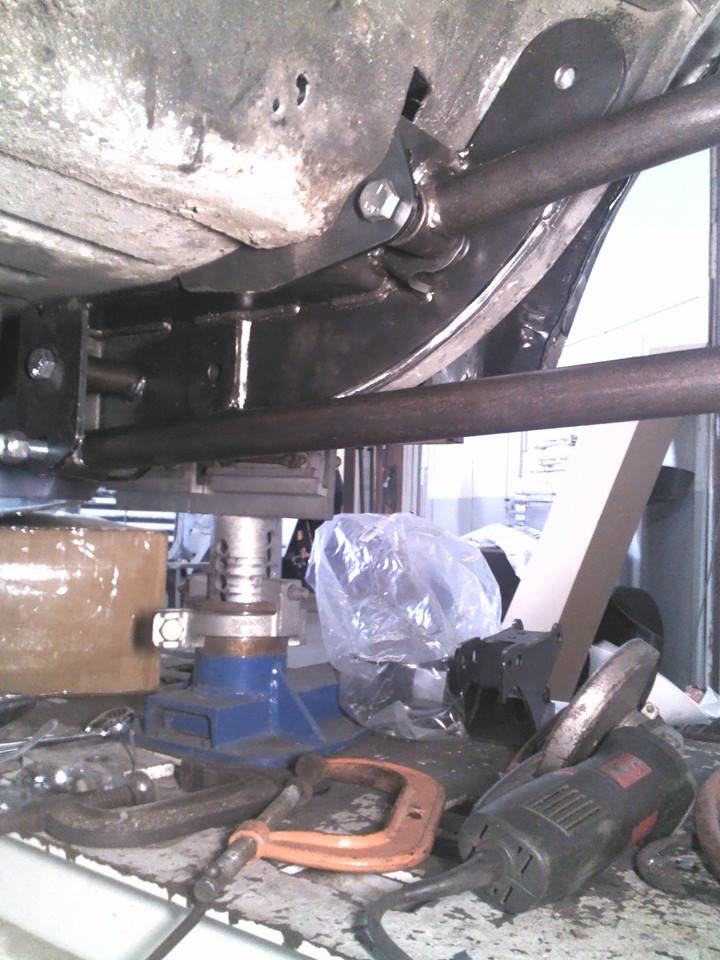

      suspension photos(as of 6/3/2014
      Here's a couple of quick pics of the front and, rear suspension. Steering and, suspension are likely my favorite part of a vehicle...Especially when you have to modify it!Name:  4 link.jpg
    9. #29

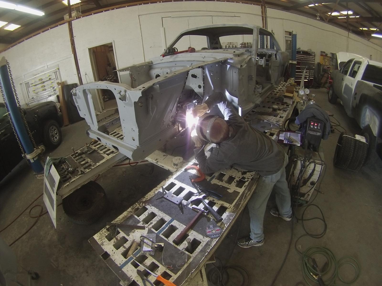

      Some of the welding of the new front end

      So far looking good. What 4 link kit is being used? I'm trying to figure out what kit would fit with an 8.8 running 18x10 (possibly 10.5) in the rear.
    12. #32
      Jun 2014
      Gonzales, LA
      9
      We went with a basic 4 link modeled after a Helix. It is supposed to be a bolt in but, we had planned to weld it anyway...It's a good thing we planned to weld it because it wouldn't fit where it was designed to since we mini-tubbed the car.
      We started on the cleaning up and, narrowing of the 8.8 last night. It isn't too bad to do, really and, it'll allow us to run the 17x10.5 with a 315 tire too!
