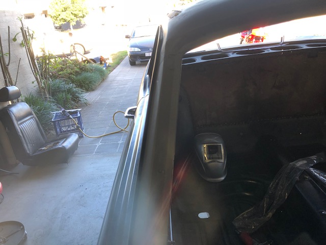

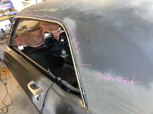

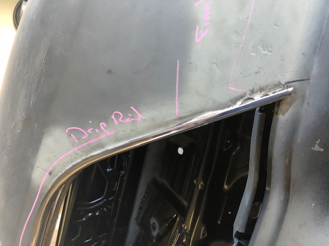

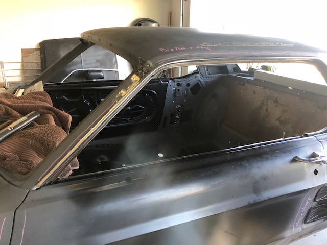

      Next on the list was a part that has been bothering me since we removed them to remove the roof, the drip rails.
      The drips rails for the coupe are no longer available and as mine were rotten and i wanted to remove the roof mine had to go. I am not a fan of the smooth rounded look but if i couldn't solve the problem then that is how it would be.
      I got a local sheet metal shop the bend a few different profiles until i was happy with one that i thought would work and offered it up to the car.
      I have to say that i am pleased with the results and once it is primed and sealed it will look even better. The stainless mould fit on really well and you cant even see the fabricated drip rail.

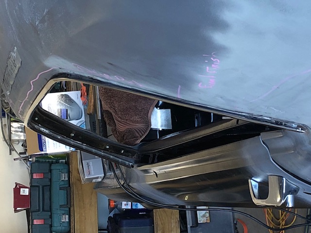

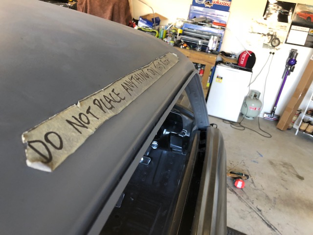

      The rear of the sail panel gets a little tight but i think only the connoisseurs among us will notice.

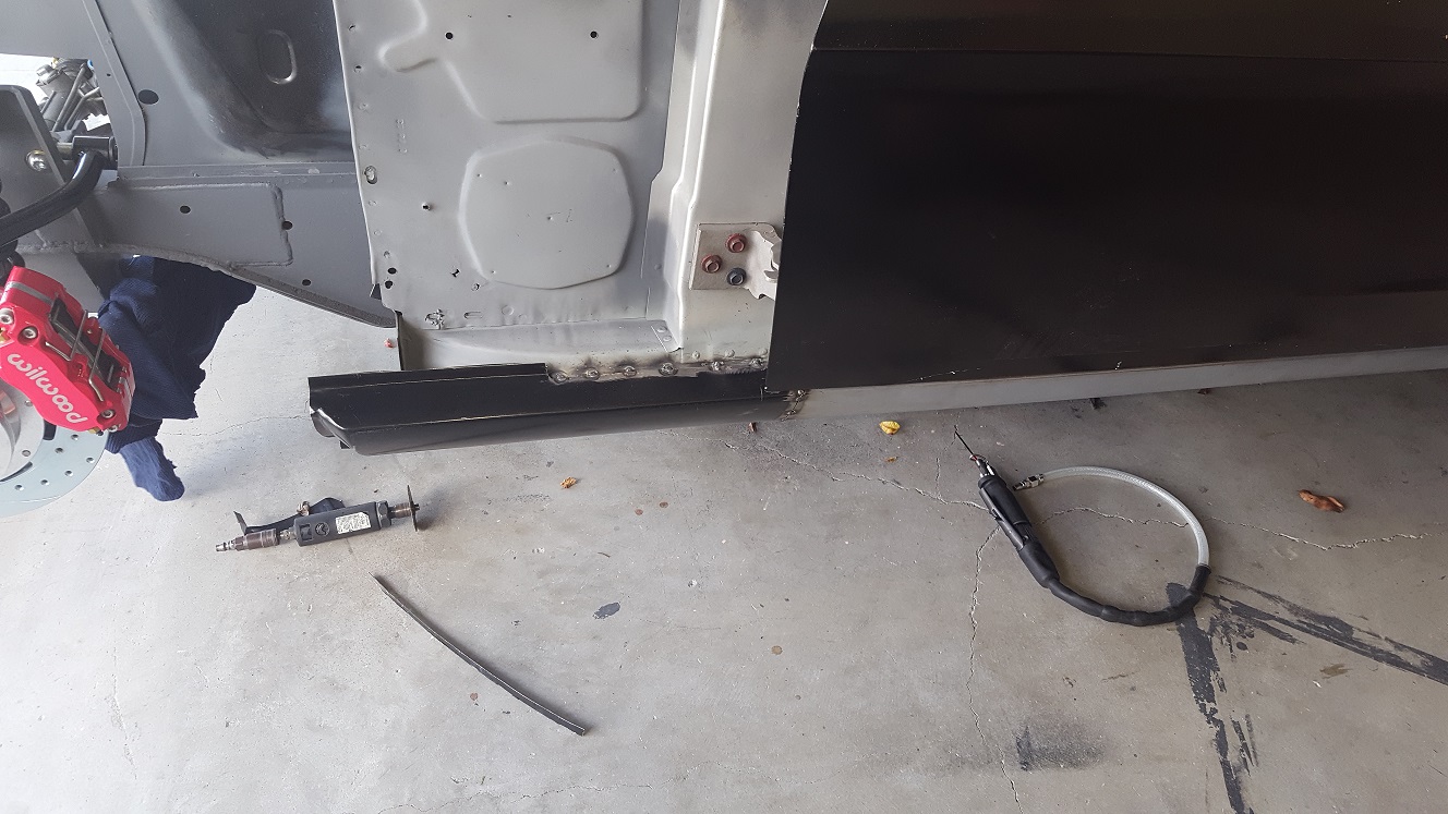

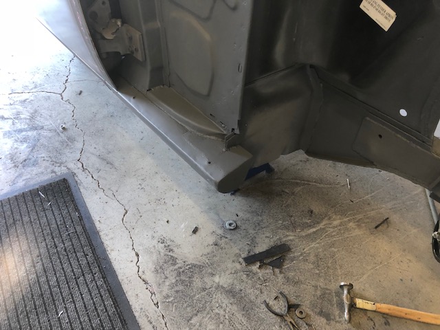

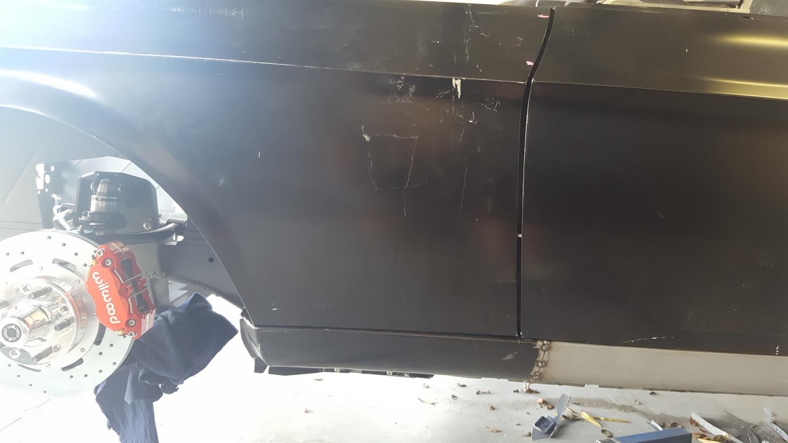

      Next was another issue that has had me thinking, how to close off the rocker panel extension, neatly?
      This is where we are at so far with this. its still a work in progress and its getting there slowly.
      Where we started....
Size:  312.5 KBName:  20160903_123759.jpg

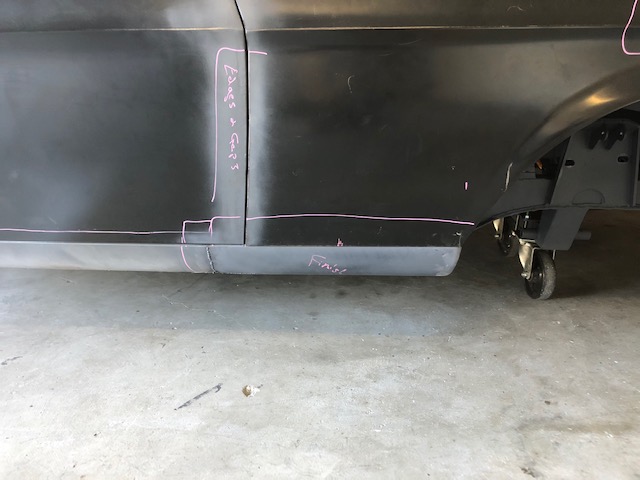

      Where we are at now.
Size:  64.2 KBName:  IMG_9014.jpg
      Coming along but still needs a good tidy and finish to make it look neat and as if it supposed to be there.
