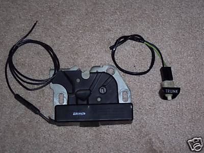

      Not nitpicking here by any stretch, just not sure if you thought of / declined - But with everything you're doing with subtle changes and modernizing - Have you thought about going with an electric trunk release?
      Also - my 68 Charger tail lights do not have a provision for a ground - the socket simply grounds thought the housing - you appear to have run a dedicated ground wire to each socket --- Did you run a different socket or just solder / rivet / weld a tab on the socket itself?

      I’ve had a few people mentioned other modern upgrades, but I like the fact that I’m reusing most of the original hardware. Apparently some mid 70 Chrysler used an electric trunk latch that has the same footprint??
      The ground wire is not necessary with the metal tail light housing but the manufacture of the wiring harness doesn’t know what kind of housing it’s going in so it’s supplied with ground wires and I decided to use them.

      gotcha! Good to know about the wiring - sounds like a very decent upgrade as my sockets don't always ground very well and sometimes require some bending, adjusting, etc.
      Yes - the trunk latch from a late 70s / 80s Dodge / Plymouth has the same bolt pattern - There are some that use a linkage rod and arm (which you dont want) and one style that uses a rod that goes through the mechanism - just like your existing factory one.
      Linked pic below gives you an idea - it is basically the same mechanism as your 68 latch but with a black plastic cover that protects the added electric mechanism -- just food for thought if you decided to add it later
