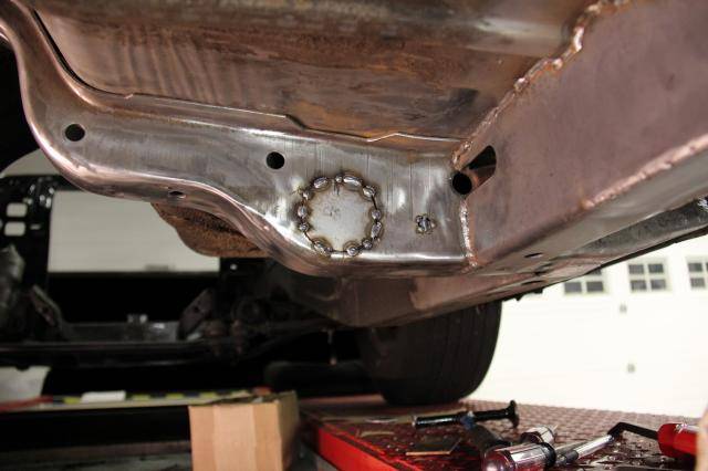

      Finished the rear valance and left rear quarter rust repair. One more rust spot on the front side of the left quarter to do then on to the trunk floor.

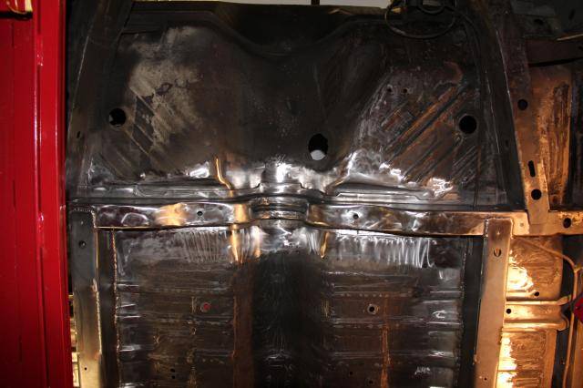

      Added a cross member just forward of the leaf spring mounts. Used a 2” x 1 ¼” “C” channel cut and welded to fit in the floor tunnel under the rear seat. This should add additional rigidity to the chassis without impeding the driveshaft. Torque boxes are next.

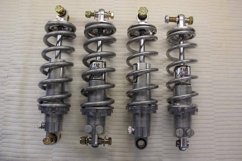

      Assembled the shocks using anti-seize and chased the threads on the upper control arms. Nice working on clean new stuff instead of old rusty stuff.

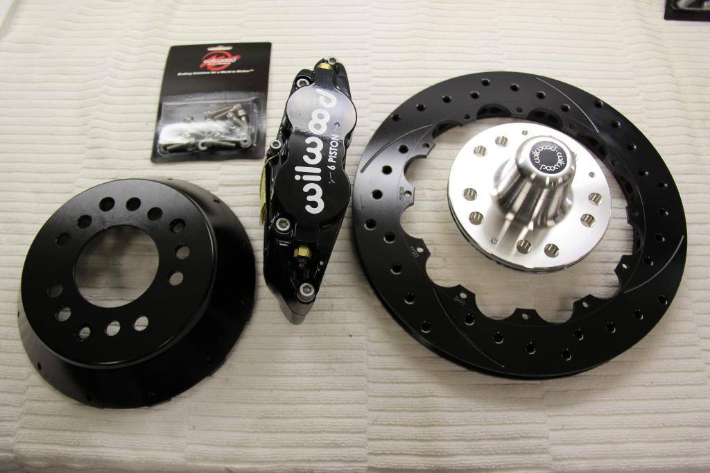

      I assemble the new front wheel hubs, hats and the rotors. I used the same Wilwood 13” 6 piston brakes on my last 68 Chargers and they worked great!
