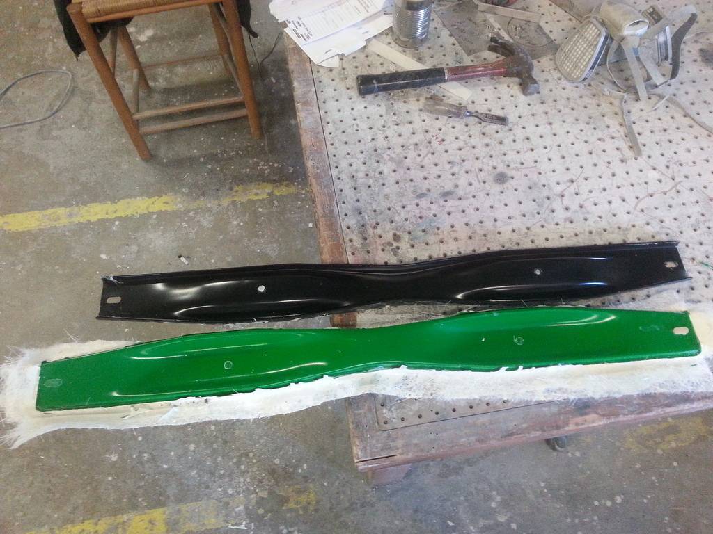

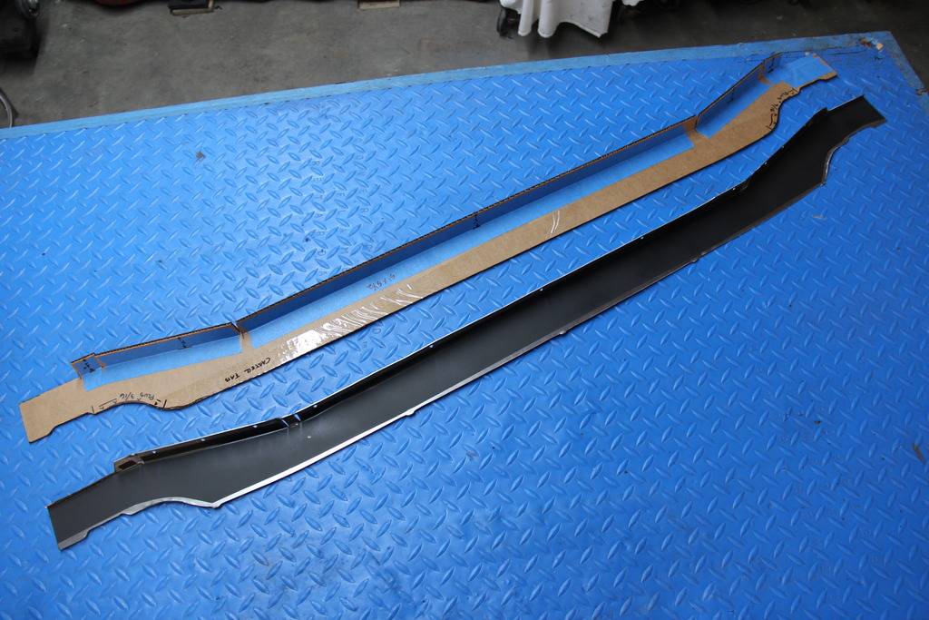

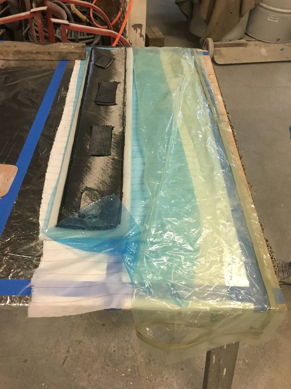

      I had a mold made of the front bumper guard mount so I could make a carbon-fiber version of it. The steel mount weighs about 6 lbs and the carbon-fiber replacement will weigh about 1 lbs. After I pull the 1st part I’ll post a few pictures and if anyone is interested I could make a few more? I think I will paint mine black to look original but they could be left clear to show the carbon-fiber if you like?
      Thanks
      Pat

      Would you mind giving us an overview of how you create the piece in CF? Is the process similar to laying fiberglass?

      Very similar to fiber-glass as there is a mold, resin, and fabric. But unlike most fiber glass work which is hand laid we use a vacuum bag to eliminate air pockets and any unneeded resin to help keep the weigh down.
      Thanks
      Pat

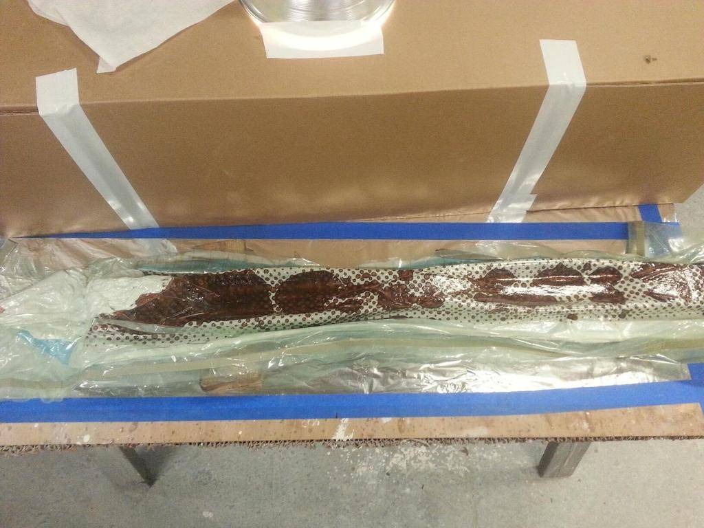

      The CF part is all sealed up, vacuum bag and going into the heater box for the next 24 hours at about 140°

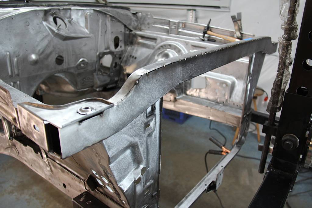

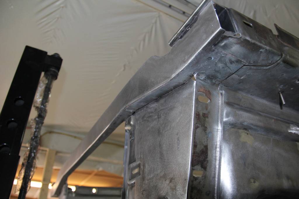

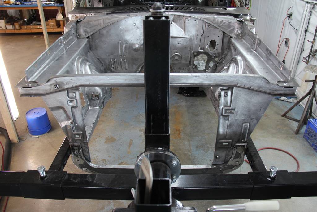

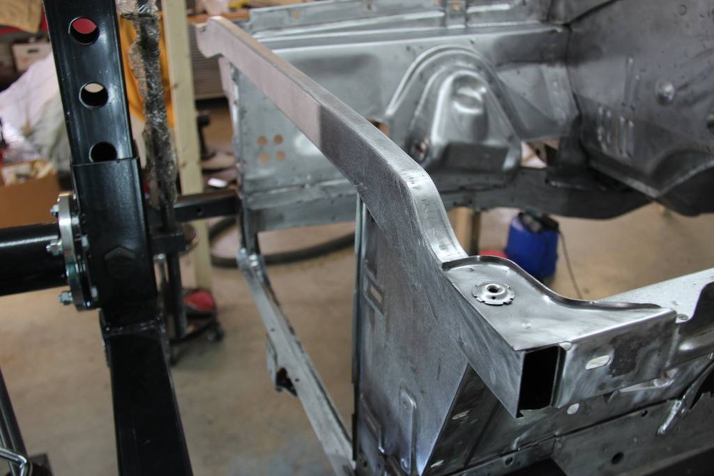

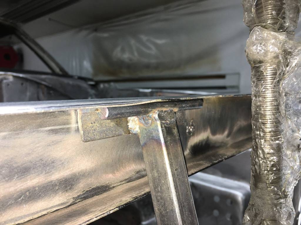

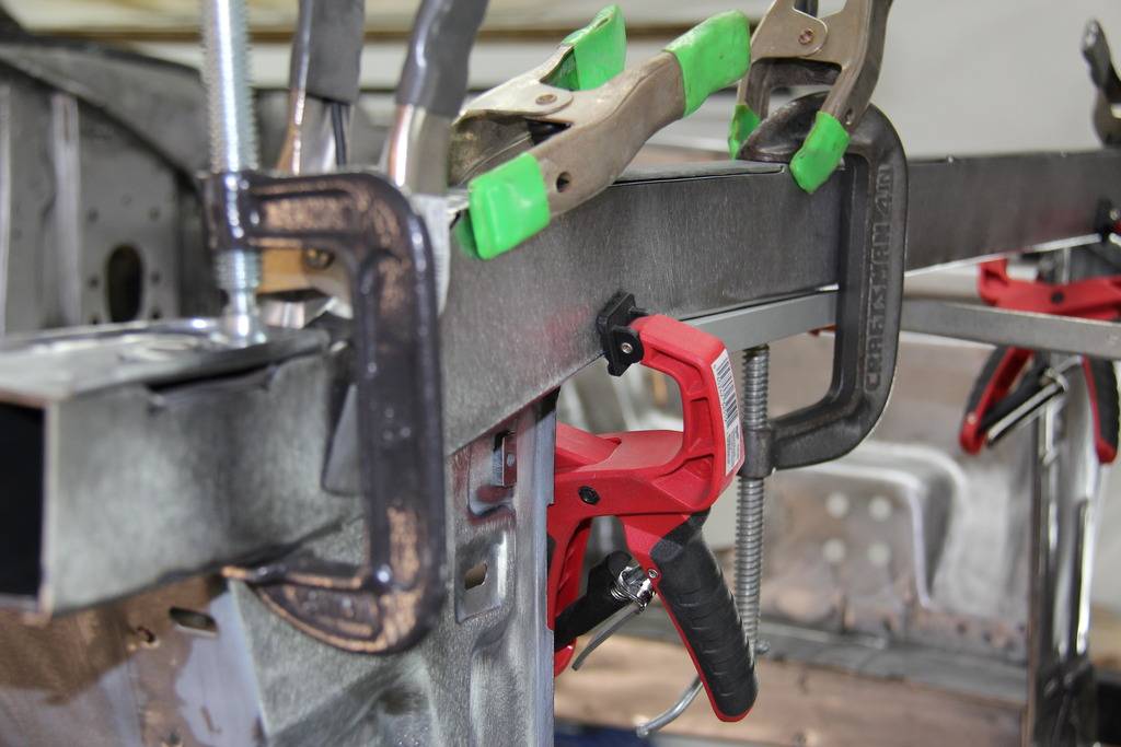

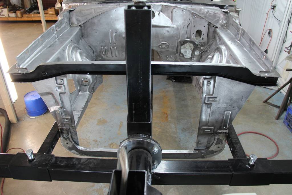

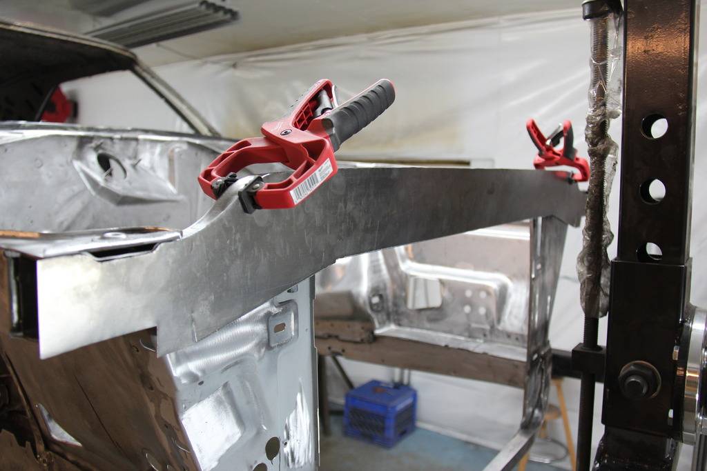

      Boxed in the upper core support, amazing how much stronger it is now. I think I could pick the car up from it! I will use it run and hide the wires for the fans, horns, AC, and lights.
      Thanks
      Pat

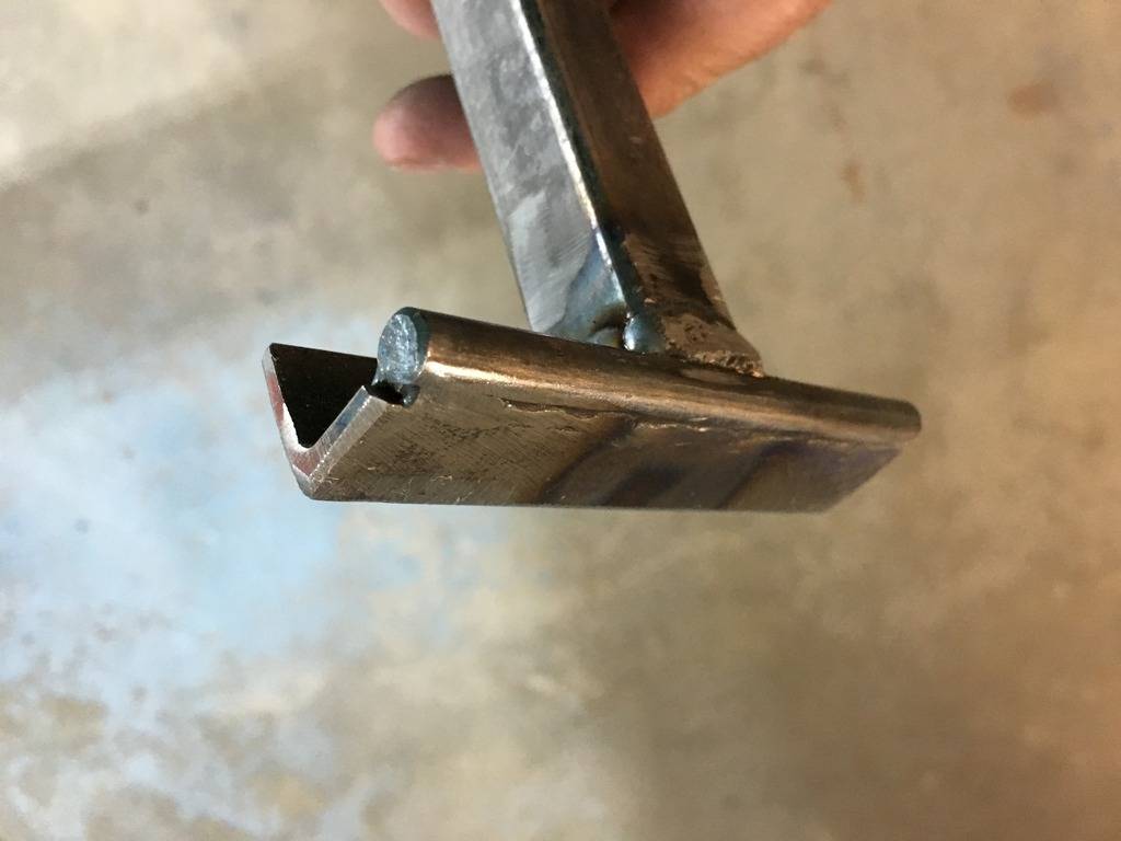

      Made tool to roll the top edge of the core support right at 1”

      Country Flag: Australia
      Love the core support mod
    7. #487
      Sep 2013
      sw Kansas
      1,661
      That core support surely will stiffen the front substantially. Good job.
      Yes, it did make big difference and someone like US Car Tool should make the part as I think it would sell!

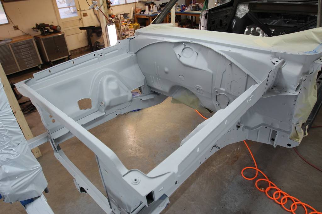

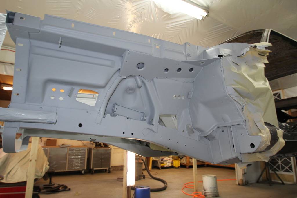

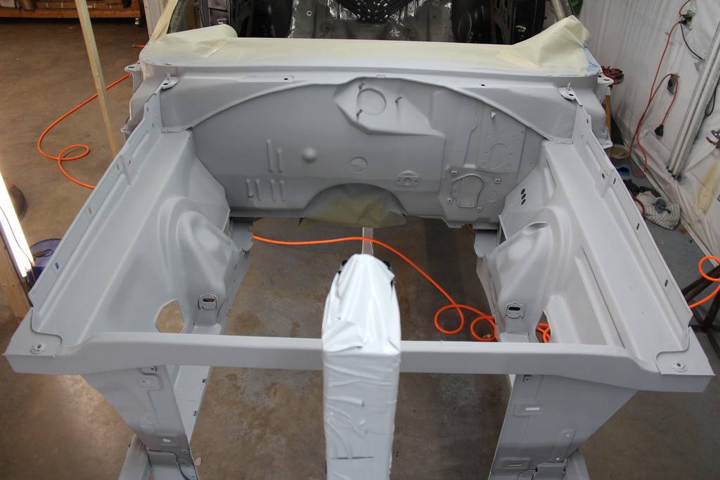

      1st coat of primer on the engine bay and fender wells.
      Thanks
      Pat

      What's the plan for painting this area?
    16. #496
      Apr 2014
      803
      The engine bay, fender well, and bottom of the car will be painted gloss black like the top side.

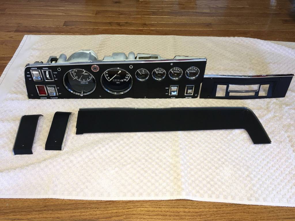

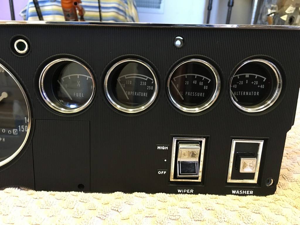

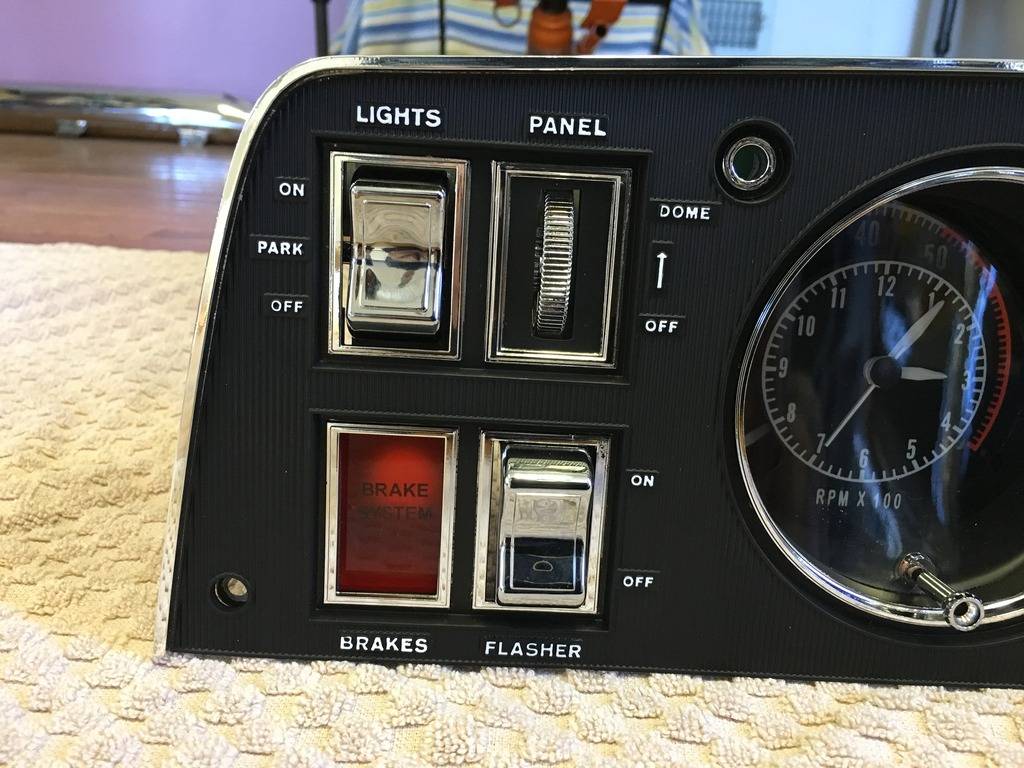

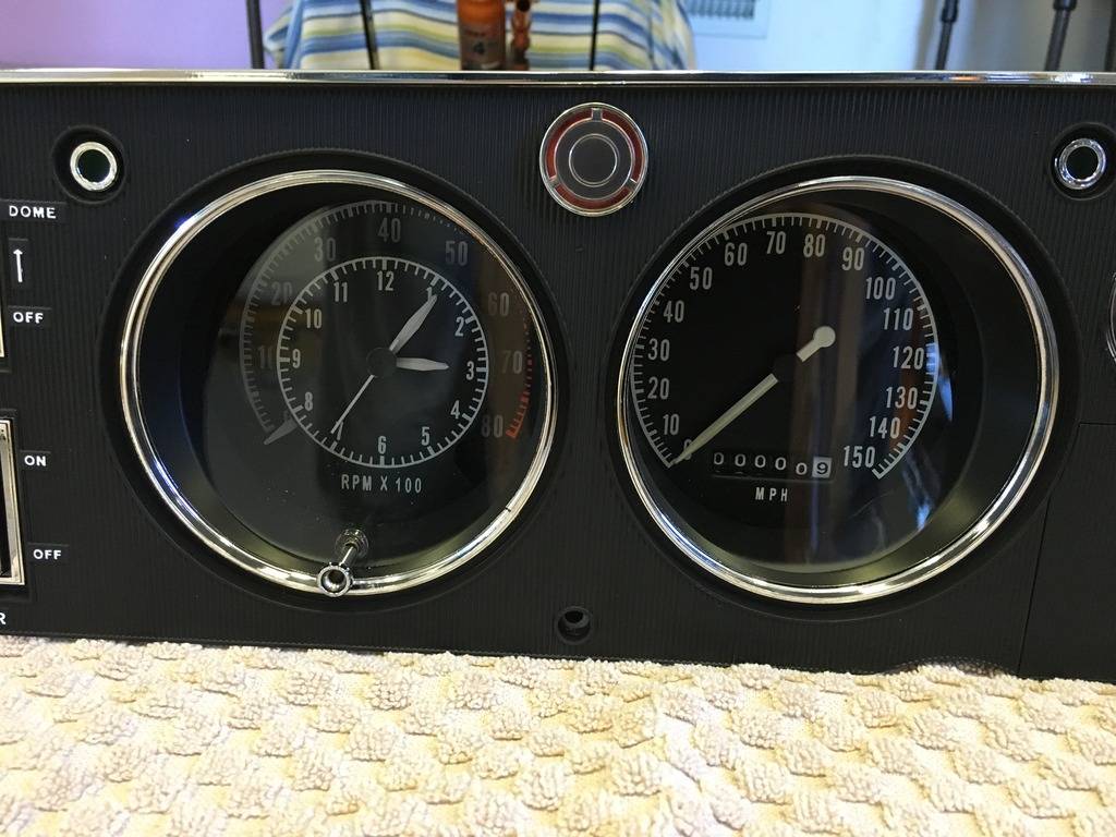

      Received my restored dash and instrument panel from Auto instruments very happy with their workmanship and the re-plastic plating.
      Thanks
      Pat

      5,560
      Study did a beautiful job. That's going to look amazing in there.
