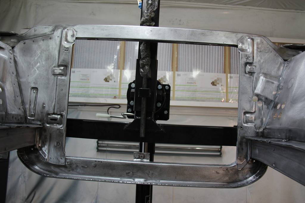

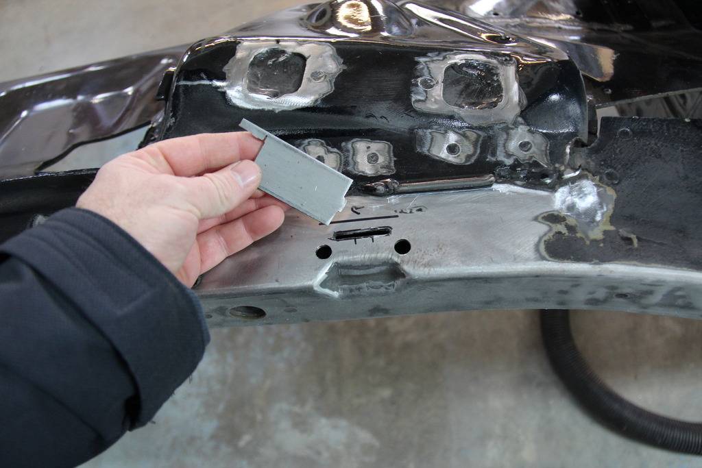

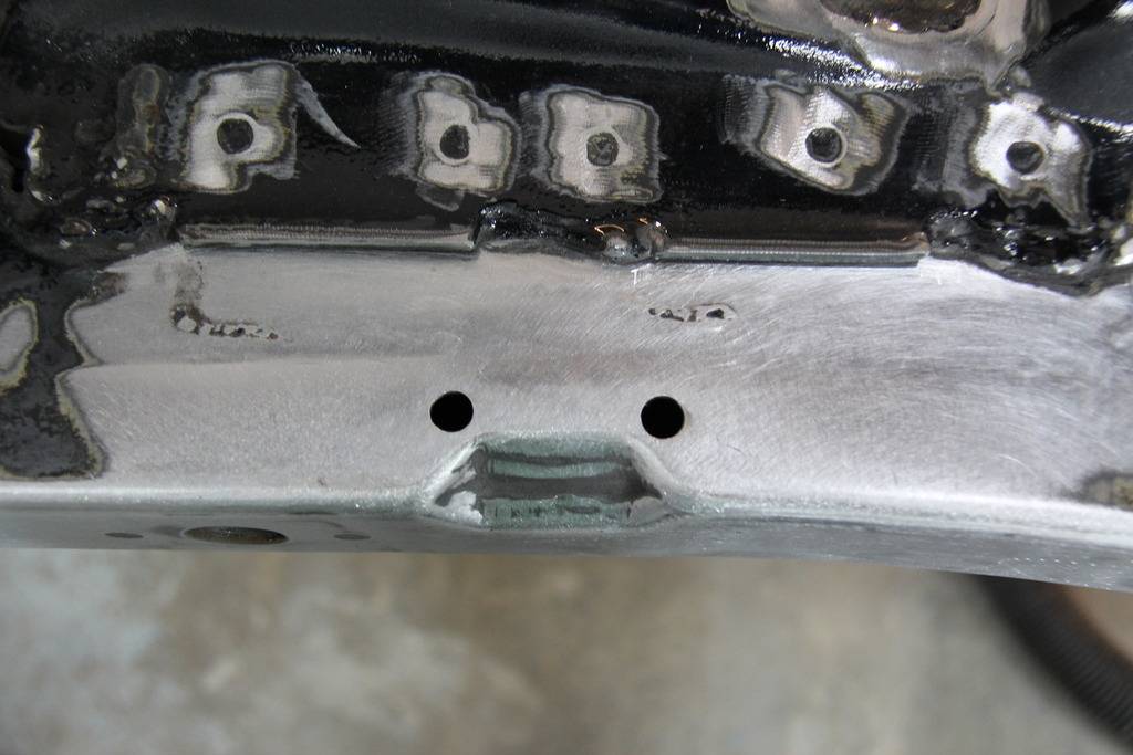

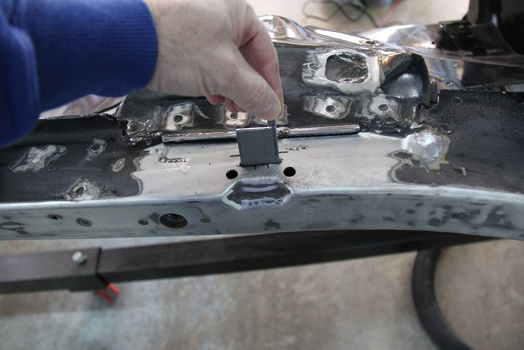

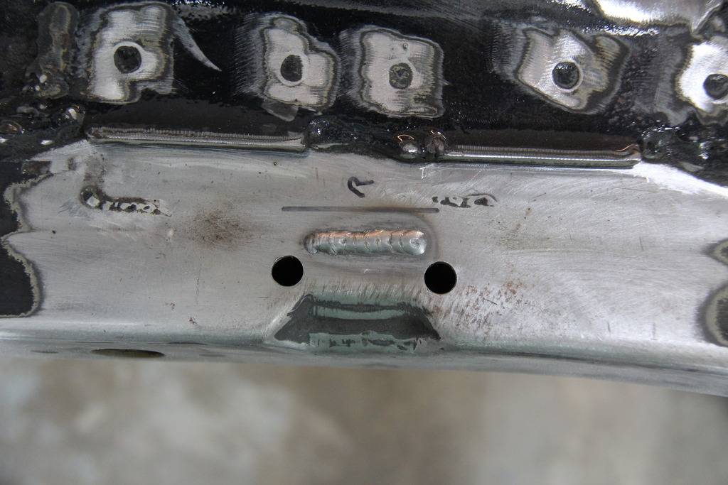

      The RMS suspension requires a few holes drill through the frame and they tell you not to over tighten these bolts so you don’t collapse the frame. So I welded in 2 reinforcements to help prevent that from happening. The 1/8” plate is welded on both sides.
      Thanks
      Pat

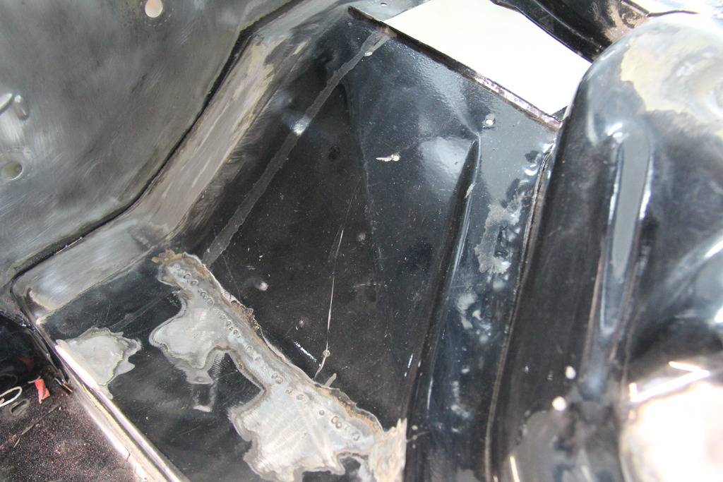

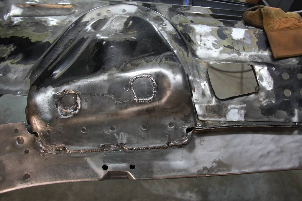

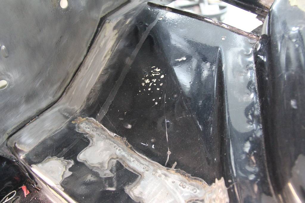

      I started filling all of the unused holes in the engine well and have the left inner fender and core support finished, so far over 50 holes.
      Thanks
      Pat

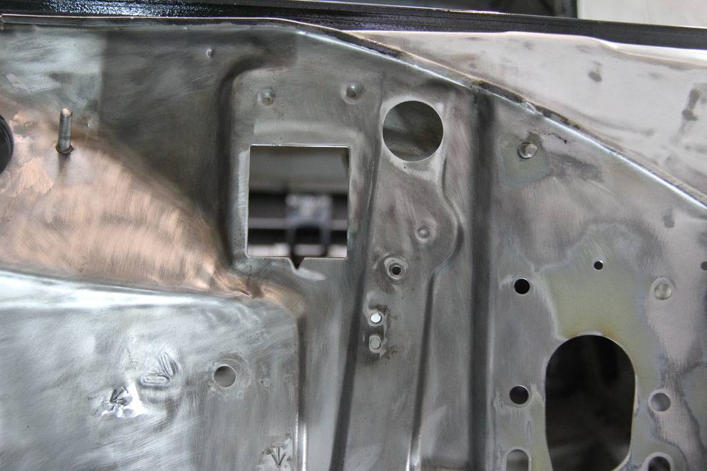

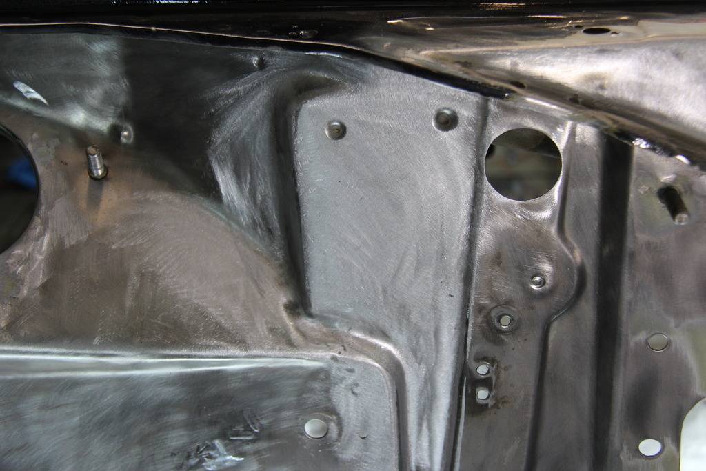

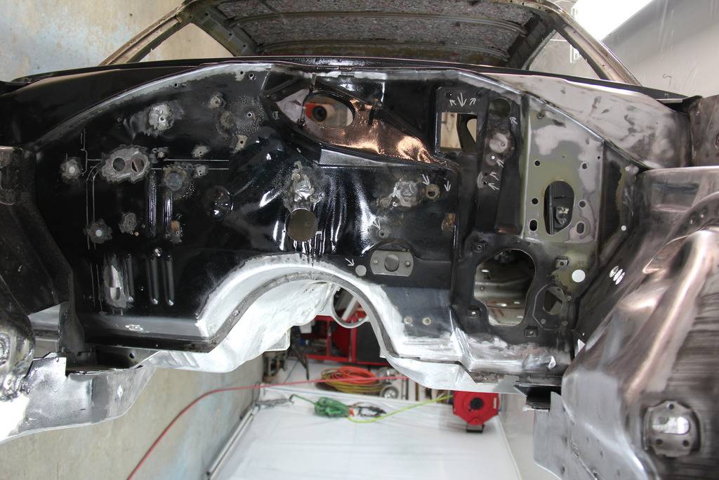

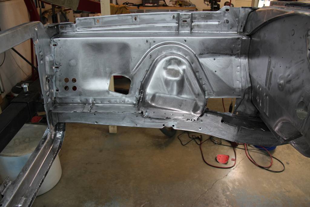

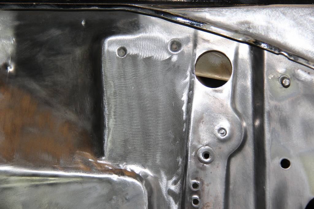

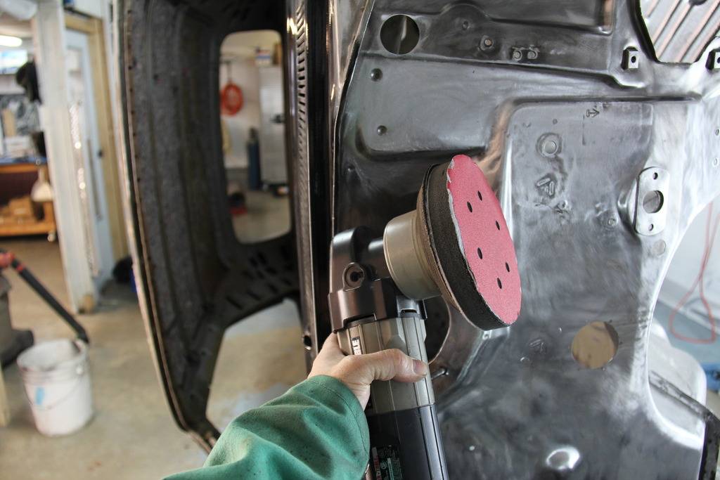

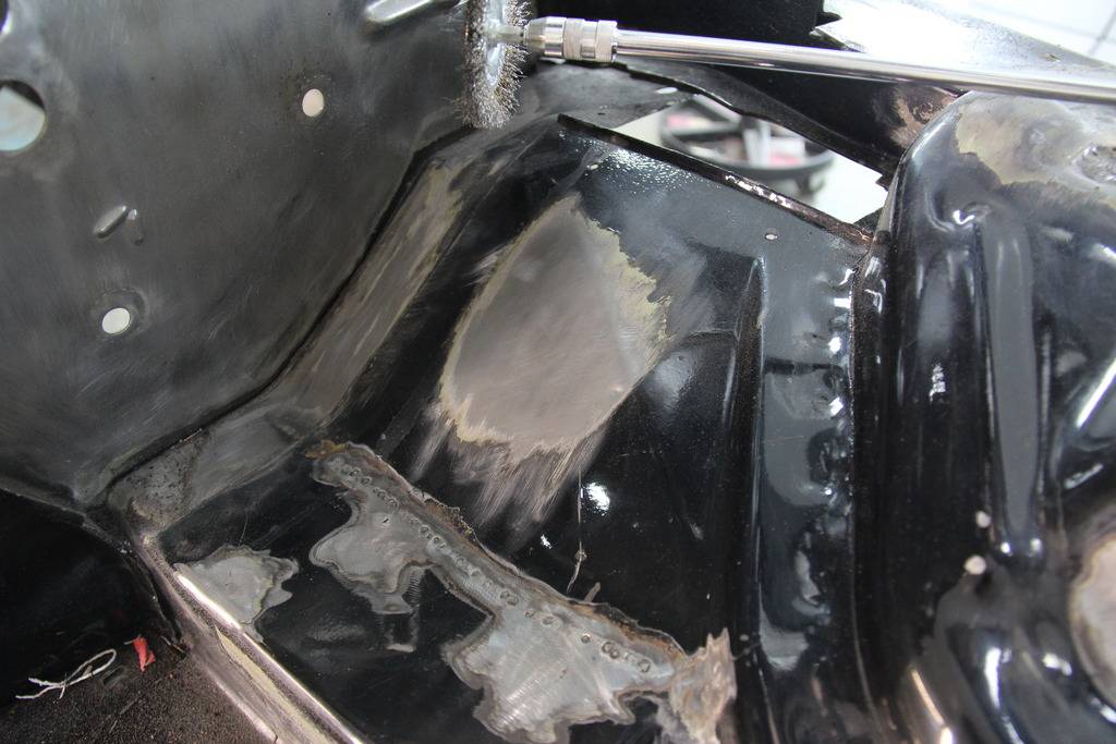

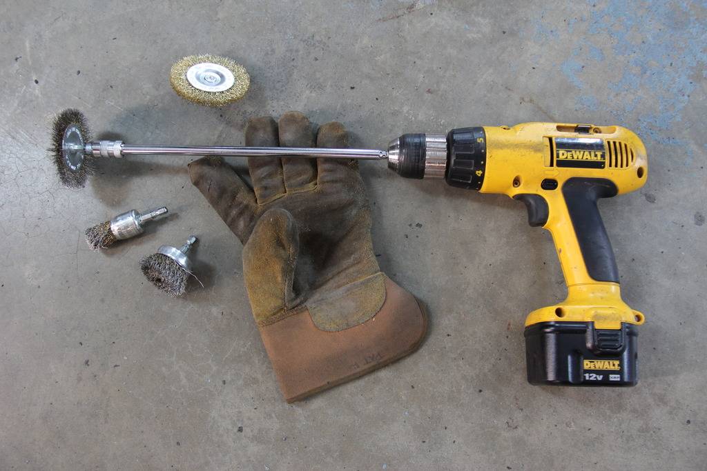

      I’ve had a few people ask how I remove the paint, clean the metal and finish off the welds, so I thought I do little right up and some pictures on what has worked for me.

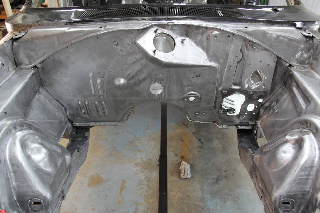

      In the engine bay I have found a heat gun and wirewheel on a drill works great removing the paint and original primer from all the nooks and crannies. I like using a 12” quick change extension to hold the wire wheels. The advantage of the drill over a grinder is you can change the direction of the drill which allows the wirewheel to work more aggressively remove the paint and primer. With the heat gun I blister about 6”x6” of paint and while it is still hot I use the wirewheel to remove that section of paint, it goes quick and no fine dust.

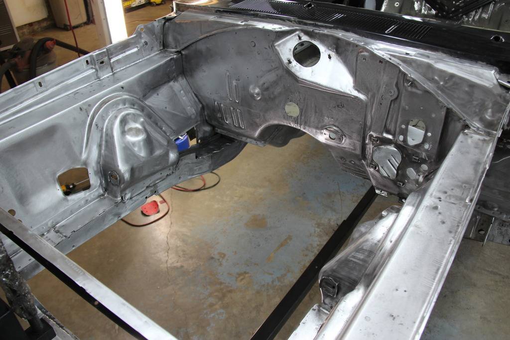

      Here is a before and after of the firewall using only the heat gun and wirewheel.

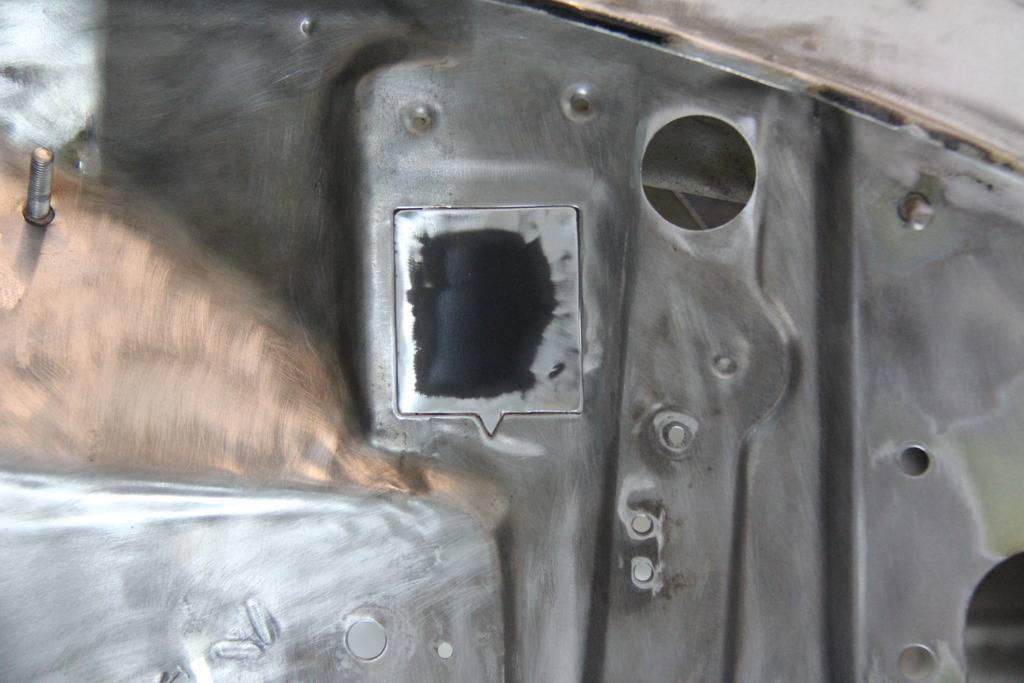

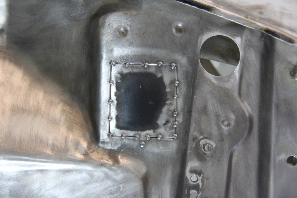

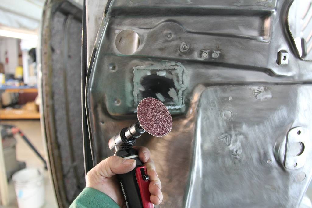

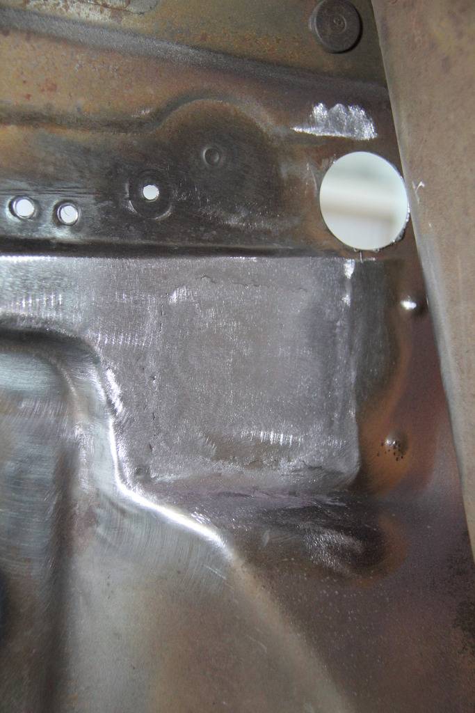

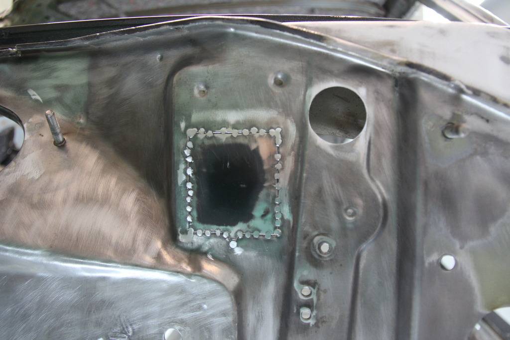

      Here I’m welding over the wire harness plug hole. After tack welding the cover in place I grind down most of the welds before finishing the welding, this helps keep the heat down and make it easier to connect the weld as thickness of the metal is similar to the welds.

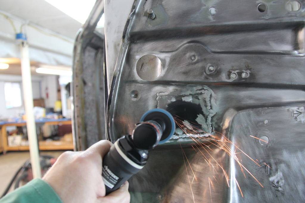

      I like to use a 90 degree Die grinder with 2” 36 grit disc to take the welds down. Keep it moving and always use new disc when working small areas as worn disc will just heat the metal instead of cutting the weld down. When the welds are mostly cut down you can hammer and dolly the panel flat and then finish off the leftover weld with a 60 grit disc.
      Note before hammer and dolly the panel you will need to grind down the weld on the back side!
      The last thing I do is use a 6” random orbital sander with a ¾” foam pad and 100 grit paper to clean the metal.

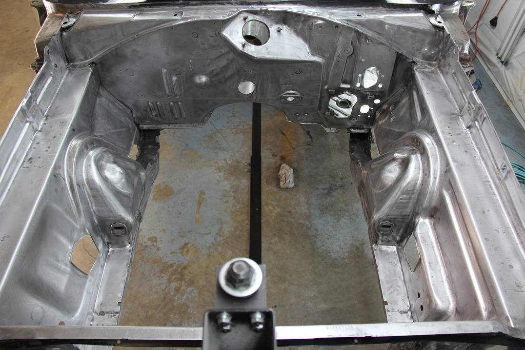

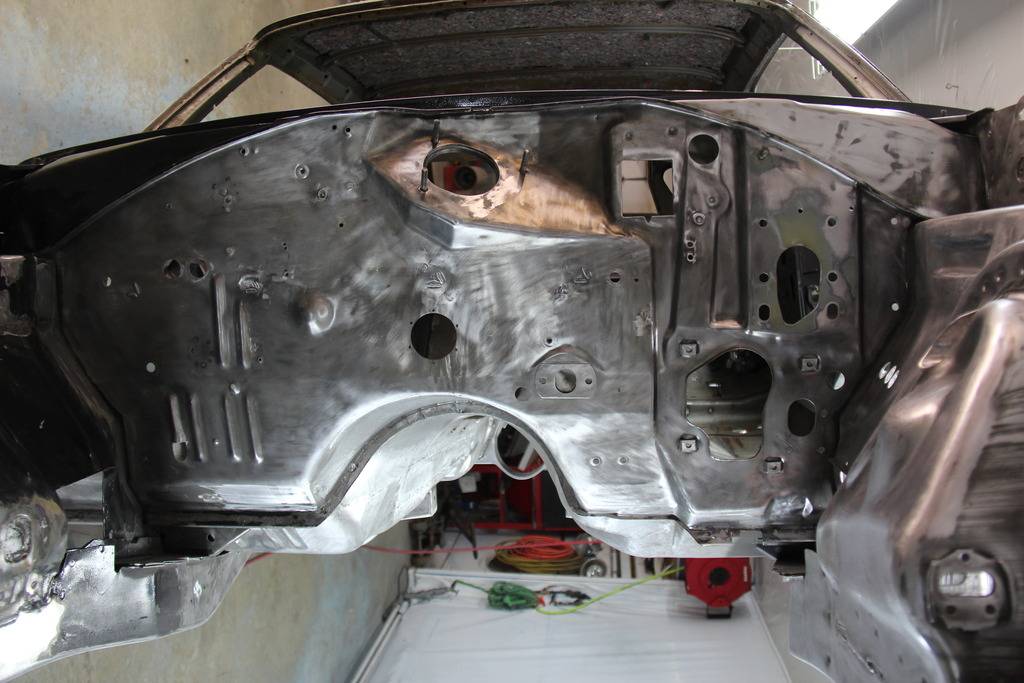

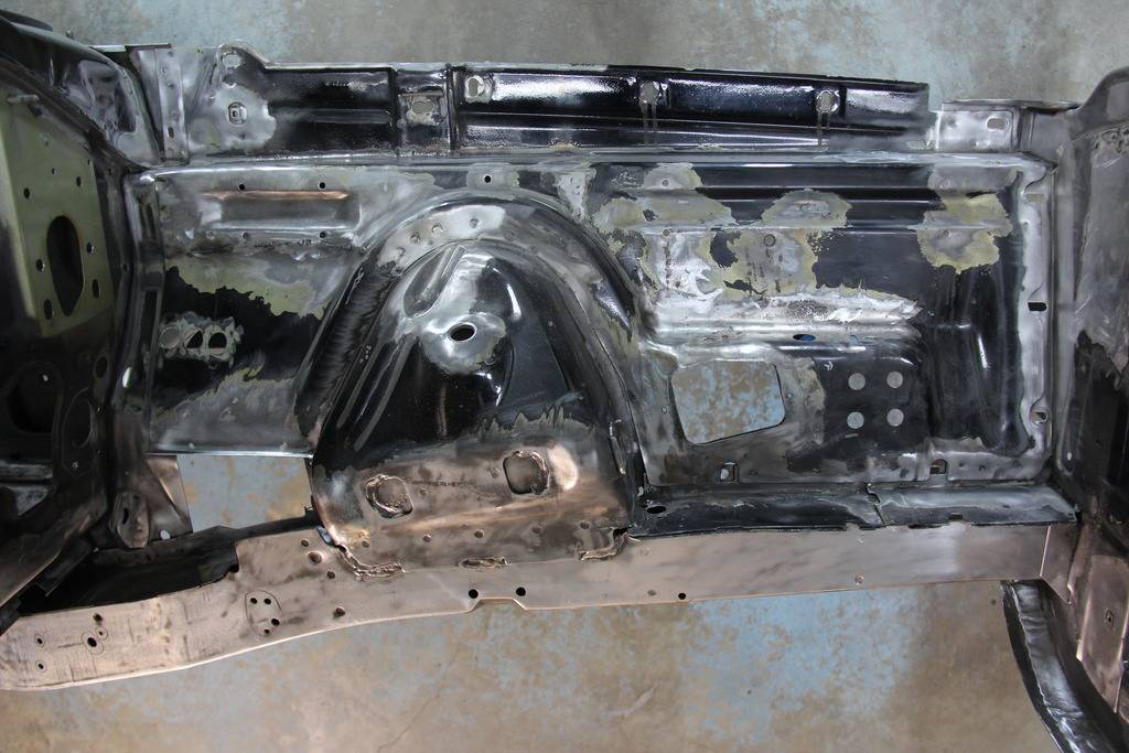

      The paint is removed and all the unused holes are welded up in the engine bay and ready for epoxy primer.
      Thanks
      Pat
