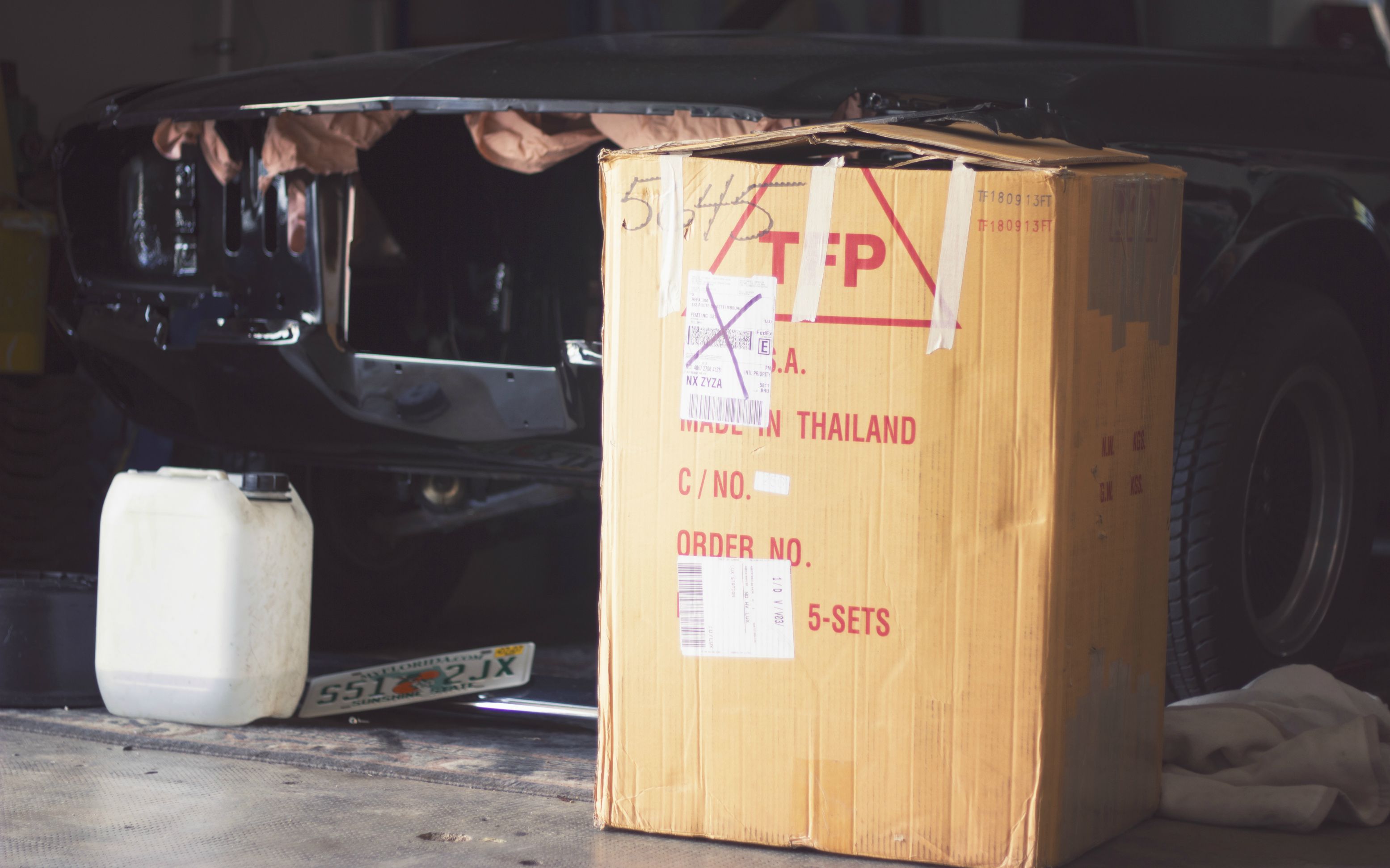

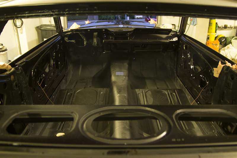

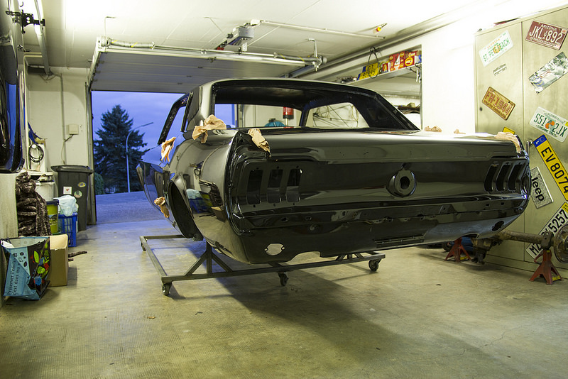

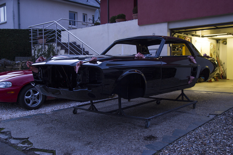

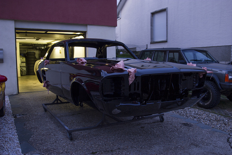

      Almost a month ago the car came back from the paintjob, I was stunned by the result.
      Yesterday I took the car out of the garage to start working on the front and to see how the color looks in daylight!

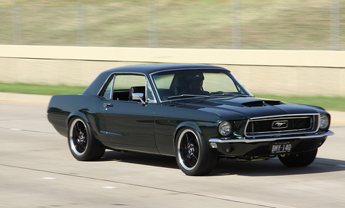

      That black paint is stunning. I have the same wheel tire combo as outrgus...only a little lower.

      Thanks dude, tell me, how did you get yours that low? what components did you use?

      The suspension is all Global West. I dearched the rear leafs 2" and cut 1 full coil off the 620# springs.

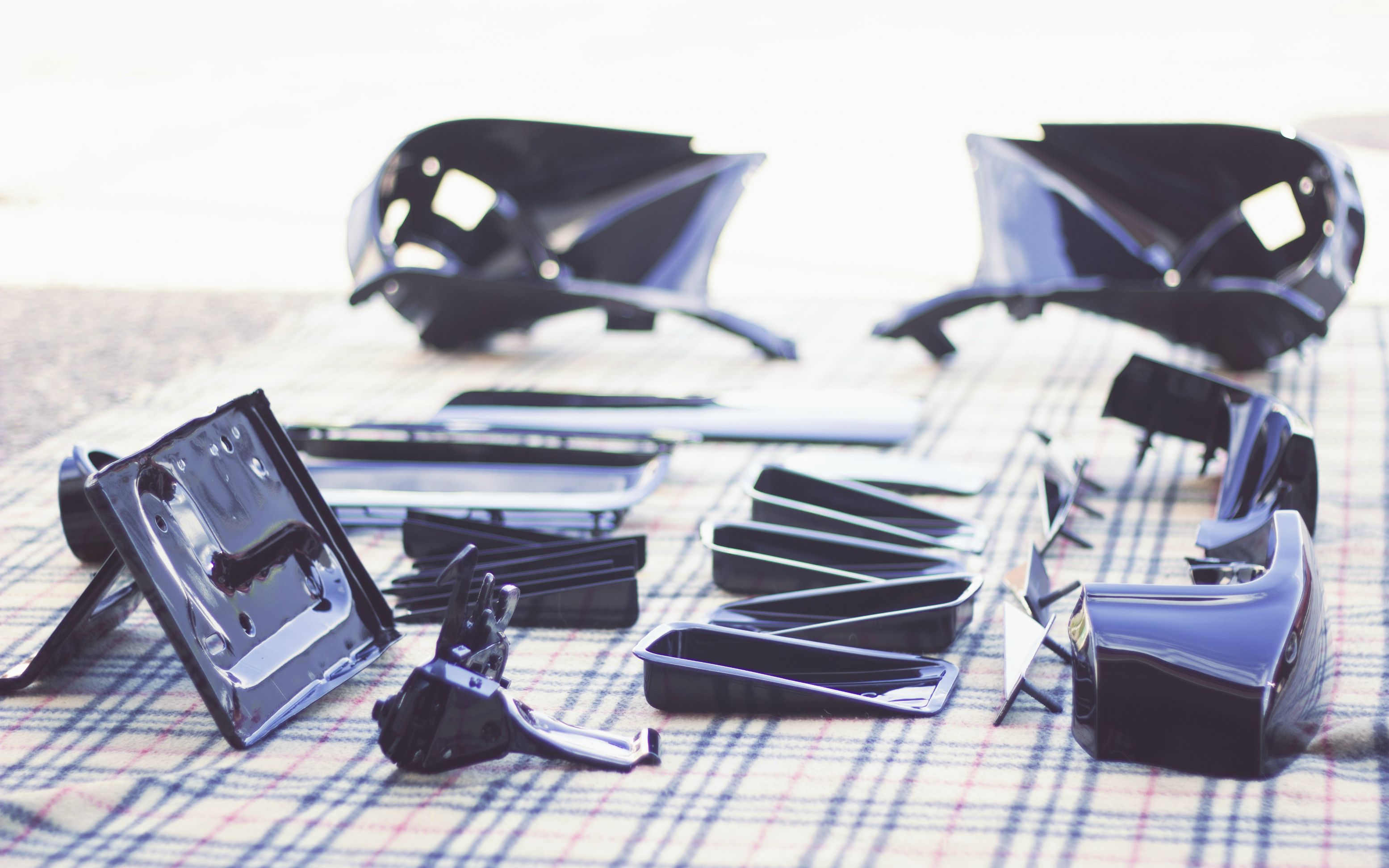

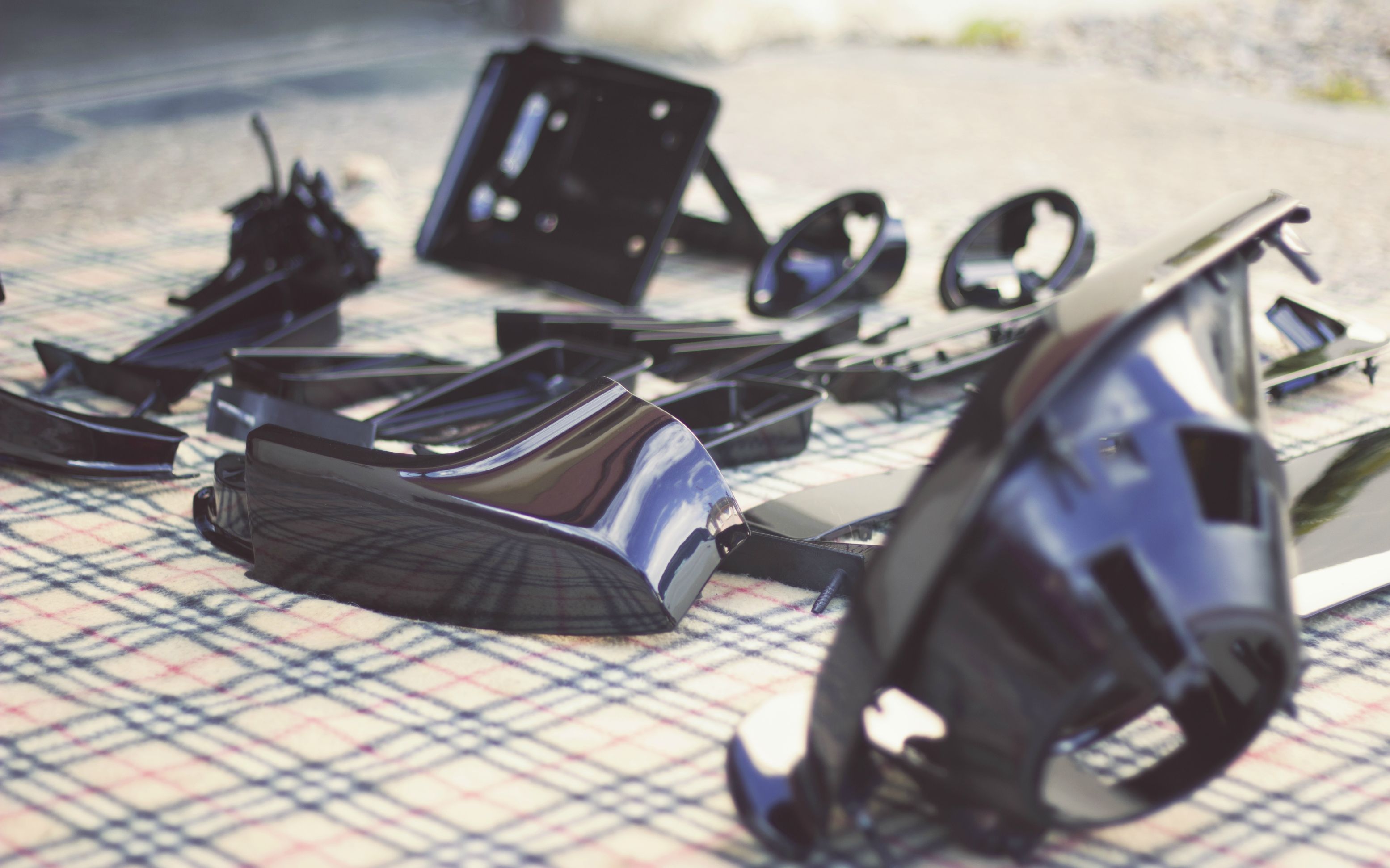

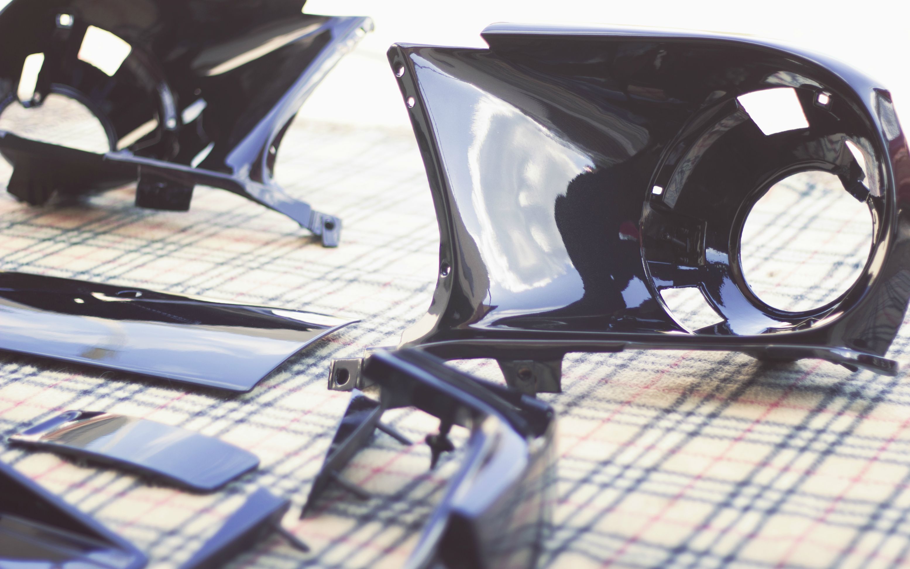

      Lots of parts came back from the paintshop today, they came out great!

      Very nice work! Alot of nice cars on this thread!

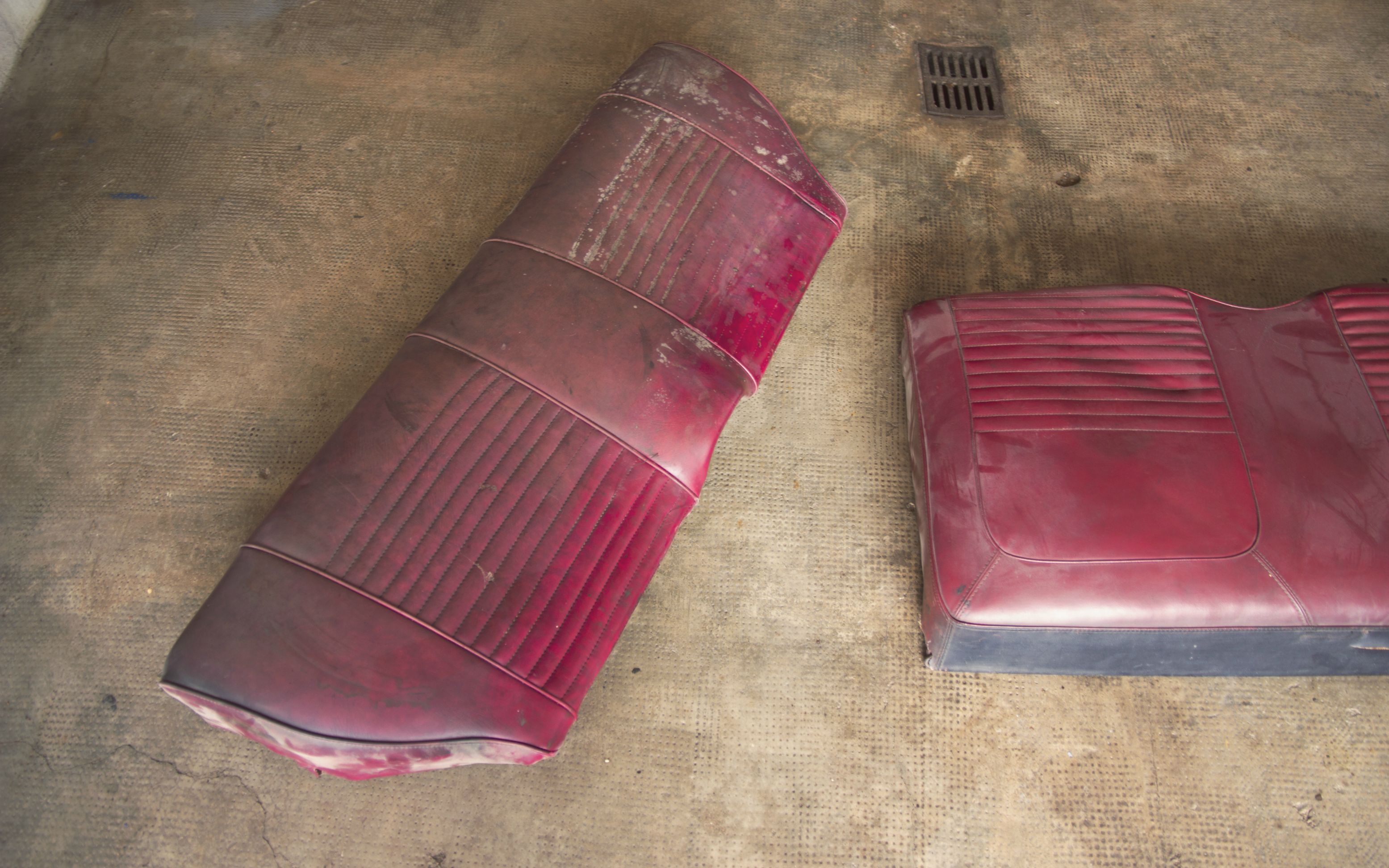

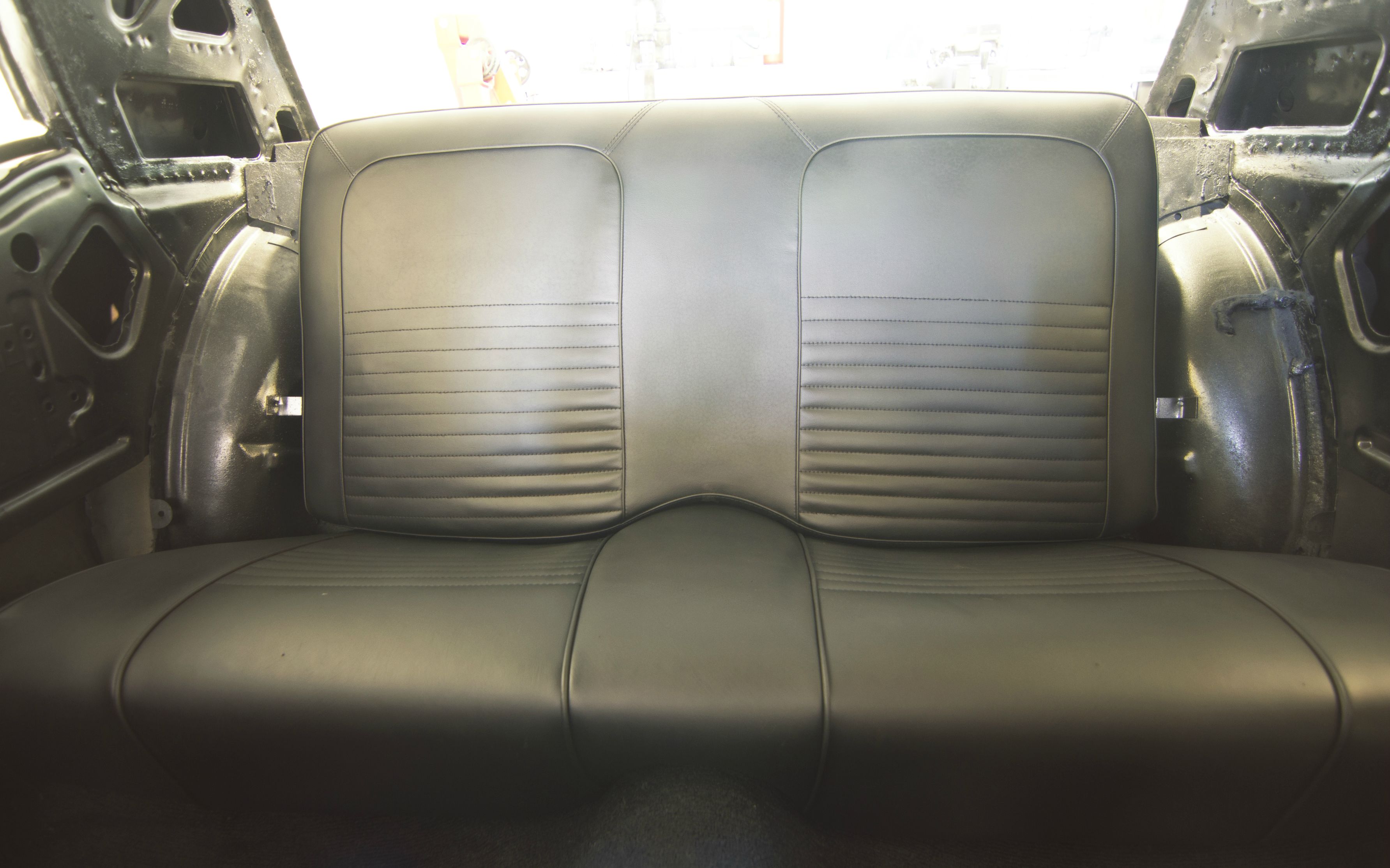

      Since the interior was red and I want to spend least money possible, I recovered the old back seats. I am stunned how it came out!

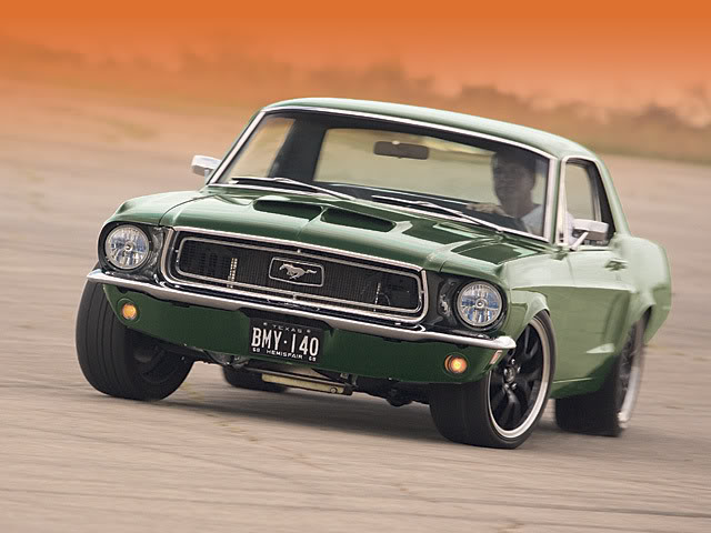

      Looks great! Looks like you've done a lot of quality work and started your project off right.
      Take a look at some of the other mustang project threads on this forum! A lot of really great inspiration for you. kmcanally's car is one of my personal favorite mustangs I've ever see.

      That action shot of my car was from PHR...they Photoshopped the color to make it look more green than it really was. I was a little disappointed when I saw it in the magazine. Not sure why they wanted it to look like something it wasn't.

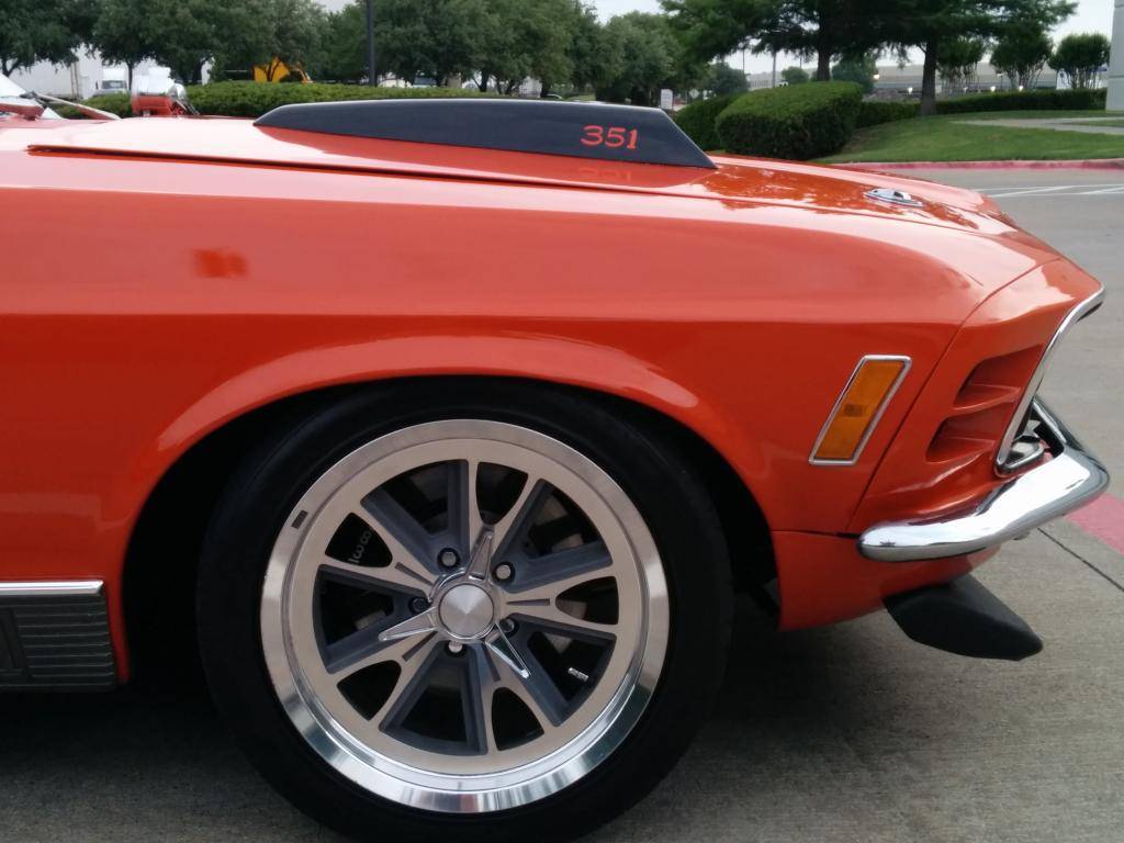

      Stance...
      I know mines a 70, but I went with TCP's Bolt in Coilovers up front... used to have 750lb springs cut 2 coils...got about the same ride height now with out the stiffness of about 1100 lbs spring.. Got 5 leaf reverse eye in the back and will be putting in the TCP 4 Link setup soon...
