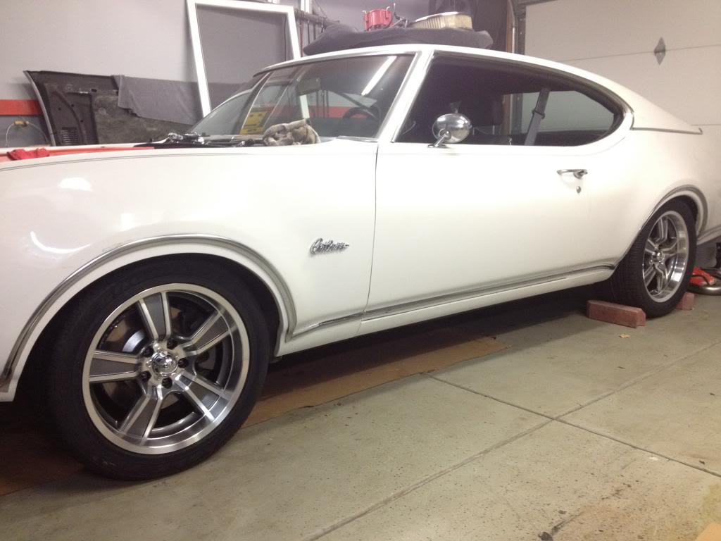

      Let's see a few pictures of your project!
      Here is my 1969 Cutlass. I need to get out and take some better shots.
      Nick ~
      1969 Cutlass

      Oh, and I vote keep it Olds powered.
      I'm running a 355 SBO with Edelbrock heads, Erson roller cam, stock crank/rods, EZ-EFI and MSD ignition. 5-speed RS600 trans, 3.90 gears and 18x9" wheels front and rear, SC&C front suspension, C5 brakes... etc.
      Are you planning on keeping it automatic, or changing to stick?
      Nick ~
      1969 Cutlass
      Mar 2012
      4
      1969 oldsmobile cutlass ideas **help!**
      I dont have any pictures currently but ill try to get some up sometime soon. Im going to keep it automatic and after thinking about it probably stick with the 455 for now
