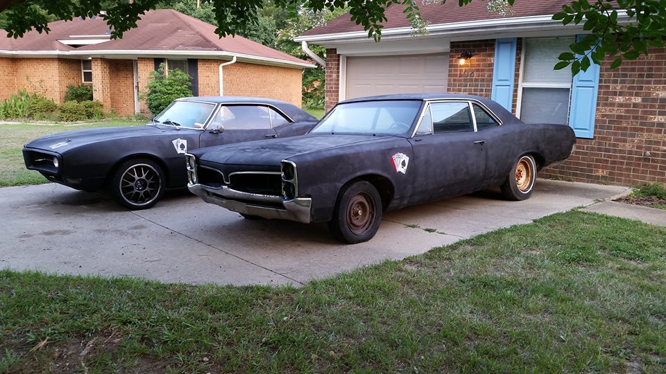

      ordered a set of 275/35/18 tires for the back of this and painted the sucker flat black. also ordered a new 20 gallon fuel tank and got a passenger side headlight bezel. SOON it will be on the road. of course it'll take years to do the bodywork, but hey so be it.
      also came up with the theme i'm going with... wild bill hitchkock's "dead mans hand" black aces and eights with a mystery 5th card.
