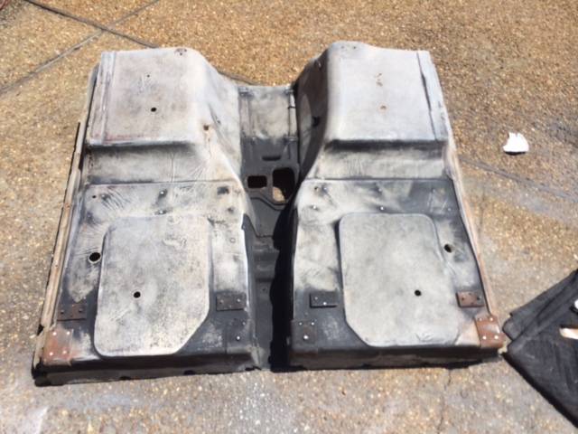

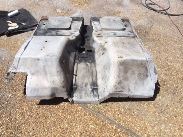

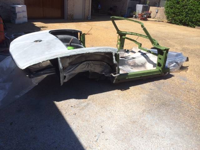

      She has a floor and part of an arse again.

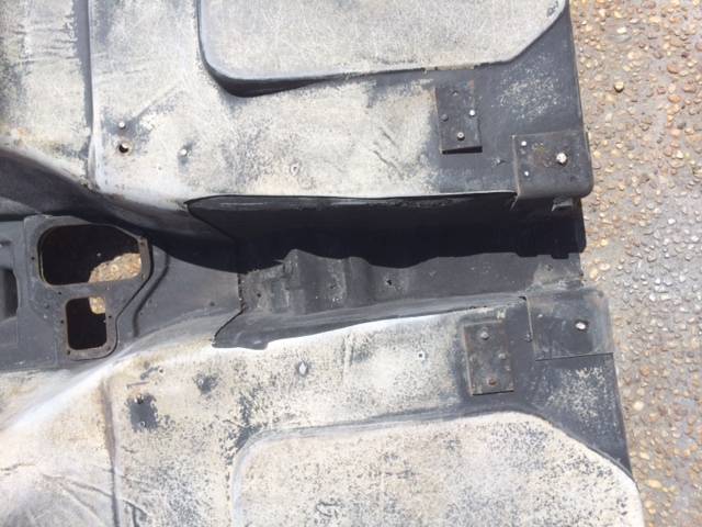

      I sanded all the garbage and paint off the tub and rear this past weekend.
      The driveshaft tunnel was cut out and replaced with a later piece of fiberglass to utilize a 67 style e brake.

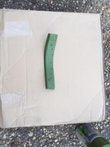

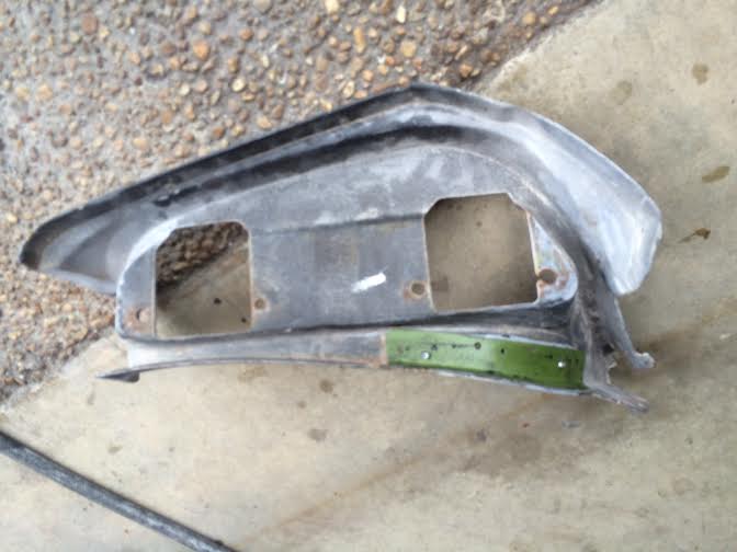

      Not much to show, but I did recondition the reinforcement plate that goes behind the hinge pillar fiberglass on the passenger side. This little piece is what the rivets for the sides of the dash go into.

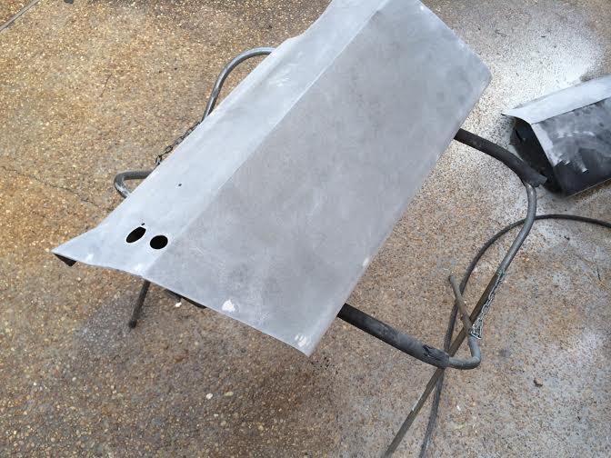

      I also stripped the passenger door. The driver's door had a very large crack that had a poor repair and it might just be cheaper to replace it than to try to fix it. This door is definitely from a 65 and so is the hinge pillar and sill fiberglass. Every part is different, some from a 63, some from a 64, some from a 65, and I found one piece from a 67. This poor car must have been in some sort of bad accident and then pieced together from a pile of fiberglass leftovers. Or, it was parted out long ago, then rusted, then pieced back together with random parts. Who knows...

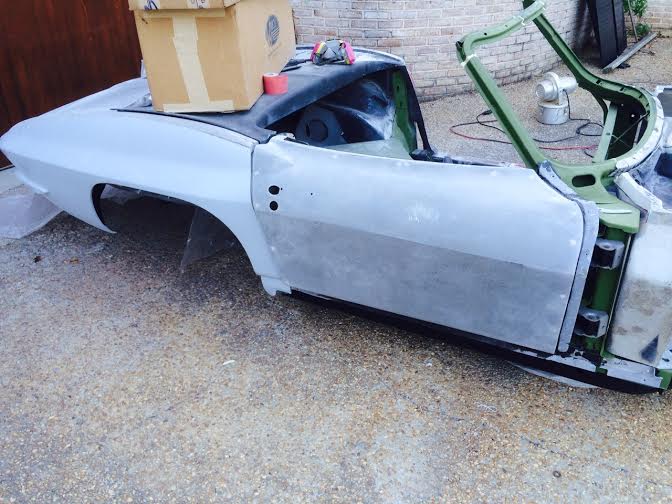

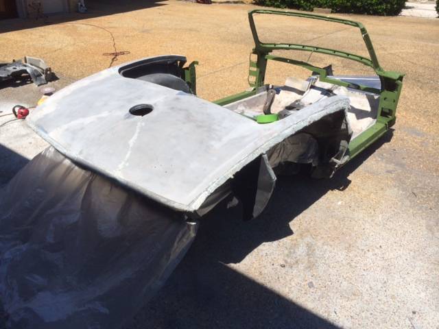

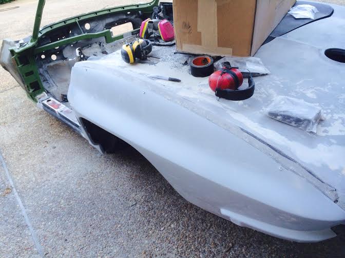

      I dry fit her new fat hips. lots of work still to do before bonding them in place, but making some progress.

      The GTS quarters are 1-1.5" wider and yes, the rear wheel wells will be moved inward and then notched for the soft top. If i go with the winters quick change rear with c6 suspension, i can run up to 345mm wide tire.

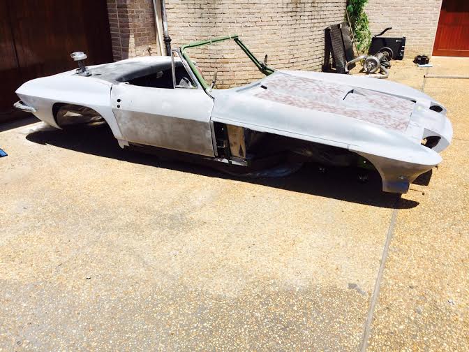

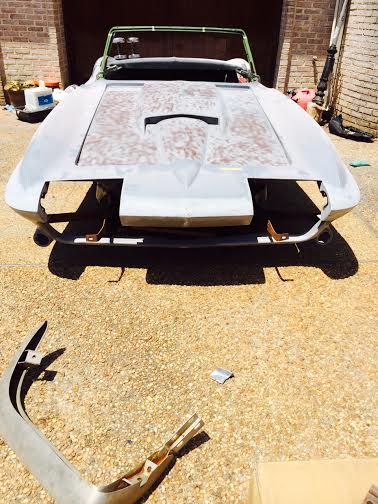

      More dry fitting. It's slowly starting to resemble a car again. Im now waiting on the taillamp panel, inner skirts, and 67 side panels to arrive.
