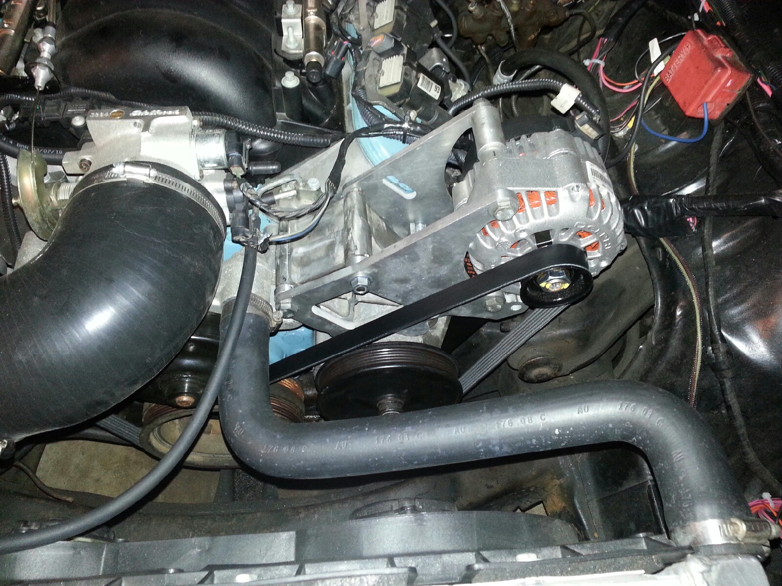

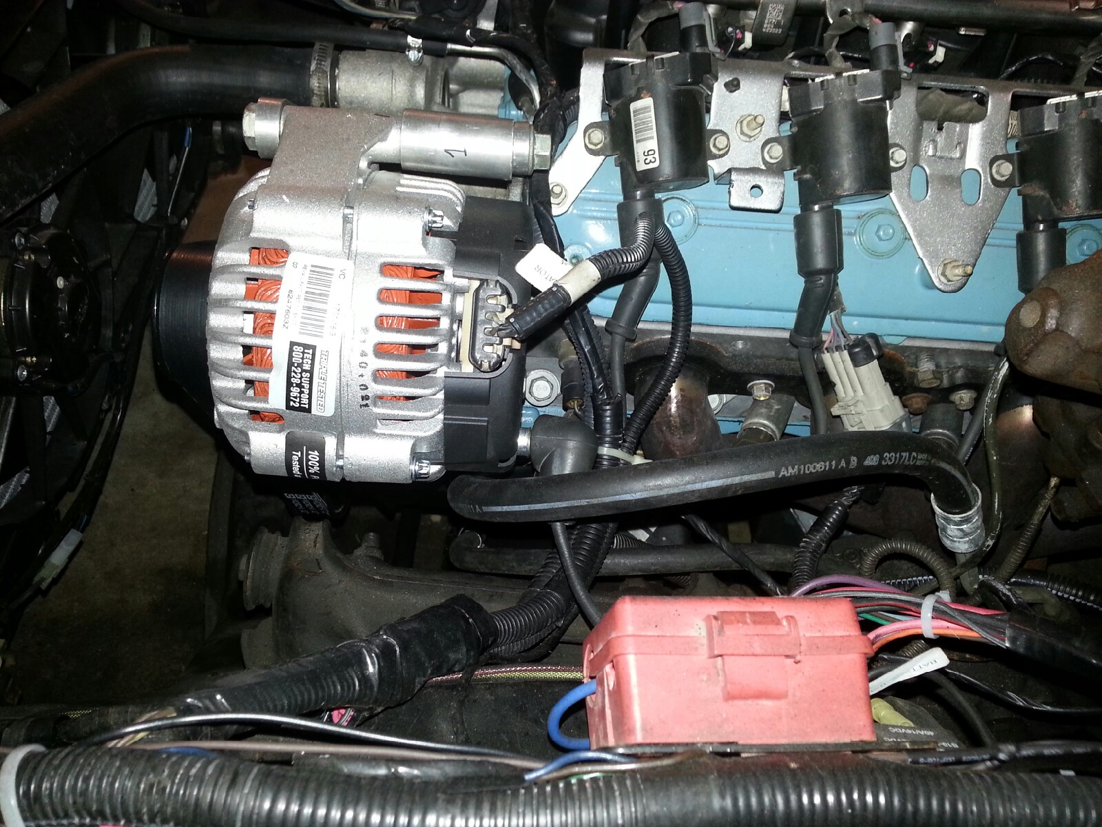

      wow sweet build! looks great. thanks for the advice also. I was mainly interested in the manifold i listed above because i used the kwik truck ALT bracket and milled down the truck aluminum p/s bracket to be retained. This doesnt allow me to run an exhaust tube forward on the drivers side. so i planned to do like a truck stlye turbo manifold set up. I well attach pic to give ya a better idea of what i am talking about. This was done on a very strict budget. Hey also what intercooler did you use. Id like to do a water to air cooler but cant seem to find one to fit.

      Here is a few pics of my set up. A little ghetto but it works and it was cheapest option at the time. This is why I was wanting to look into the truck style turbo set up.

      Is that a high mount ps and alternator bracket ? what brand? kit looks nice, is similar what i have done...

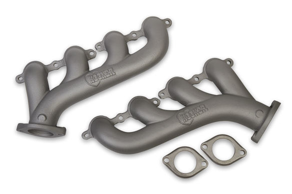

      We have been itching to try a set of these on a build.Name:  8501-5hkr[583x].jpg

      Those may work nice. I wonder how they would work facing forward either pointed up or down.

      567
      Quote Originally Posted by DButler View Post
      Are these manifolds built to point downward or can they be made to turn upward?
      There are so many GM manifolds and they easily cut and weld. Anything is possible.
      I honestly don't know what issues will occur. We haven't gotten a build to try them yet.
