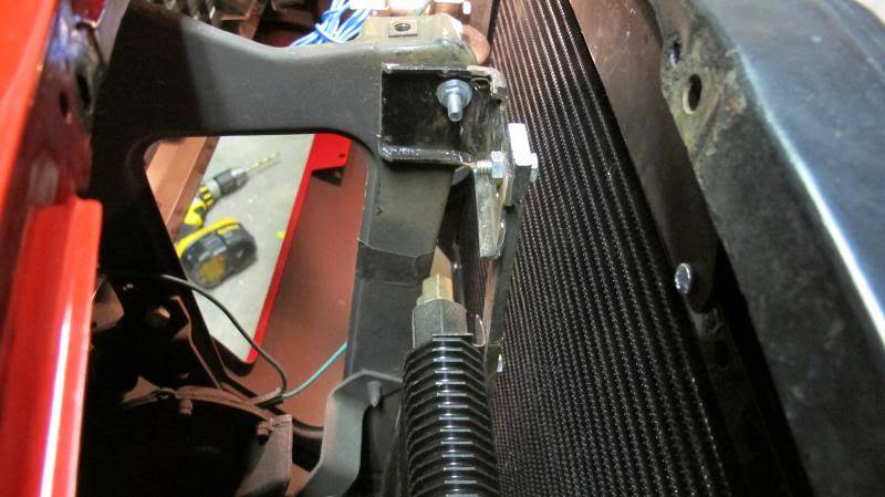

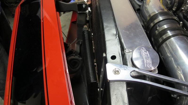

      I mounted mine on the driver side in front of the radiator as shown below.

      Thank you! About the only area it will fit in. Do you have any close ups of how you mounted it? Also I am not sure but is it recommended that you mount the cooler with the fittings pointing up like that? I thought it was a no no

      I can get you some closeup pics later. I mounted the trans cooler per B&M's recommendation, http://www.catalograck.com/ImgVD/BMA/9500835-00.pdf
      77
      I remember you couldn't mount it one specific way, I guess it's with the inlets/outlets pointing down. Thank you

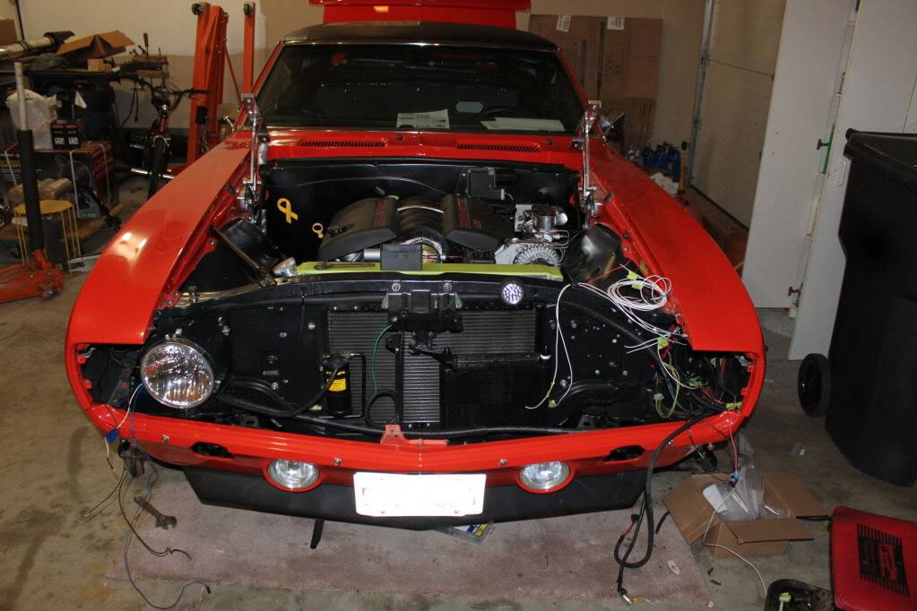

      Hey there,
      B&M says pointed up or to the sides.
      Here's a preliminary mock up of mine in process on my 69RS. I just need to square it out and and add some additional support. Plenty of room with the grill on too.

      Thanks Kurt. We got as far as removing the blower motor old heater core cover last night. We should be getting to this area in the next day or so. Looks like a possibility just wondering about the sturdiness of this spot while still keeping it looking clean after adding some more support.. Interesting though thank you.

      Like i stated, this is a preliminary mock-up and not finalized but I have all sorts of room.
      I'm pondering a couple of bracketing ideas for the side that is not supported in these pics. With the remainder bracketing ideas I'm playing with, it is hella sturdy.
