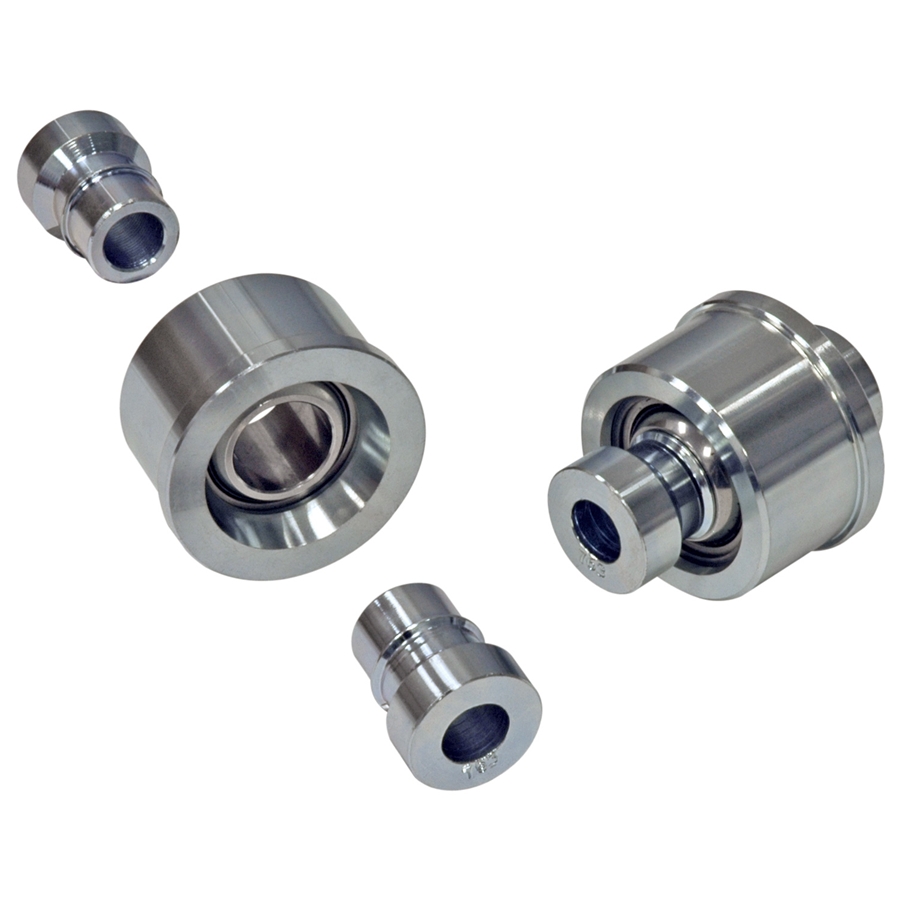

      Anyone have link or suggestions on how to remove and replace the upper bushing on the rear end on an A-Body?

      We just did a set yesterday. They were poly so the inner part just pressed right out after pressing the sleeve out (use a deep socket with a rib, like 3/8 or 7/16). Then we sliced the shell with a muffler tool and tapped the flanges in to relieve pressure.
      With stock rubber, you can drill through the rubber in a few places to get the rubber piece out. Then proceed accordingly.
      There are a few tools out there but they're $50+ and we like to do things the hard way.
      Installation was much easier as we simply slid one of our new Roto-Joints in there and spun the clip on.

      Ordered ridetech level 2 kit and looking forward to install. Need to replace the dog ear bushings since they are still the rubbers ones. Was thinking about these and wanted anyone thoughts and feeling. Overkill or just go with poly ones. Not looking forward to their removal but got some suggestions on removal of them. http://www.cachassisworks.com/p-1488...-bearings.aspx
