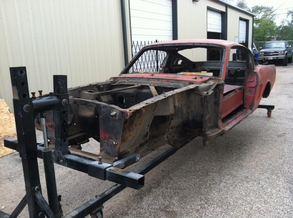

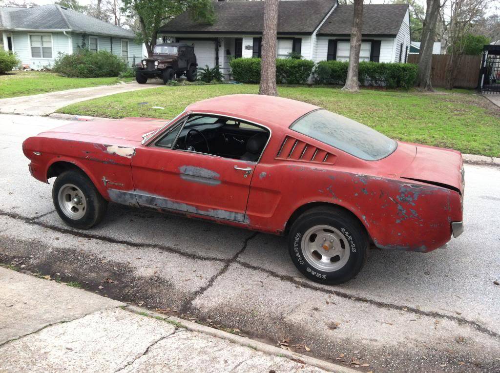

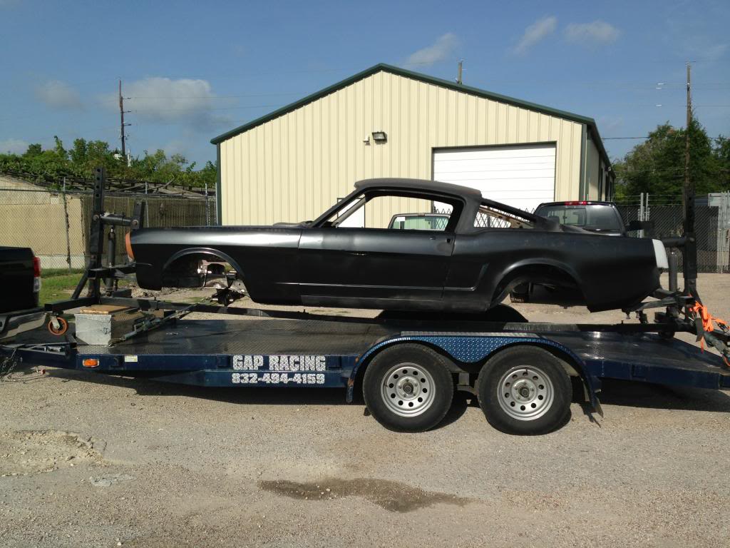

      Here is the project the day we picked it up

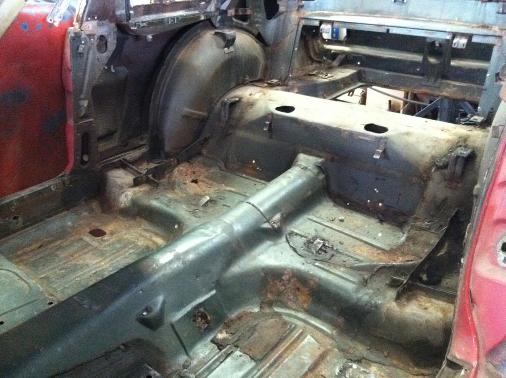

      So as we started to do the tear down, we realized the car was in need of a lot of sheet metal.

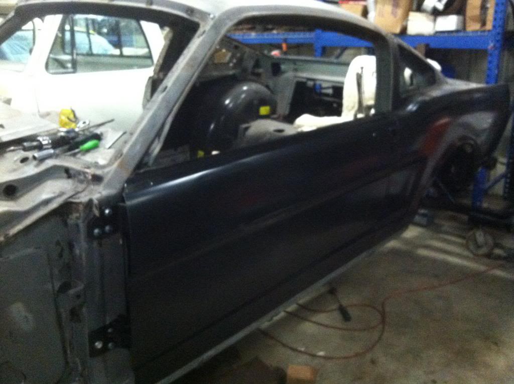

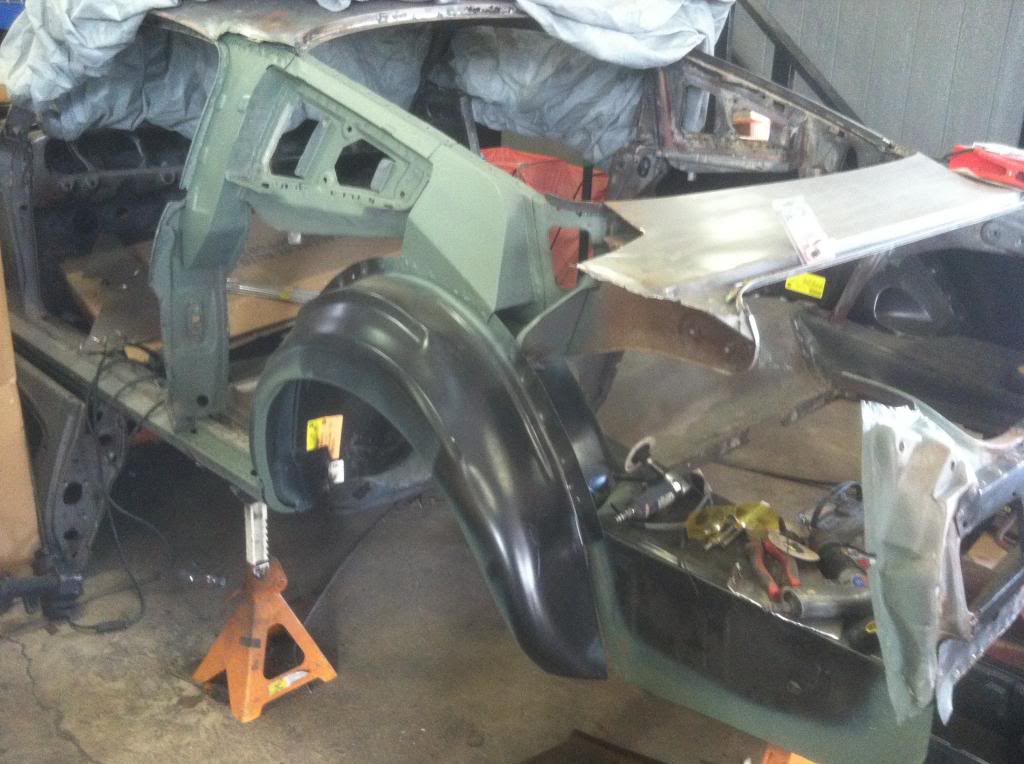

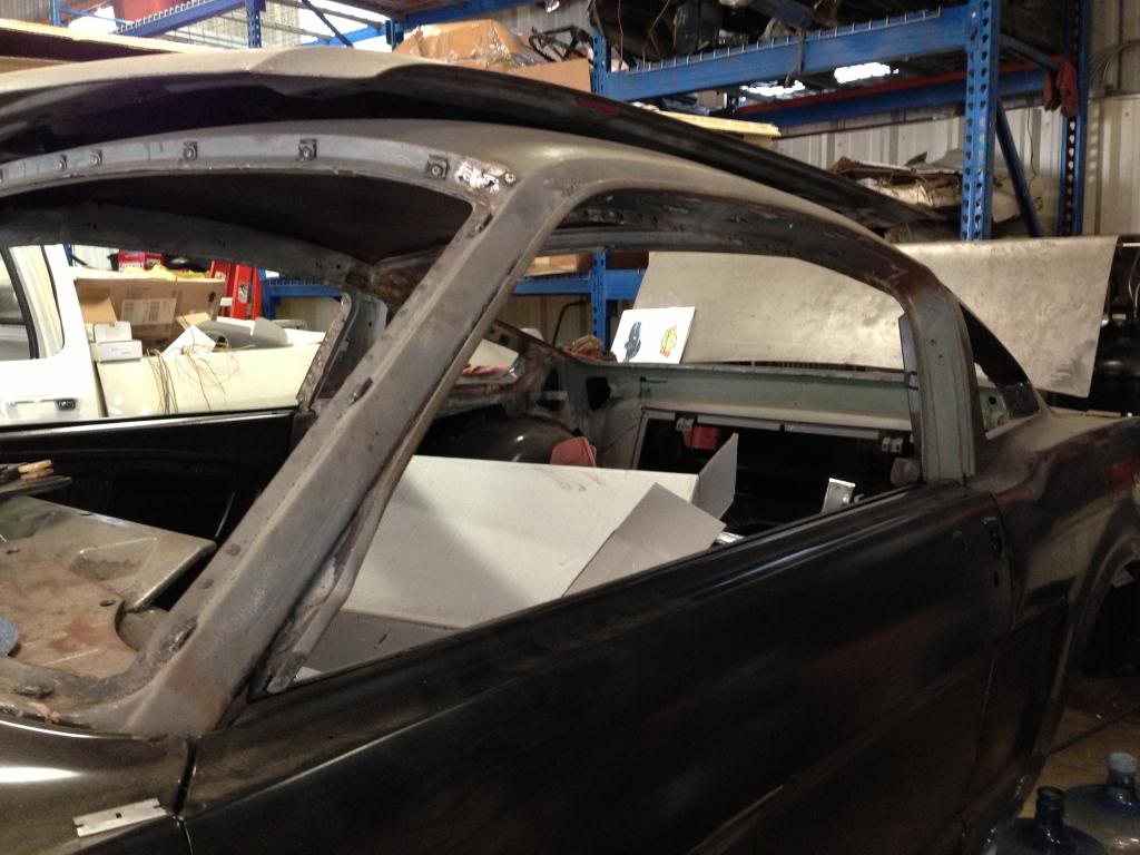

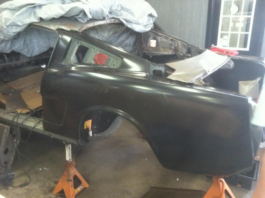

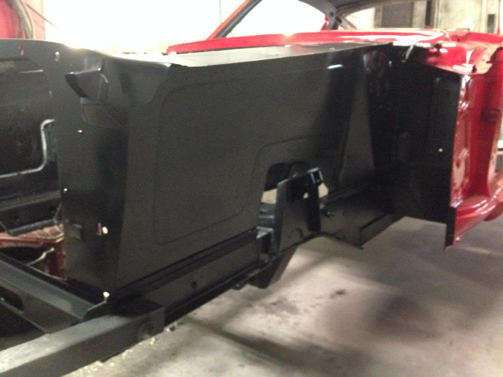

      When we got it back to the shop, we started replacing the inner tubs with a wider version, new Quarters, Floors, Trunk, Doors, Fenders, pretty much most of the sheet metal was replaced

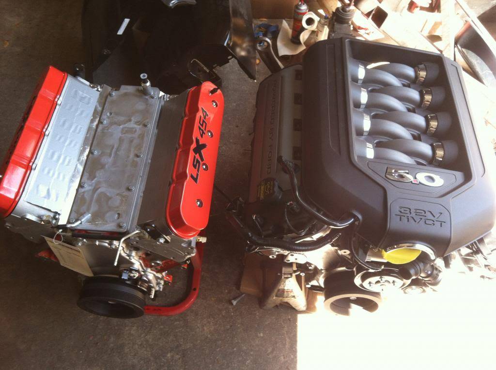

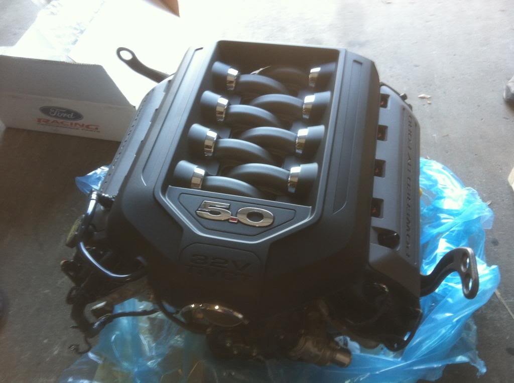

      The new power plant arrived
      Gives you an idea of how large this little motor really is

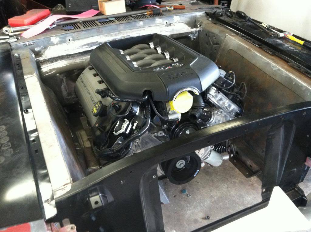

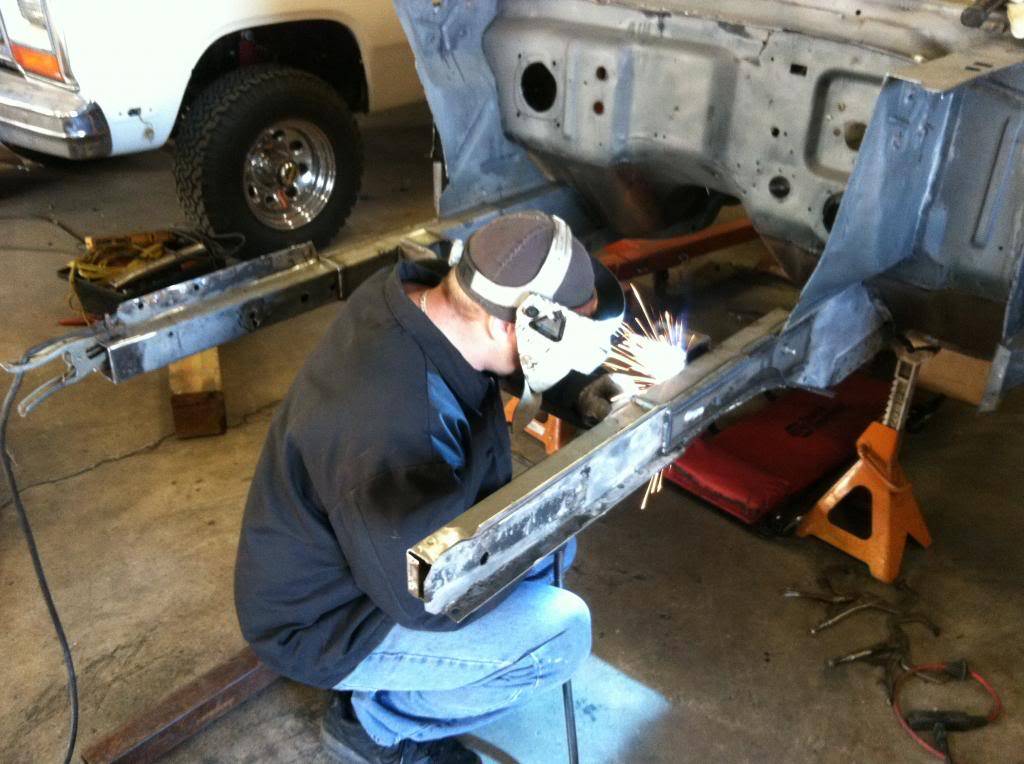

      Both shock towers and the entire front inner fender area was destroyed. It had been in an accident and the repair was horrible. We cut it all out of the way and started installing the TCI front suspension
      Test fit the engine
      Started fabricating some better looking panels to clean up the engine bay area
      Then we installed the 5.0 with the 5 Speed. Then we ended up raising the trans tunnel

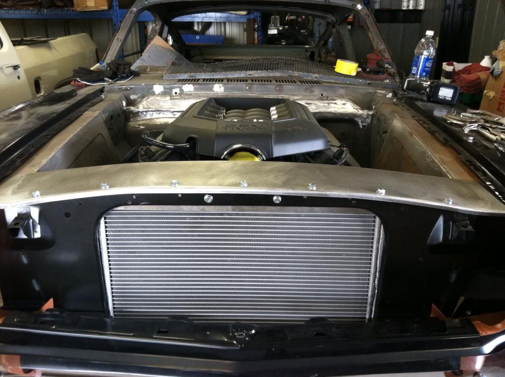

      Fabricated a radiator mount.
      And a cover to hide the Radiator, Cap, and Air intake. Also opened up the hole in the core support for the larger radiator.

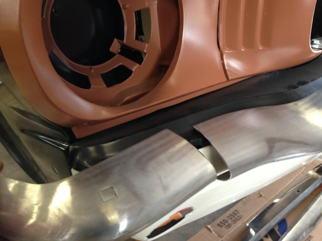

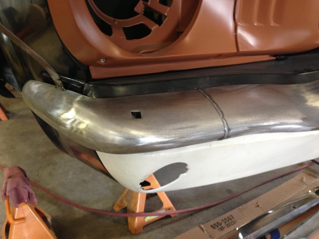

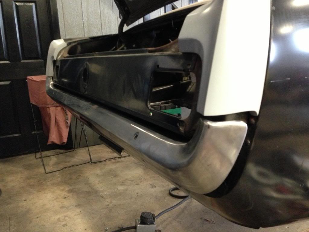

      Once all the sheet metal was lined out, we started hacking up the front bumper to make it fit tighter
      The rear bumper needed a lot of attention too
      Once they were trimmed and notched and re shaped, we took them off and welded all the holes up too

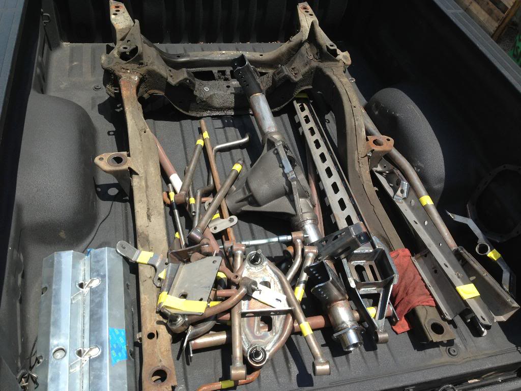

      Suspension stuff is headed out to the powder coater along with some Camaro pieces

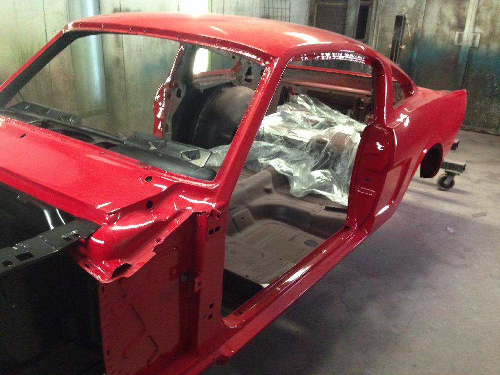

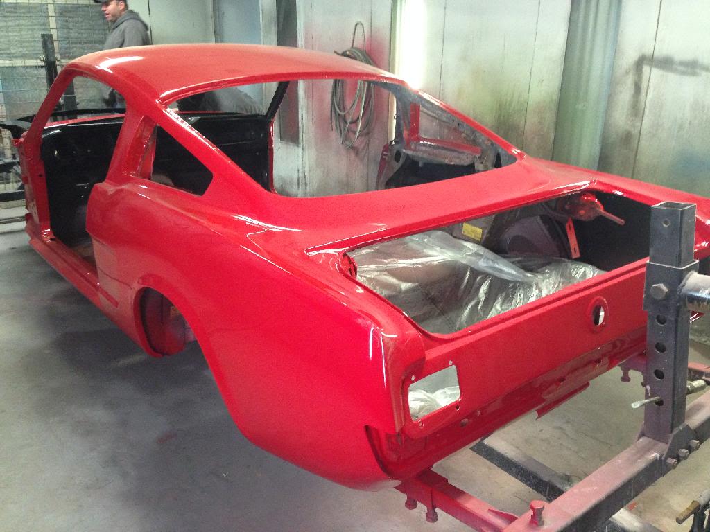

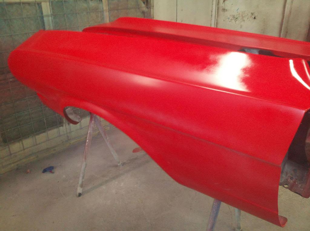

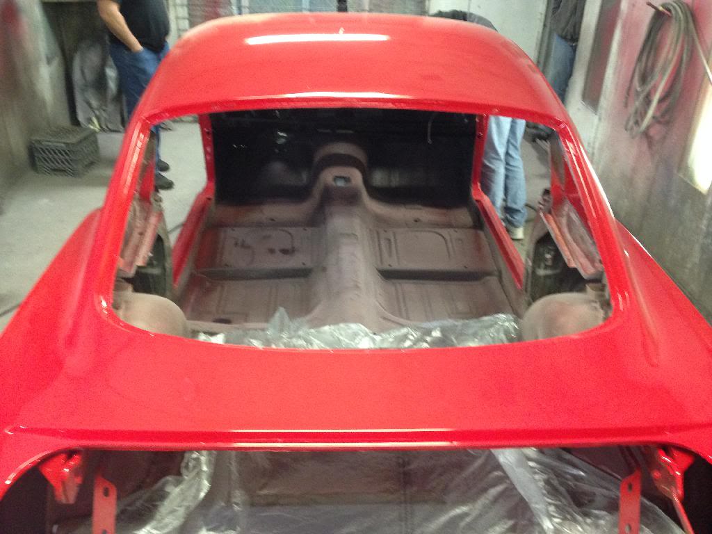

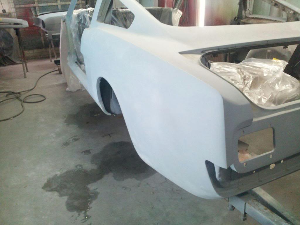

      Body Shop update. All the body work is done
      Customer ended up selecting a Nissan Redline Red

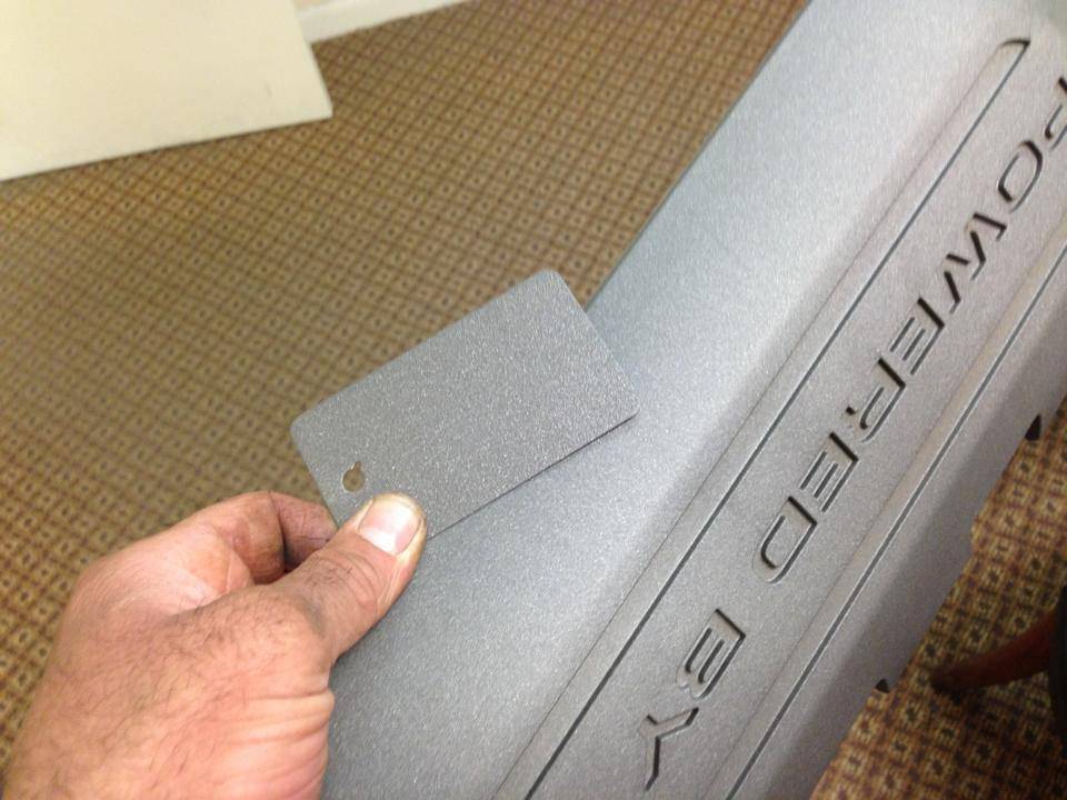

      We found a textured powder coat for the suspension that matched the Valve covers and intake

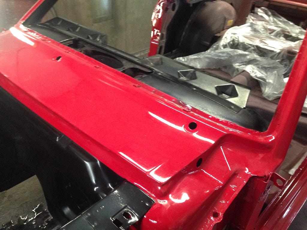

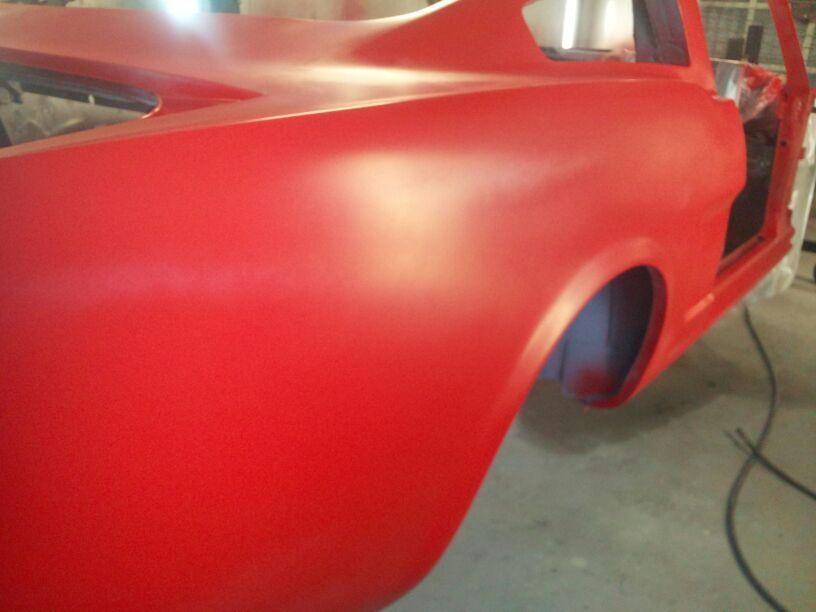

      Body shop update. Had to go out and look at the 68 Camaro they are doing for us. Here is the 65 Mustang. All that is left is to finish painting the engine bay, paint the bottom and wet sand and buff it out. Should not be long now.

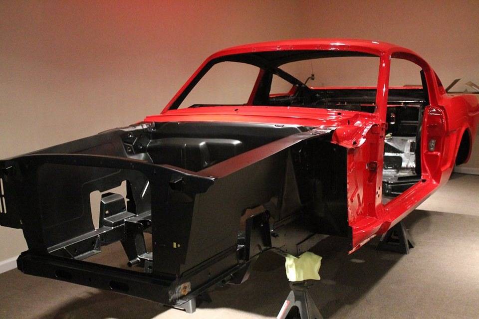

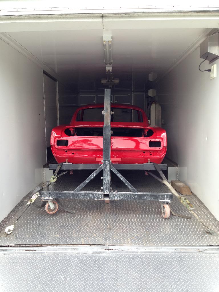

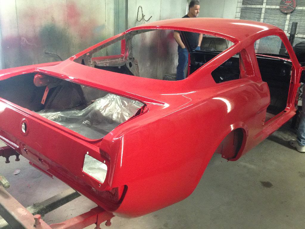

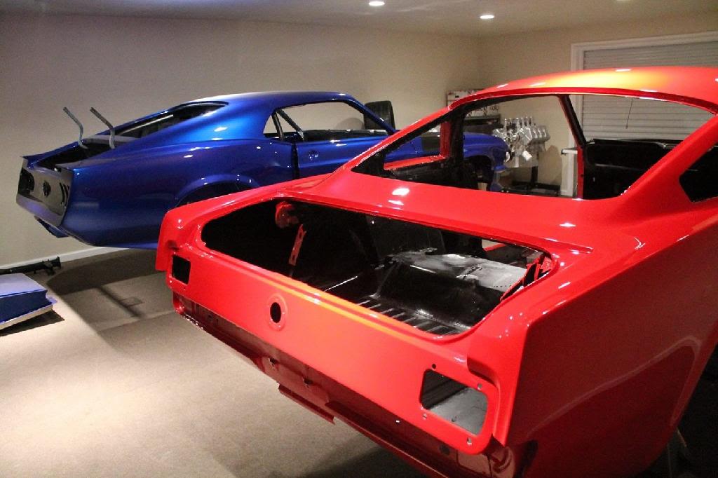

      After many months at the body shop, the project has been loaded up and is back in our clean room next to our Stampede project
      Motor is ready for installation
      And here is the shell back from paint

      What radiator did you use great project.
      Aug 2009
      Houston TX
      111
      Quote Originally Posted by Camberdually View Post
      I do not remember the exact part number. But I will find out

      Looks great. Curious though where is the fender tag? Some stangs have 3 locations some do not. Can you weld it in and it is still legal?
      Thanks and keep up the great work.
      M
      Aug 2009
      Houston TX
      111
      We cut it right before the ID number on the inner fenders. The number is still there
