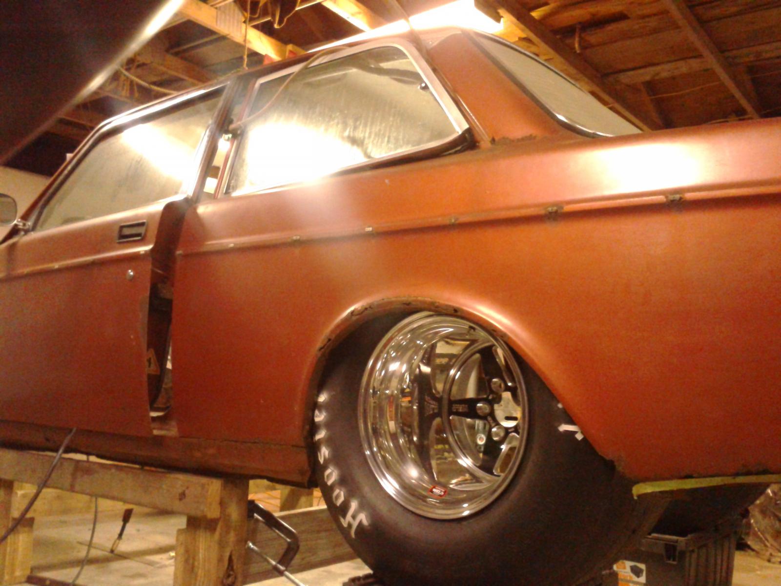

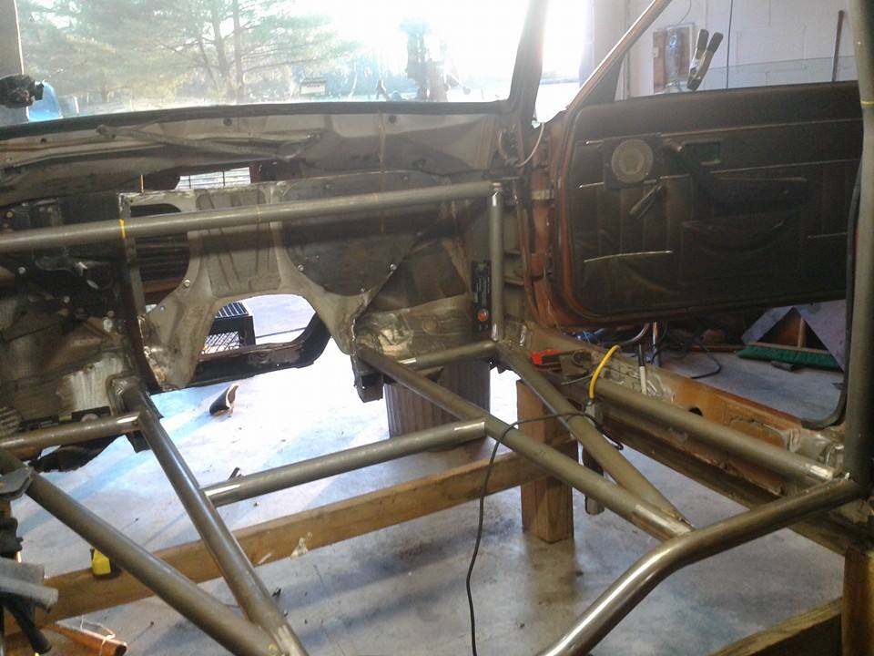

      Hope you guys don't mind me posting updates on my Pro Street build. I've always loved fat tire cars so I decided I should build a Volvo since I've had over a dozen since I was 16. The chassis is design has a emphasis on backbone stiffness and four link support. Tubing is .095" 1-3/4 DOM for most of the structure. The firewall has been moved back 5" to accommodate for tighter mass centralization as well as moving the engine up to keep the pan off the ground while cruising.
      -Vincent
      -75 Volvo 242GL
      -2JZ-GE
      -6 speed 4L80E with PCS valve body mod
      -Narrowed 9"
      -Weld 15x15 RT-S wrapped in 31x18.50 Hoosier QTP DOT's
      -Custom made DOM chassis designed by Joshua Mazerolle (Vague Industries)
      -Phantom Electronics touch starter
      -PCS Dashlogger, TCM, EGT module and touch button gear select module
      -Built in my garage on a "pallet"

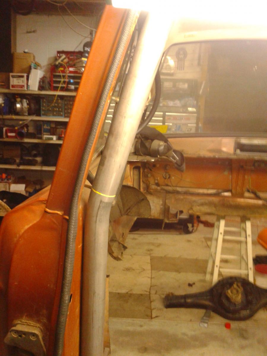

      Got the main hoop bent and tacked into the car..

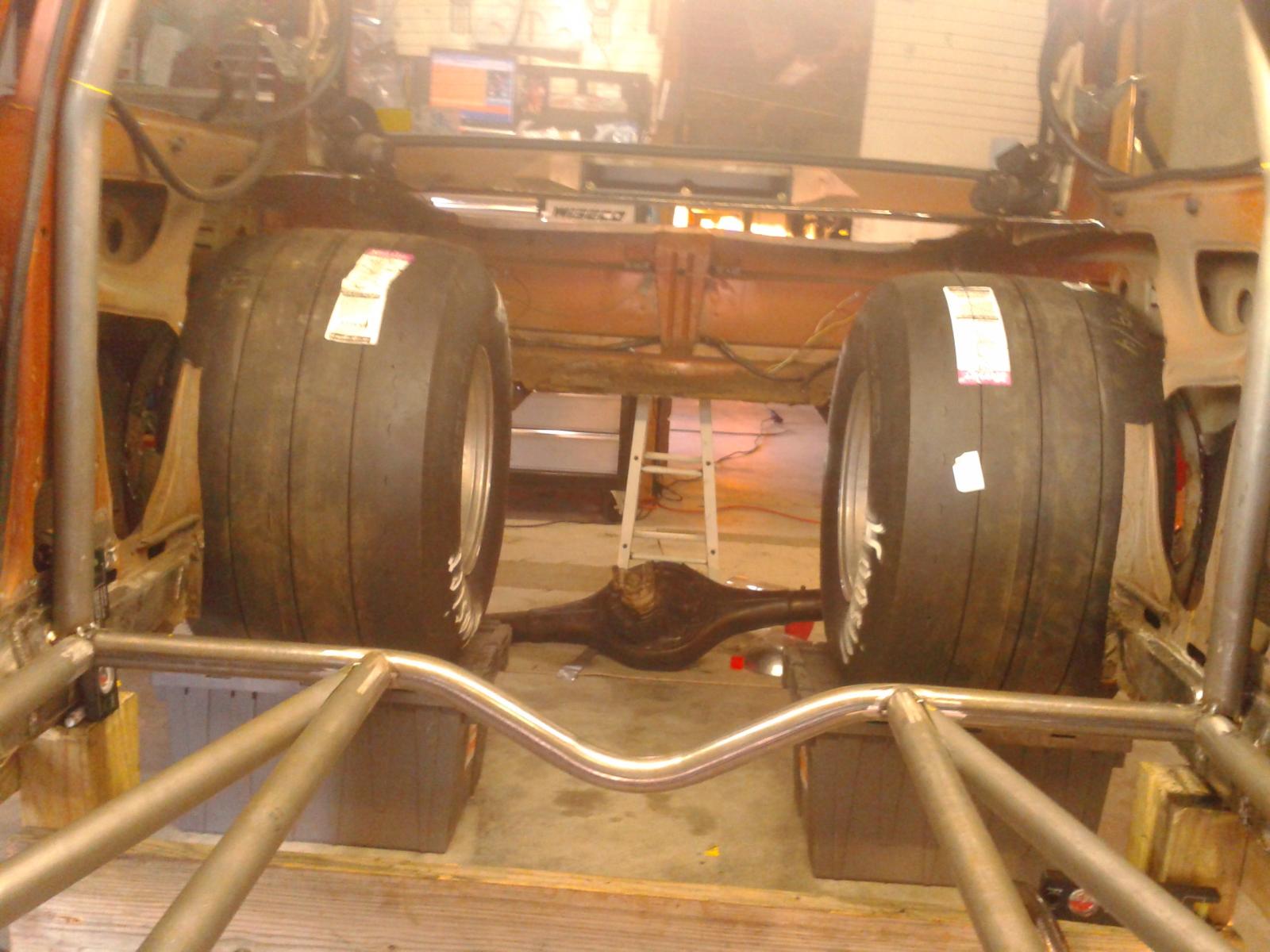

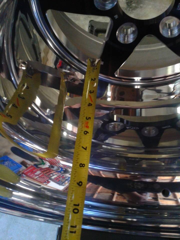

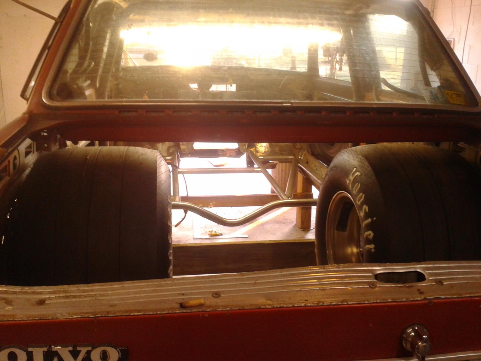

      Cut the trunk hinges out and test fit the wheels again.
      Tires are 31"x18.50" Quick Time Pro's On Weld Racing RT-S 15x15 wheels.

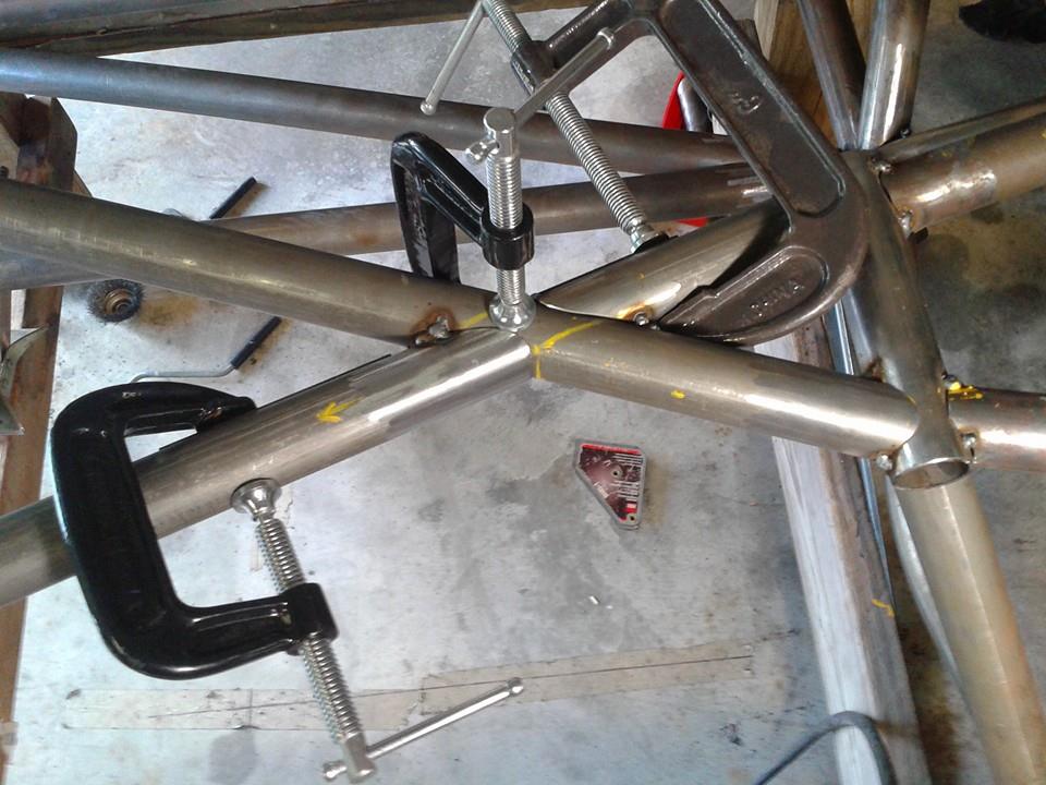

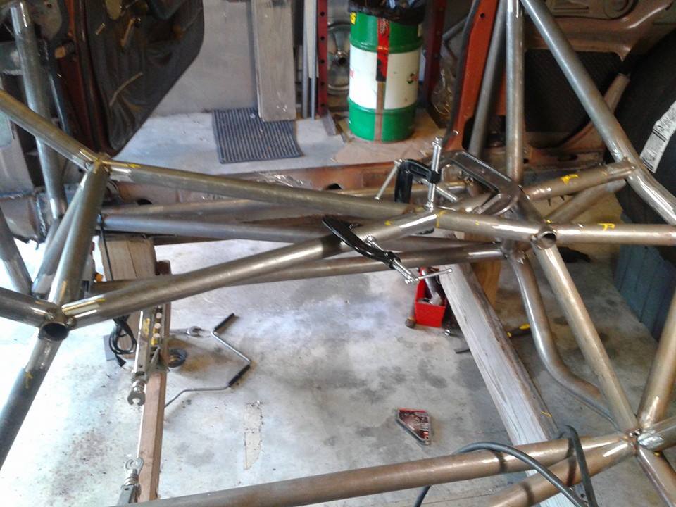

      I've been really busy but still taking out a few hours around midnight to fit tubes.. Almost have the four-link truss finished. Time to buy some tubing!

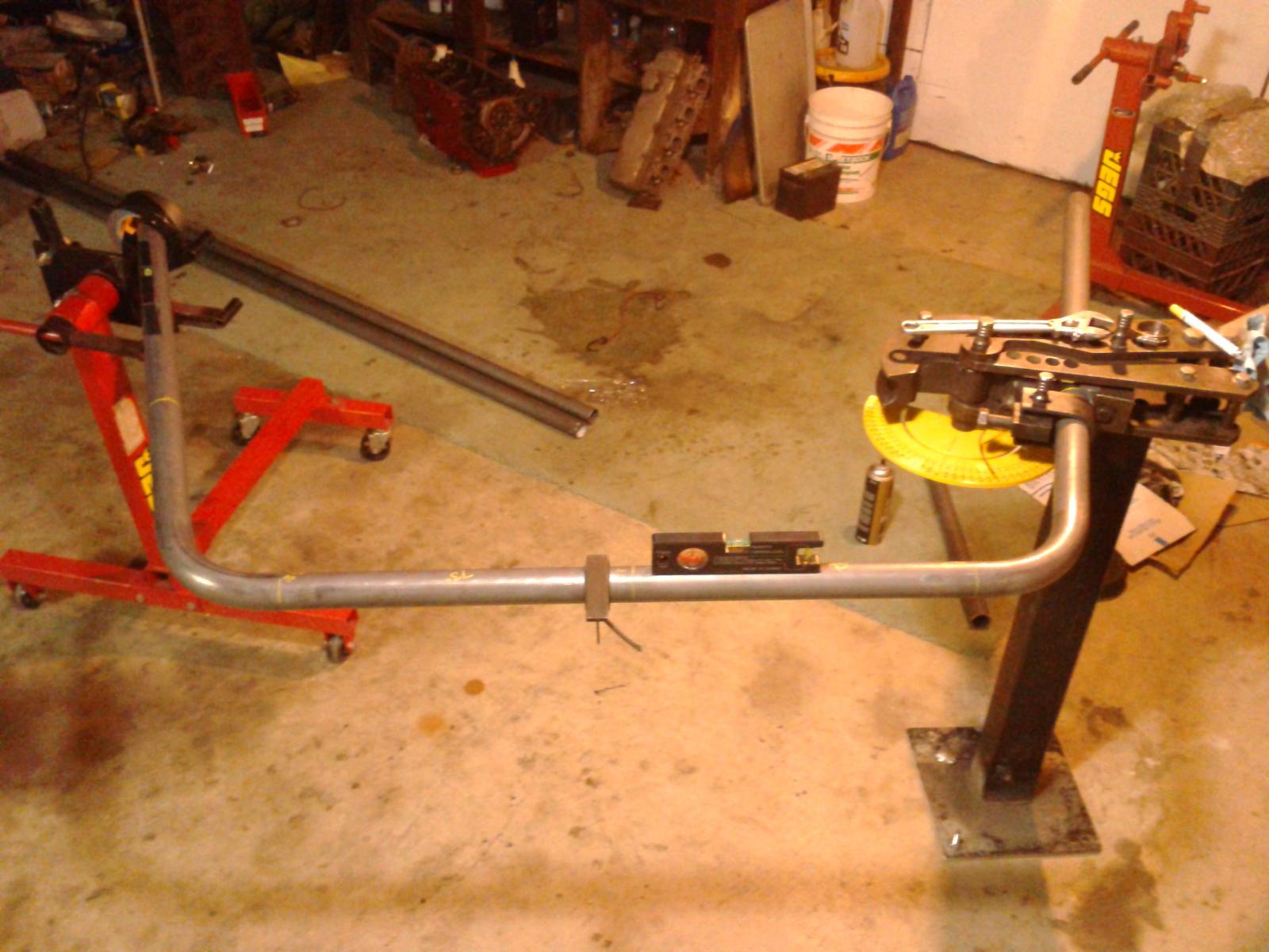

      What are you using to bend the tubing? DOM correct?

      Thanks Tig! I'm using a JD squared model 3. Tubing is 1-3/4 .095" wall DOM.
      My fab skills aren't good enough to warrant Cro-mo..

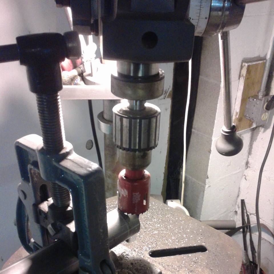

      Bending and fitting the cowl bar

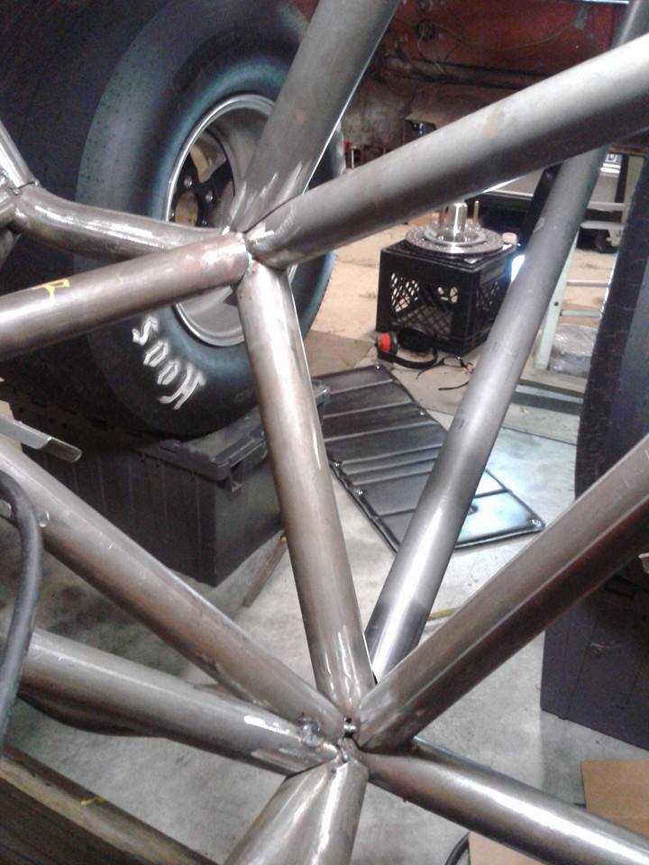

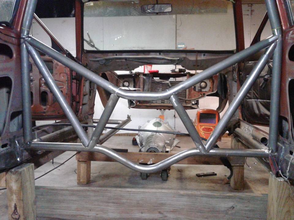

      Finished up the firewall/cowl area. Starting on the front node for the backbone.

      Man That fab work looking great. That Volvo gonna be a beast.

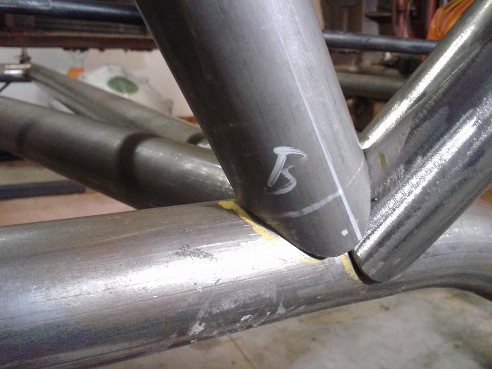

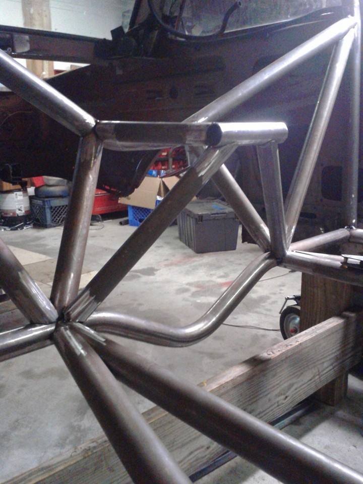

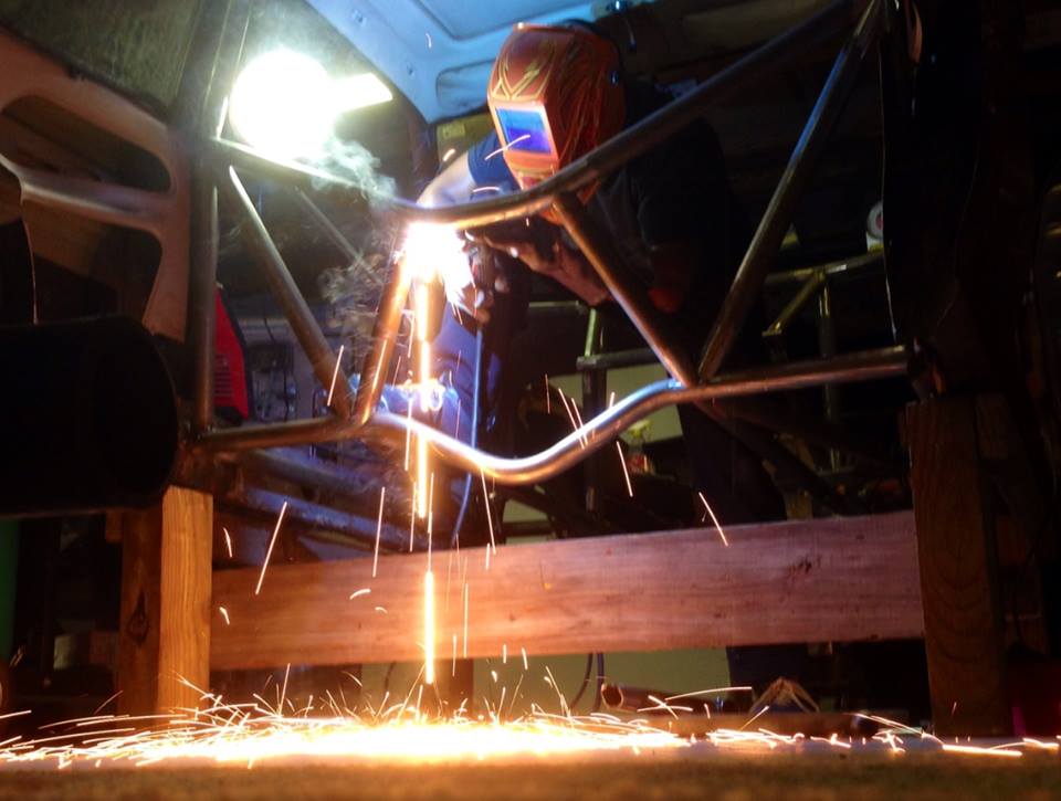

      Got a few more tubes fitted..
      Getting the Mazderp engine ready to stab back in my other Volvo
      Cant forget cup holders for Sonic runs
      Mar 2014
      58
      Country Flag: Jamaica

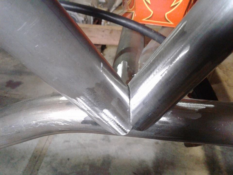

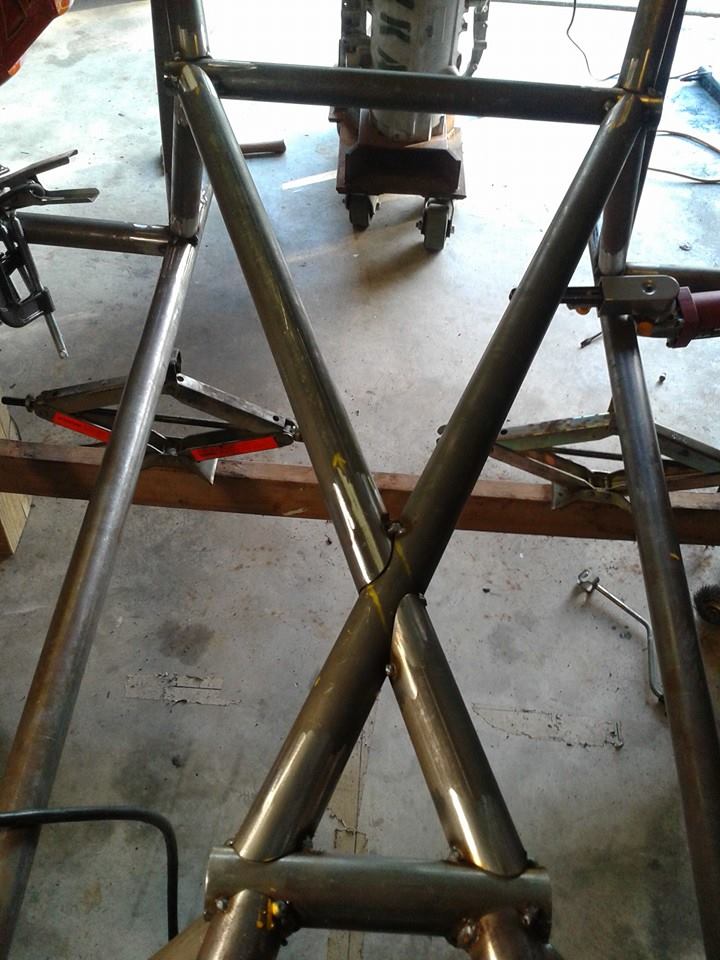

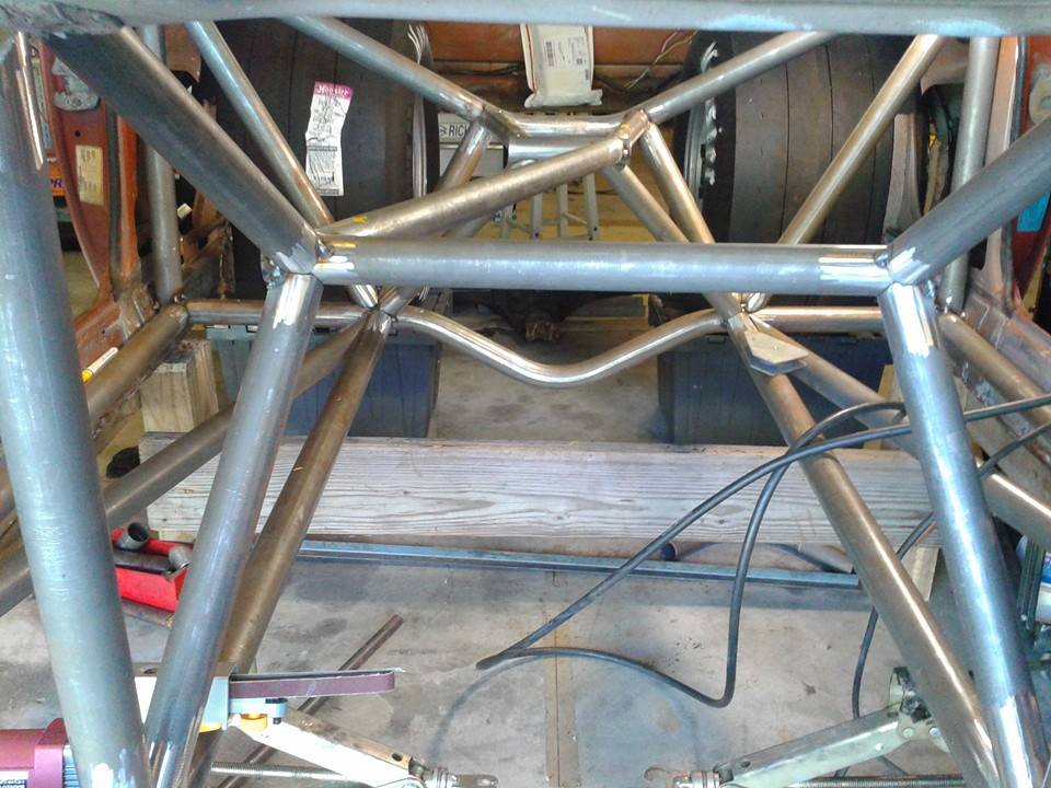

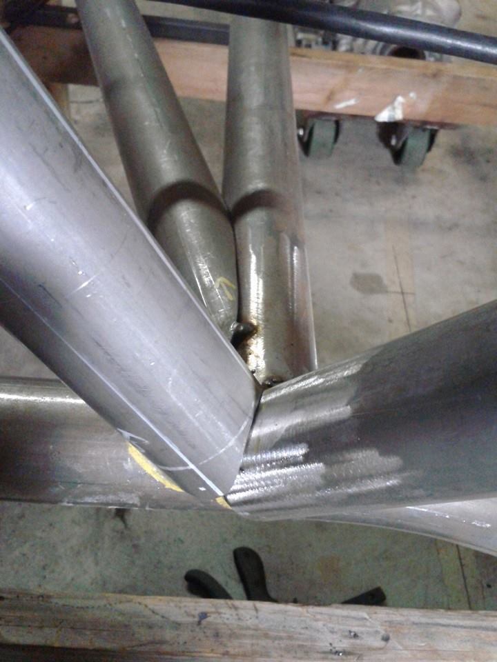

      Finally got some time to lay some tubes.. Got the top of the backbone x finished up today. Definitely took me the good side of 5 hours to fit three tubes..

      I think you're wrong, you are definitely capable and skilled enough to do a chromoly chassis. Heck your tubing notching and alignment is damn near perfect.
      Great work man.
