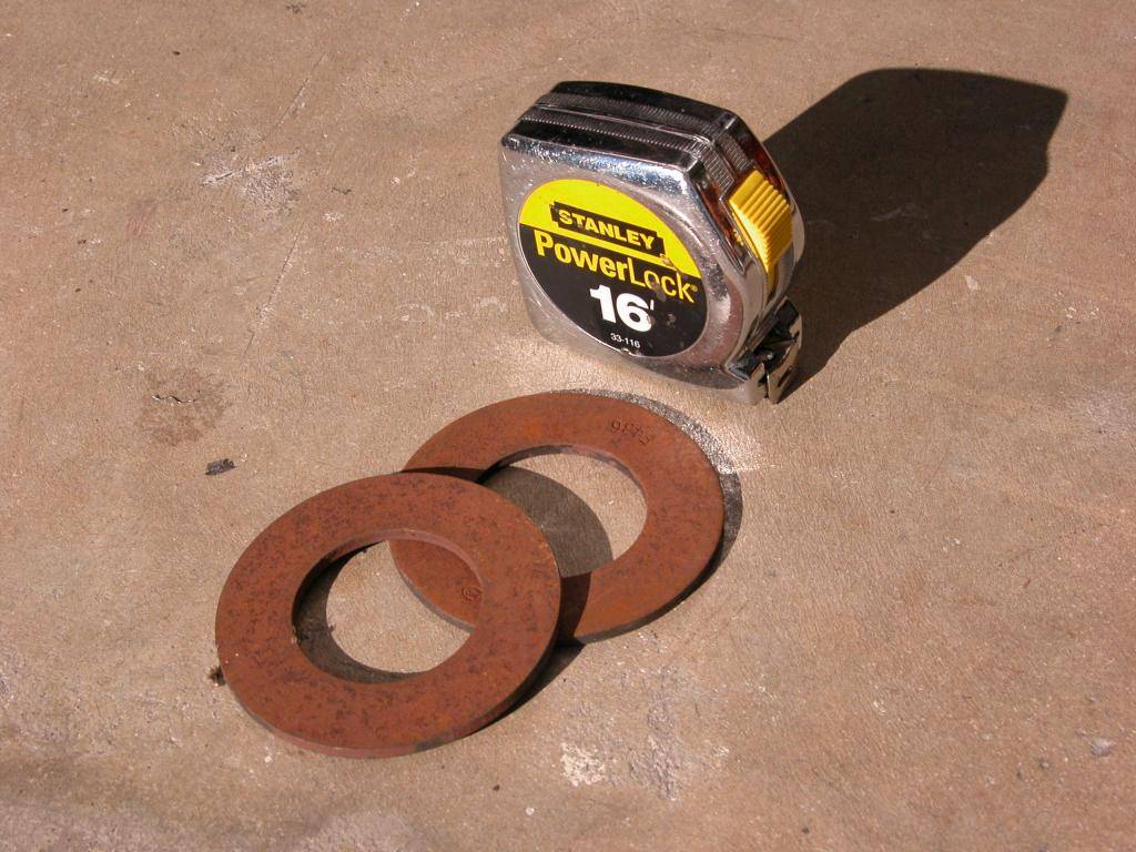

      I just cleaned the rust off, primed it and then welded a washer over the top. If I remember, I special ordered a 1 5/16" fender washer which was a true 1 3/8" hole.
      I tried the hole saw approach, but my cheap hole saw was immediately flattened. I figured the washer was an easier solution

      i did the same as the person above. they sell washers exactly for that

      Another way to go, make the repair 'washers' thick. Such that they become the body mounts. This kills two birds with one stone. The holes are repaired, and no separate body mounts are required.

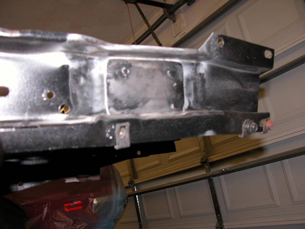

      I usually use washers from the local Fastenal. If you can only use them on the outside you won't need to modify the body mount thickness. If the core support us rusty I make a sheet metal patch for top & bottom, plug weld & drill hole.
