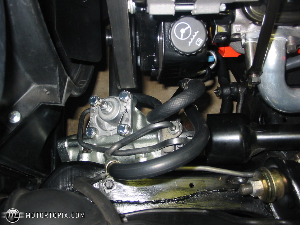

      BTW….I've got the upgraded steering box and new TC PS Pump installed from CJR products. I must say that their craftsman ship is fantastic and the feel of the car is completely different. It feels just has good as any late model muscle car on the market today. Well worth the money spent. In total, I spent roughly 600$. They reconditioned the stock steering box and I bought a remanufactured TC PS pump from them along with a their pulley. If you're running a BBC, like i am, I highly suggest getting the PS Pump bracket from DSE. Thanks Wayward!
