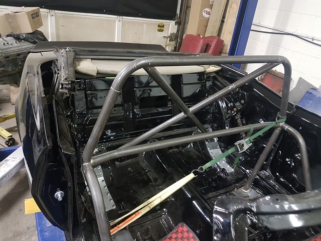

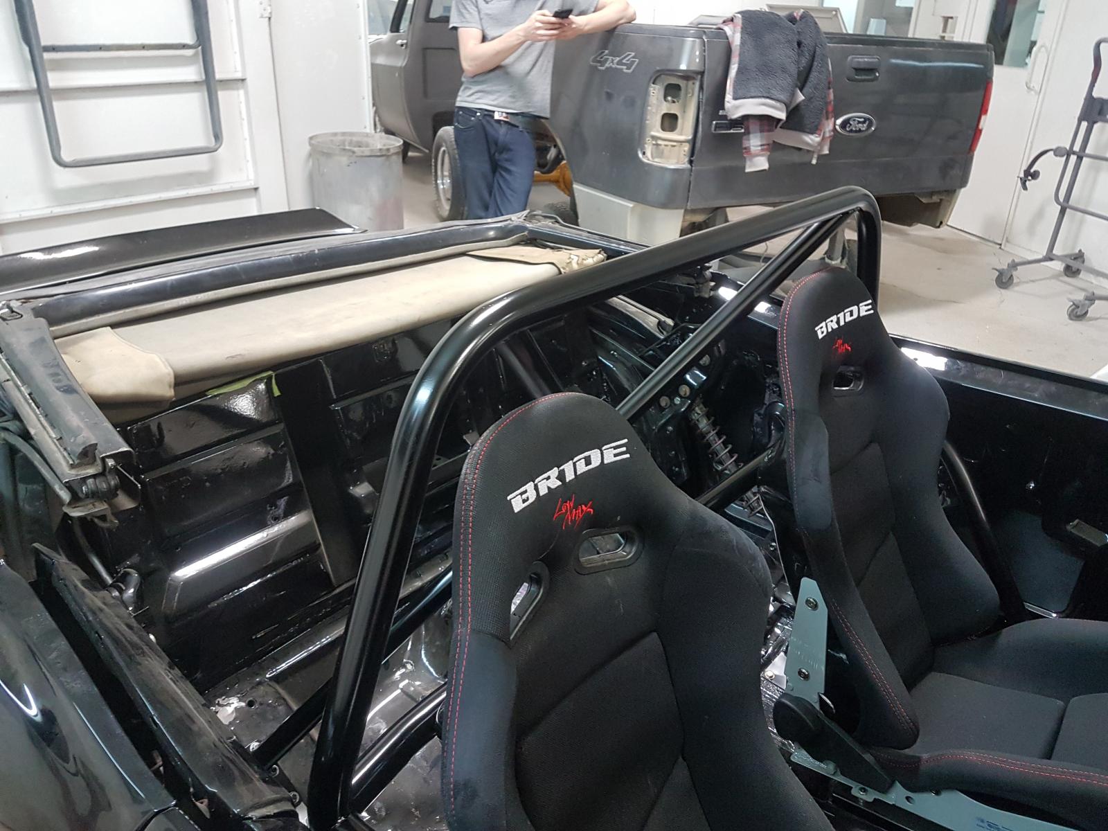

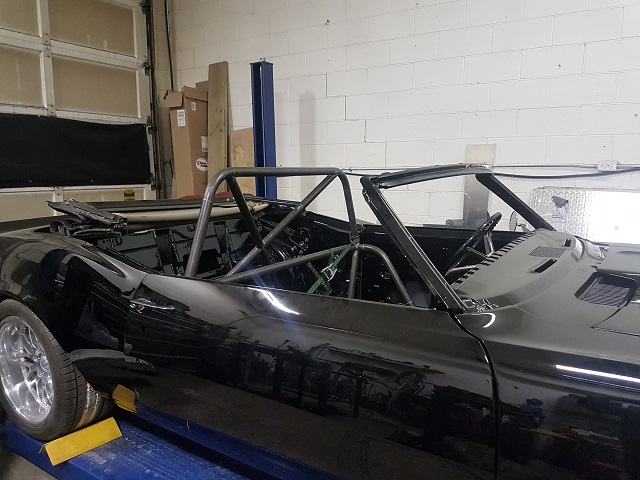

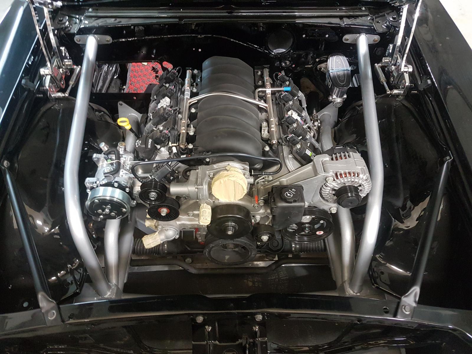

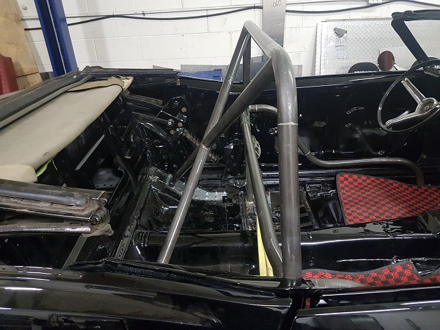

      Some more progress, i am very happy with how the bar is progressing.......and its bolt in......and good bye back seat. Front subframe bars and exhaust next,

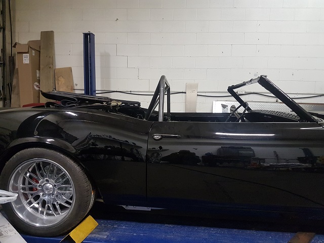

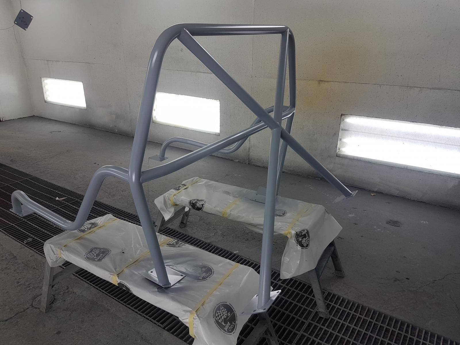

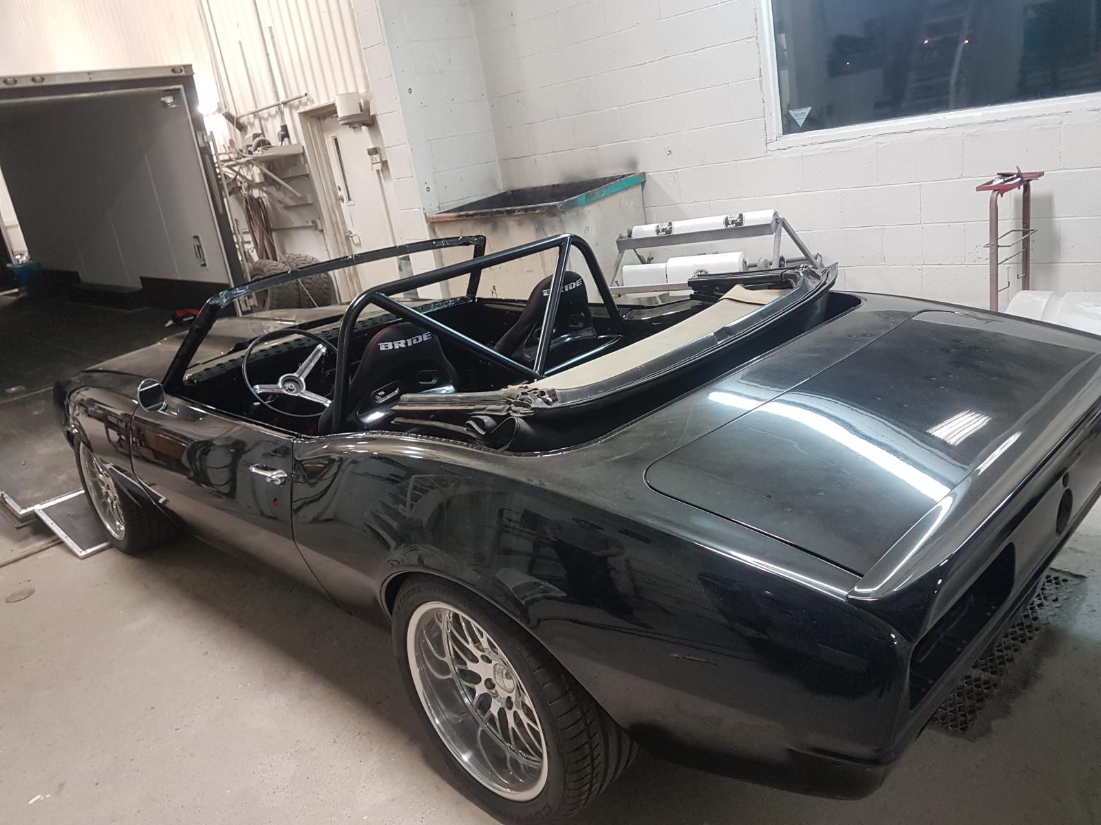

      Took my car out to paint,and here are the results.....forgive the extremely dirty car.

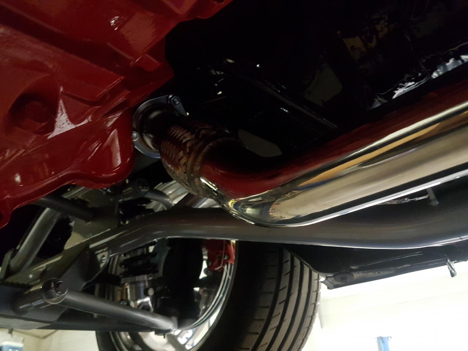

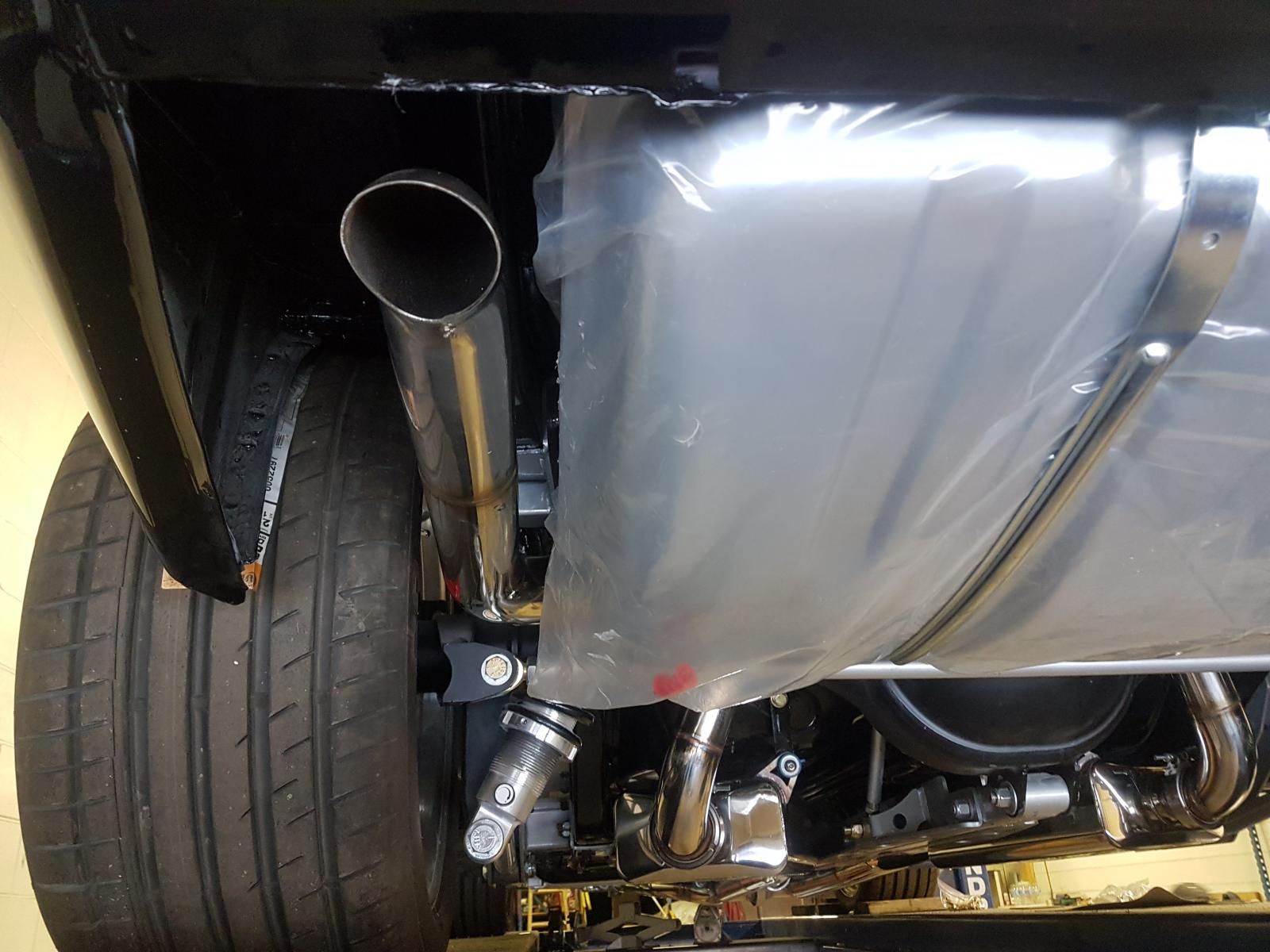

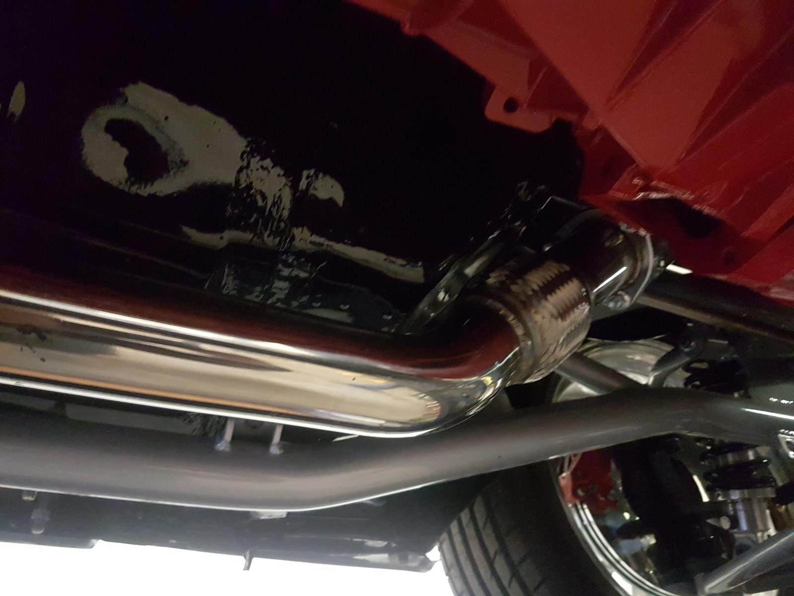

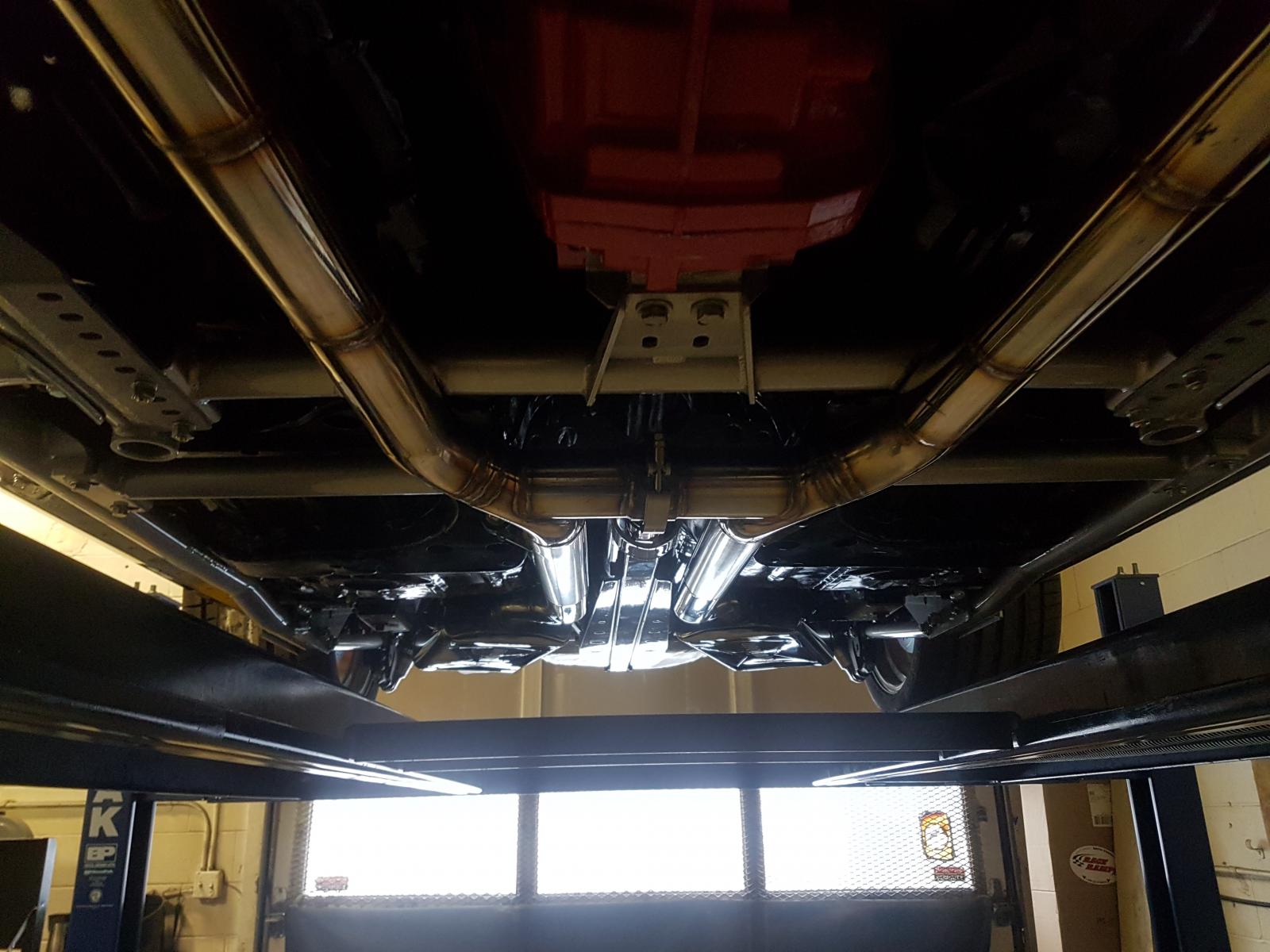

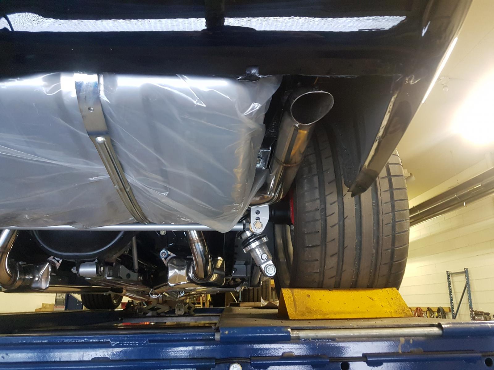

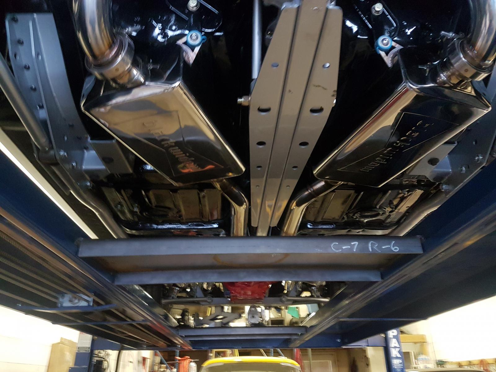

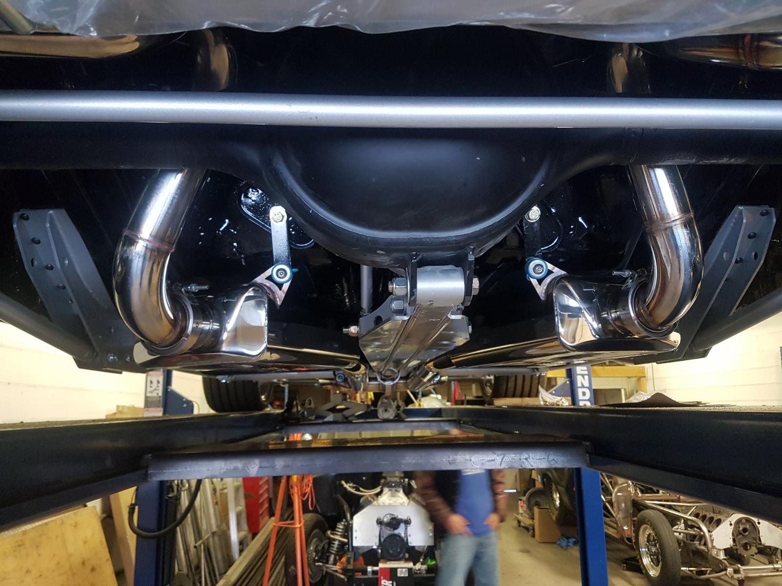

      The exhaust was also finished ,was in a bit of a hurry to pick car up as we are getting a big snow storm here ,so the pics could have been better.

      Beautiful build. Is that a TCI 4 link ??
    5. #45
      Feb 2013
      Saskatchewan, Canada
      157
      Quote Originally Posted by DT69Cam View Post
      Thanks, Yes is a TCI, it's the torque arm version.

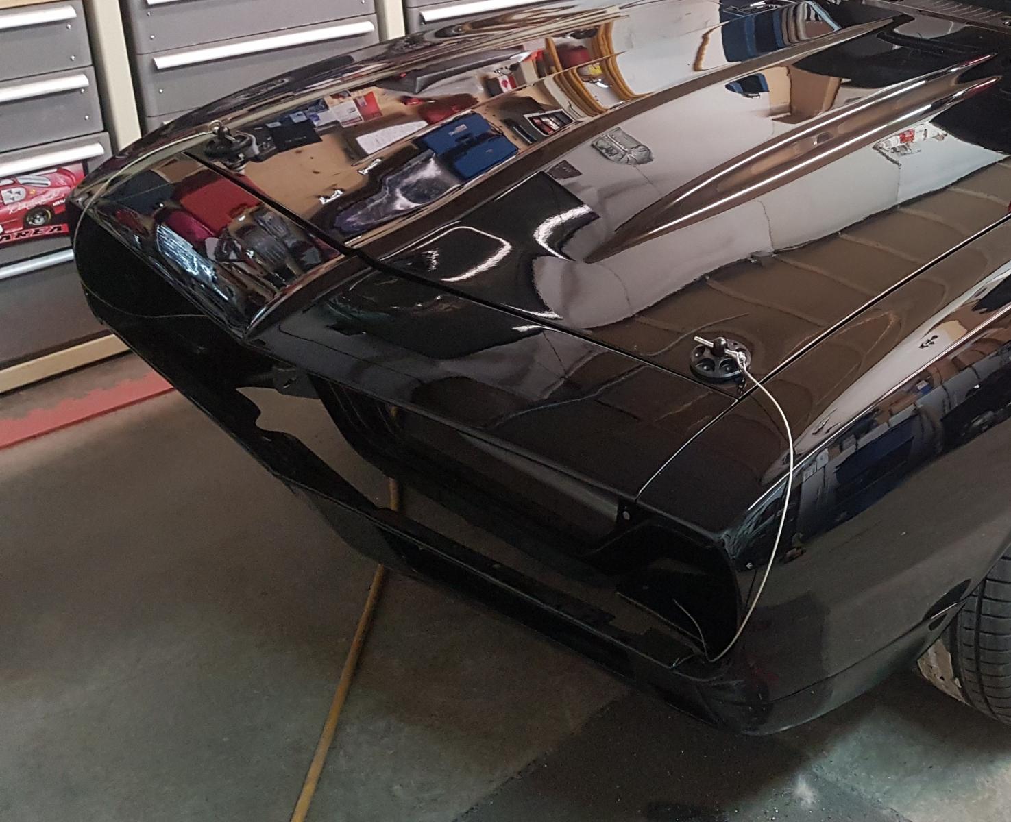

      Installed Ring Brothers hood pins, got to say, it was a little nerve wracking, drilling into new paint, but I like the results.

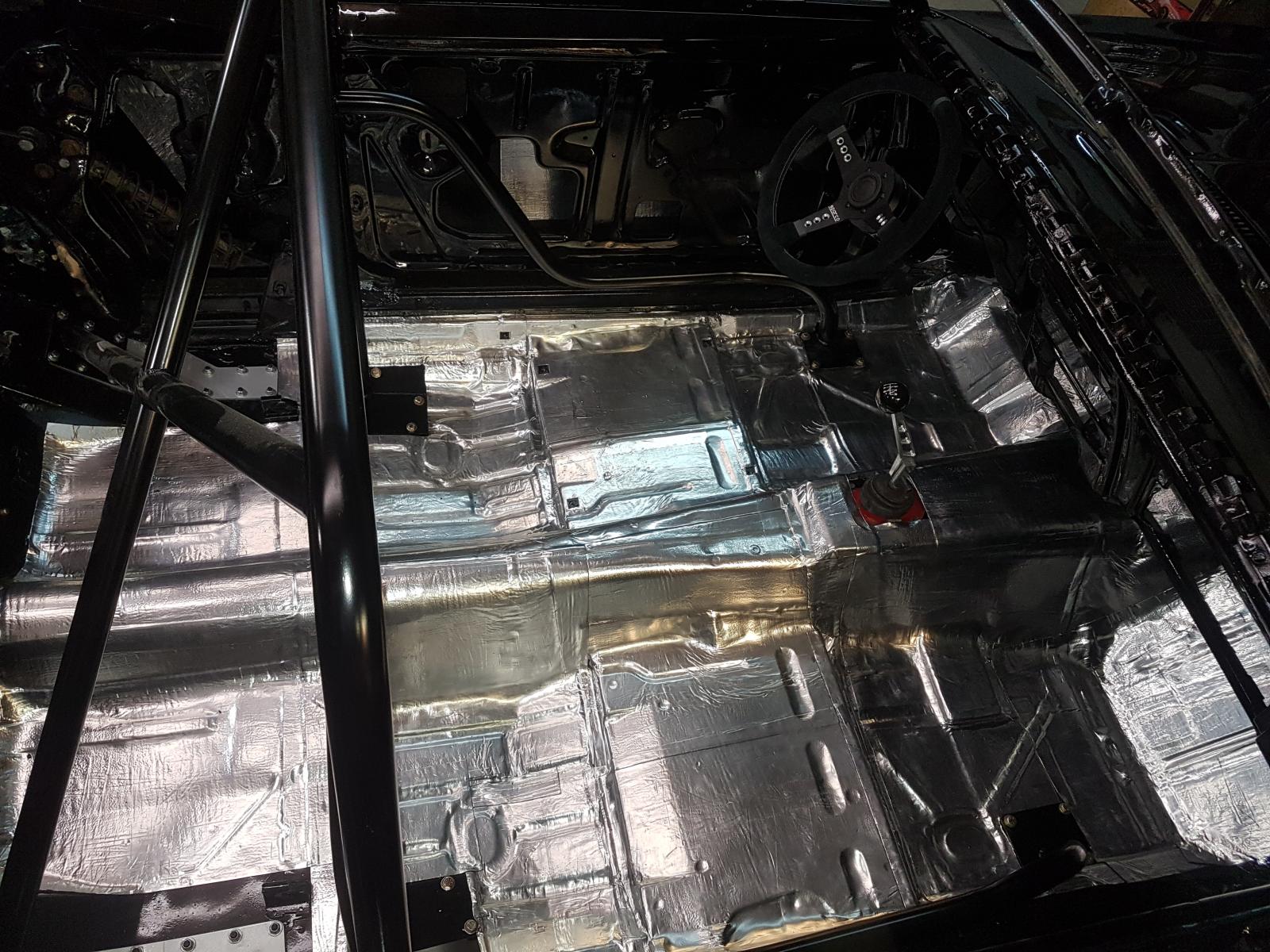

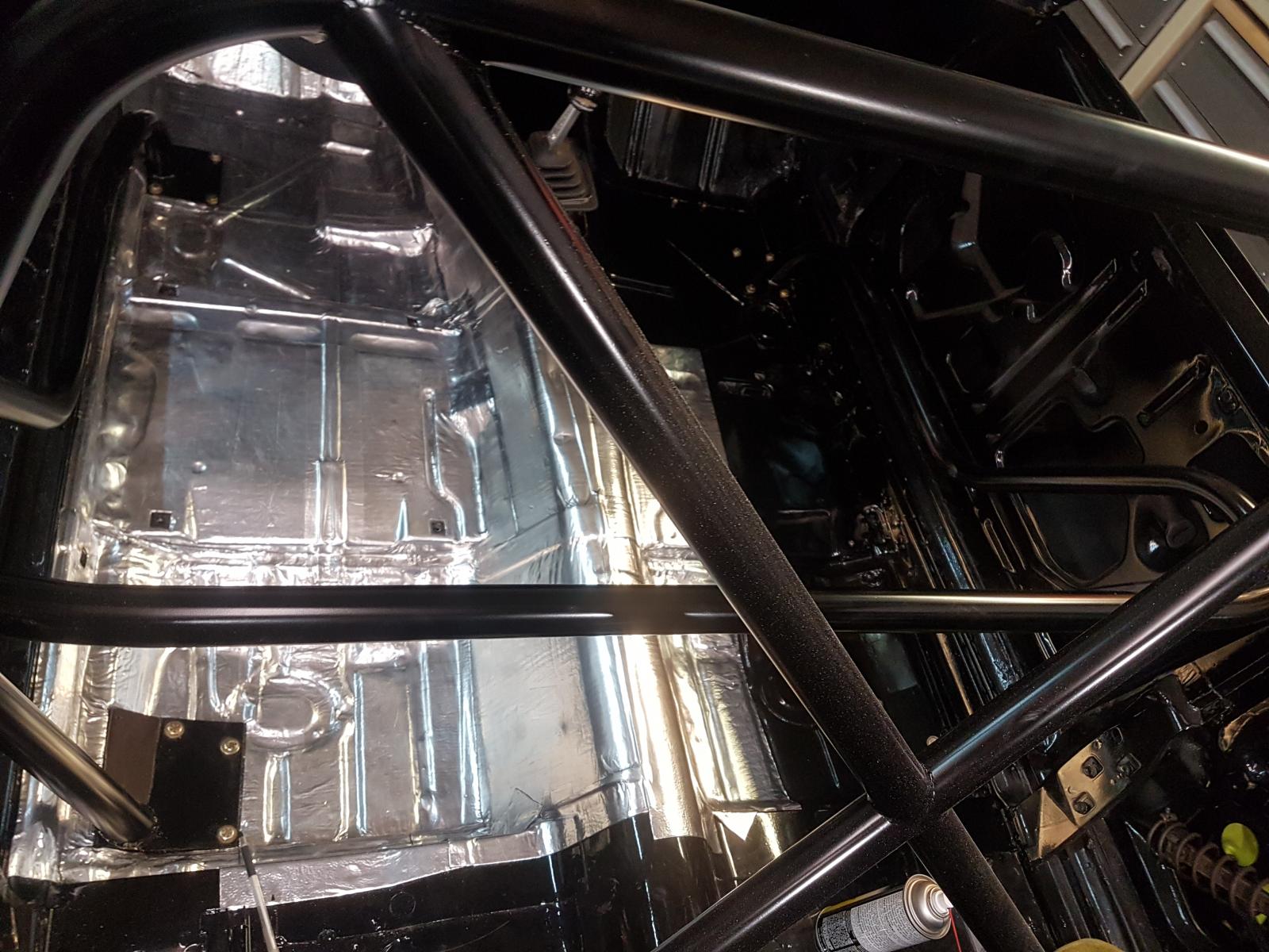

      1st day putting GT sound deadener down, I don't know how much this is going to deaden sound, but, it will no doubt give a good level of waterproofing to the floor pan. This deafenetly puts your finger tips to the test... Hopefully finish tomorrow.

      Ragz, they sell a small roller to use with the sound deadener. It has a wooden handle and a rubber like wheel. You roll it over the material and press fit it in the nook and crannies. Saves your hands. Ask me how I know ? LOL

      Yeah it came with a small one, a wooden roller, broke in about a minute.. Lol, got another, but a better one, and it does make it a little easier, good call.

      Finished the interior part of the deadener, added a few pieces to the doors, inside of interior rear quarter panels and some up under the dash as well, the door difference is very noticeable, not sure, but once I cut an access hole in my trunk I may do that as well... So, I guess it's on to the AAW wiring harness, hope this goes smooth.. Lol

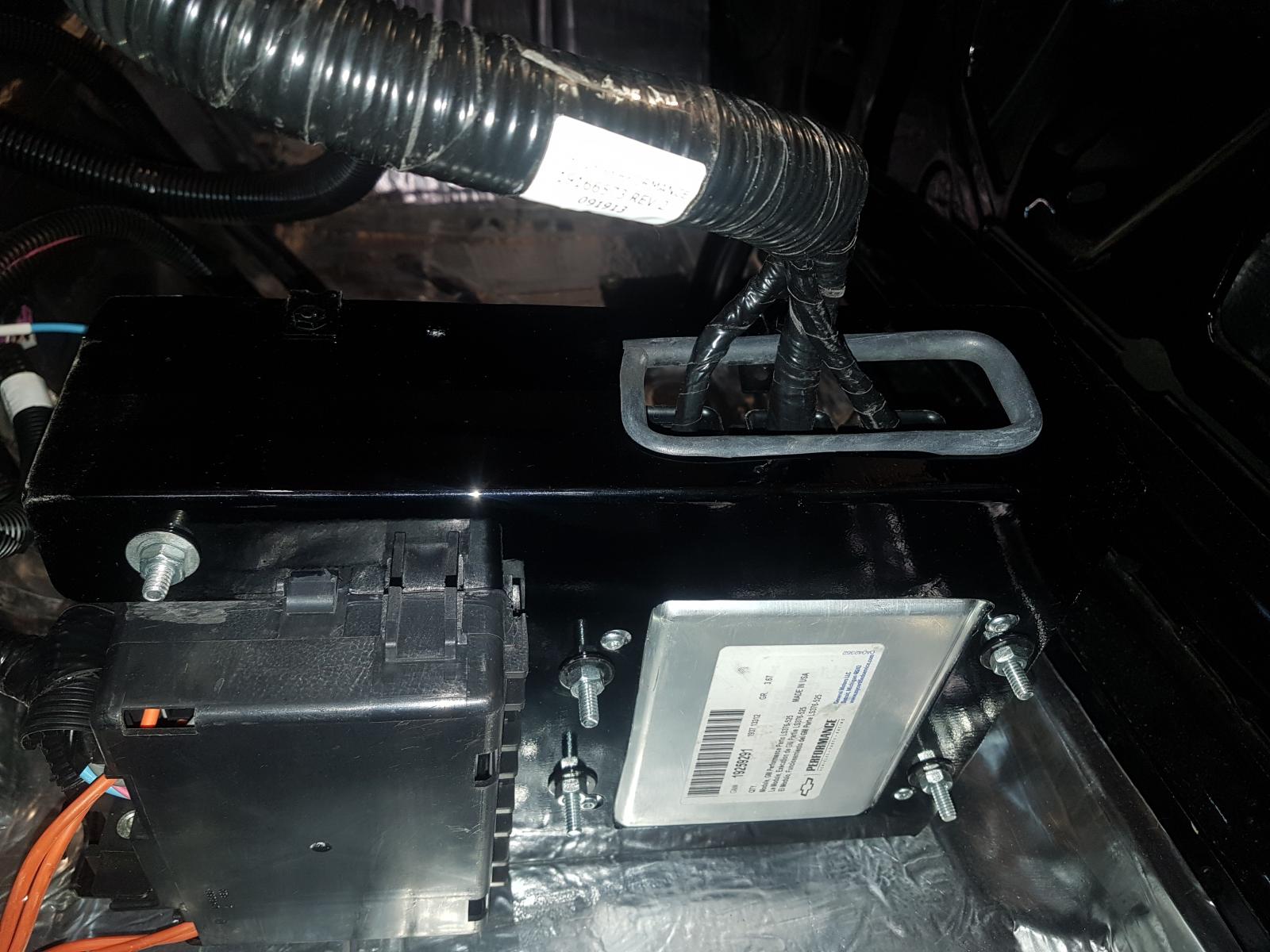

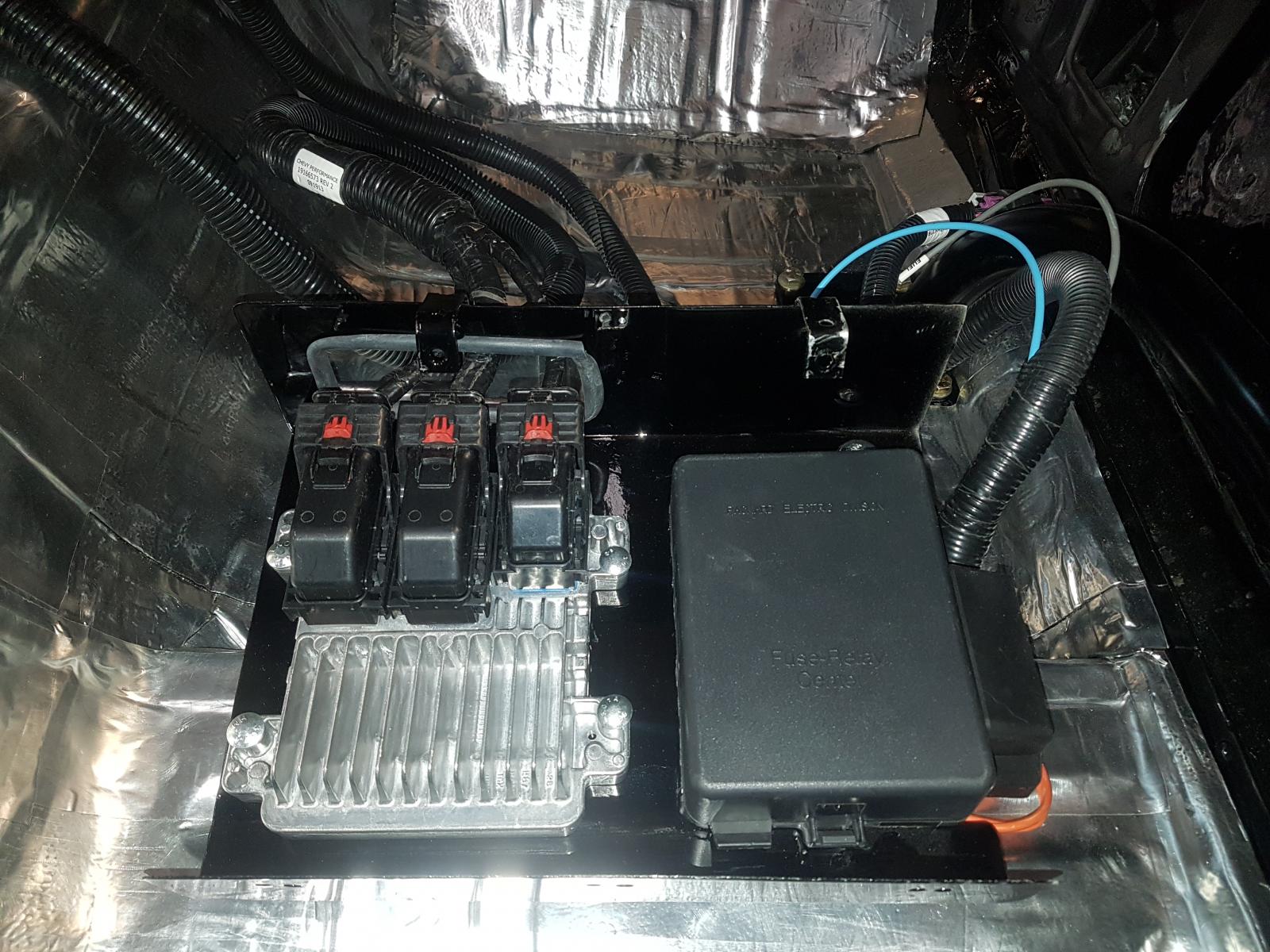

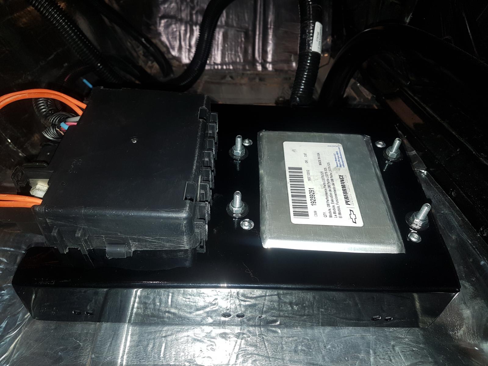

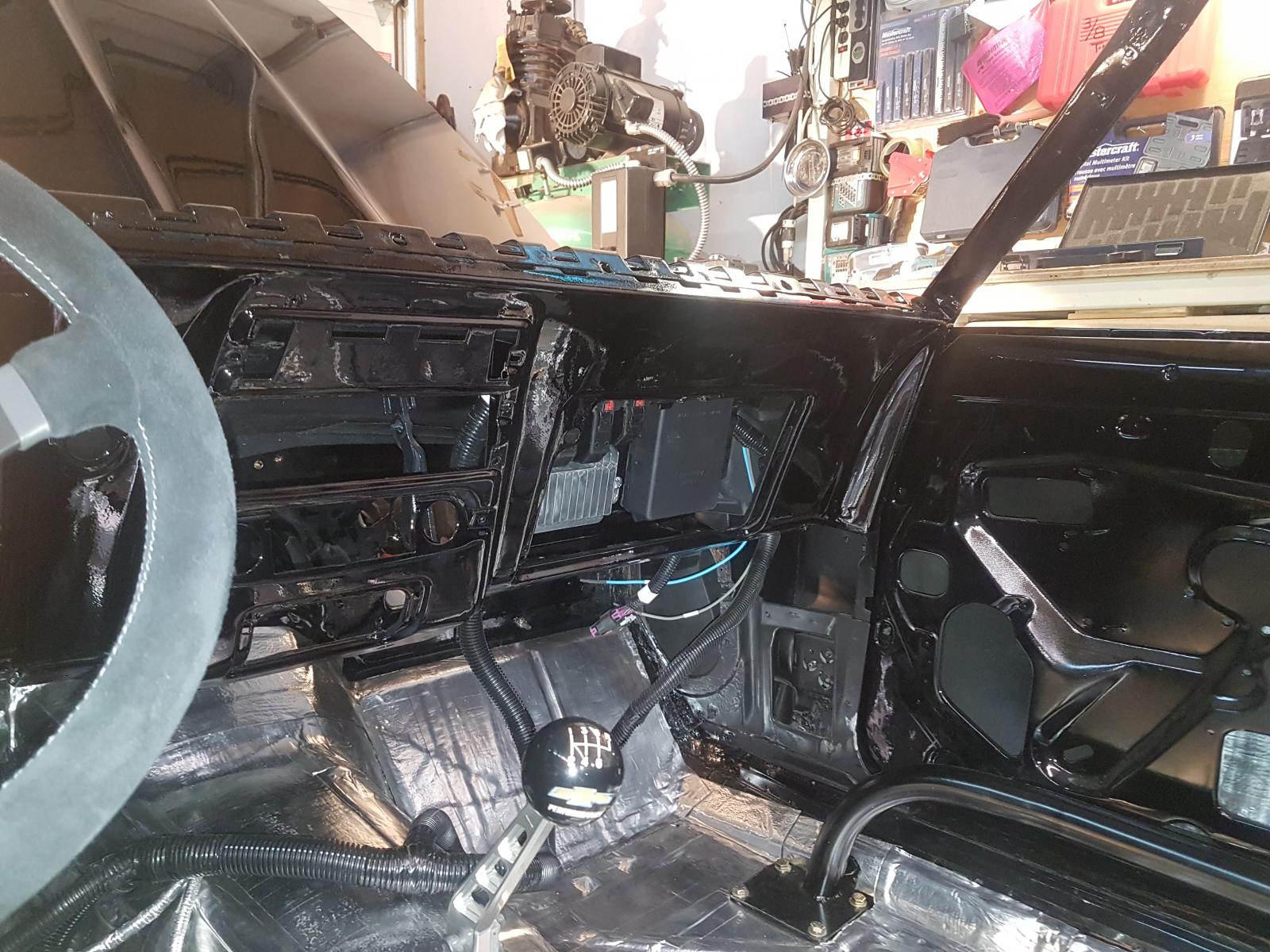

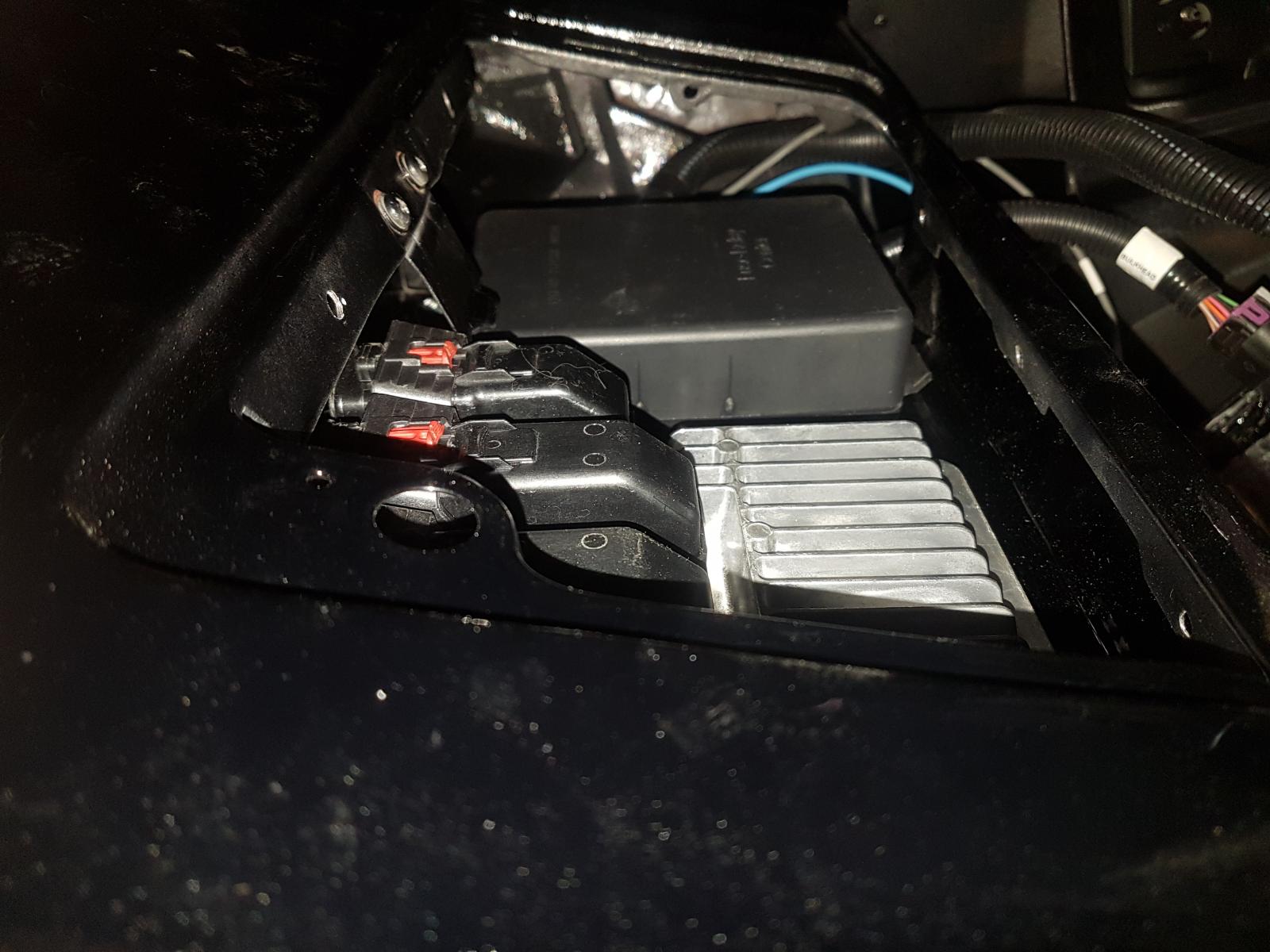

      Going to fit some wiring,made a bracket to hold the ls computer and fuse box, it is going to go in the glove box hole...i tried to make it as slim and shallow as possible to clear the vintage air ,so hope it works, now to drill the Big hole in the firewall....
