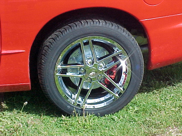

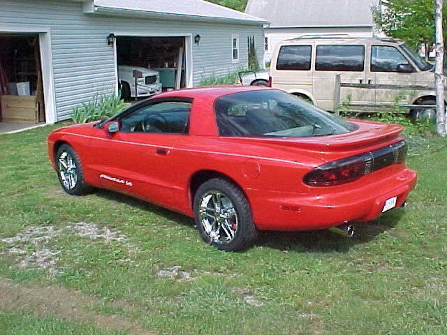

      I picked up both sets of wheels for both of my 4th gens off eBay. They are very nice quality and balanced up nearly perfect.
      18" C6 replica's in black chrome with 285-30's on the CETA.
      For my '94 Formula I got a set of brand new 17 x 10's with Nexen 275-40's, mounted and balanced, with free shipping, for a grand. I sold the stock 16's for 500 and ended up with less into the new set of wheels and tires then if I had just put new tires on the 16's.
      These are Z06 replicas in chrome.

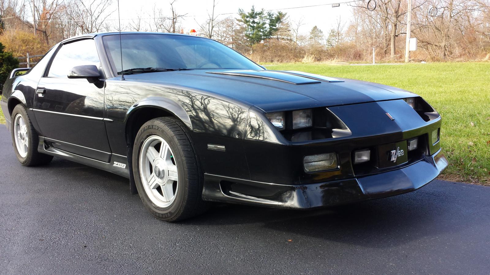

      Heres my 91 for a frame of referenceName:  20131123_112309.jpg
