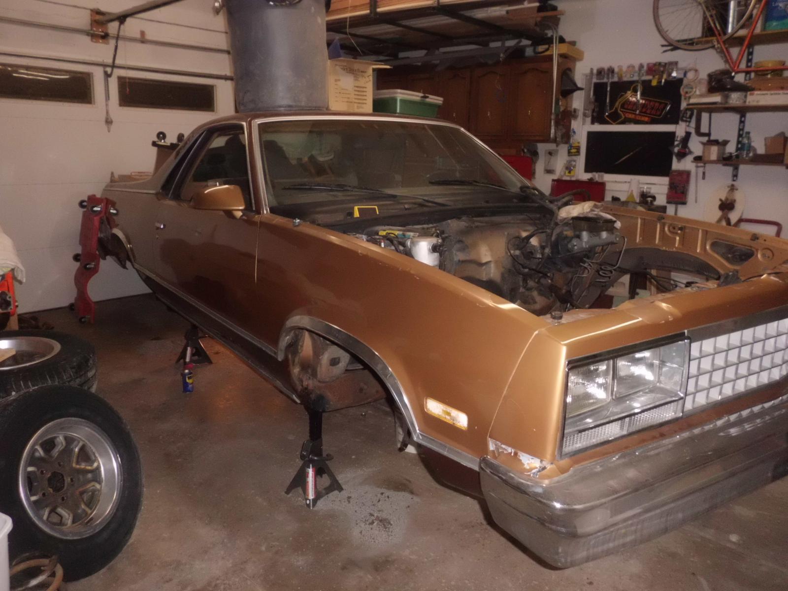

      After a couple of years in outside storage, my Elky finally made it into the garage for demolition. I've bought a lot of suspension parts and that I'm anxious to install, but the frame needs to be mocked up for my T56 gear box mated to the 350 I built last year and have yet to crank.
      I initially hadn't planned on doing a complete frame off at this time, but as I've gotten more and more involved I've decided to proceed with getting down to a clean frame and moving forward from there. I don't have the luxury of being able to transport the pieces to a media blaster, but could send the frame out.
      I'm looking for some feed back on powder coating the frame vs a POR 15 finish.

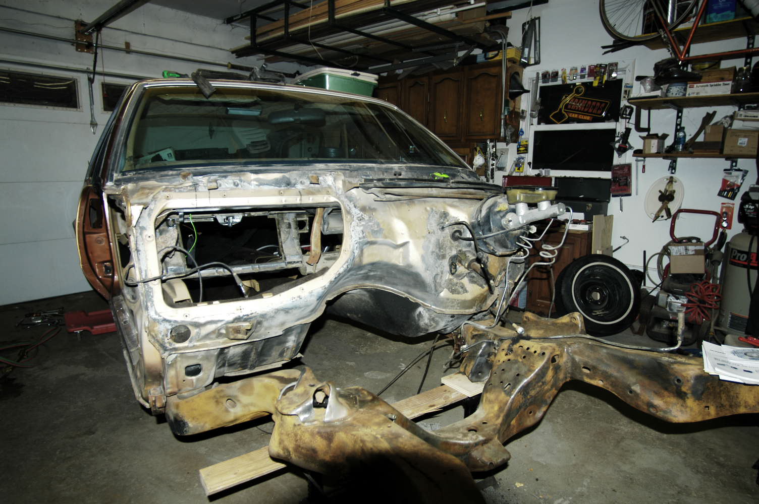

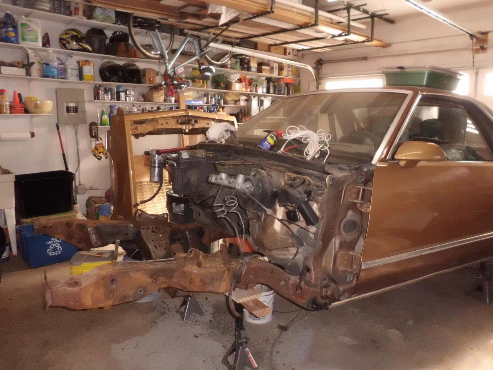

      The more I uncover, the more I find that needs to be done.
      All in all the cars is in great shape. I need to get to the frame to make sure I don't have any real structural problems. Name:  DSC_9909.JPG

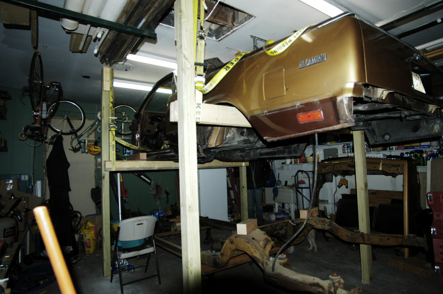

      Creative Engineering
      We added support both in the attic, rafter reinforcement, and below, and were able to get the body off the frame to assist in working on both.Name:  DSC_9944.JPG
Size:  221.1 KBName:  DSC_9947.JPG
Size:  213.1 KB. I'm still debating on finishing the frame with POR 15, or to have it professionally powdered. I have a little work to do on the frame prior to paint anyway. I need to mock up the engine transmission to ensure the crossmember is properly placed. Hope to get to it soon.

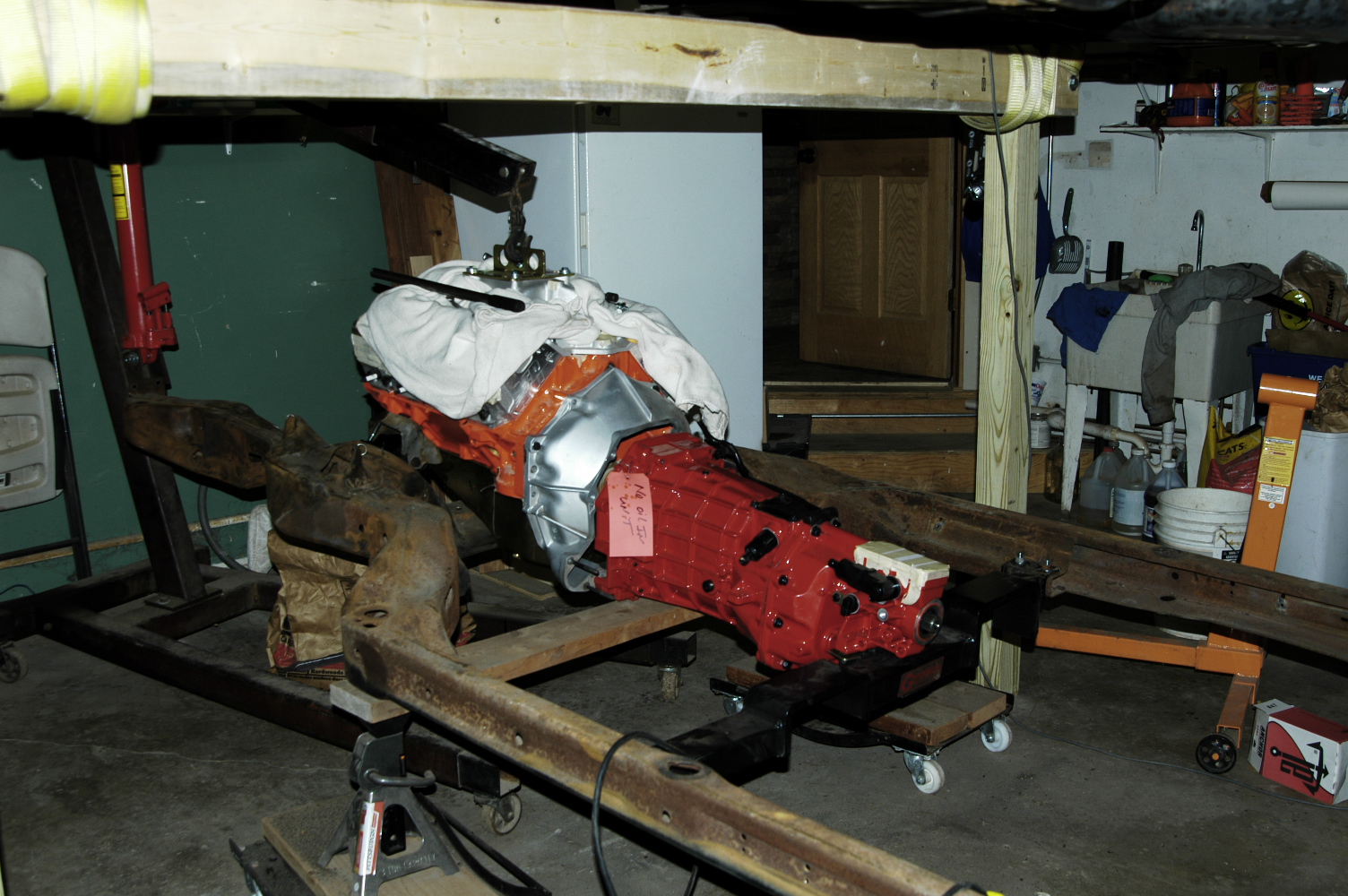

      Transmission mock up
Size:  715.8 KBName:  DSC_0012.JPG
      I mocked up the engine/trans to make sure my Spohn Gbody T56 mount would fit, it does. The tri color, I painted the engine over a year ago, and just got the T56 and bell. The tranny tunnel will have to be opened up a bit.
