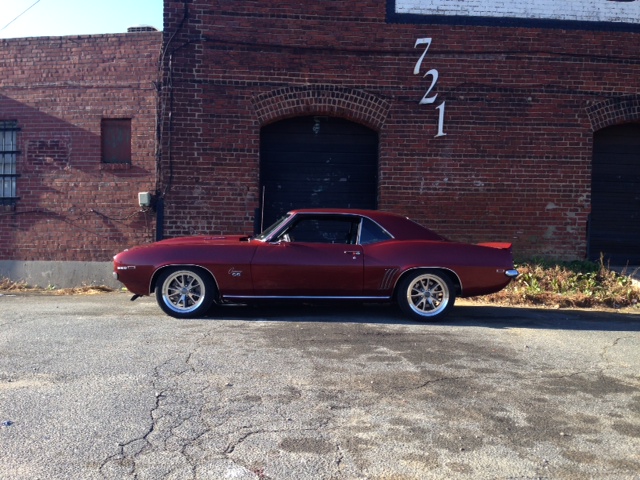

      I agree with Buzzkillian-start with both 1/4" spacers and the aluminum spring block, especially if you are happy with the current ride height. Here is a pic of my car with both upper and lower SPC control arms, 2" Hotchkis lowering springs, and both 1/4" shims and the aluminum spring block installed for reference:
