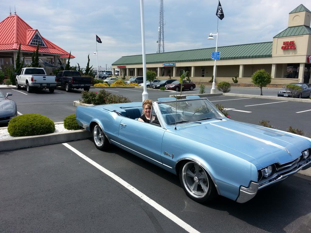

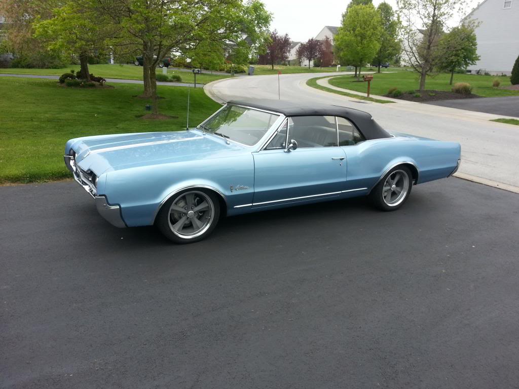

      Attached are a few photos of my 67 cutlass pro tour build.*
      The car was all all stock with a 330 & 2 speed with 4 wheel drum power brakes
      Last winter I upgraded all of the suspension, steering and brakes parts.*
      The suspension received spec upper and lower control arms with spc spring and a Heldwig hollow way bar in the front. To benefit from these changes I also installed all new moog components and had the steering box rebuilt to a 12:1 ratio.
      In the rear I went with spc spring and umi adj. Control arms and a helwig sway bar*
      For braking I went with 13" rotors in front and 12" in the rear assisted with a hydroboot.
      After driving the car last season and being happy with this set up I decided its time up the power and get full use out of my upgrades.*
      For a new power plant I decided to go with a LQ9 6.0 motor 4L80 trans and a 75mm turbo.*
      We just pulled the motor the other week but I have all the parts for the install. Ill post photos as I go.

      Nice ride! Don't see too many of these- we've had a couple in at the shop for minor work, but I really like the 67's.
      Good luck with the build!

      What brake kit is on it? Looks like Right stuff signature series? Nice car. I love the color, black top and gray wheel look. Im doing the same color combo with my 67gto.

      Its a*Right stuff signature series brakes front and rear combined with a hydroboost set up
