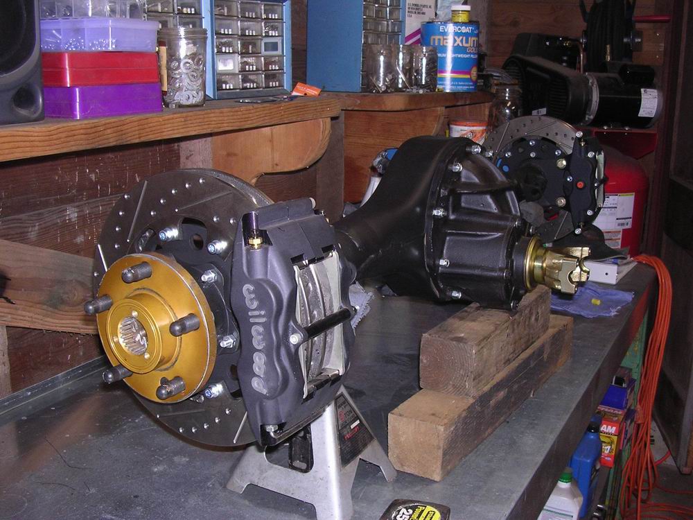

      Rear axle update
      Attachment 13357
      I finally finished the rear axle and it looks great. Here are some cool before and after shots. One of the last things I had to do was find the shock mount locations and finish up the spring perches. I also included pictures of the upper shock mount/rear sub frame cross member.
      I'm very happy with how things are turning out.

      FYI - one thing (which you probably already know if you rotated the rear wheels) is that the inner valve stem sometimes hits the disk brake caliper. If it doesn't hit, still make sure there is adequate clearance. I had to change my Budnik Tiller 5's to the "button" valve stems when using Wilwood disks.
      Your car looks great and you have done some really killer fabrication work.

      Quote Originally Posted by speedster
      This was defiantly something I had to consider. Luckily the rear grand national hubs were so large or I wouldn’t have been able to accomplish it. The front valve stems had to go on the outside to clear because I wasn’t willing to go with any more of an offset in the front.
      Thanks for the fabrication props. There are many many hours of it in this car already. It's nice when someone else can appreciate the work. Most people I know have know idea what I'm doing and can't really comprehend what it takes.
