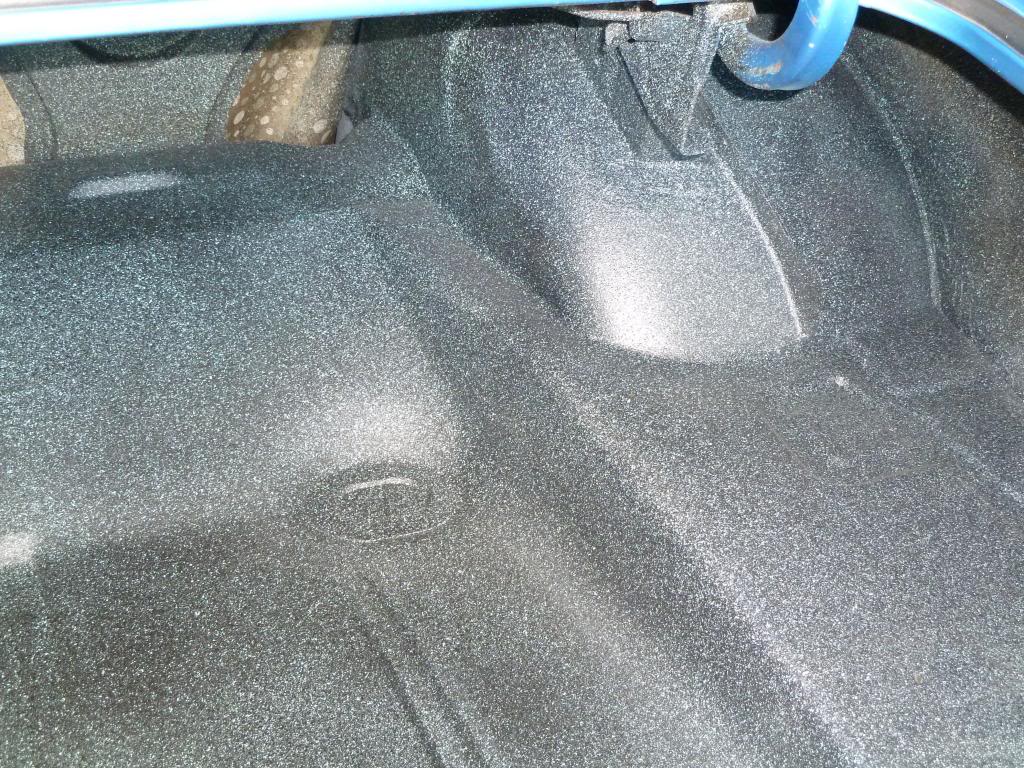

      You have to scribe the lines for cutting the floor pans b4 you remove the old tub. It works with a flange and without, but you can only bend the flange in the strait areas. Then you have a place for water to be trapped if you don't seal it well. Butt welds work great if you cut it nice. I welded solid then seam sealed. I have more pictures if you need them.
