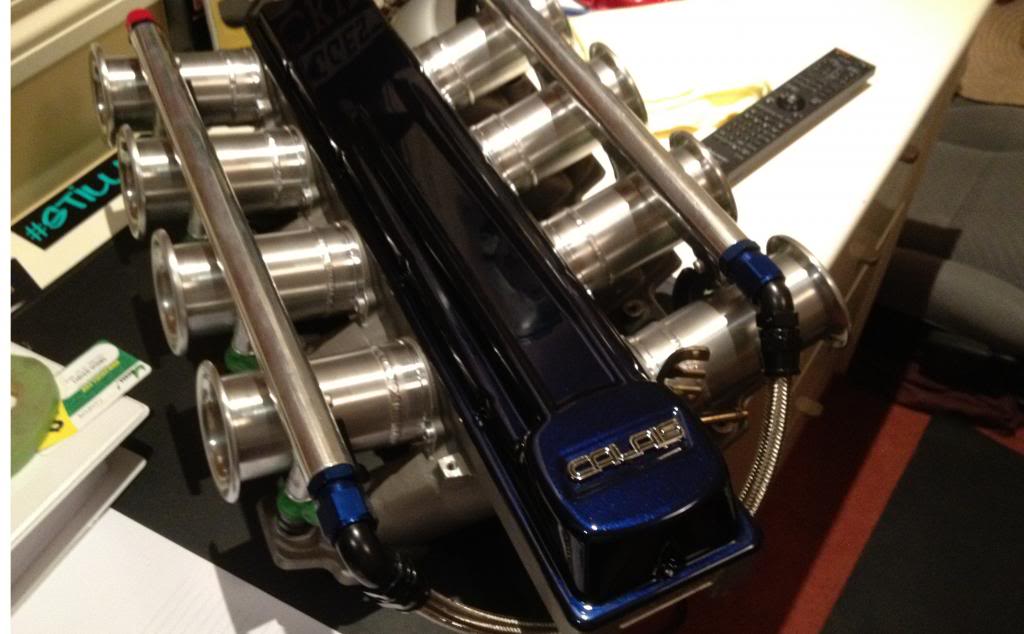

      manifold spoiler

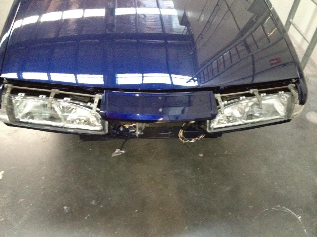

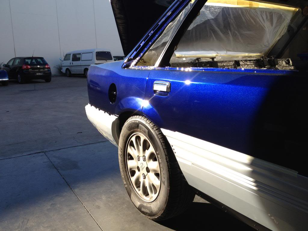

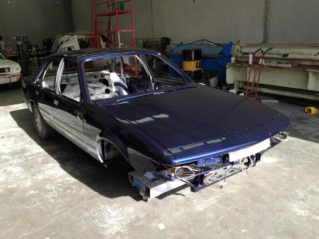

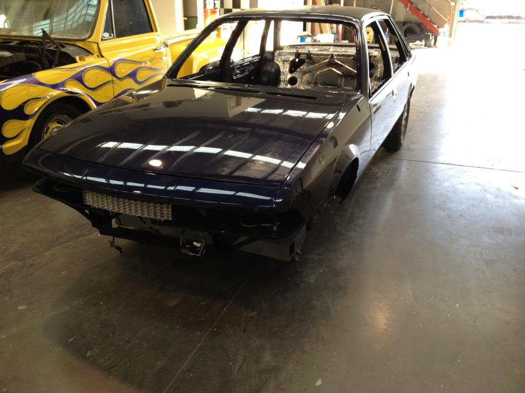

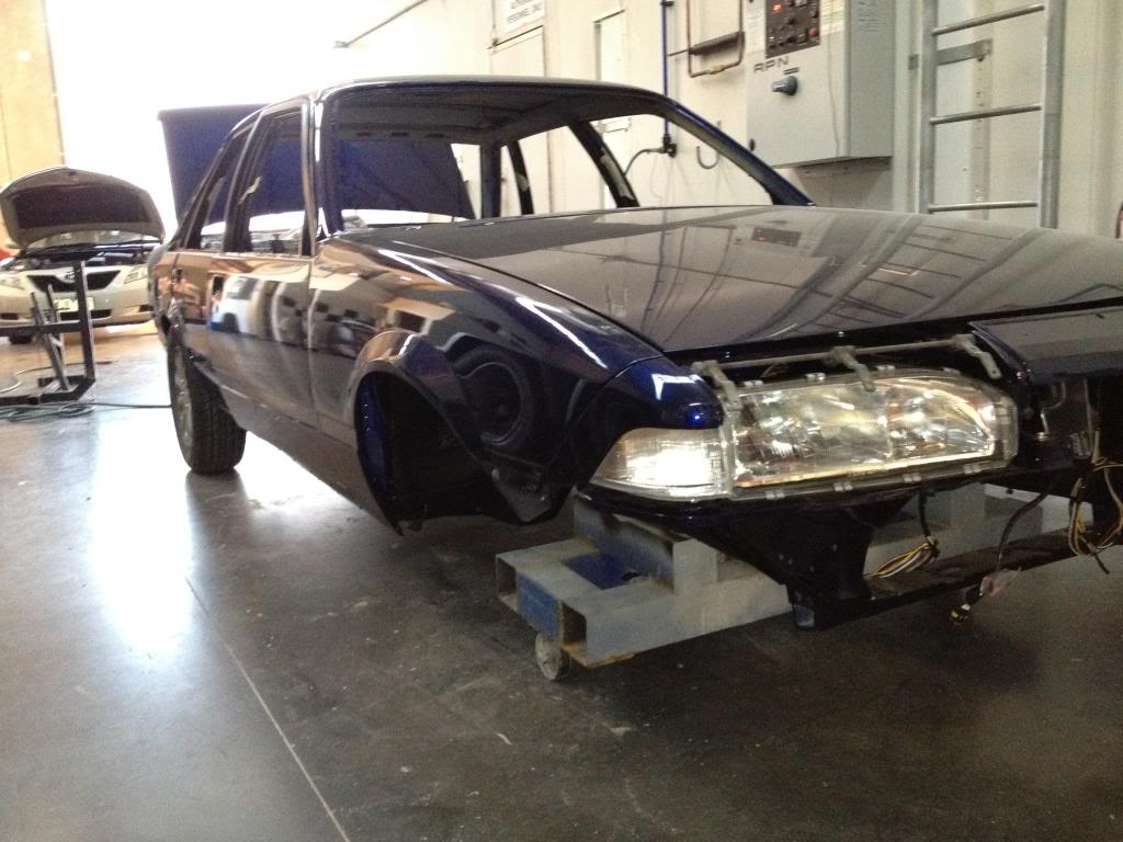

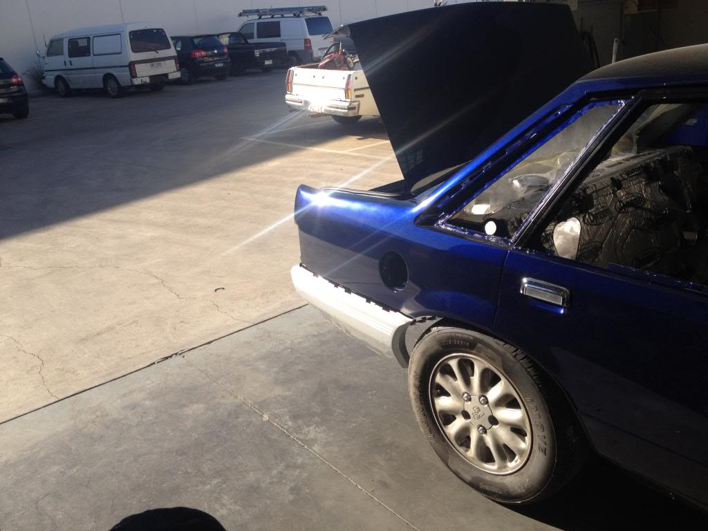

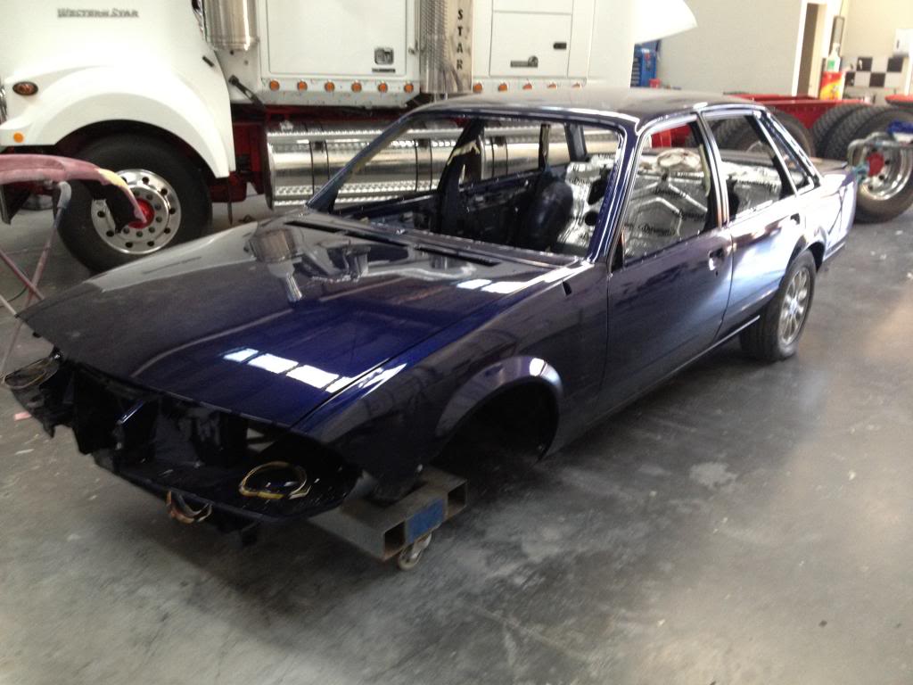

      updates got the guards bonnet boot and a bit of the front back together

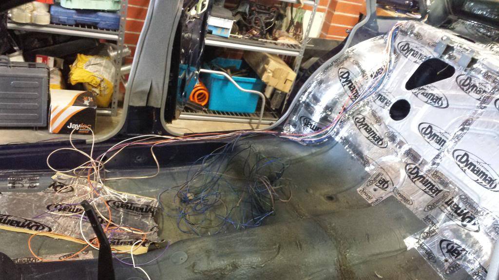

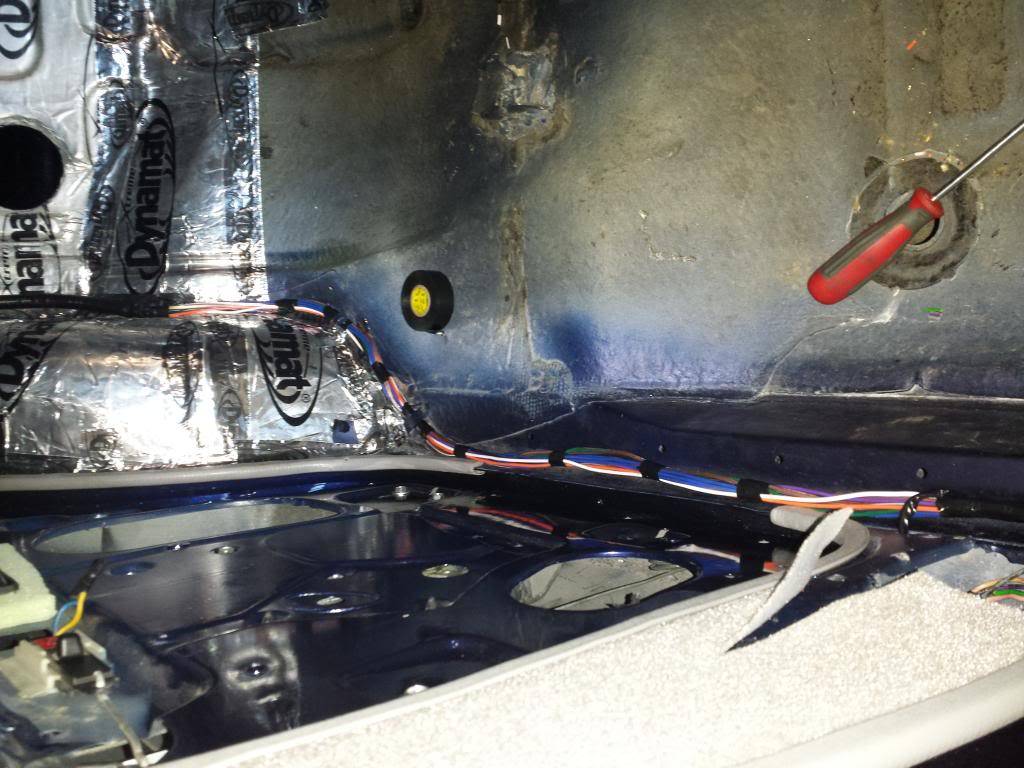

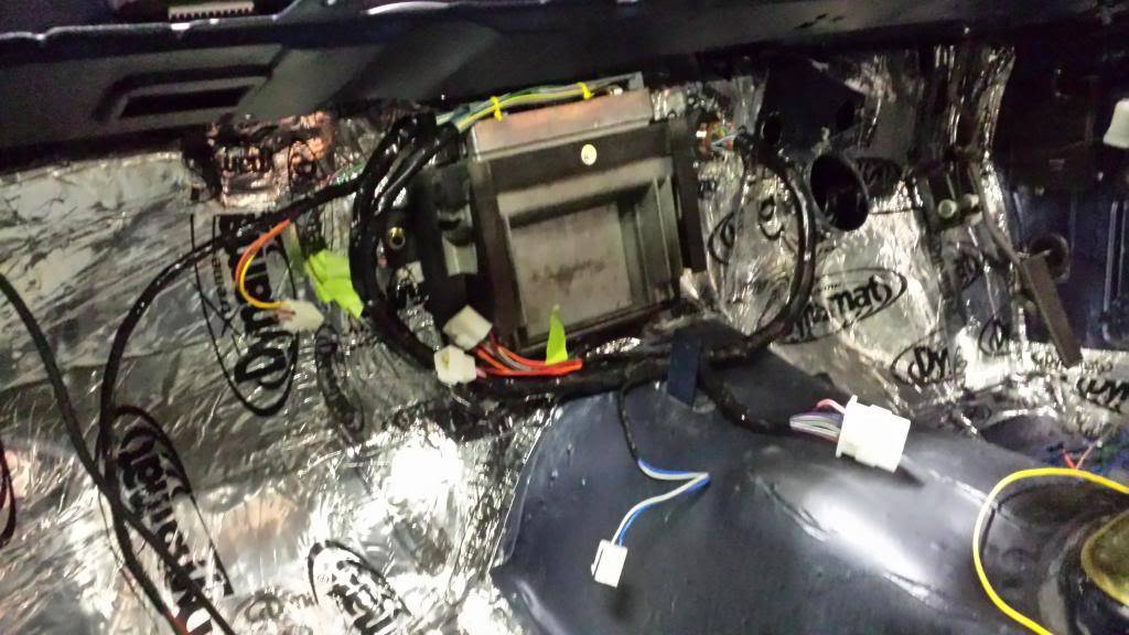

      also made some progress on scratch building my wiring loom started with the body side of the engine loom

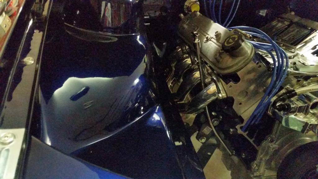

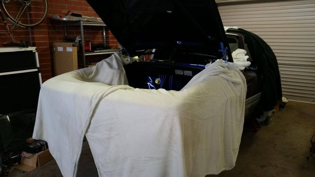

      progress almost ready to come home

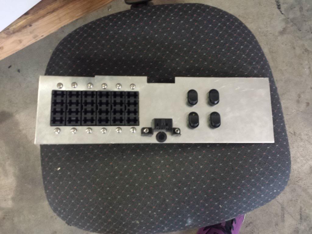

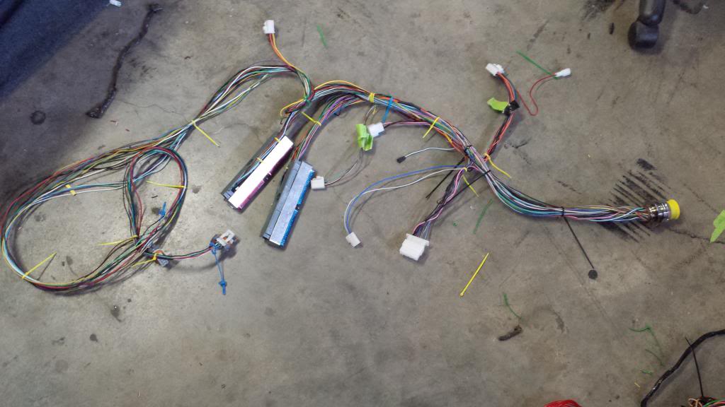

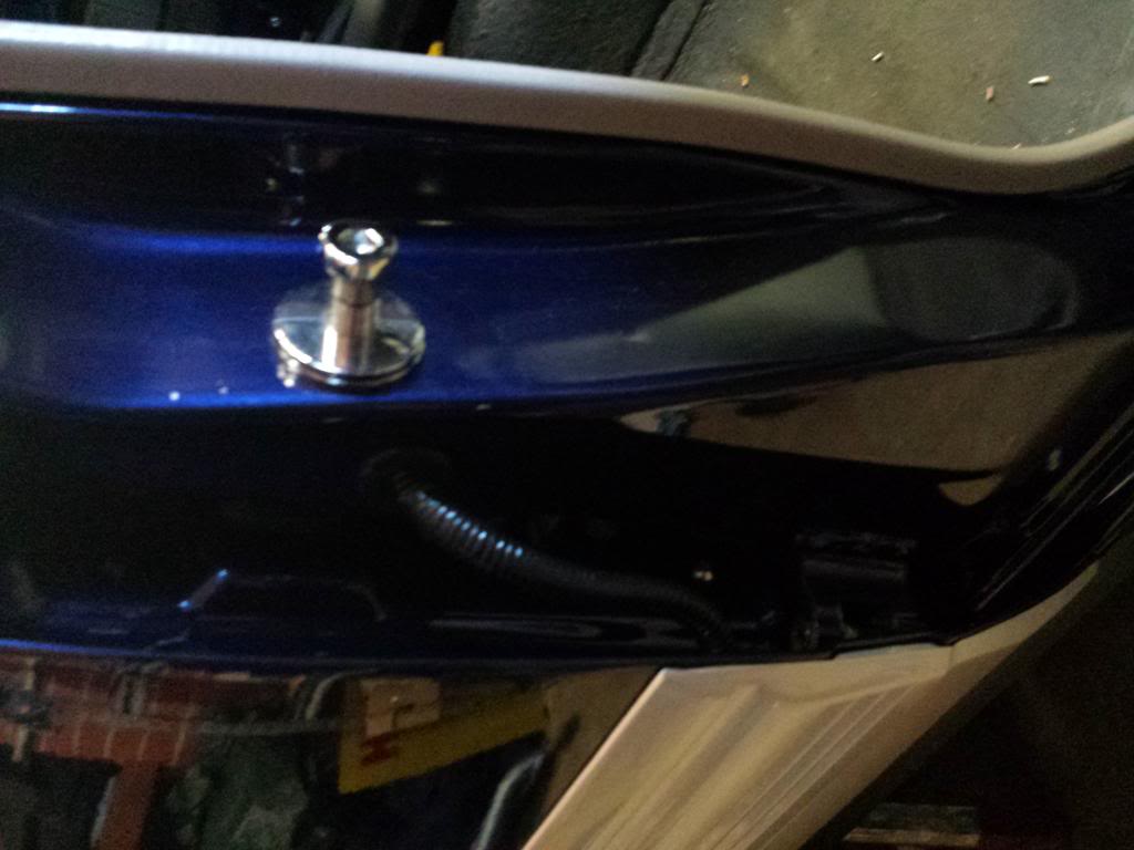

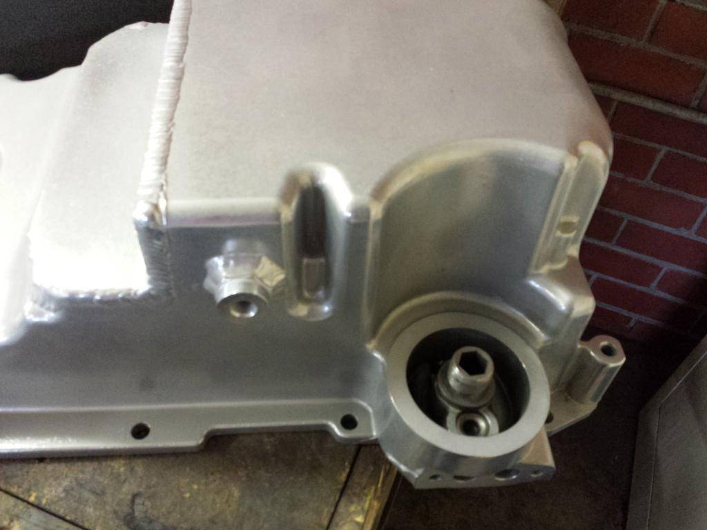

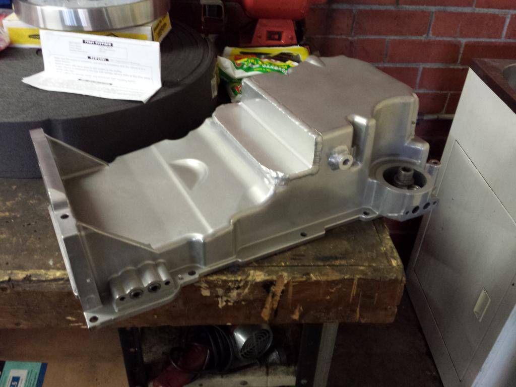

      some updates still welding up my sump (almost done ive been lazy)oncw done i can get the engine in but got some other stuff done in the mean time mounted my ecu up and installed my body side of my scratch built engine loom reinstalled my power mirror /window loom after rebuilding it and also built up my rear taillight loom from scratch and i reassembled my pedal box now i got the pedals back from being coated

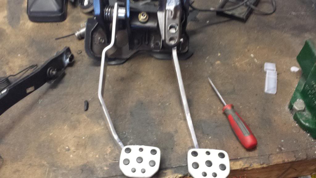

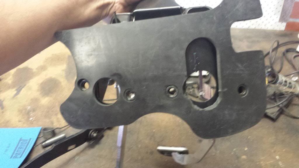

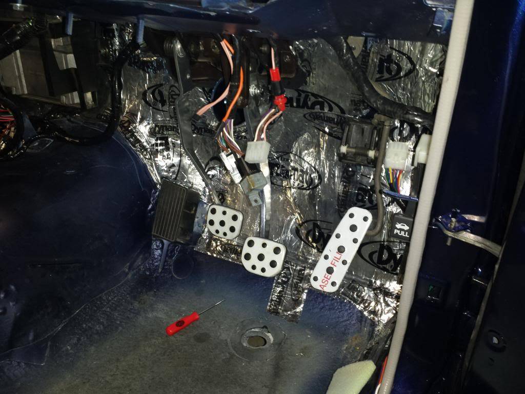

      pedal box assembled
      just an fyi for anyone who gets the ebay fire wall to pedal box rubber on a manual you will need to cut it to clear the clutch master
      installed

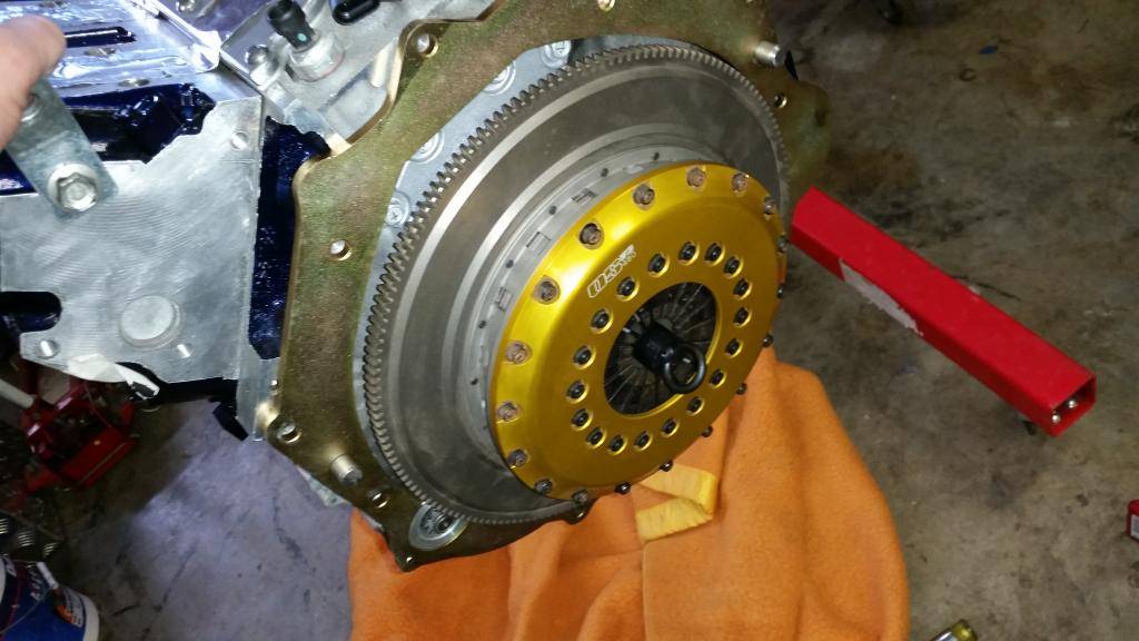

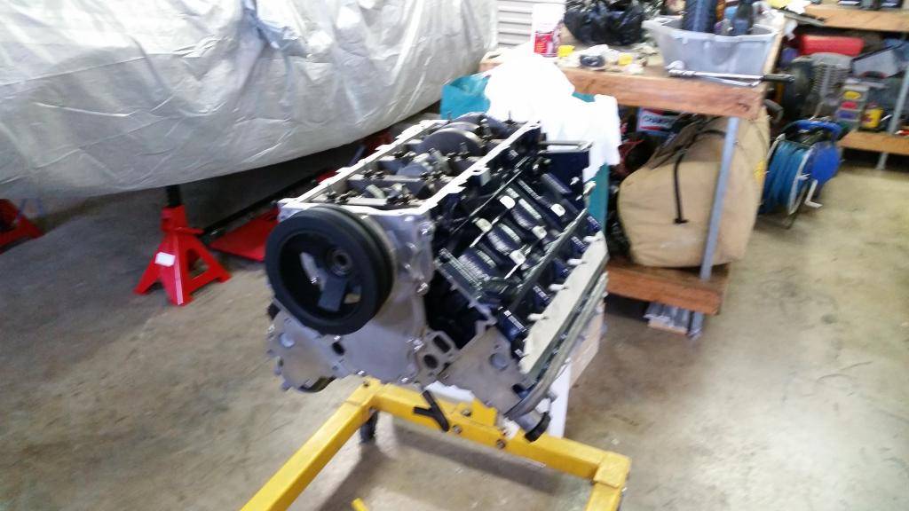

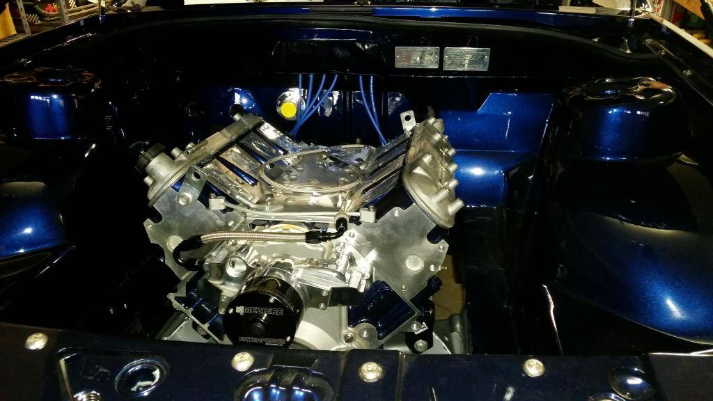

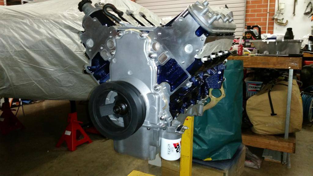

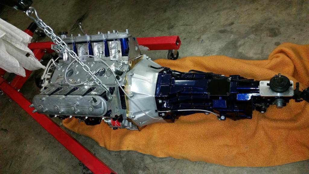

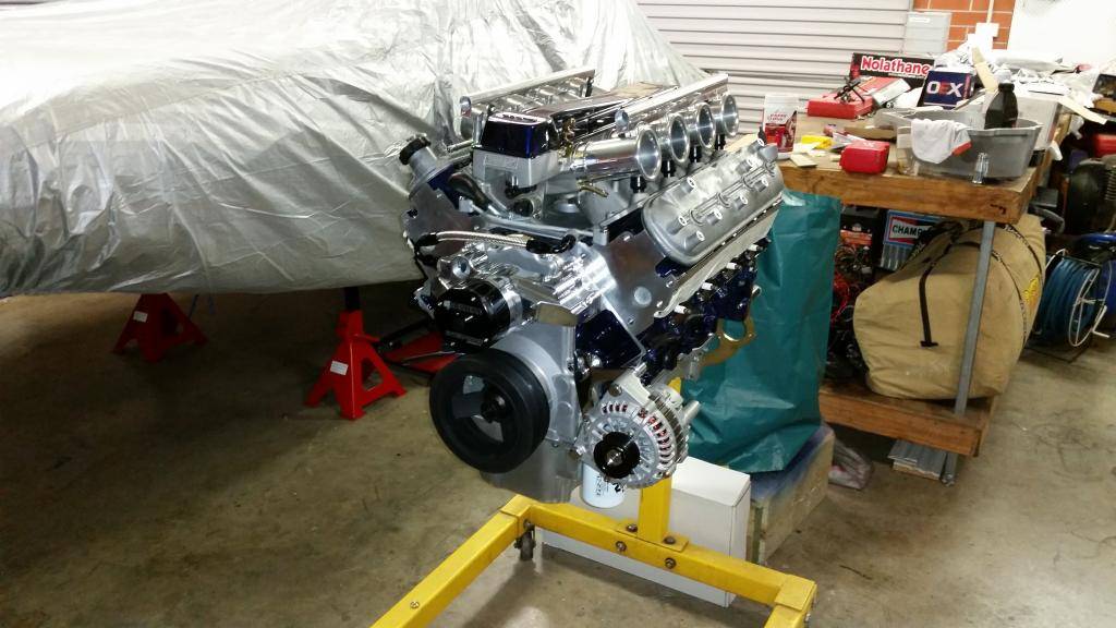

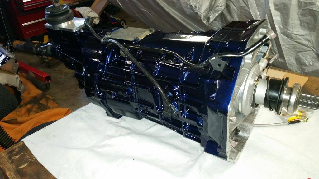

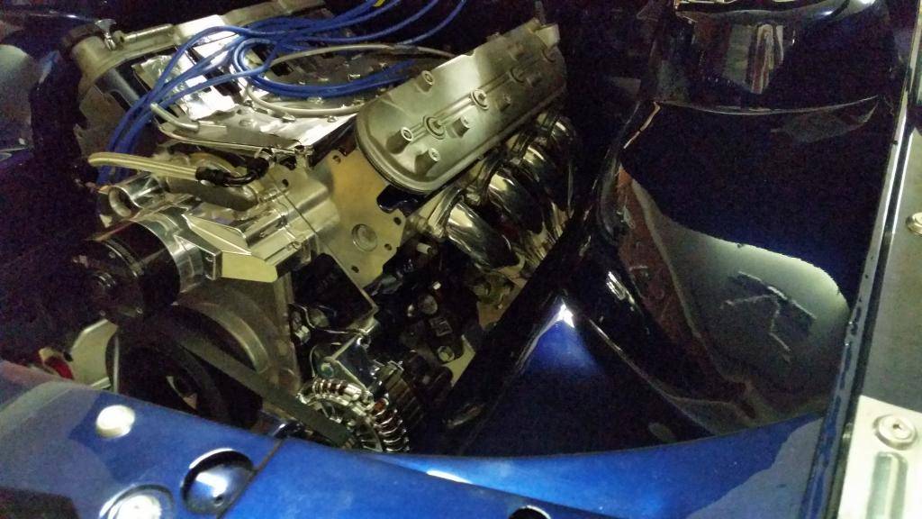

      heap of updates my modified sump is back from ceramic polishing and i had some time to make a mounting plate for my glove box fuse box and isolater switches engine is now also assembled its home built ls1 stock crank h beams forged pistons hand ported heads and a mild 224/230 112lsa isky cam gearbox is just a refreshed t56 from a holden vx ss with 100000 kms or so i was told put a rebuild kit through it inspected everything was pretty happy lets hope its good also finally got my clutch os giken twin plate installed it oh and the best part its now in the car :D:D:D

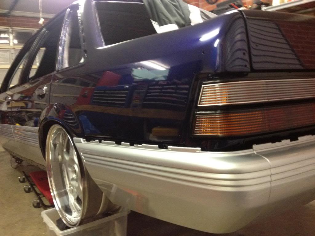

      thanks buddy heaps of work still to go, if you can tell me witch dimensions you need be happy to measure them. Also there simmons wheels made in Sydney Australia these are an fr 19 there a 3 piece wheel and they will do them in any offset stud pattern you need every set is serial numbered to incase you need to order new dishes or centres

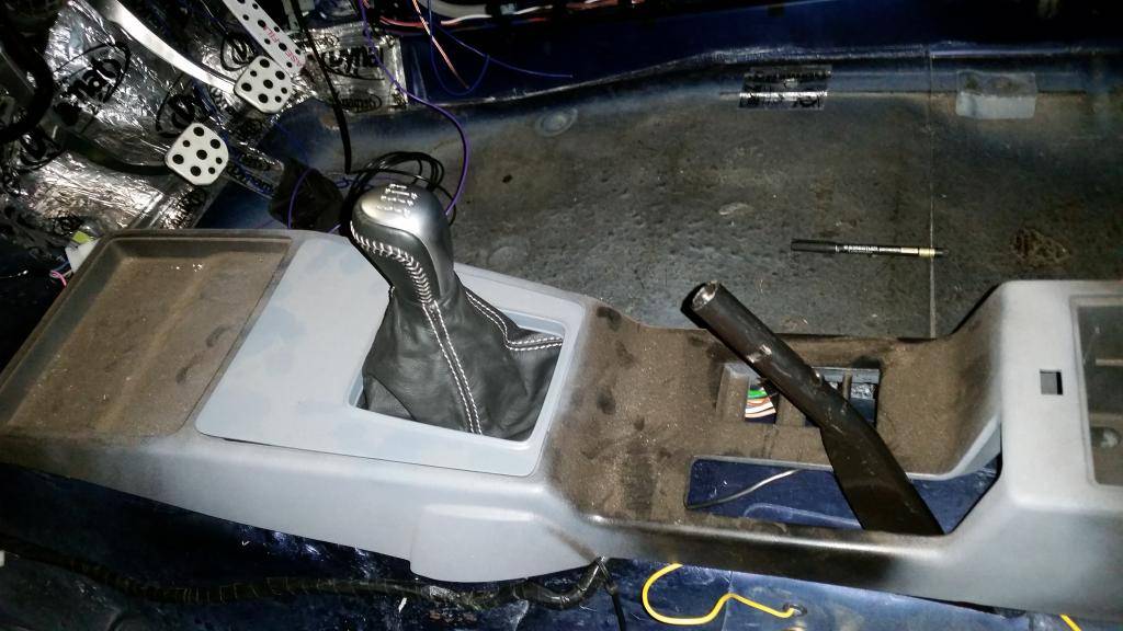

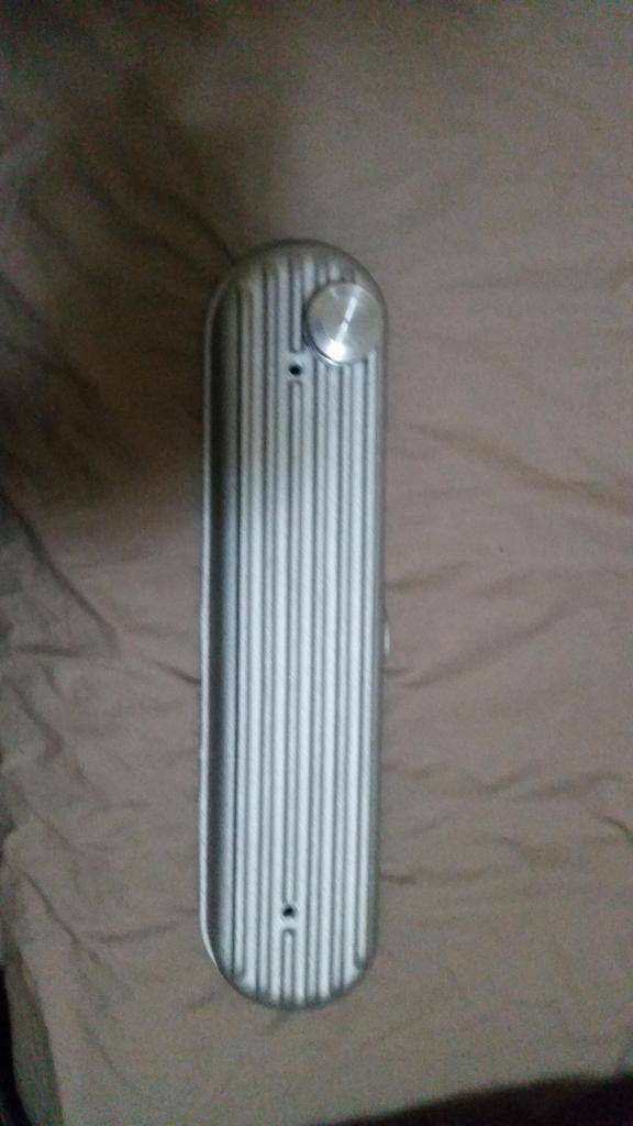

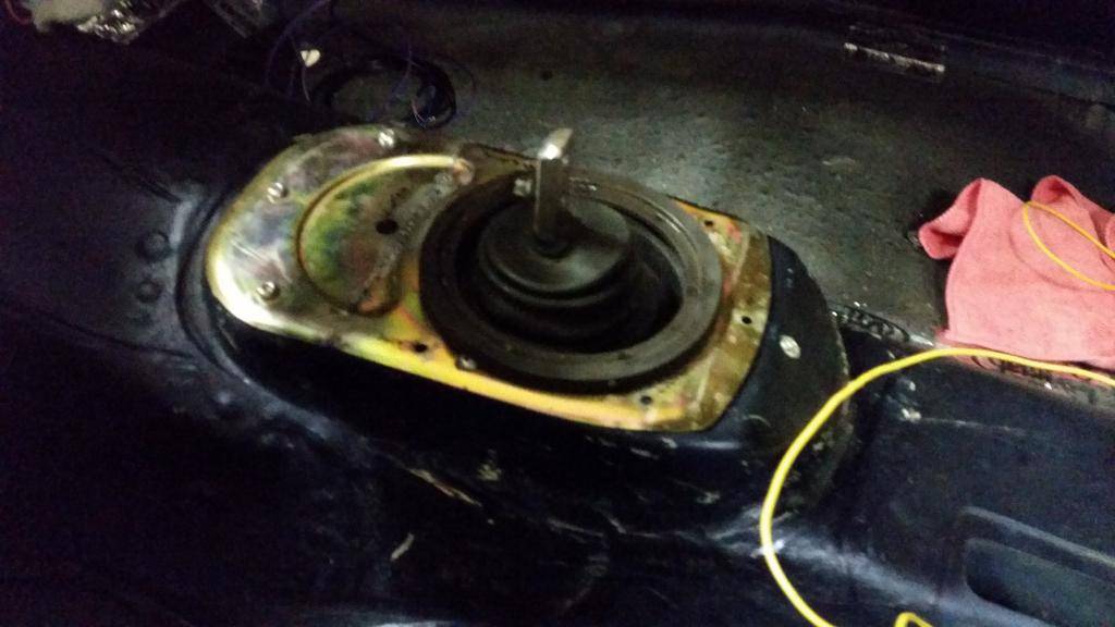

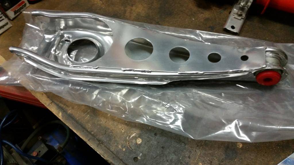

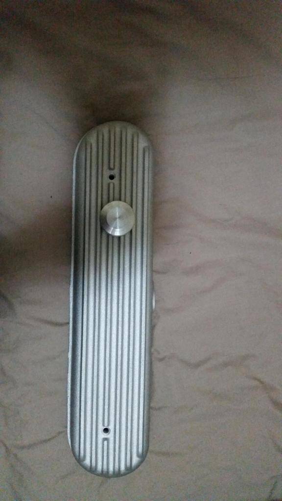

      made some small progress started fitting a few things up started to modify my shiftier plate due to the rip shiftier being further forward than i measured up no biggy it all fit the console fine but the shiftier was really high so i made up a shortened shiftier arm came up nice. control arms are back from coating also cam up sweet, ordered all my diff components summit racing alloy case Daytona pinion support and billet lsd and went 4.11 gears which i've heard is pretty good for a ls1 t56. my rocker covers landed FINALLY but i didn't realize they don't come with a fitted oil cap so i need opinions people look at the rocker covers below tell me which oil cap position you prefer option b is my pref but i need opinions.

      option a
      option b
    19. #59

      Where is the ITB manifold from?
