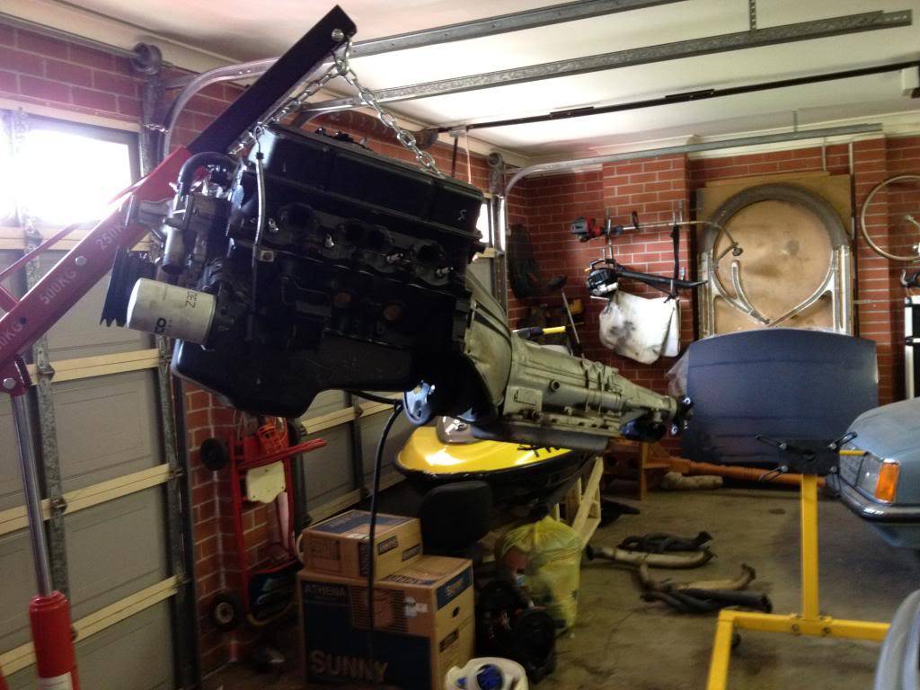

      stripping out comes the old drive-line

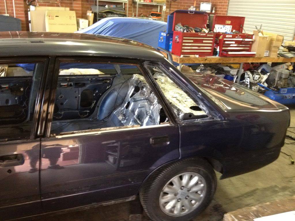

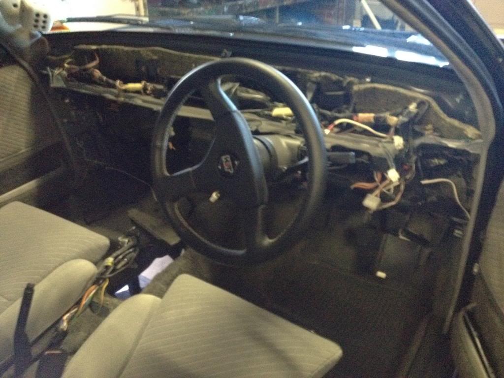

      interior stripping

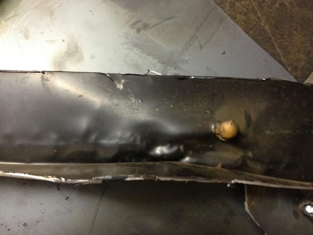

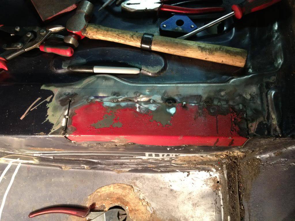

      found my car had been in an accident in a past life they did some excellent repairs on the quarter panel and door but neglected the spare wheel well they decided to fill with filler :/
      wet down to u pull it and got a new piece tacked it in i dont have a photo of the finished repair

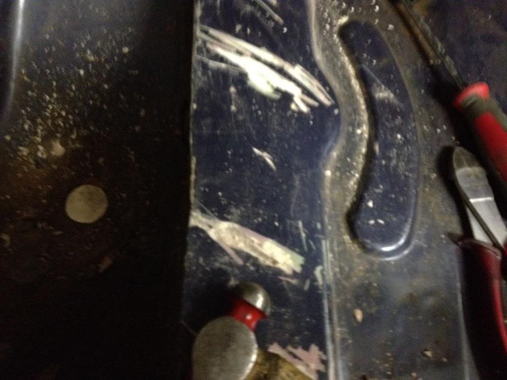

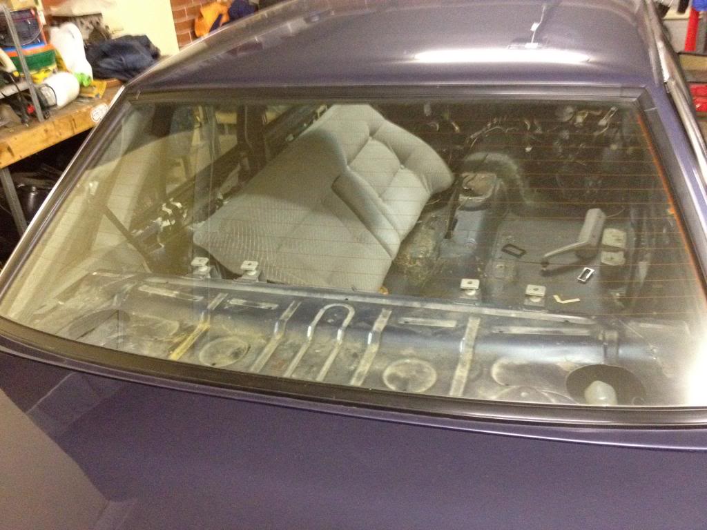

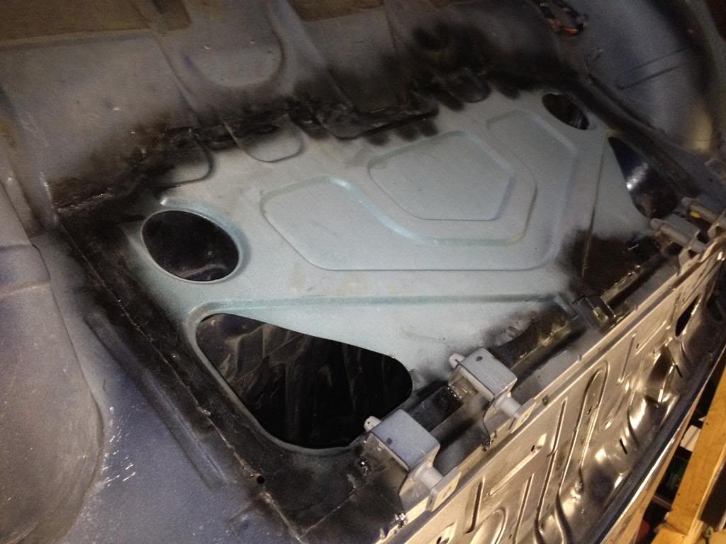

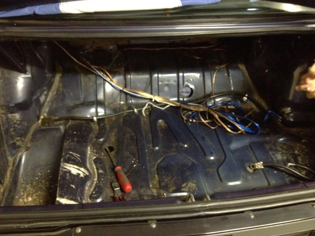

      noticed the previous owner cut out some of the boot interior separator for a sound system
      again a trip to you pull it
      fixed

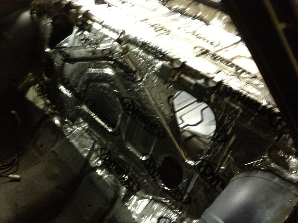

      and dyna mat

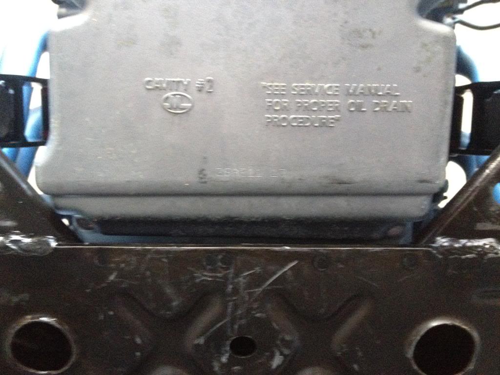

      test fitted gear box and extractors everything fits quite well just need to modify sump for more k frame clearance

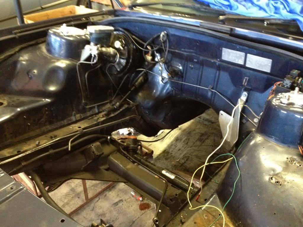

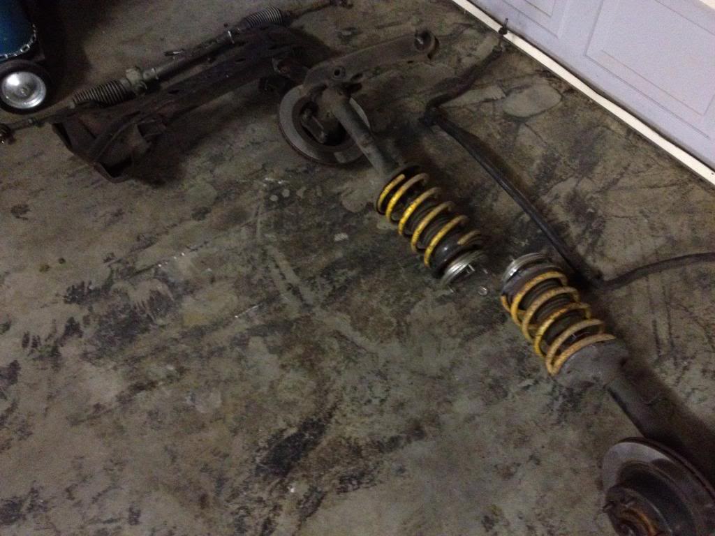

      pulled everything back out removed k frame and suspension for over haul

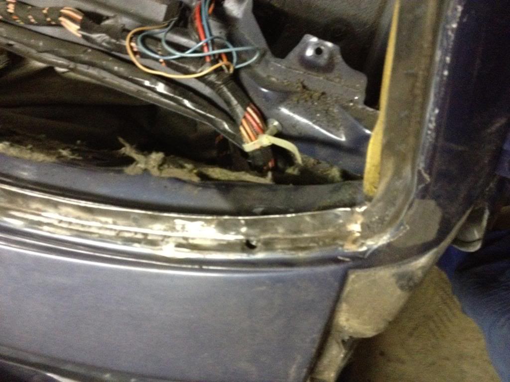

      found some small rust under my windscreen (hole on the right is meant to be there as a drain hole the hole on the left isn't rust hole) rust around front and rear screens is pretty common on these.

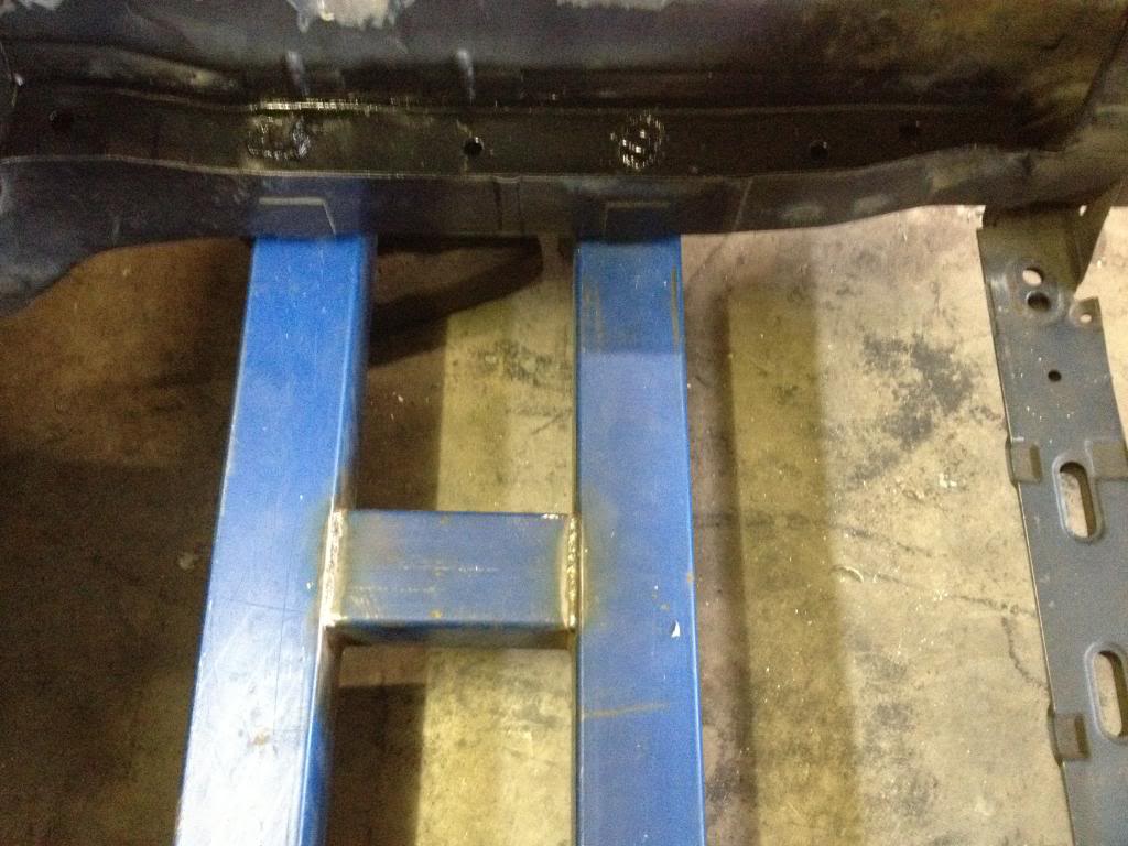

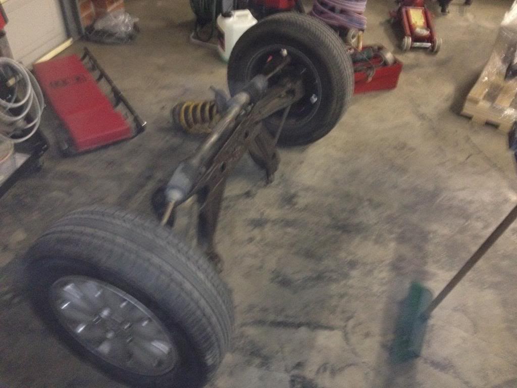

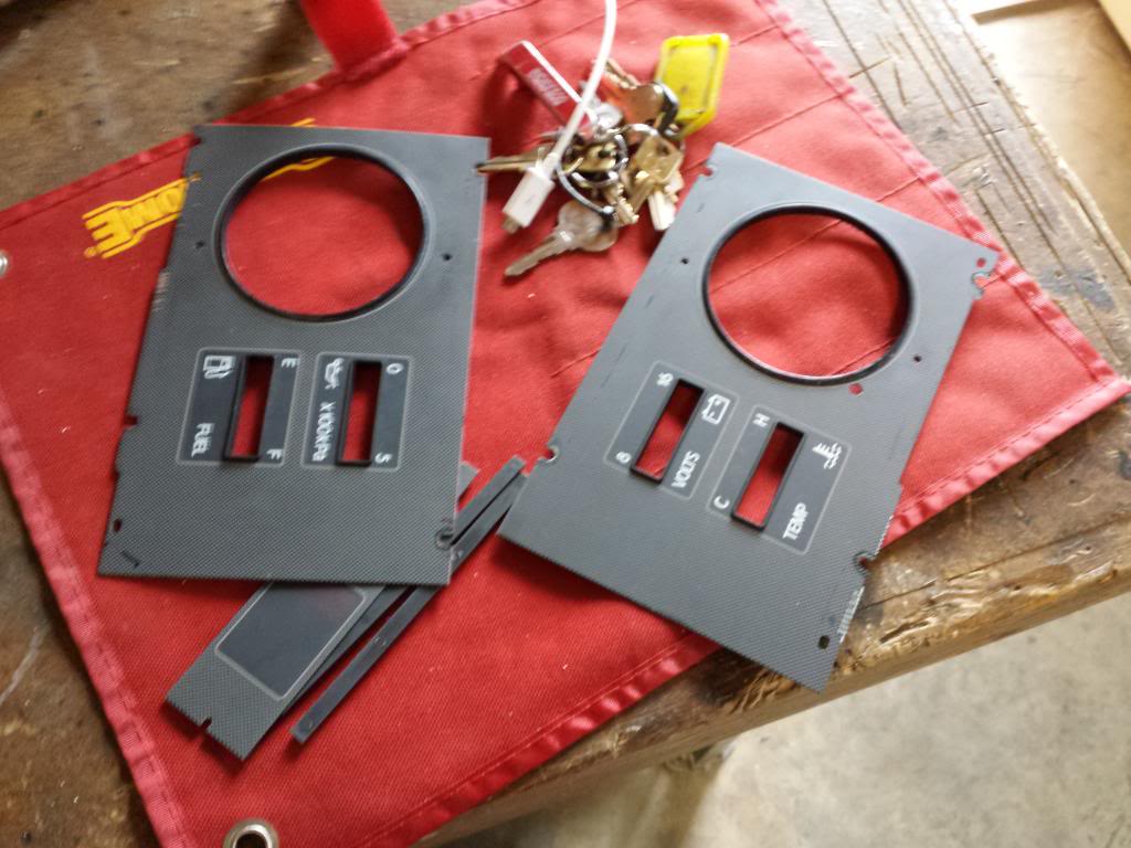

      built a trolley to keep the car mobile for the minute also triped the front end and done a bit more work on my dash cluster ive put a picture of the factory dash to compare ive fitted autometer gauges into my factory cluster and rapid prototyped some dash fachia parts still a little bit of work to go but im happy so far

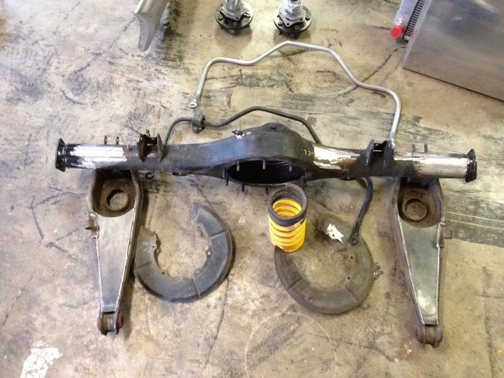

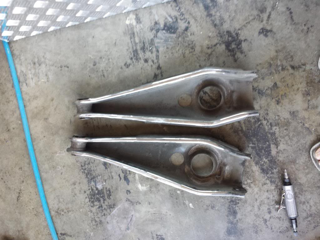

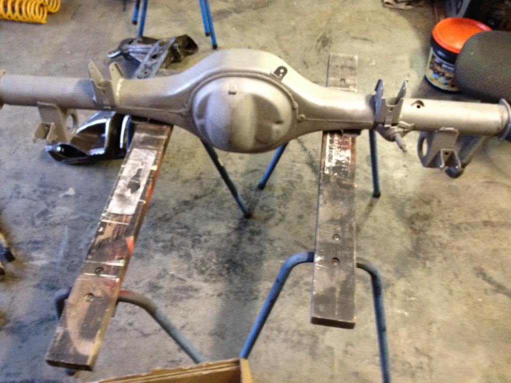

      did some work on my nine inch setup today im not running tubs or a hugely modified rear end due to our road laws here im a bit limited but ive shortened it 1.5 inches and cleaned up my factory tubs which means i can fit a 19X9" rim and possibly a 275 tyre i spent most of the day today cleaning up my diff housing i also boxed up my lower control arms to hopefully make it a bit more rigid up back
      my diff housing is originally out of a f100 unsure of the year housing is cleaning up ok but ill get it media blasted through the week

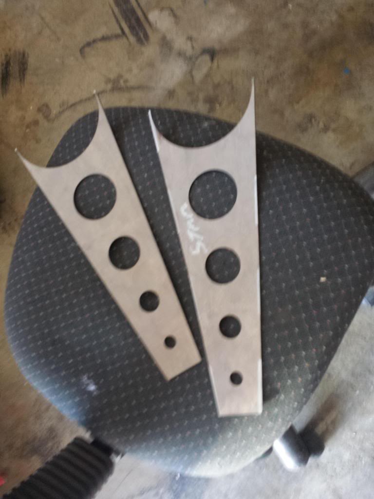

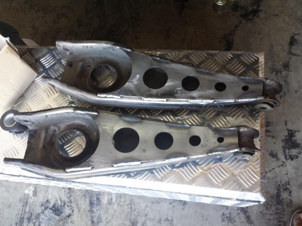

      well update time i decided my trailing arms i boxed were not up to my standard so started from scratch, reason for boxing these is because people have had problems with bending these arms under high hp launches with slicks i've even seen pictures of them bending on dyno's. I had another set of arms here so i pulled them out they were earlier arms which is no problem because the only difference is a spot welded bracket on them for the hand brake cable so off that sucker came
      here's what happens when they bend hope no one minds sharing a link
      http://i73.photobucket.com/albums/i2...103_153447.jpg
      got some plates laser cut this time was so much easier than hand cutting also looks heaps neater

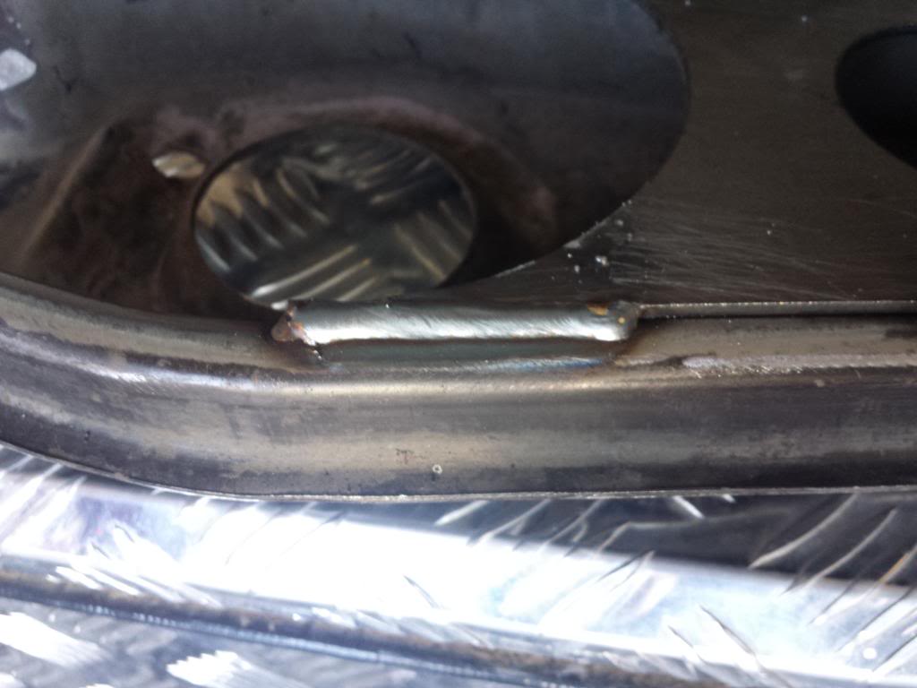

      tacked and stitch welded them in i didnt join the welds due to potential for cracking along the welds
      my welding its average i know but any pointer's that can be given is great still kinda getting used to my new mig

      got my diff back from media blasting came up pretty good

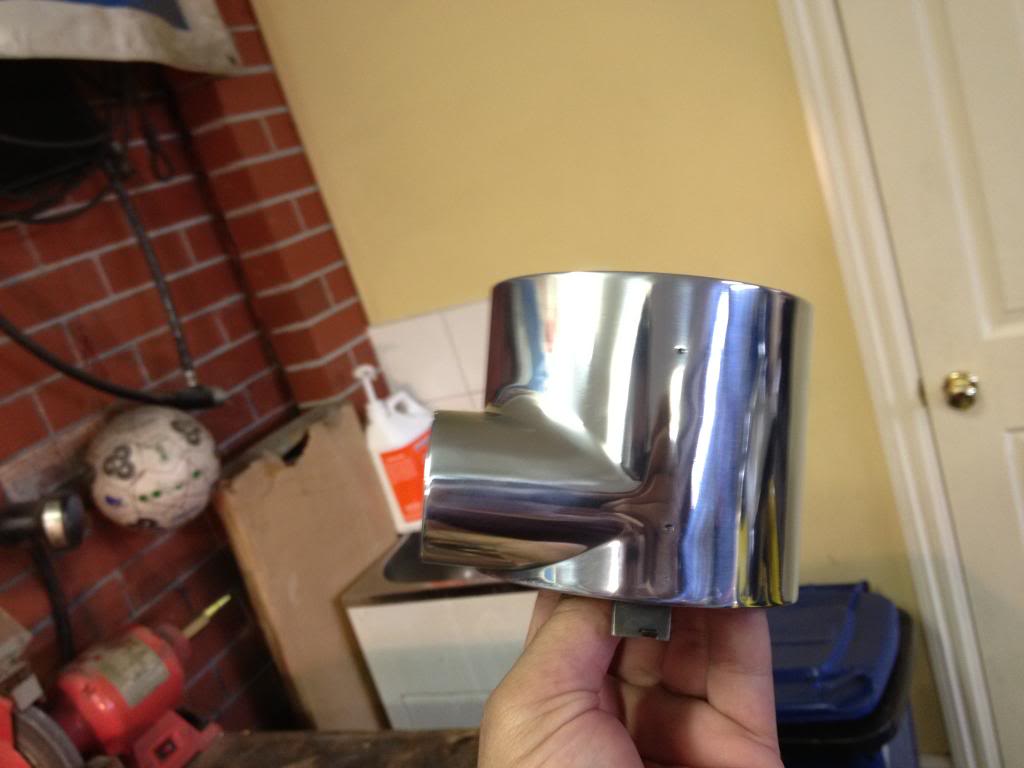

      also disassembled my steering coloum to solid mount my shift light if you haven't seen these gizzmo shift lights before there such a sweet piece of gear carbon fiber super light and don't take up much space perfect for where i want to put it. i also polished my steering coloum the visible portion anyway came up pretty nice :D.

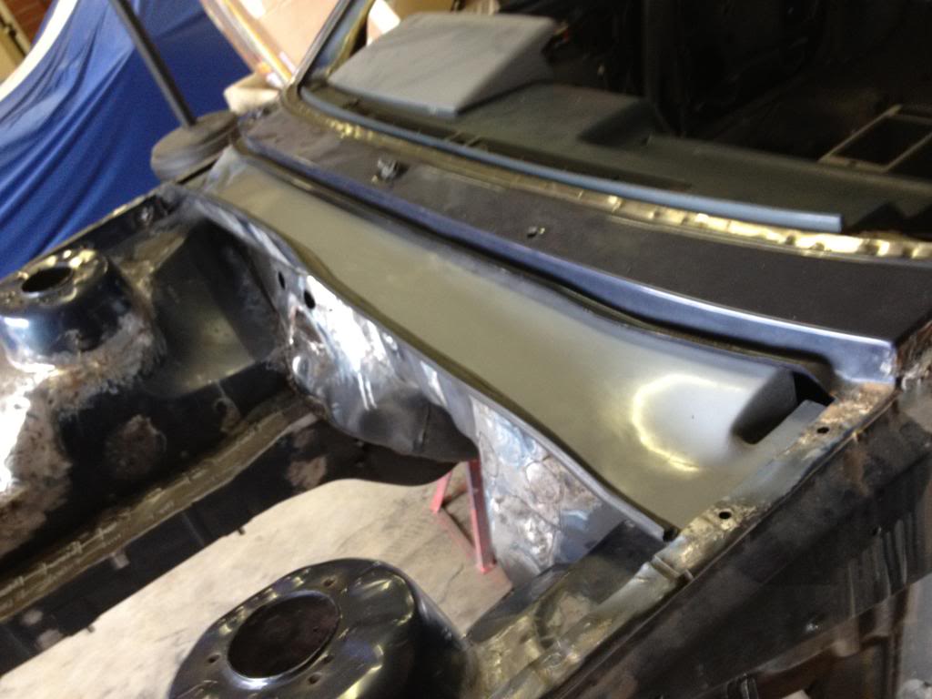

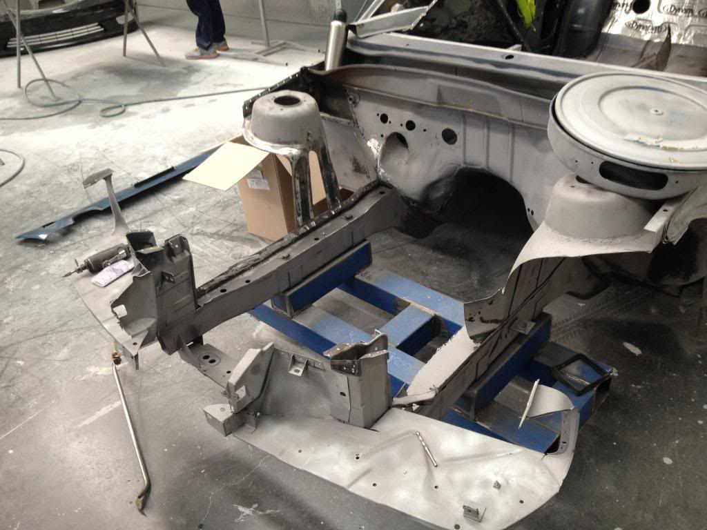

      got the car back from blasting and off to a mates panel shop i wasn't happy with the engine bay so we pulled all the spot welds and removed the strut skirts blasting showed up a few previous repairs that i didn't know about so i picked up an arrow straight donor front cut off a 80,000km wreck for the strut skirt panels no one makes any repro panels for these that fit so gotta do what you've gotta do
      heres the front with the skirts removed

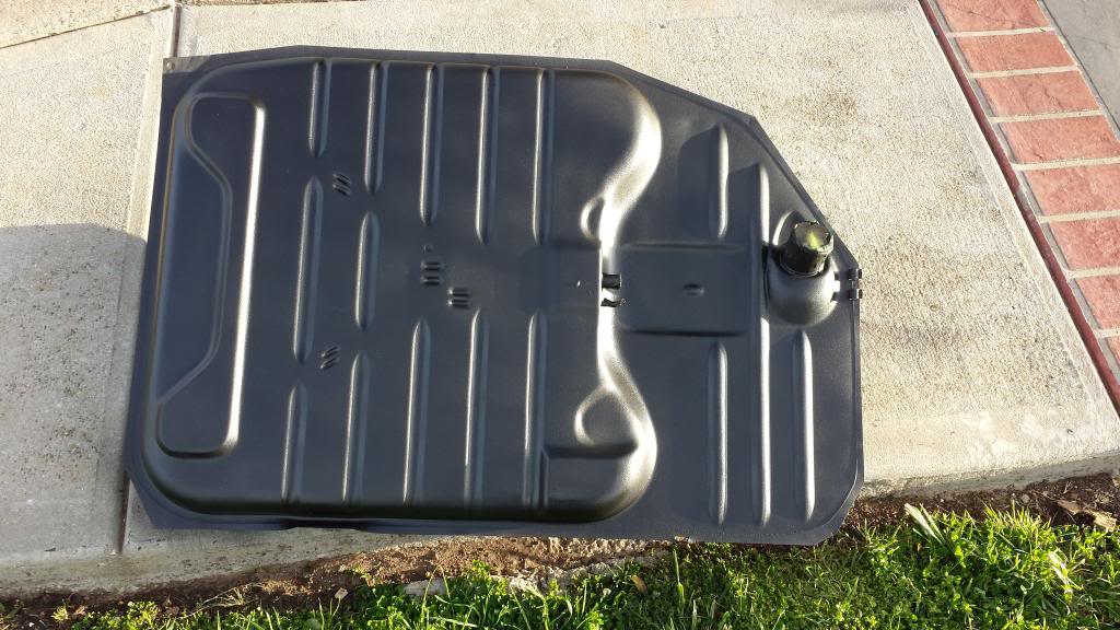

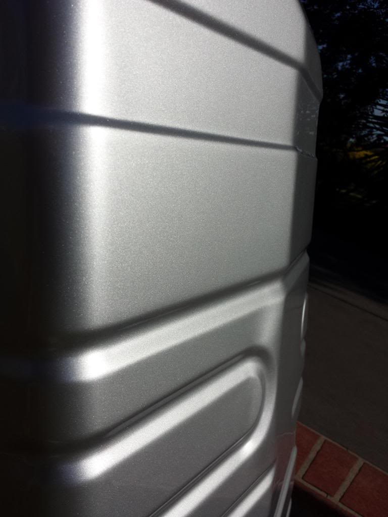

      also began cleaning up the fuel tank i bare metaled it then used a steel filler to fix a couple of very shallow dents that would have annoyed me. the tank i used is off a later model vs commodore i didn't want the 90l factory tank so the 80l was the next best option to reduce a bit of weight still hold a fair amount of fuel and gain a little ground clearance it also has a slightly better swirl pot setup. Only thing ill have to to to fit it is make new tank straps to suit the shallower tank other than that it will fit as factory BONUS
      i also sound deadened the top of the tank where it contacts the body

      small update been working on the shell will have pics up soon but we got the tank high filled and all painted up came up pretty sweet colour coded it to the wheel centres
