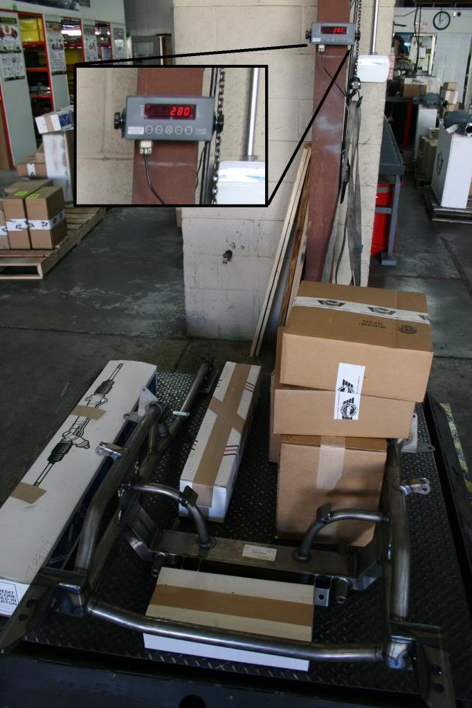

      TCI Engineering - 280lbs shipped weight inc transmission cross member
      If i have missed any please advise, if you know the weights please post in the thread.

      Here is our shipping weight of a complete front end, actual weight will be slightly less without packing material. This also includes the transmission crossmember.
      -Jason
