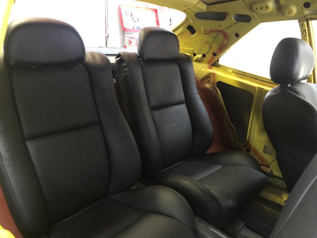

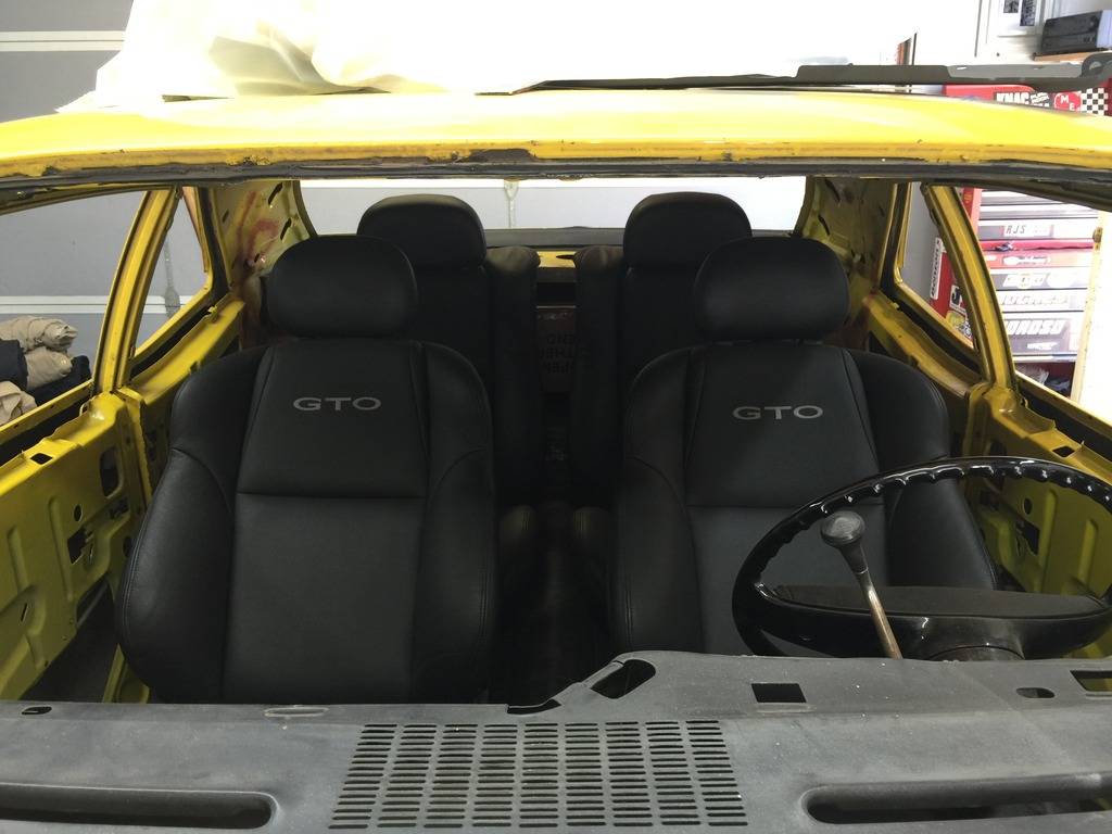

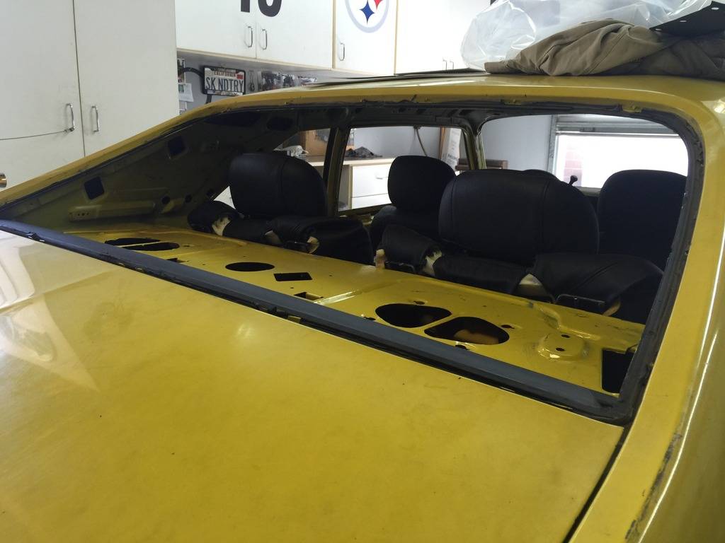

      Finished up fitting the top portion of the GTO back seats in the car this weekend. I started by removing the back padding behind the headrest, formed it a bit, cut some of the frame of seat and welded a pad to the floor with a nut to where both seats will bolt up. Will need to have both top back seats and the front seats sent to have some upholstery upgrades done to them. Next will finish the firewall behind the seats to complete this task, was tired of climbing in & out of this car lol.

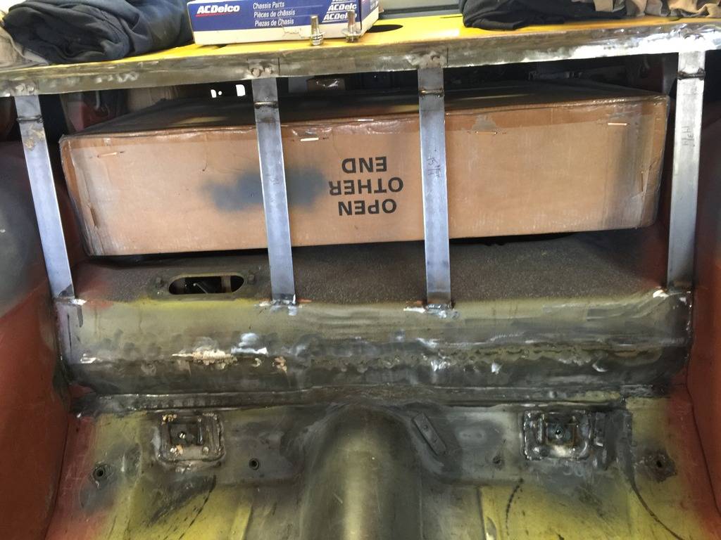

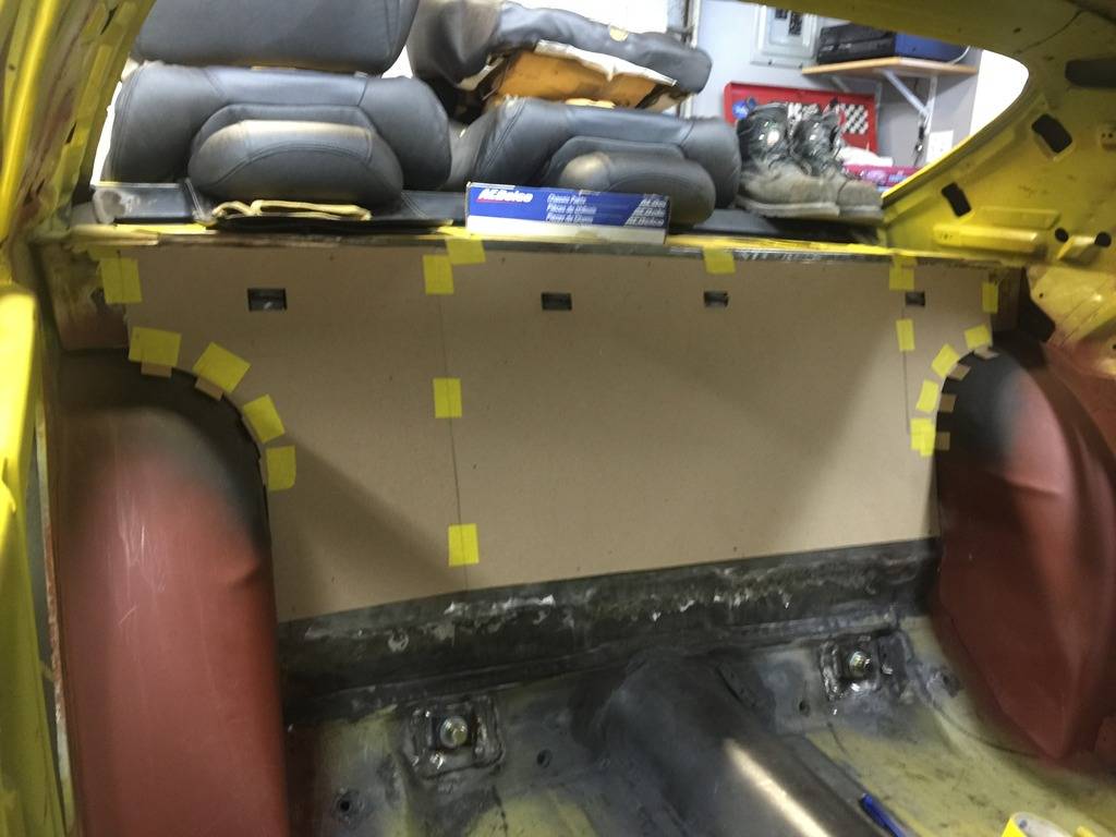

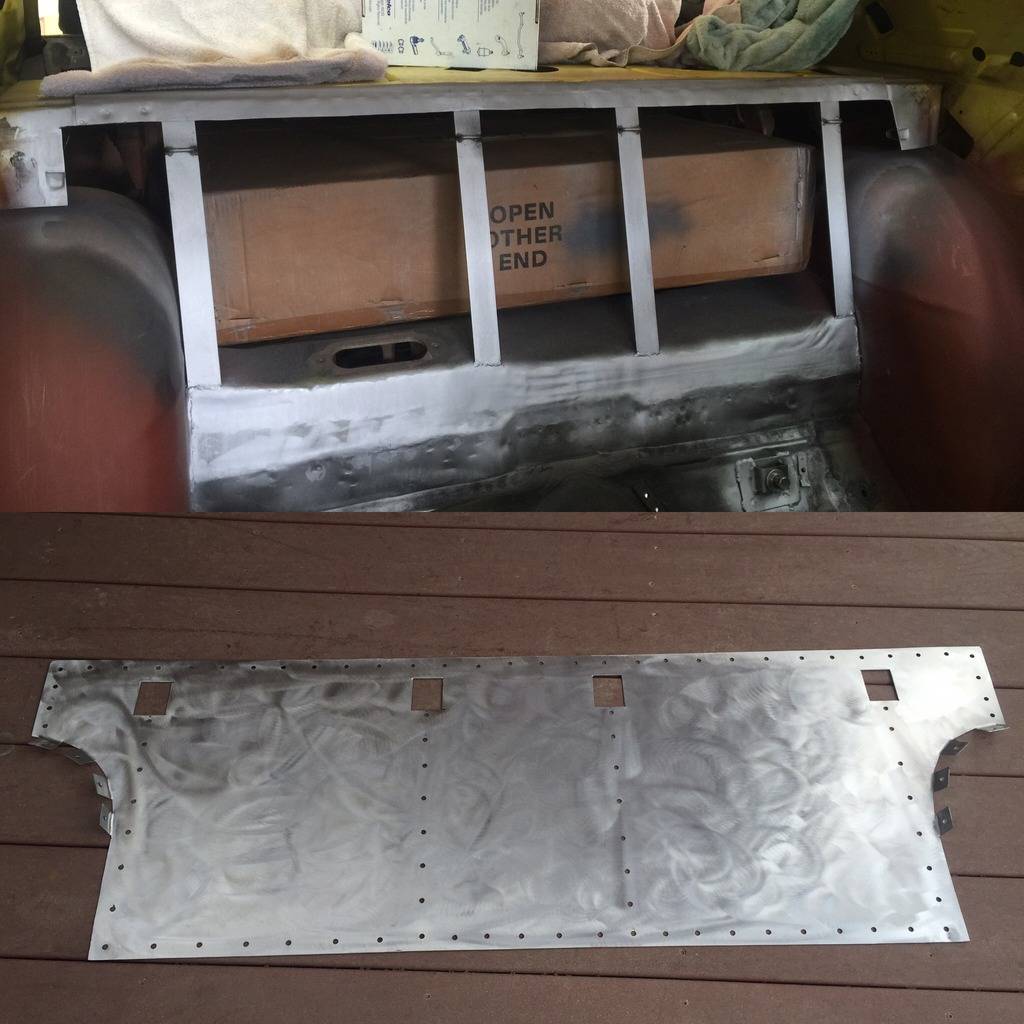

      Well it has been a while since I've done any work to the Nova, but have been getting parts tho. Anyways had some time off today from work so I decided to make the divider between the back seats and trunk. Got it all ready for spot welding in place. Now that's for another day.

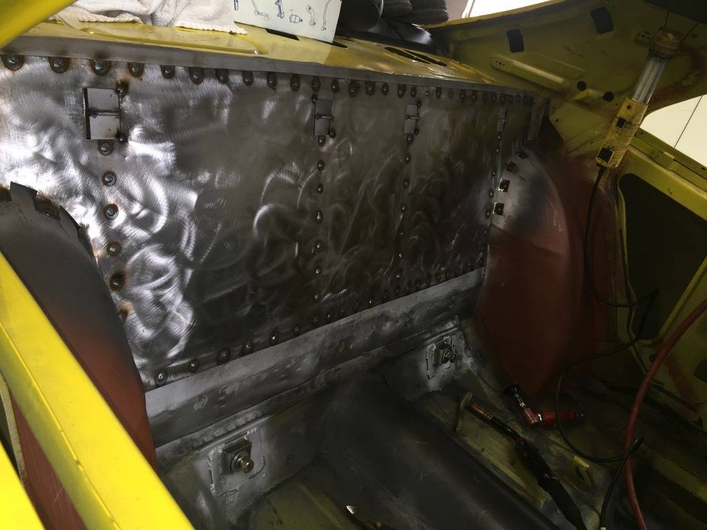

      Well after a busy day with son's baseball picture day I finally had time to finish up the back seat divider. Finished up all the spot welding and cleaned them up. Installed the back seats again and decided to take five on them for a few second lol. I bought a steering column from a member here and waiting for my steering wheel also purchased from another member. Will post photos once I've received them. Will be fitting up drivers fender tomorrow and see how she fits compared to the original that rubbed when the wheel was full left. Hope it clears so I can move on to the fab work on the inner fender wells. More to come ? stay thirsty my friends lol

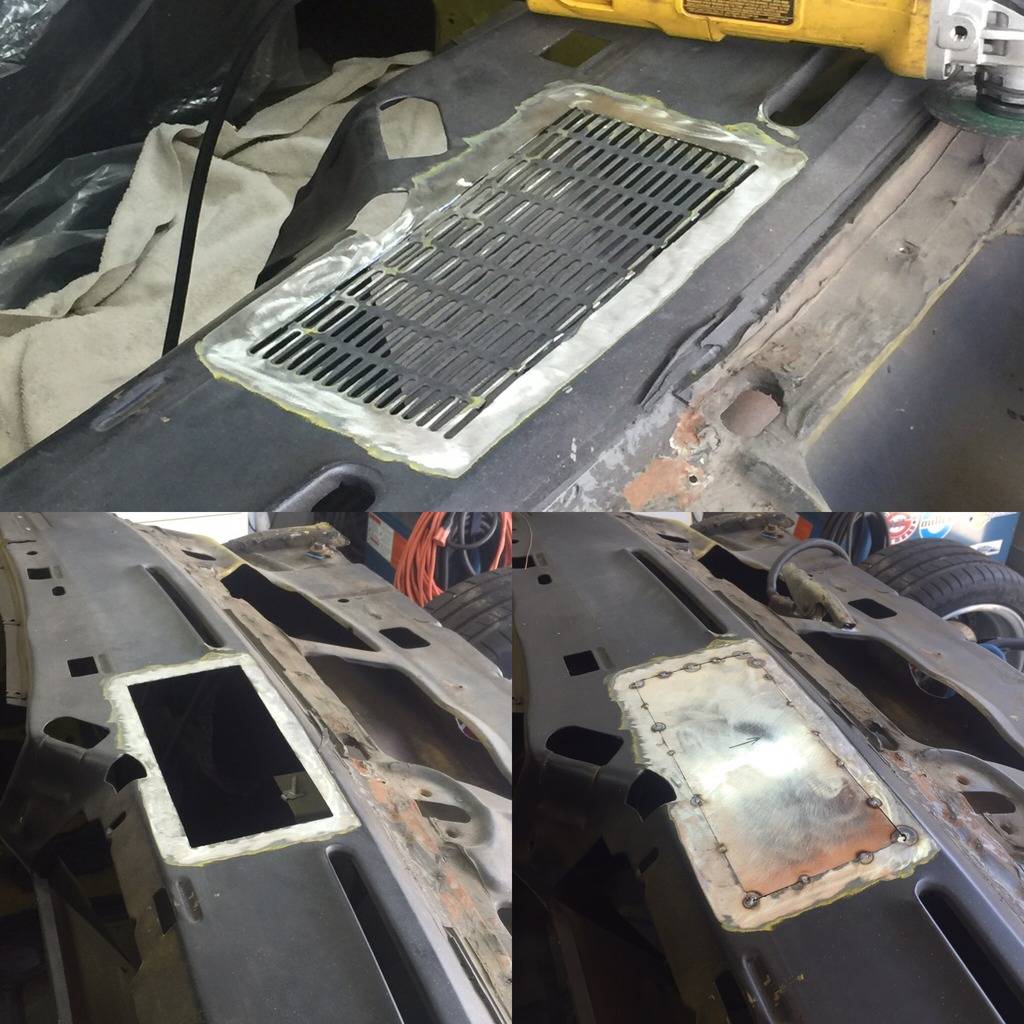

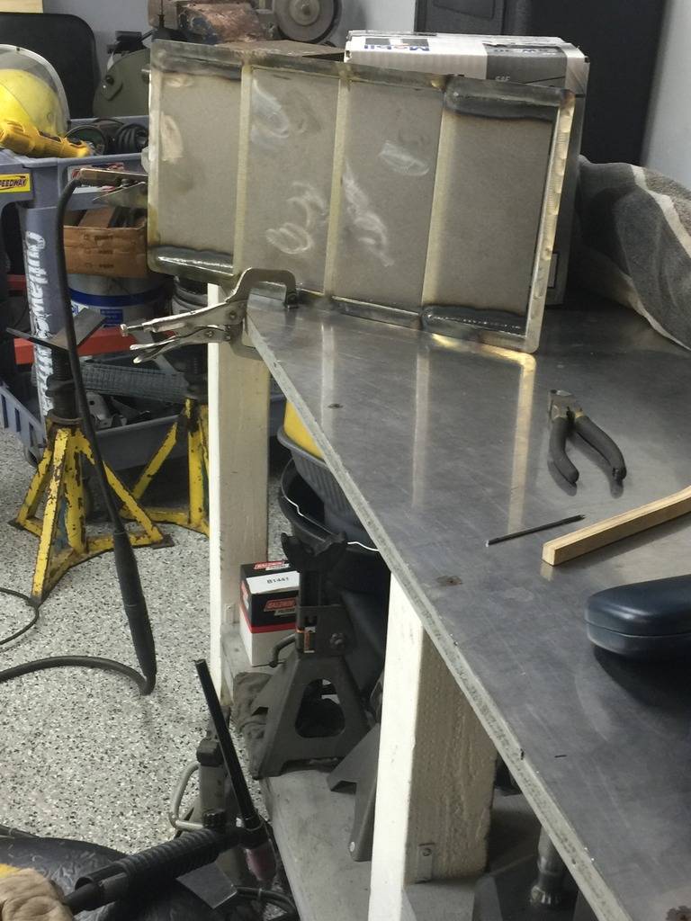

      A little more progress. Started by cutting out the speaker sheet metal at the dash and filling in with a solid piece. Wanted to get some practice on my tig with sheet metal before I tackle the hood with some vents. So far so good. Still waiting on parts and time so I can continue with other things to do. More to come.

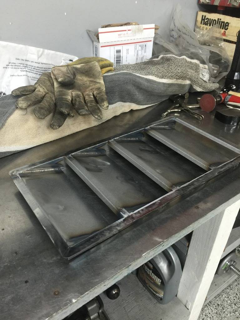

      Working late lol. Did some final welding on my hood vents, not bad for the first one. Hopefully the second one comes out a little better. Hmmm wonder if I need some more beers lol

      Great job on the fill! That's thin material, and it looks like you had barely any warping.

      Awesome progress! Are those FrankV's vents that you welded together, or did you make them yourself from scratch? That's the exact style of vent I want to put on my non-cowl hood, so I'm really interested to see how they look turn out on yours.

      Thanks Centerforce. Yes very thin lol but I managed to keep somewhat straight. I had to use dolly hammer to bang out the little waves. I messed up on deleting my side markers with mig and now the body guys will have to fix that lol. So I tried tig welding this time and my test subject was that speaker sheet metal on the dash. Wanted to get a handle on it before I tackle the vents on a new hood.

      Yes those are Frank's vents, but I bought them tacked only. I figured I can weld them or fuse them myself. Wasn't an easy task on the first one. Was having issues, but finally managed to finish it up. I'm excited to see how they turn out or I ruin a perfectly good hood. Still a ways from getting to that point.
