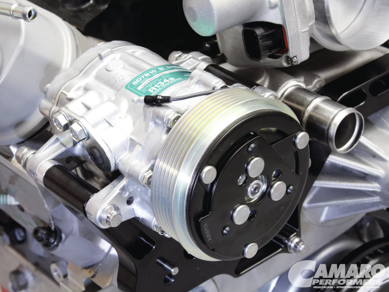

      I have the Holley bracket with a Sanden SD& compressor that looks like this:

      To me the way the fitting fits on the compressor looks like there will be more clamping pressure on one side. Has anyone had any issue with this type of fitting leaking?

      Should be no issue with leaks if the flange is seated.Offsets crews have been used for years (I first saw them in 1986.) The seal is effected by O-ring compression, and as long as that compression ratio is betwen 10-20% (defined by the O-ring diameter and the gland shape) the joint will seal.
