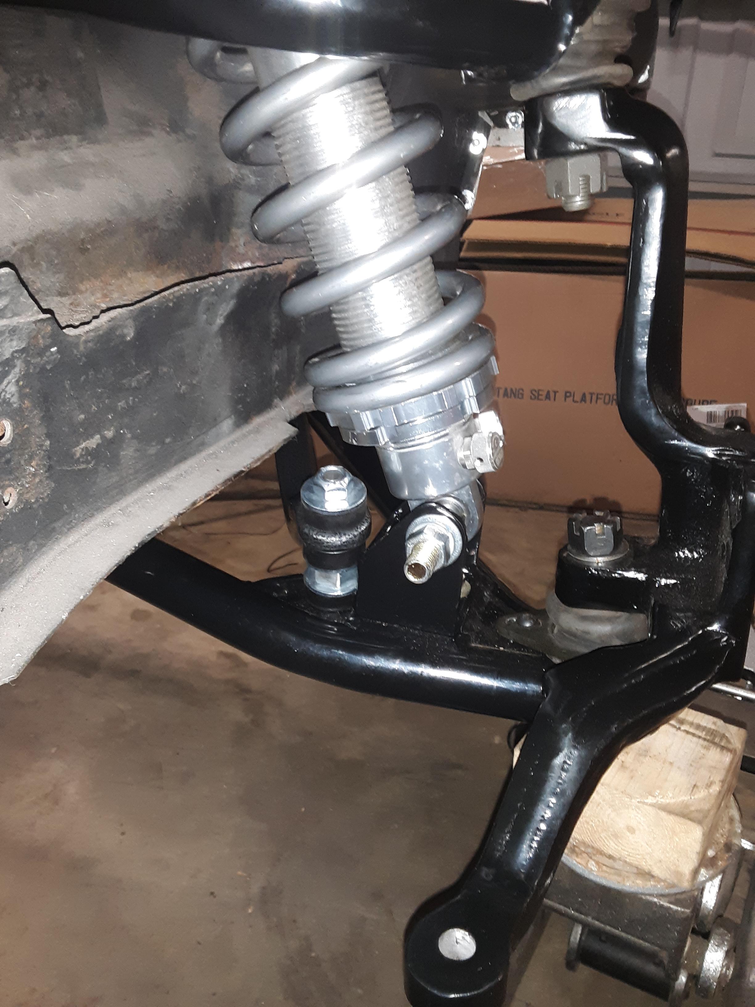

      been a long time since i have updated this thread. i got the front suspension done, i am very happy the way it turned out. went with viking double adjustable coilovers. Also picked up cobra brake calipers, 13'' slotted rotors & mustang steve caliper brackets. doing the suspension was a very long process & a lot of research to get it right.
      control arms & coilover brackets
      another mock up pic.
      one side mocked up

      Front suspension got powdercoated black. For anyone interested, this uses CPP mini subframe, modified CPP upper & lower arms. fabricated upper & lower coilover shock brackets, Viking double adjustable shocks, Hellwig 1-1/8'' chromoly swaybar with their hammertone finish.
      - - - Updated - - -
