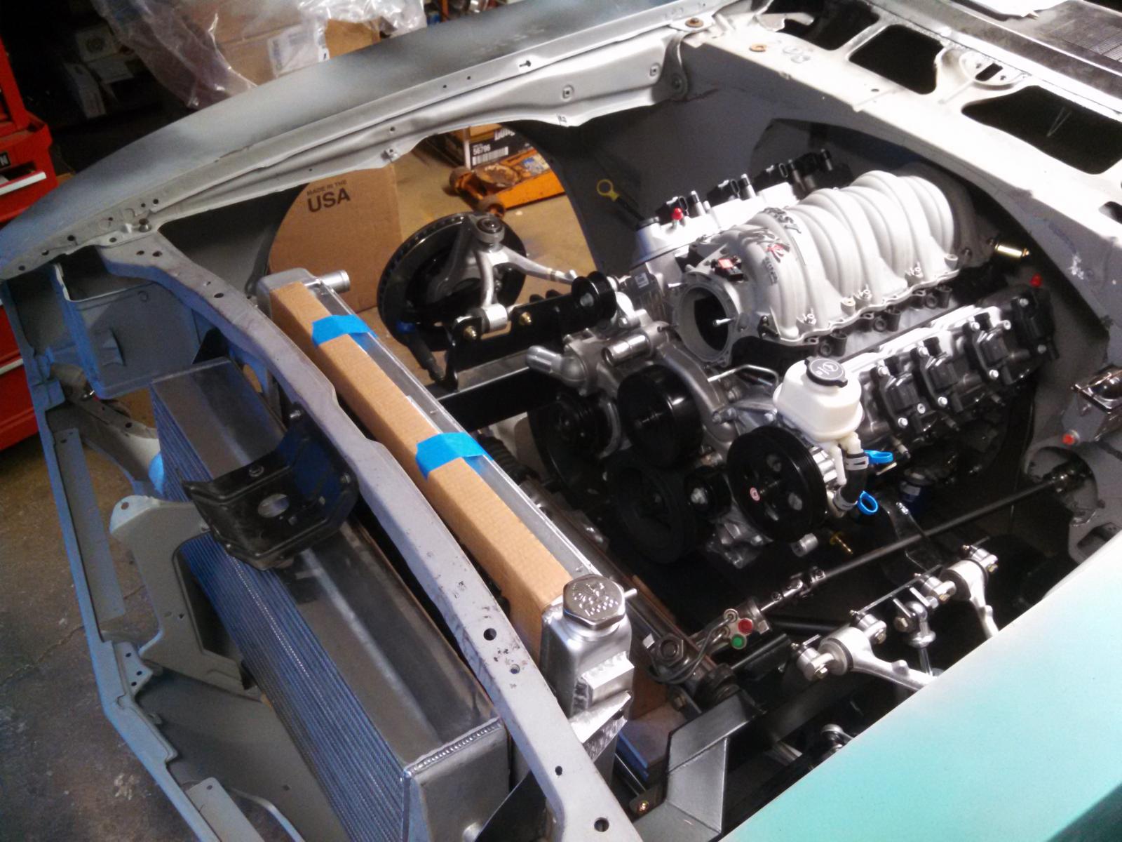

      Check out Treadstones website and scroll down to the bottom of the intercooler page. They have a 1300hp rated unit that has two bottom inlets and one center or offset outlet. It will package nicely in a second gen and Ive used one at 1000whp with no issue.

      Name:  top intercooler.jpg
Size:  54.4 KBName:  inter_front.jpg
Size:  93.0 KBI actually have that treadstone intercooler I'm mocking up for the 70 twin turbo project I'm finishing. It does fit very nice. I will post a couple of photos tomorrow.

      I second Treadstone Performance. Just mounted a custom intercooler they built for me in my 68 Camaro.
      Their cast end tanks and 3.5" CNC lips with 12" x 4.5" x 28" core. Looks great and I definitely recommend them. Tony is the tech there who primarily helped me but everyone I talked to was good to work with.
      For anyone curious I have 9" rearend with truck arm suspension, Wayne Due C5 subframe, LS3 with a pair of 6076 Precision turbos. Shooting for 700 hp to start until everything on the car is checked out
      Next challenges are hot side piping in tight engine compartment and my steering shaft goes through where the alternator wants to be.
