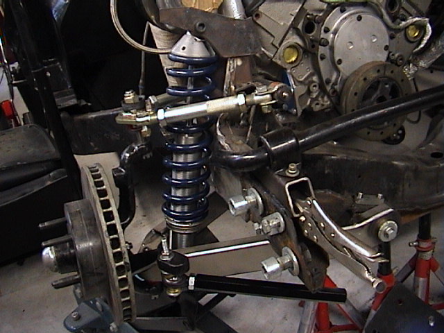

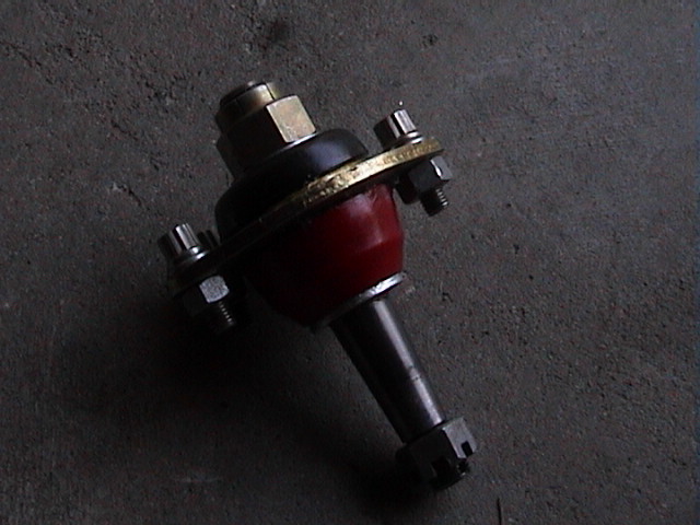

      You're better off w/ the coleman adjustable ball joint, it's a tapered stud w/ a spherical ball on a plate, it comes unsealed but you can use 2 boots on it and a thin washer to capture the boot so it doesn't slide over the taper and put grease in it. Works for me:
      here it is w/ 2 boots on it
      It has the 4 bolt gm mini bolt pattern.

      TwinTurbo,nice pic and nice adj. upper arms! ;) I used Coleman monoball ball joints on a couple projects before the modular tall stud ball joints were available. They`re really convenient to use but I had 2 issues with them. First their total travel is only 36* or a little more than half that of OE ball joints or the modulat ball joints we use now which are both 65*. That limited the travel on cars with more street oriented spring/shock rates. The only other problem is that while they hold up pretty well in the upper location so long as they`re kept clean and lubed (nice job with the boots BTW) they were getting loose in less than 10K miles when used in the lower location (pounding the races out). I`m fairly certain it`s due to the fact that the uppers recieve almost purely radial loads while the lowers take a great deal of axial load where monoballs have much smaller races than a true ball joint.
