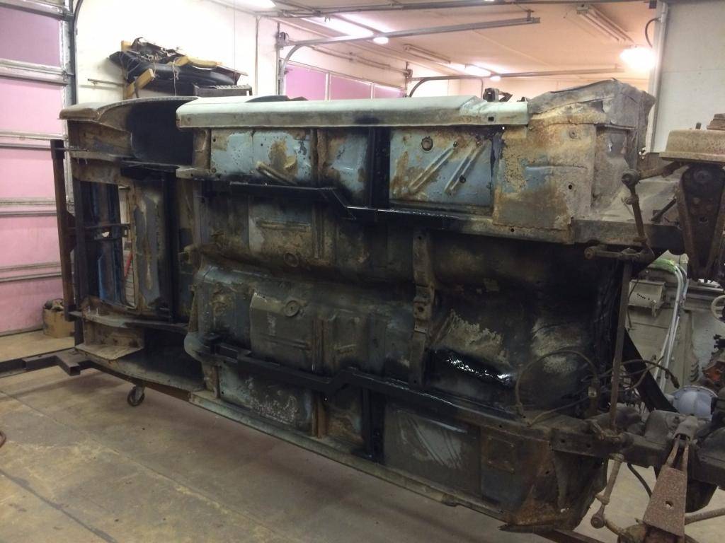

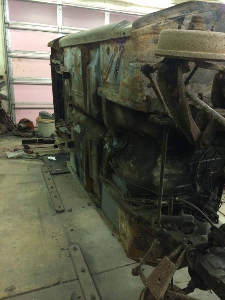

      she is hanging
      got it up on the rotisserie got a lot clean up to do

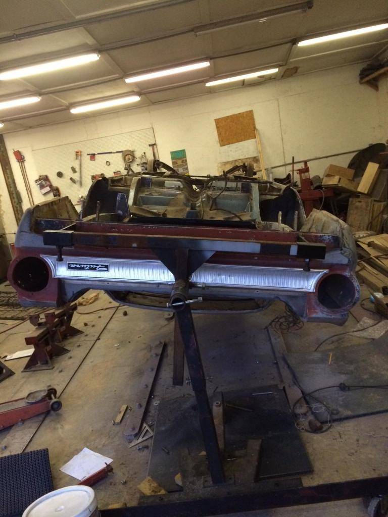

      39

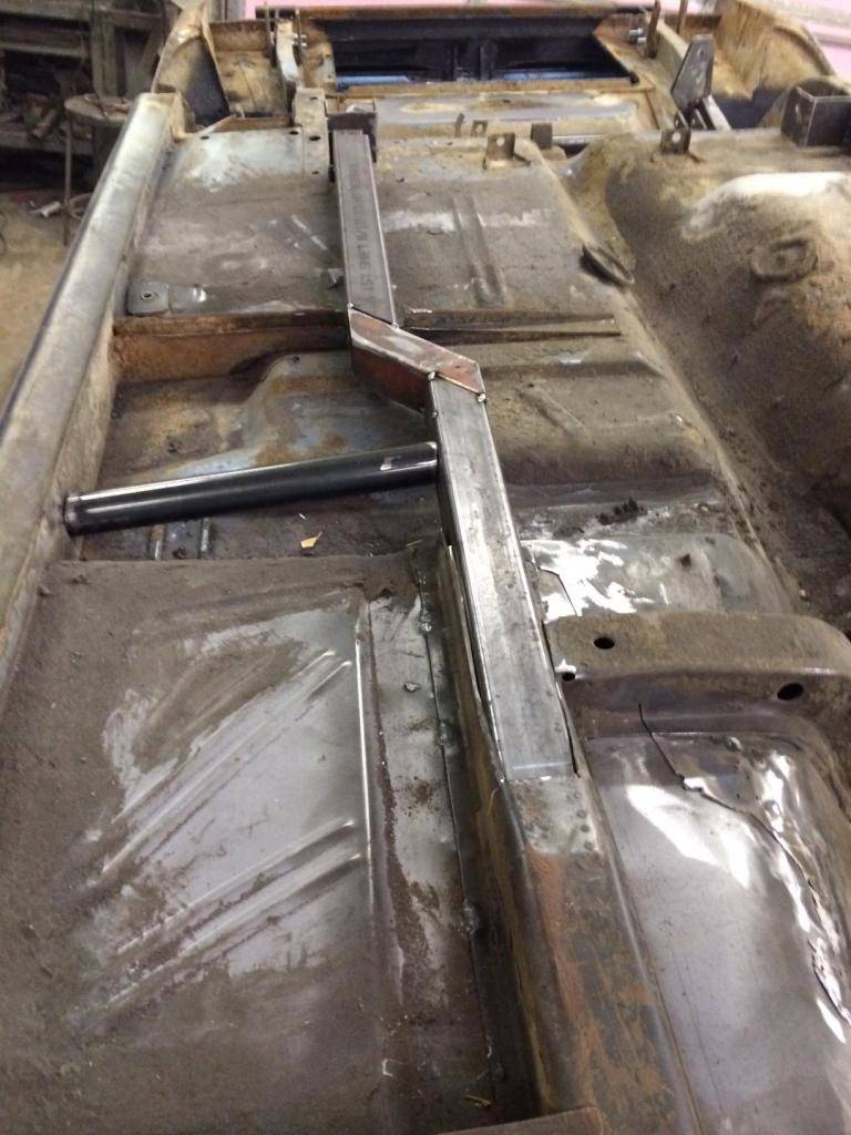

      what do you think ?
      ok I did a little looking and readying about sub frame connectors this is what i came up with what do you guys think ?

      34
      I have got to get me a rotisserie! Like the SFC's, especially the tie in to the rockers. I have to make a set for my 65 sedan.

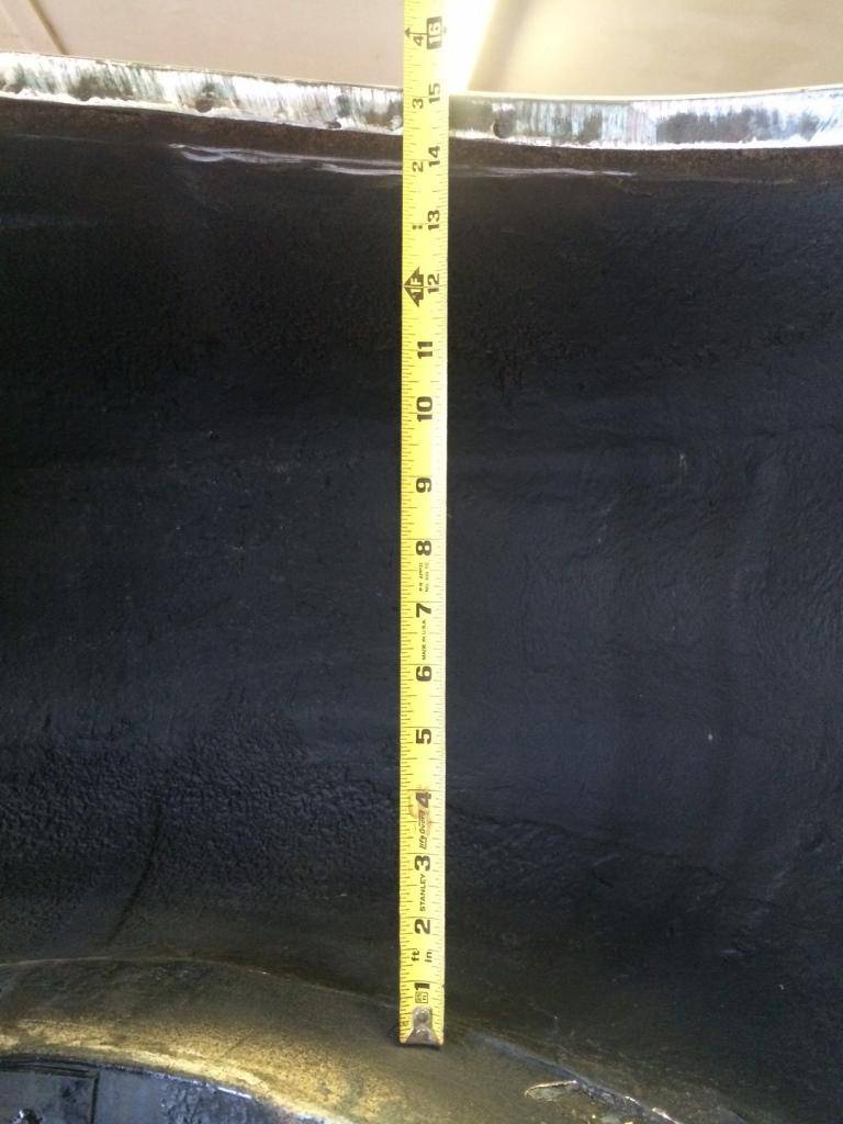

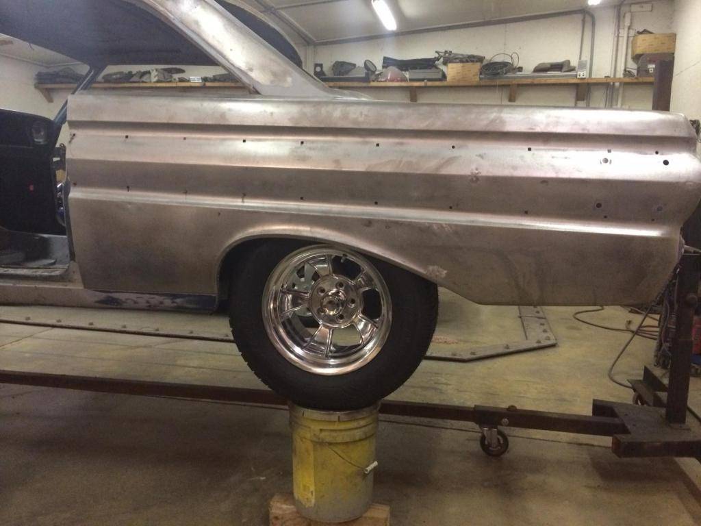

      39

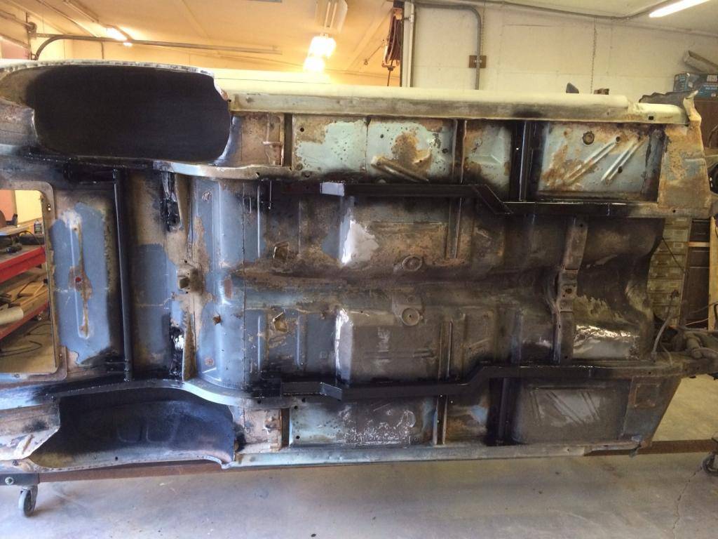

      Sub frame connectors and tubs done
      had a pretty good day got my sub frame connectors in and outer wheel well lips cleaned up
      Think I might get the car media blasted not sure yet

      Quote Originally Posted by DC-69 View Post
      Looks good. Have you looked at a convertible Falcon. I had no idea, but the torque box bracing and the under-seat bracing was crazy compared to a sedan or coupe. My buddy brought his over to work on and I was impressed how much better it was then a comparative mustang.
      Look at this: http://www.jalopyjournal.com/forum/s...d.php?t=740025
      It might be a good idea to incorporate those features.

      Quote Originally Posted by rustomatic View Post
      That looks like a nice hunk of metal to start with--the outer parts look amazing! When I started on my Falcon three years ago, I thought I was going for a very mild daily driver . . . oops! The crappy paint's the only thing that stayed true to my original idea...
      Rustomatic,
      Thanks !!! yea she has a solid body for sure .... nice to start with some good metal and not a bucket of rust ........... I was lucky to get this one from the south west .... my other project is a southern Cali car also ..........
    8. #28
      Mar 2011
      Oxford
      39
      Quote Originally Posted by MichaelUser View Post
      Thanks
      Michael,
      thanks for the link and the information..... I would have imagined that a convertible would have a lot more bracing in the floor seeing how it does not have any support from the roof.

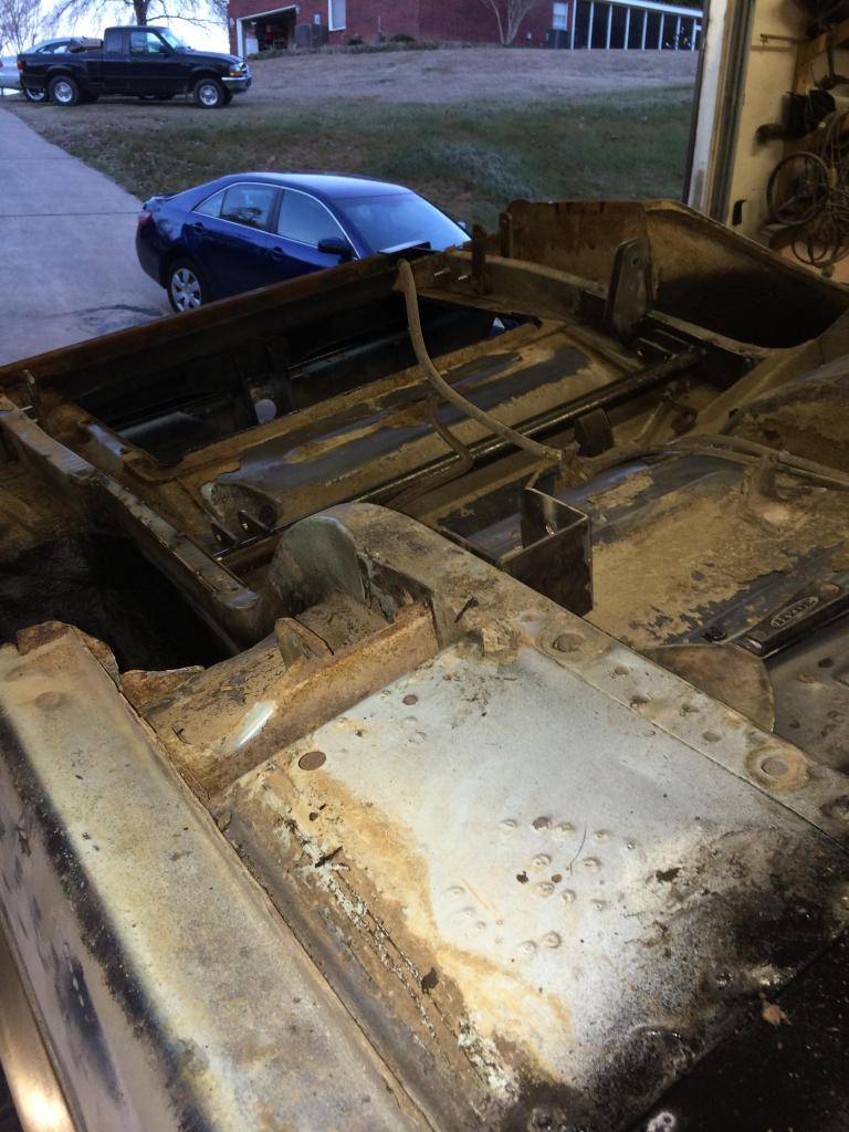

      39

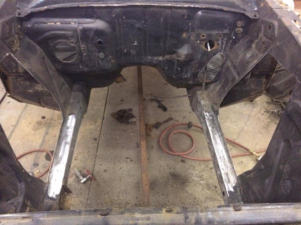

      update
      It was not as bad as I thought it was going to be to get the front end cleaned up and ready for the Mustang II crossmember.
      I got this pile
      to get to this
    10. #30

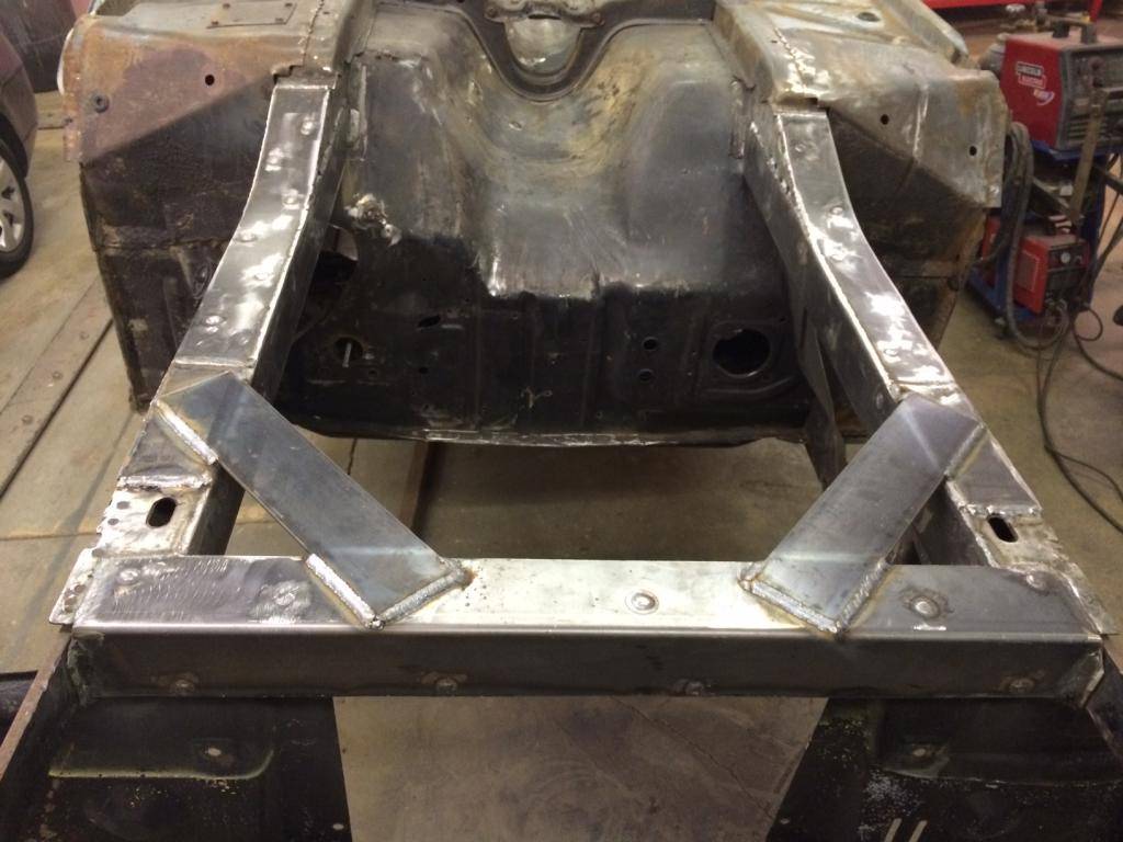

      39
      small update I managed to squeeze in some time to get the frame rails beefed up so I would have a good
      strong frame to mount the mustang ii crossmember to. Hope to get it all welded up this weekend.

      39

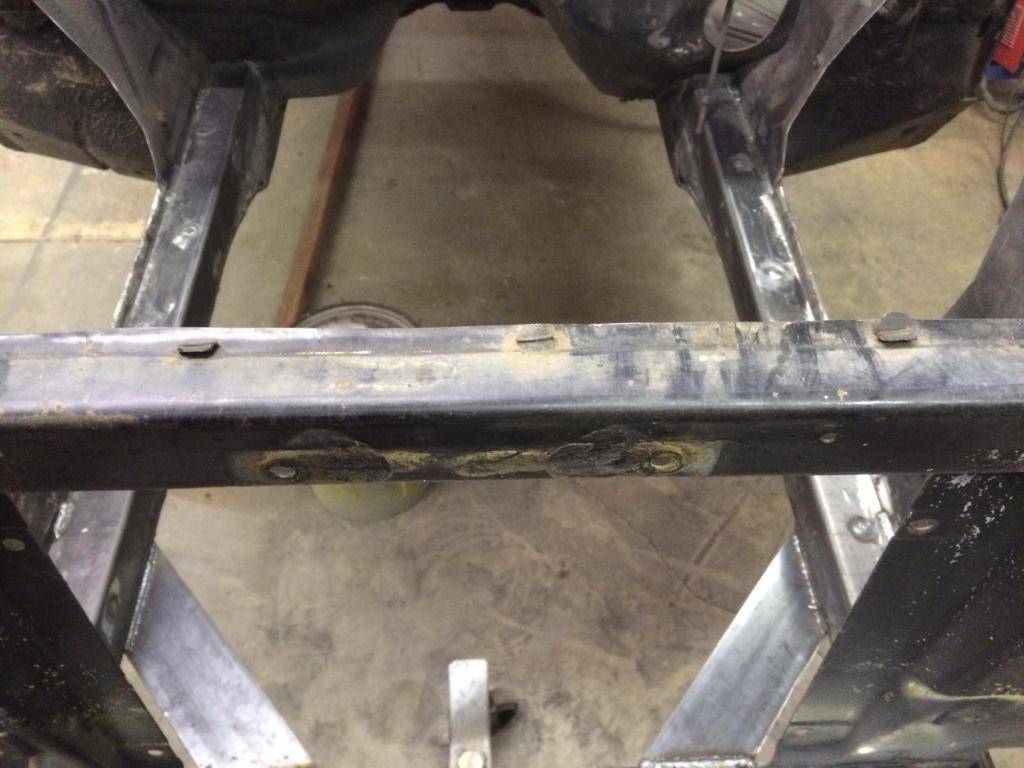

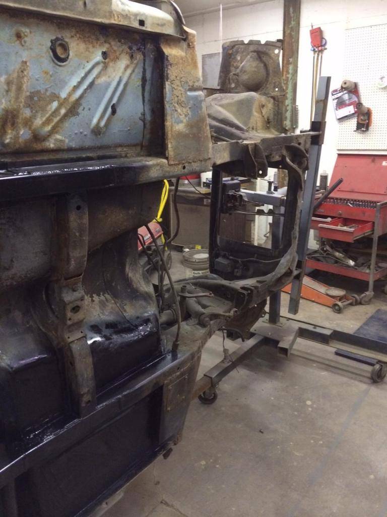

      another small update
      I know it does not look like much but is sure took longer than I thought it would to just reinforce the front frame
      rails. I received my crossmember from the guy's up north hope to have it welded up and install this weekend
