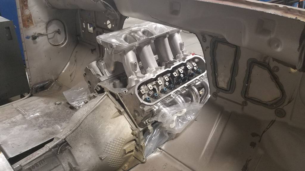

      Mounting the ballast.... Since the bed wasn't mounted yet I just took a guess on where they should be based off the factory cab mounts.
      Came pretty close on my guesstimate.
      You can kinda see it hiding under there.
      Mounted the Holley Hi-Ram to check for clearance issues.
      I have always hated the 67-72 dash. It's flat, tall, ugly and boring.
      So about 5:30 last night I'm in the shop and Ed(Owner of TCI) comes walking out of his office. I'm sitting on a short stool inside the cab just staring at the dash contemplating things. Ed says "You know, when I was building my Mustang I wish I would have cut the dash out. It would have made my life much easier". That was all I needed to hear. I grabbed a sharpie and started marking it up. Removed the few retaining bolts and fired up the plasma cutter. I left a one inch flange to attach the replacement dash to later.
      With the dash out it became very clear to me how the tunnel and firewall should be cut. I knew I wanted to push the engine back, I just didn't know how much.
      So I took some measurements and rigged up a floor mounted fixture to use as a guide with the plasma cutter and went to town.
      Once you exceed 3-4" of setback things start to get interesting (difficult). However, once you go beyond 3-4" it's not much different to go 10-12" vs. 6". In the position below the engine is back 10" from the factory location.

      We have a few different sets of headers sitting around the shop we use for mock up. Of all the ones I tried our own off the shelf headers fit the best. Mainly because the rear cylinder primaries go forward slightly before going down. This actually allowed me to move the engine back another 2.5"(12.5" total) with relative ease. I had to raise the engine in order to keep the pans(engine & tranny) above the bottom of the frame anyway. It had to go up over an inch(too much) in order to keep the transmission tabs off the tunnel. Now I've got clearance issues with the intake manifold. Next week I'll trim the tunnel a little more where the tranny tabs are interfering so I can bring the engine down roughly 1/2". This may or may not be enough to clear the intake manifold again.
      Needless to say if the engine stays this far back I will have a constant foot warmer.

      Twins, engine set back, it's starting to look like pure Awesome is the plan for this thing! Now I see what you meant earlier by having some tricks up your sleeve.
      I'm in full support of putting that engine back as far as possible. Have you set the final engine position yet? How much further back will it be from stock? Looks like at least 12inches!
      That last pic is 12.5" back. Haven't really decided where final placement will be.
