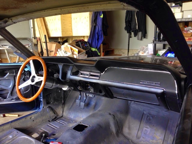

      Here's some new pictures. I was a roll once it came back from paint and then wedding season hit and it's been over a month, since then I haven't touched it.
      Started with the dash and bits. It has to come back out to put the windshield in nicely.
      Dakota Digital gauges, Ididit column, Nardi wood steering wheel.
      In retrospect I wouldn't have bought a Ididit or Flaming River branded column. My friend got a no name one from Ebay and the quality/finish was the same for a fraction of the price.

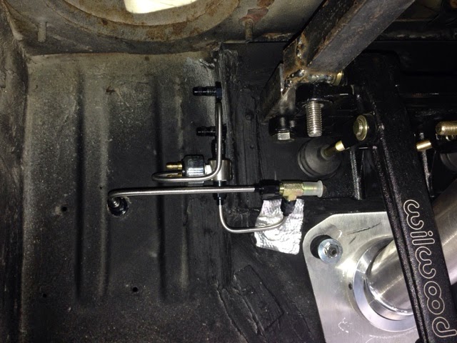

      New brake lines under the dash for clutch switch and brake lights. Going to keep it really clean under the hood. (don't mind the welding on the pedal brace, my left hand did it)

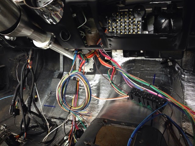

      Time for the AAW install, I'm not the best when it comes to circuits so I appreciate all the help that everyone has given with various questions in the tech forums.

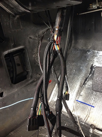

      Wiring covered in tech flex, zap straps are temporary I wrapped all braches with electrical tape.

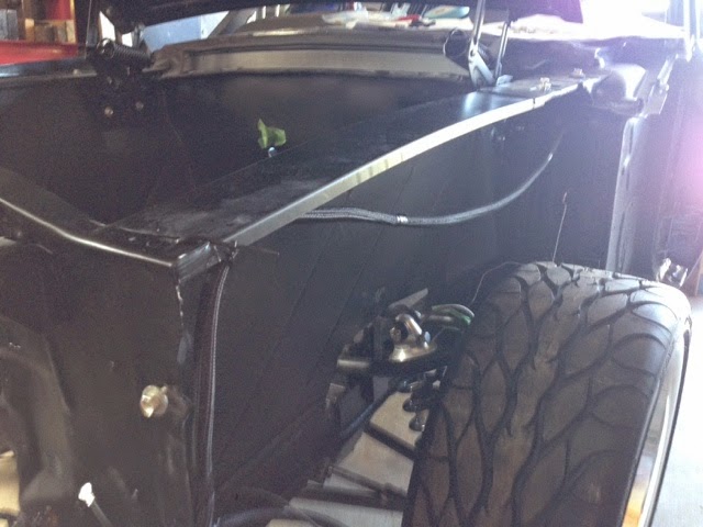

      Running all the wiring for the front of the car on the outside, again keeping it clean under the hood. I used magdaddy magnets to secure the wiring to the aprons. I got some 12lb and 20lb magnets to keep things in place.

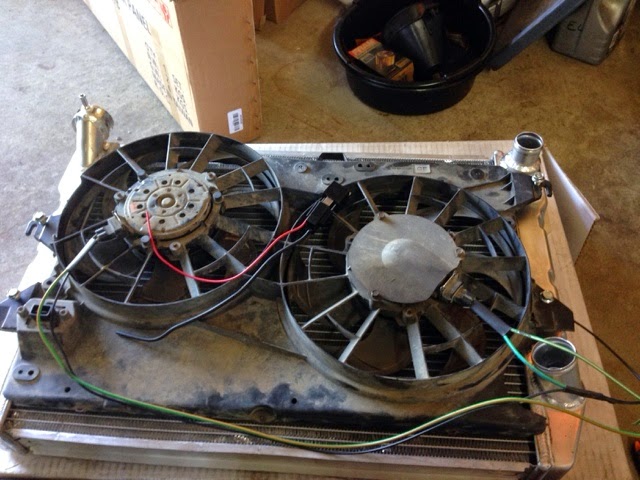

      Stripping and wiring of the new/used dual fans out of a V6 Cougar. My friend made all the mounts to bolt on to the rad and a/c condenser as one unit.

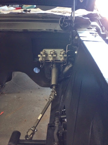

      The only brake lines you will see under the hood
      Close up

      Is that a nardi torino wheel? I had one on my car in japan and forgot to pull it off when I junked it. Your project is looking good!!
      Jan 2013
      Abbotsford, B.C.
      297
      Yep, bought it a couple years ago, it's no 100% but it looks great and fits the car really well. Funny only my import friends know that wheel haha.

      Nice job on running the wiring in the fender. Did that w the Falcon and happy I did.

      Awesom build! Have a few questions. I too am putting wildwood pedals in my car and I am curious as to what exactly the "New brake lines under the dash for clutch switch and brake lights" whats a clutch switch? I got the wildwood prop valve with build in brake light switch for my car and my master cylinders will be behind the dash to clean up the firewall. But im really curious to what that clutch switch is and where your brake lines go. If you have pics that's even better!
