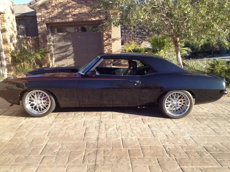

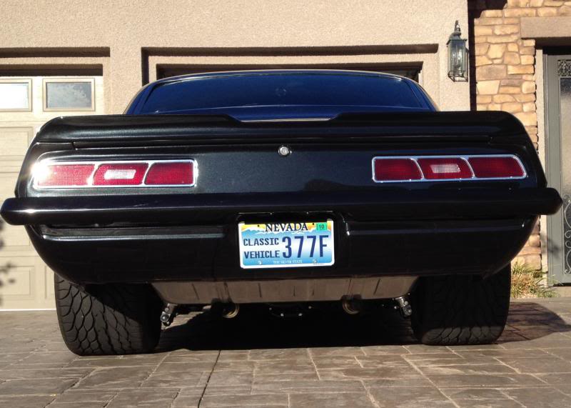

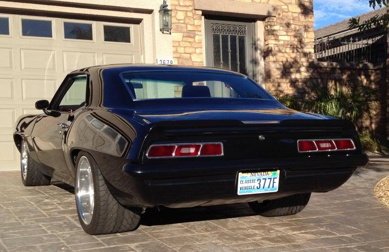

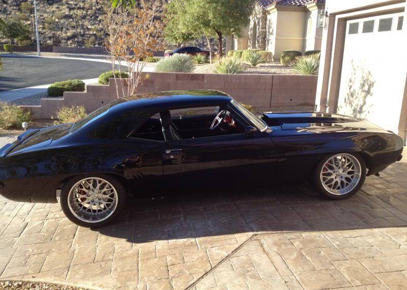

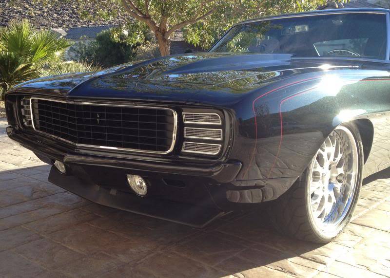

      Here are a few pics of my just finished 69 Camaro.

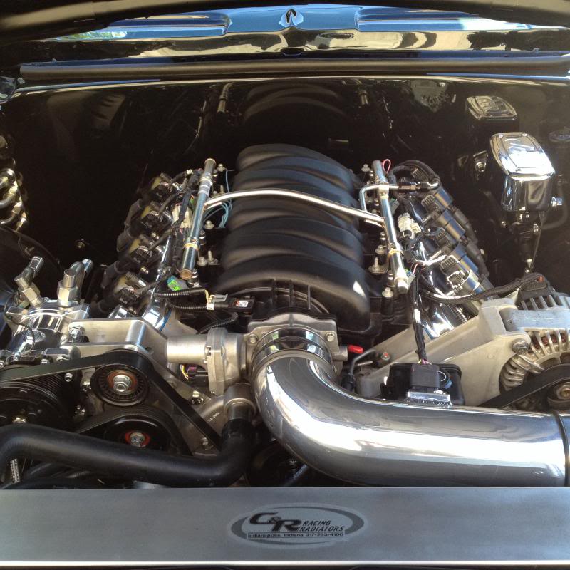

      Features LS7 T/56 TCI Torque arm and Front Suspension. Ford 9" with 3.50s. Wilwood 6 Piston Fronts and 4 Piston Rears. Some small subtle body mods among other things.
      Diamond Forged Pistons, TS Cam, Hooker Supercomp Headers, Mantic Twin Disc Clutch, Dynoed 500 RHWP on a conservative tune at 6200 rpm

      Hey john how in gods name have you got such a nice camaro and haven't been a member here a long time ago... pt.com is the best. lately I've been clicking online like 4 times a day minimum . Heck I hate to ask...what's the plans for the car...just drive the snot out of her?
      And seriously how do you like the dry sump? ...anything you changed? or would change? ...I'm asking because I'm in the process with a ls7 in my chevelle and will be parts shopping soon thanks for any help

      I love driving it. The car is crazy fast and handles amazingly well. I've built a few cars over the past few years. I always build them to keep and then somebody comes along with an offer I can't refuse. Short list. 55 Belair Merlin 509/700R4, 69 Camaro/406 SBC, 67 Camaro ZZ502/TKO600, 69 Camaro/355Roller TKO500. For me is the building I enjoy the most.
      I converted my LS7 to wet sump. I do not road race or autocross and I didn't want to clutter the engine bay with the tank and hoses. You actually pick up a little power. The Corvette LS7 sump system is not a true dry sump. It's actually a "dwet" system. That is basically a wet system with and external tank. I run a C&R Racing Radiator that has built in heat exchangers for Engine Oil and Power Steering fluid.
      Just starting a build on a 69 Camaro project with an LQ9 and 4L60E that I picked up in Cali a few months ago. (for my son. He sold is Corvette ZO6 to pay for the build)
      Let me know if you need any info or tips on your build

      Nice 69! I gotta ask, where did you get the air intake tube etc.?
      May 2012
      164
      Quote Originally Posted by 72BBSwinger View Post
      Actually Spectre make them for LS motors in 69 Camaros and other muscle cars.
