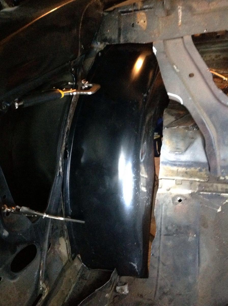

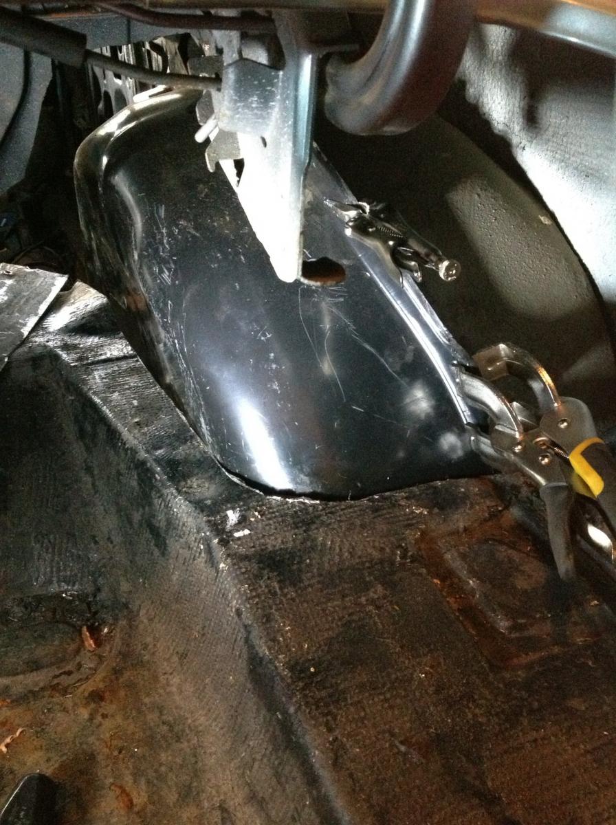

      Also in the same situation on a '67 Camaro. I'm half done the mini-tubbing and that's where I started. My reasoning is that I want to make sure I keep everything as square and lined up as possible. As maro67 stated I will start with lining up doors gaps first then go to quarters. With installing the mini tubs first I haven't changed the structure of the car. When they are done I will start and complete one quarter at a time. If you have a rack and the talent to remove it all and do it at once then I would assume that would be the easiest way. Doing it on my garage by myself this is the best way I can see to make sure the end product is straight and aligned like the car I'm starting with. Less the rust and room for bigger tires of coarse.
      Also, half way through I purchased an inexpensive plasma cutter and it made things much, much easier and cleaner. There was some debate on these things but I found that the plasma cutter was a great investment and took a lot of the stress out of the fabricating for me. Take your time and go slow and it's not hard to do. I've really be enjoying the process and building the car myself so I hope this helps. I will try and get my project status updated over the holidays as I've taken lots of photos during the mini-tub install and fabrication.
      Sorry for the HUGE pictures, it's a PIA to do these from my iPad.
