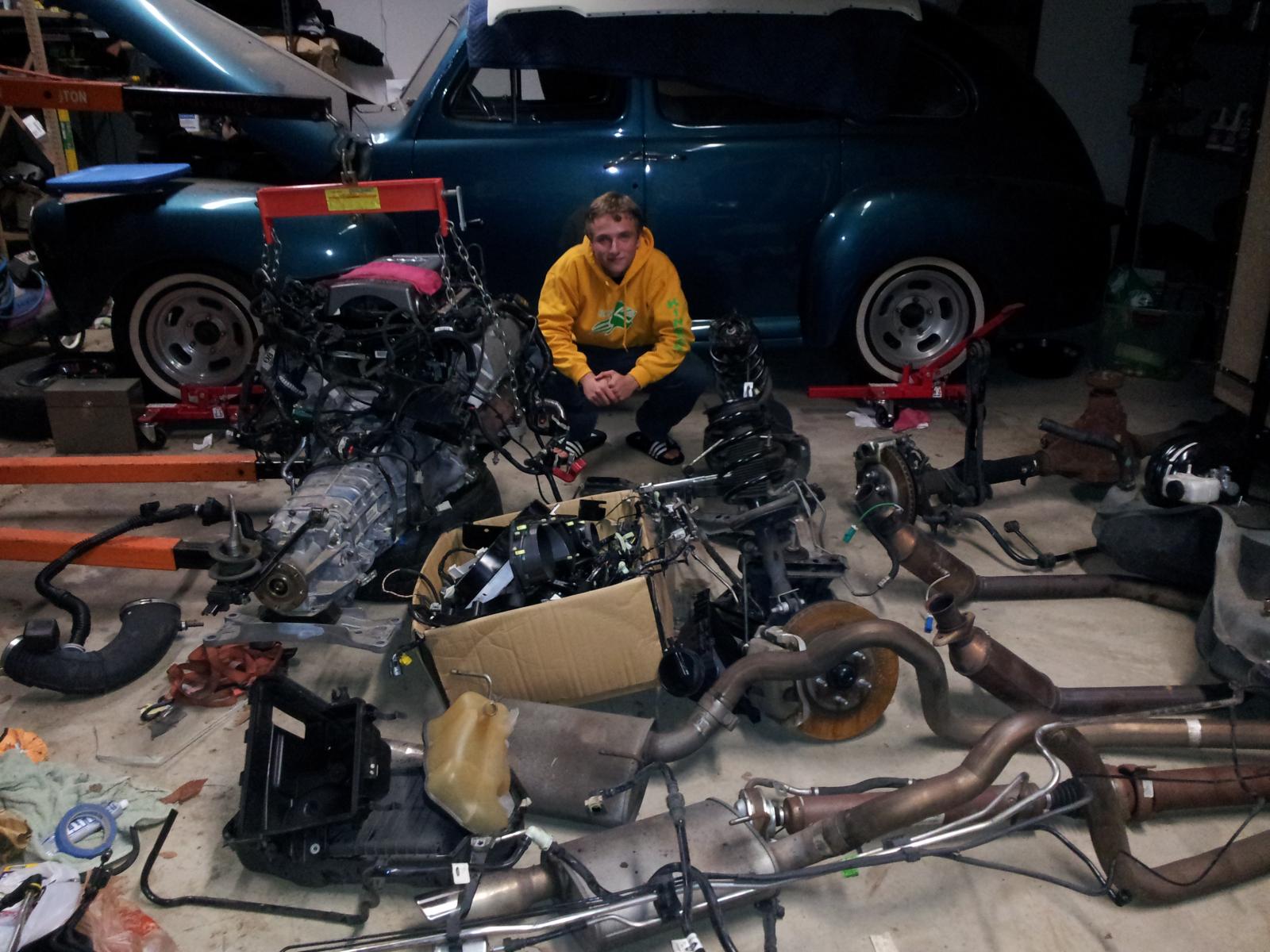

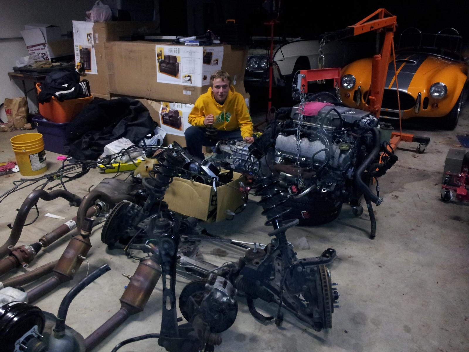

      I am brand new to this site and this is my first post for a new project with my son. Step 1, drive train. see pictures. We pulled everything for the drive train from a rear-ended 2010 Mustang GT Convert with 35k miles. We have 3 goals for the project: 1. autocross/HPDE 2. Be unique at car shows 3. A 65/66 fastback
      Our first short term goal is to start the motor in the car by the end of his xmas break. The car we are looking at is a 66 coupe with 10 point cage/full frame and mustangII tubular front. If we go this route we will need to decide the best way to convert to a fastback. Options are fiberglass body (http://www.usbody.com/Pages_Cars/64-Mustang.htm) or use repro metals panels. Let me know if anyone has input on either way. More pictures as soon as we get the car
      Thanks, Jim and Elliot

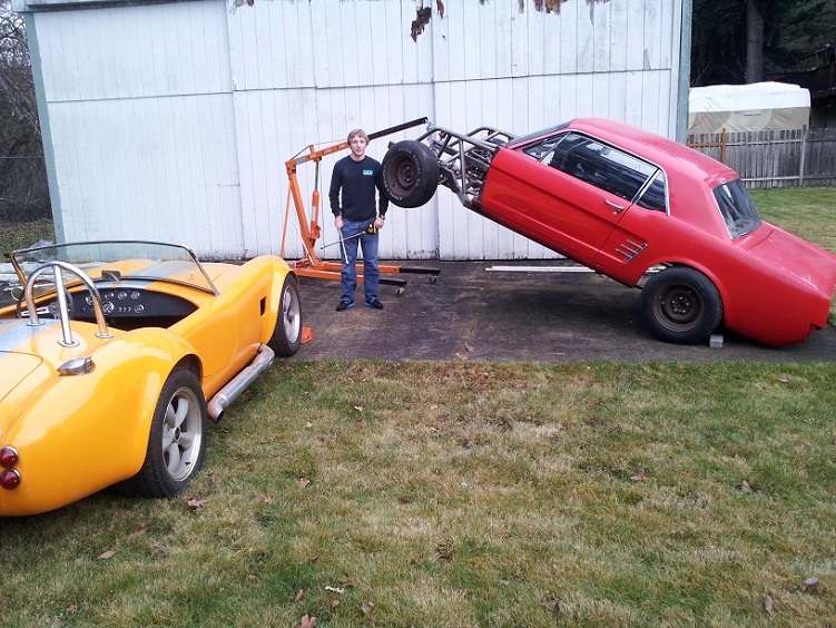

      Got the car home

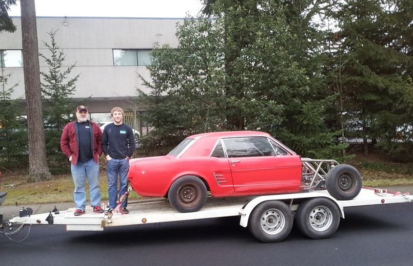

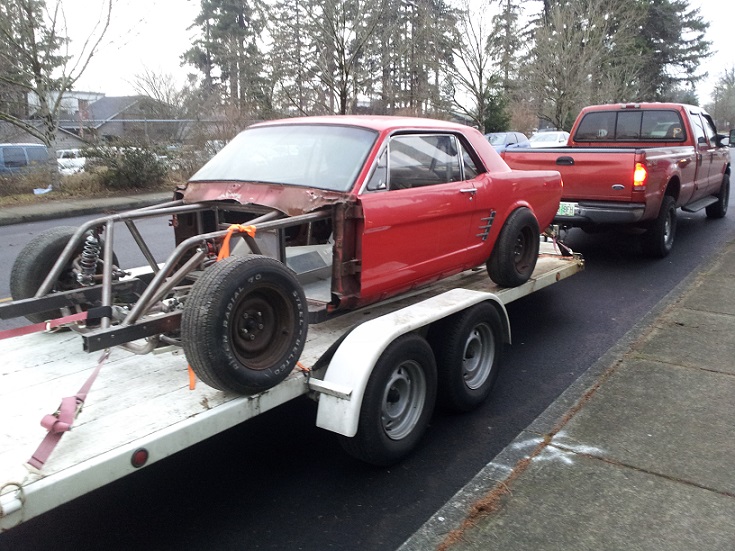

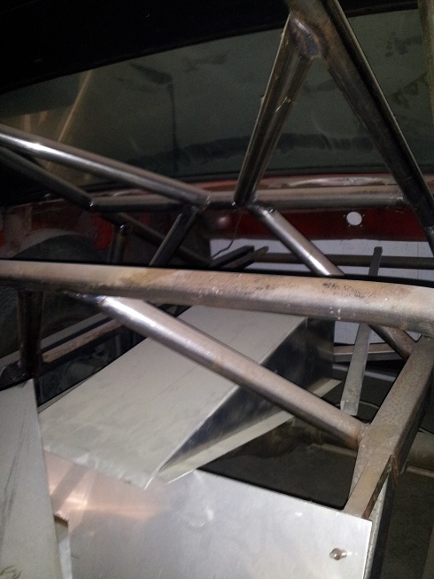

Size:  138.9 KBNOT_A_TA, I had the car picked out at the same time as the drive train but then there were some title issues. Now I have the car and ready to move forward. Picking up the fastback roof chop in a few weeks to do the conversion.
      MSTSFabbed, I think I am going to go with what is already on the car but we will see. Do you have a late model motor in your 67?
      a lot of work has been done on the car already, 4wdb, cage, front cross member, front & rear coil overs, rear 3 link, etc...
      We need to check out whats there and see if we can use it all

      I hope you got all of the inner support structures for the conversion and not just the roof.

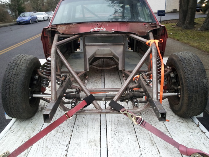

      looks like a full tube chassy. that thing is worlds stronger than a stock mustang unibody. i would just get the fastback panels and convert it. however you will need to get a roof, roof support, doors, full quarter, trunk divider, trunk lid & trunk filler & glass. parts cost around $3500

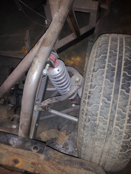

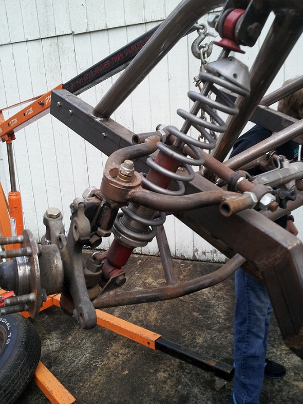

      the front rotors we got are 13" the rears are 12". I need to know what calipers will work on this front end. does anyone recognize it?

      this the way to get a look at the custom frame we have. We don't have a rotisserie so this is next best thing. The front is so light my son and I can lift it off the ground, just not this high

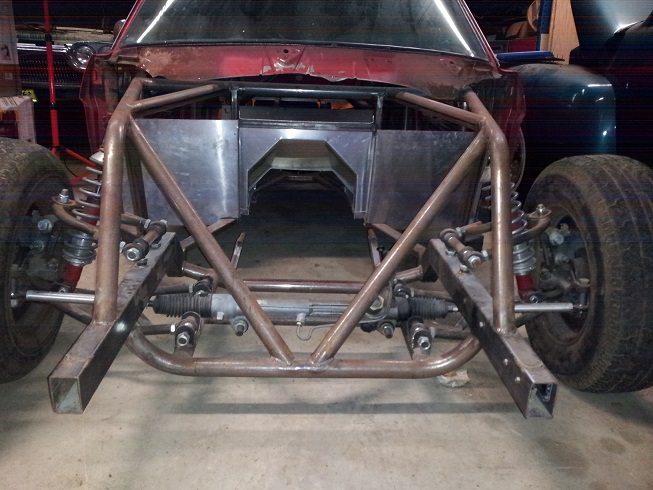

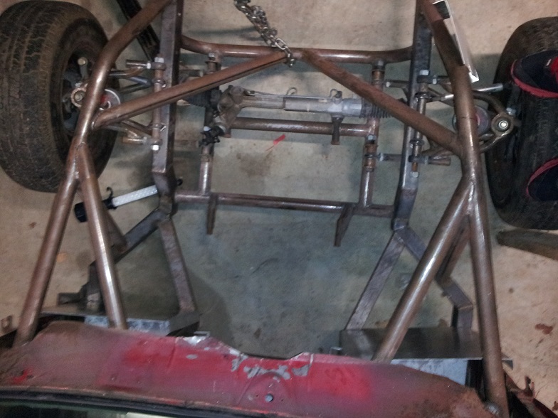

      here is what we have underneath. Some of the smaller cross bars are just tacked in. Does anyone see anything that needs to be addressed?
      The body is bolted to the frame which means we can lift the body off in the future

      Those look like mustang spindles. You may identify the spindles here, maybe not.
      http://forums.corral.net/forums/gene...-how-tell.html
      They could be from a later mustang. Also, those upper ball joints are suspect at best.
      Griggs sells adapters. There is another company that makes them but I can't recall their name.
      http://www.griggsracing.com/index.php?cPath=70_1443

      about those spindles, check the ball joint fitment you might be able to fit the 2010 mustang spindles and re use all the brake stuff. also looking at the trans tunnel & crossmember you should add a drive shaft safety loop.

      Looks like a good start! I'd double check your lower link brackets in the rear. Looks like some lateral gussets would be good insurance. Keep us posted!

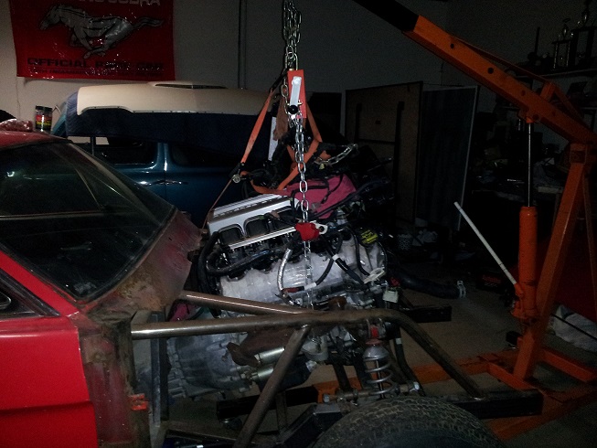

      fit??
      it is a measures as a tight fit... but we are getting close. Looking like we need custom long tube headers.

      You stated that you want to do HPDE and Autocross with this car. Forgive me if this comes across as negitive but what you have there was built for dragracing and will likely be worthless for HPDE/Auto-X. The entire front chassis and suspension looks to be too light weight for serious high G cornering. I just don't see where that front end is going to work at all for what you want to do with the car. Even the support structure around the rack unit looks to be too light weight. Speaking of the rack, based on the tie rod angle the rack looks to be located too far aft in the chassis. In my opinion, you would be money ahead to sell that car to a dragracer and find a nice fastback to build a proper track car around.
