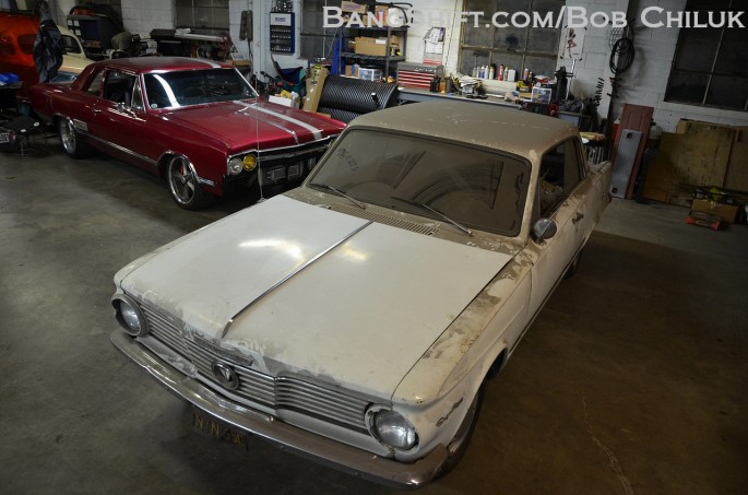

      Here's our '64 Valiant project aka Violent. After we built the Raybestos GTO-R, most of the events that Raybestos scheduled it for were trade shows and static appearances (aside from OUSCI, PowerTour and Gingerman), so we didn't get to thrash on it as much as we would have liked. This car will be ours, taking what we learned that was right and could be improved upon with the GTO and making an even better car to tear up the racetrack. And you almost never see Mopar cars at the Autocross/Road Racing events. BangShift.com is covering the build as well, so many of you will have seen some of this already.
      Power is a Max Wedge based block, with Indy heads and Hilborn stack injection backed by a Tremec T-56.
      Our starting victim. A really nice California car.

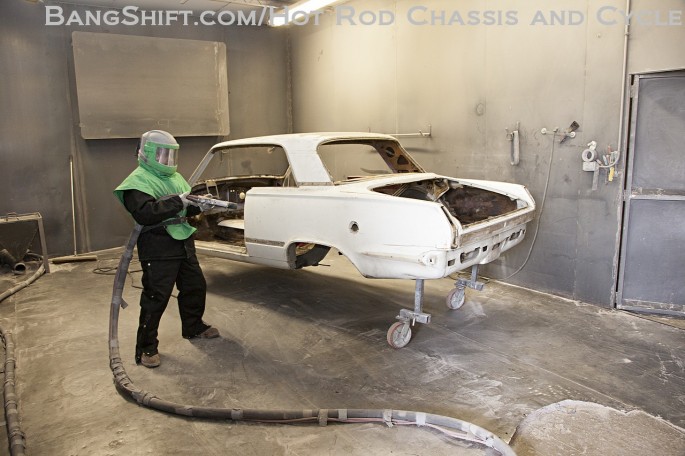

      Geting blasted at Redi-Strip

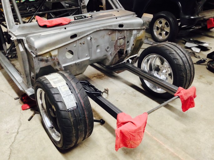

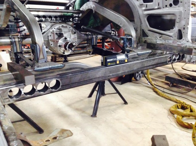

      Building the rear suspension.

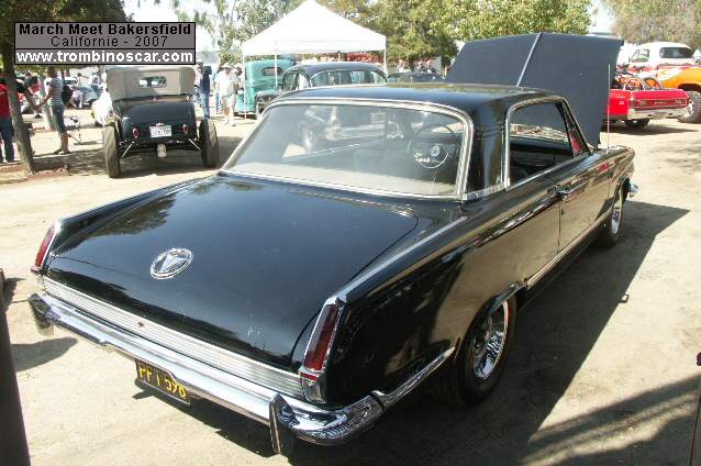

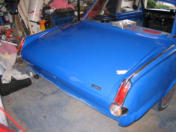

      Might want to see if you can scare up a '65 Barracuda grill, '65 barracuda tail lights and spears... Maybe pass on the spears, but they are cool. Last pic here shows the spears on the rear quarter in front of the bumper.Name:  100_0257s.jpg

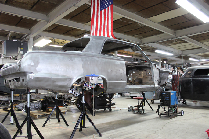

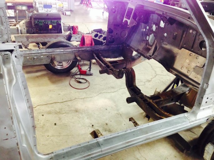

      Where has the time gone! We're in final assembly but I'll try to catch up quickly over the next few days.

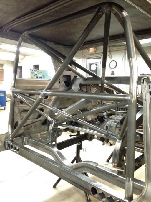

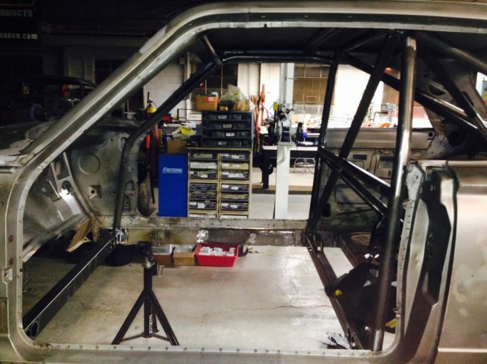

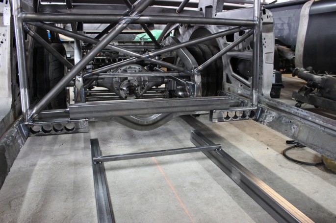

      Here are some updates on the Valiant on the floor and the cage. Click here for the full article on Bangshift.

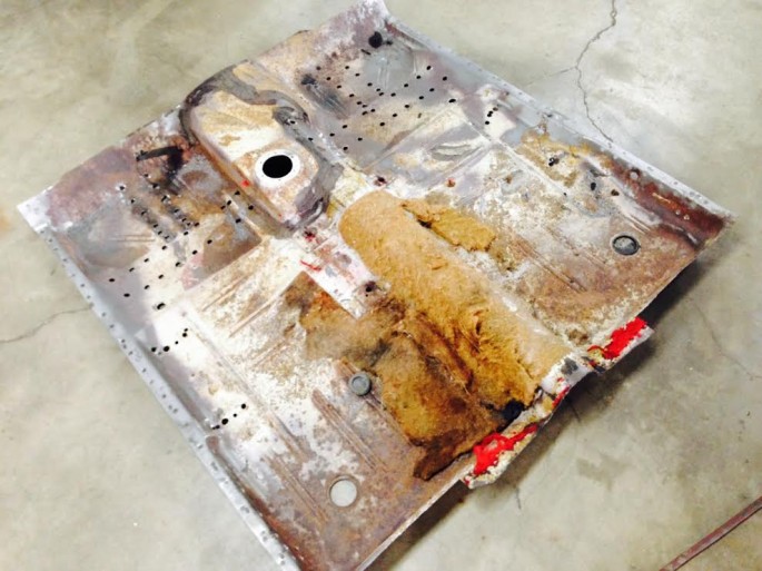

      The floors were really nice! It was a shame to cut them out of this California car.

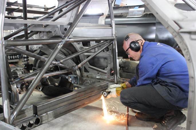

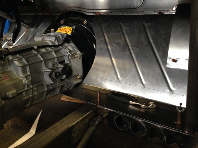

      Rear cage

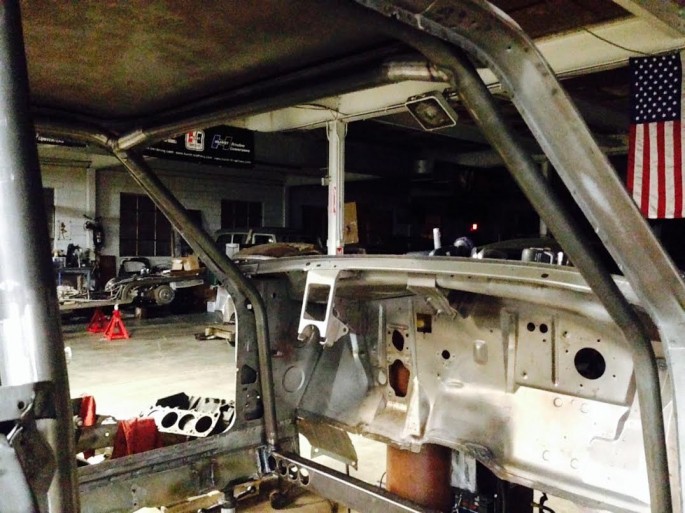

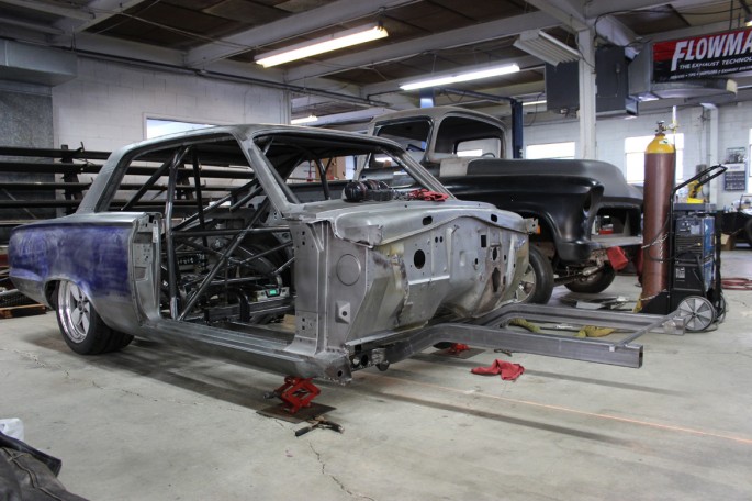

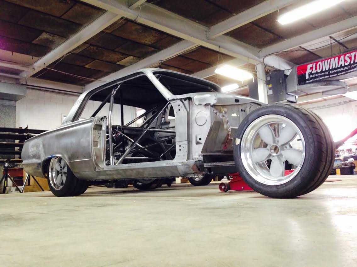

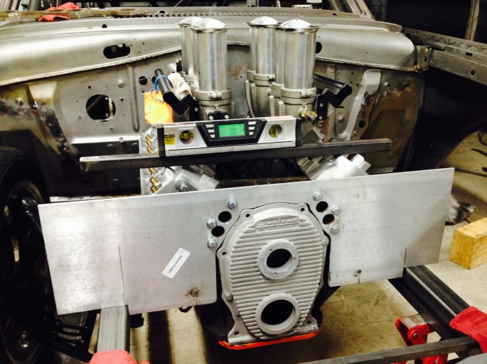

      Next up the front end gets cut off.
      Cleaned up.
      Front of the cage.
      Mocked up.

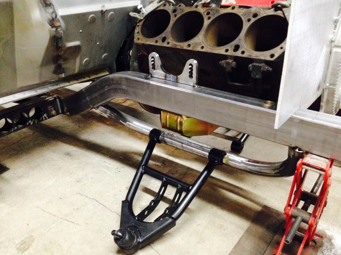

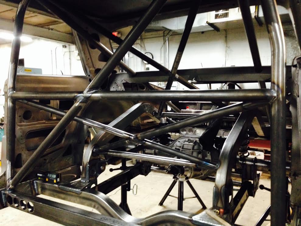

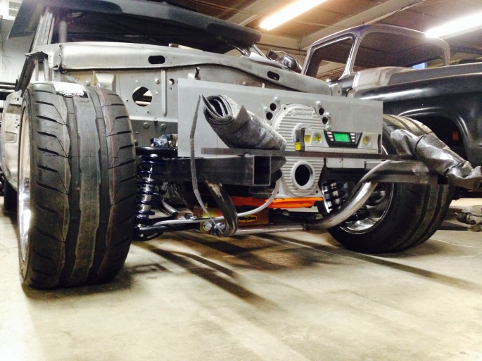

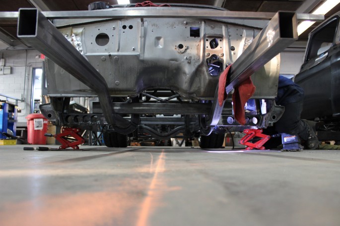

      More pics on the front frame rails… BangShift article here: http://bangshift.com/bangshiftapex/p...and-installed/
      1967 Chevelle Obsessed for 40 years
      Jul 2013
      29

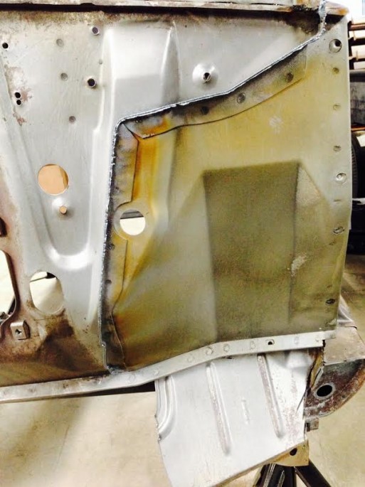

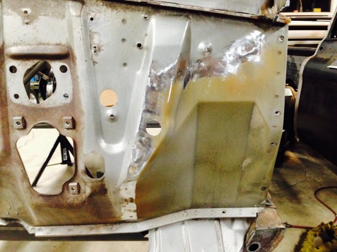

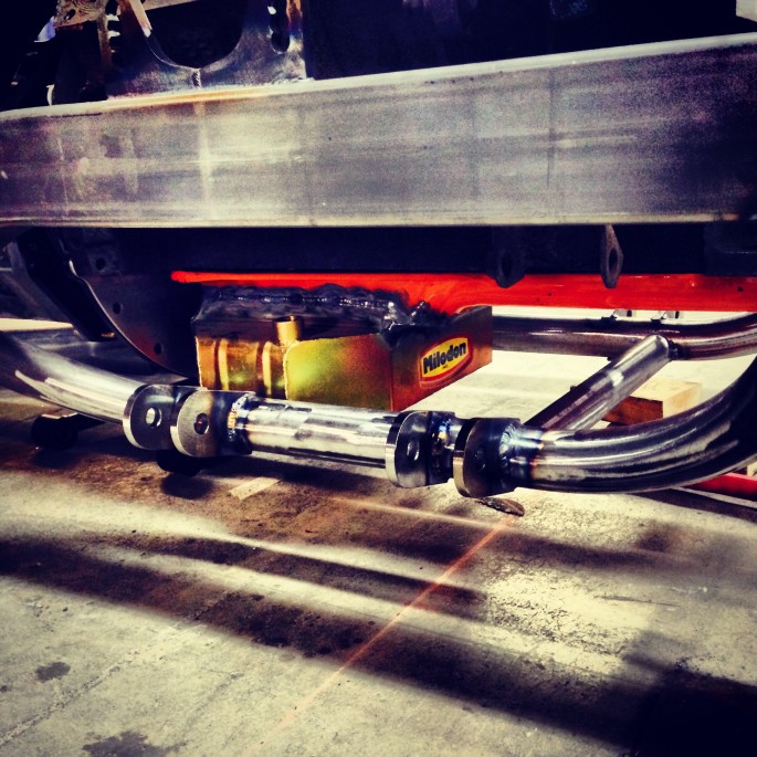

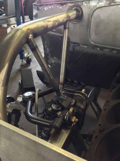

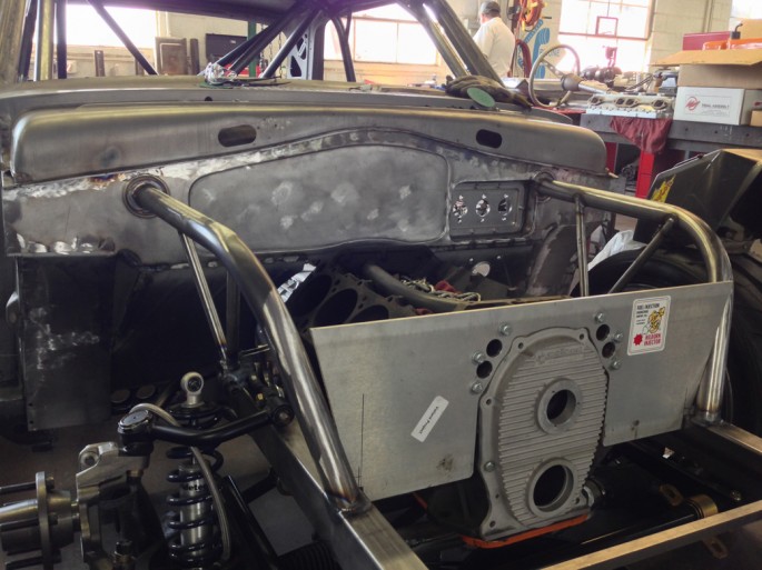

      More photos fabbing up the front rails and suspension…
      Jul 2013
      29

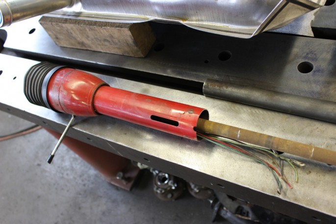

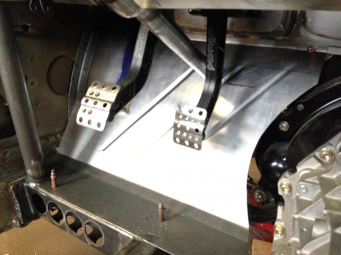

      …and the firewall.
      The original steering column before modification.

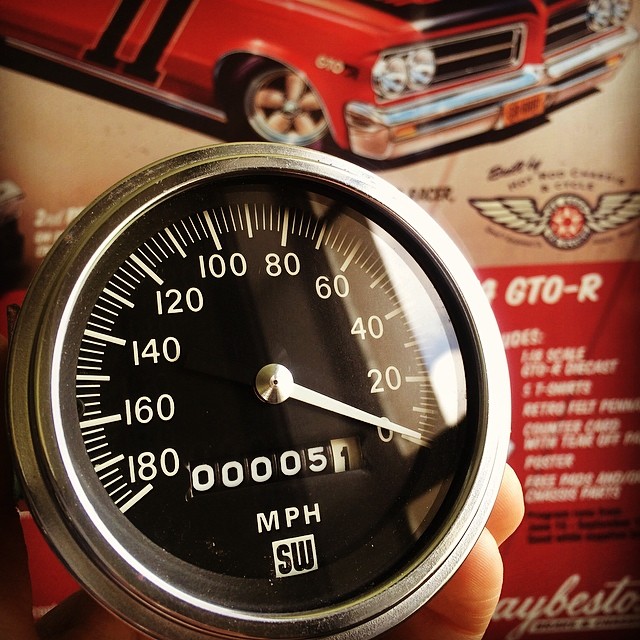

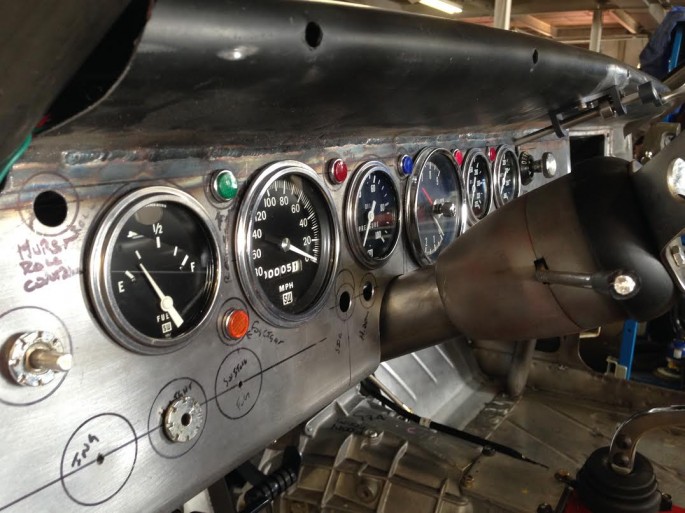

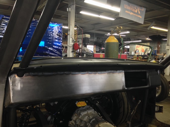

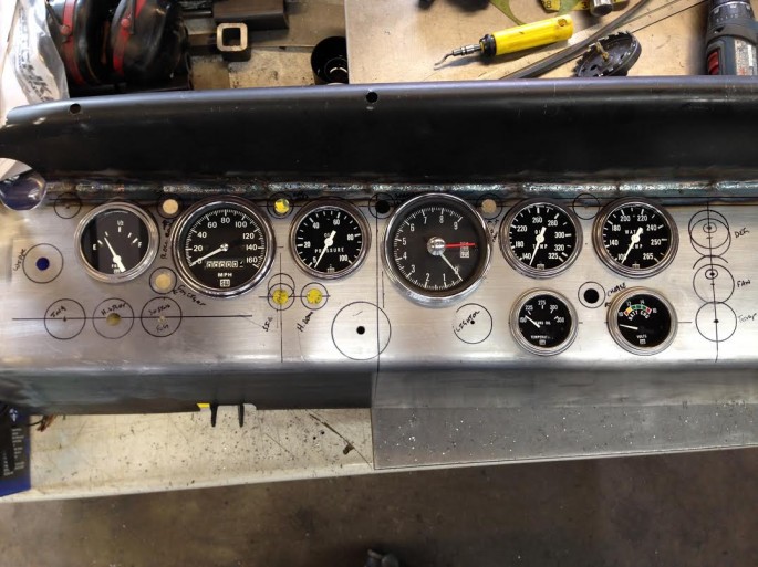

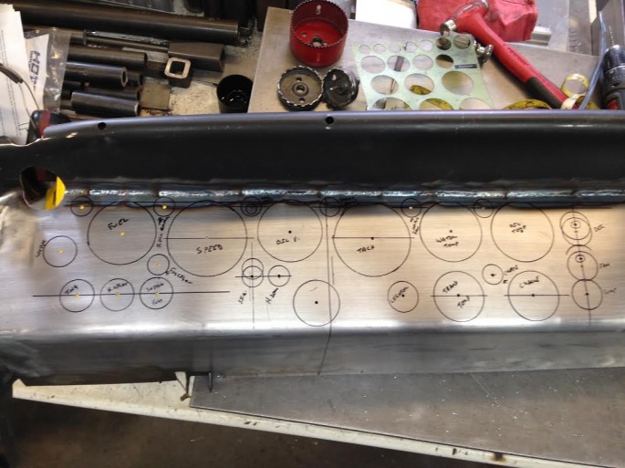

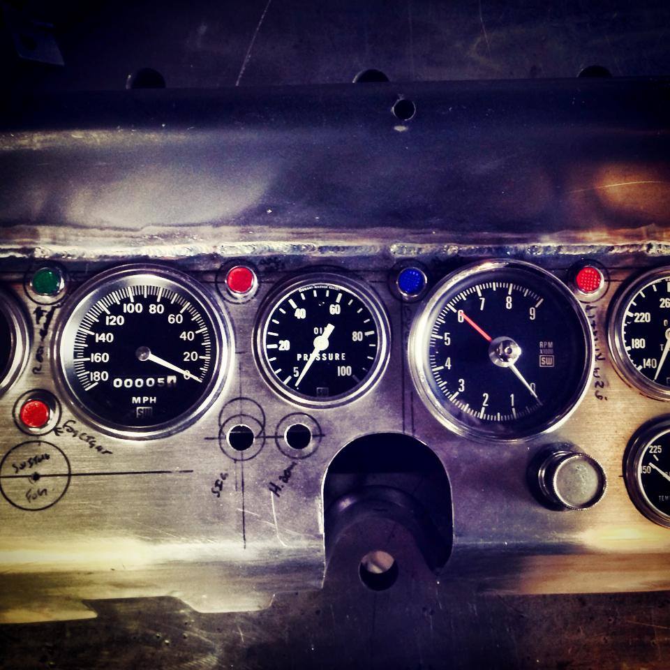

      The Valiant HAS to have one of the UGLIEST dashes in all of automotive history! So let's fix that...
      We'll be using Stewart Warner gauges…
      If you followed the Raybestos GTO build, then you'll recognize this speedo that we bought for the Violent Valiant. Maybe the last NOS Stewart Warner reverse sweep speedo in the country? Took 2 weeks of searching to find one! What a shame that SW discontinued it. They told us that after the GTO was done, the sales of this speedo went through the roof.
      Much better!

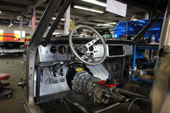

      Column modified and mounted with a mock up steering wheel.
