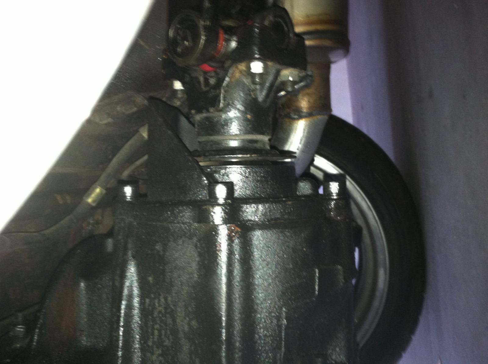

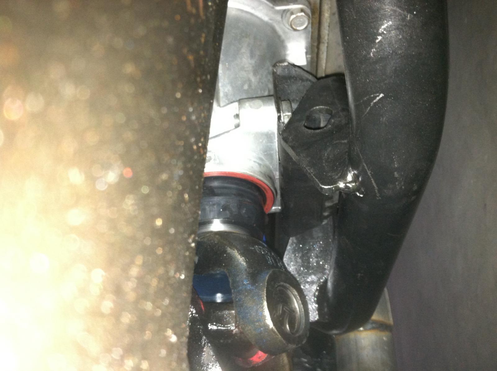

      Hopefully this helps...its a little tight taking a picture without a lift. I still have a drip coming from the transmission tailshaft.
