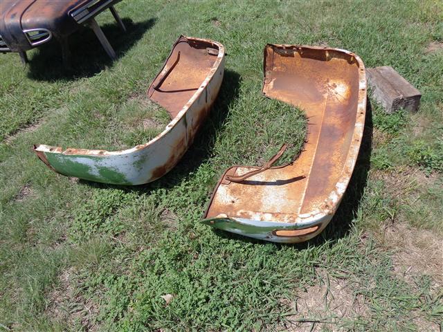

      Did a lot of work today with little results. Removed the fenders from the bed I'm not using. Put the engine in the frame and put it outside. The cab will come in and more work on it is next.

      Little more today. The rear fenders fresh from the engine vat. The bed frame was sanded and primered. It's painted the same gray as the chassis.
