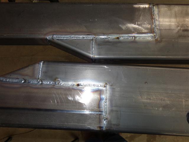

      A few more boring pics. I welded in the last of the gussets on the main rails this evening.

      Those rails look burly! Good move with No Limit stuff--I spent a couple hours watching Rob kick most people's butts on Saturday (GoodGuys Pleasanton) in Hellboy. He seems to know what he's doing, and he's a pretty cool guy. Who would have thought Hellboy has a horn?
