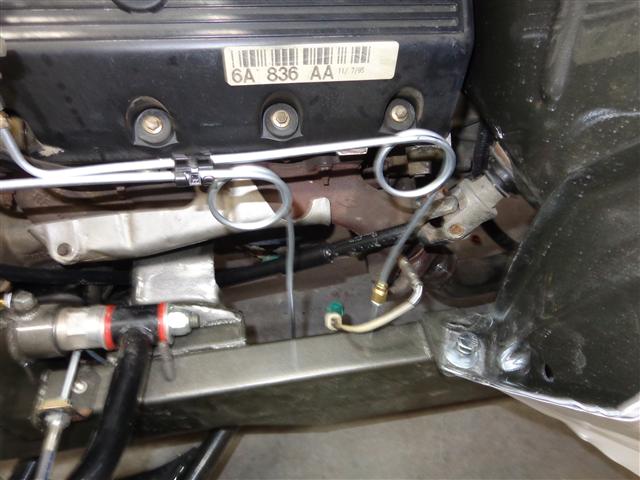

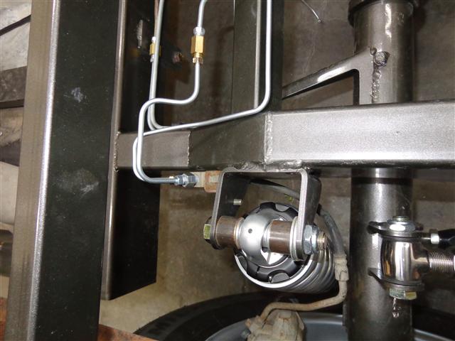

      I spent the last couple of days changing things that weren't going to work well. Most was cosmetic but when I was checking the rear suspension, I realized that the right rear brake line was going to be pinched if the suspension travel was every fully used. I redid those lines and finished the front going to the master cylinder. The hydroboost lines have been finished and the belt is on the engine for the first time since disassembly.

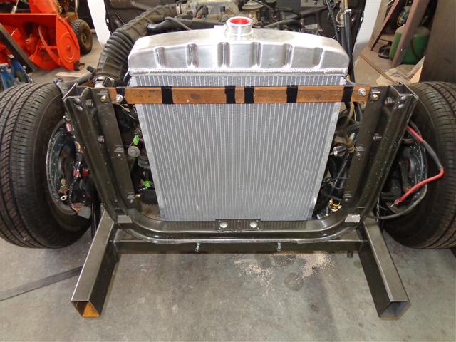

      Once again I worked all day and didn't get much done. One of the pics is the remote filter mounted. The radiator is in place and some of the mounting done. There is the cooling fan and the ac condenser to mount still. The pic of all the hydroboost lines is just to show that using the Mustang parts leaves you with some real ugly areas.

      One pic is of the wiring I'm trying to find a way to use gracefully. I spent most of the day making panels to fill the gap between the radiator and the radiator support, mounting the condenser, and mounting the cooling fan. The fan is spaced so it can't rub anywhere on the radiator. Same with the condenser. I hooked up power to the fan and it seems to move plenty of air. I won't know until it's above 100 degrees and I'm stuck in traffic with the ac on.
