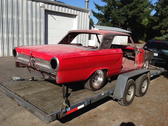

      Lucy loaded up, and ready for some metalwork.
      New guages

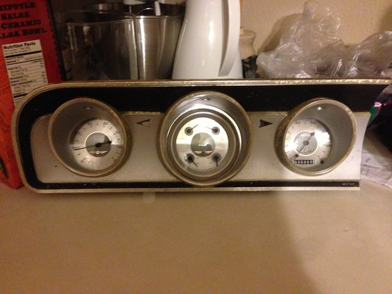

      They fit behind the factory plastic
      Here we go..

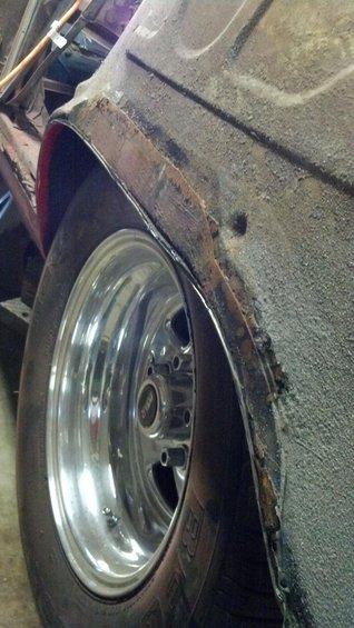

      Patches behind the wheelwell lip..
      Sigh..
      Scotty tossed this on to make me feel better.
      Panel went out to be dipped, he will fix the wheel tub area, where the shabby patches were, then he will get it put on.

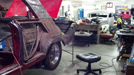

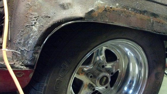

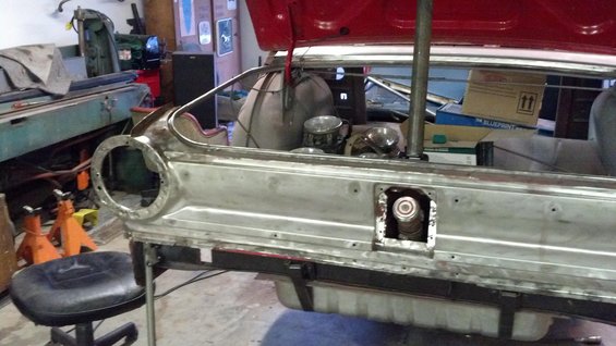

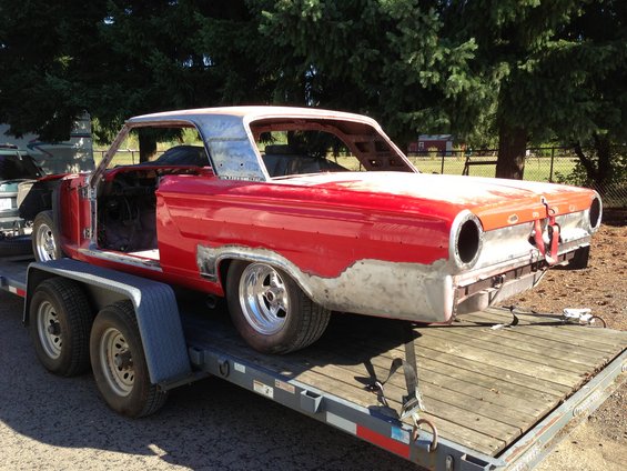

      Close ups of the removed quarter..
      Gas tank is out..

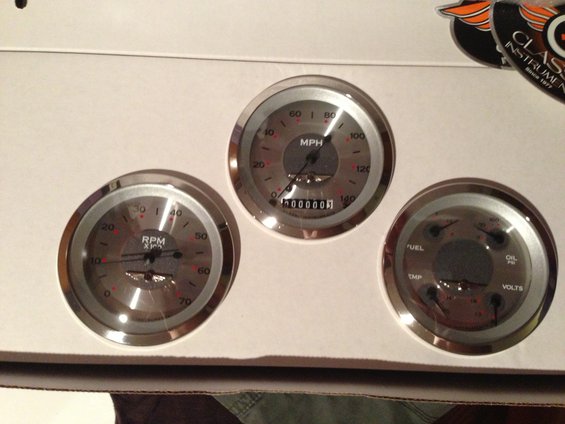

      Got some new shiny parts.. Wife sez since we are spending so much this car should be driven alot when done, so she wants air.
      Since I am going for a classic look on this car, i picked up this..
      Mark IV underdash from vintage air
      and this..

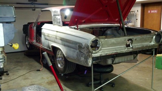

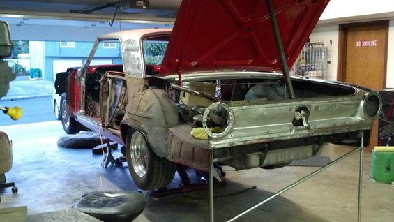

      Cut out cancer/booty fab from the wheelwell
      Cleaned excess metal flanges, prepped to replace the quarter panel.
      Inside of the firewall patch
      Clip back on to see how things lining up
      Set the grille in
      Axle gone!

      Looking sweet. Have you thought about putting the windshield wiper under the dash and closing off the engine compartment hole? Just a thought.

      Very nice build. You went all out smoothing the engine bay out!
      Those #'s by the hinges shouldn't matter. You just need to keep the VIN #'s from the front aprons.

      We are going to spice in the vin plates from both aprons after the new ones are welded in, And are just going to remove those #s by the hinges.
